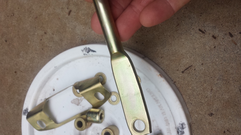

This hinge plate is a little dark but isn't burnt on the top edge like the picture makes it appear

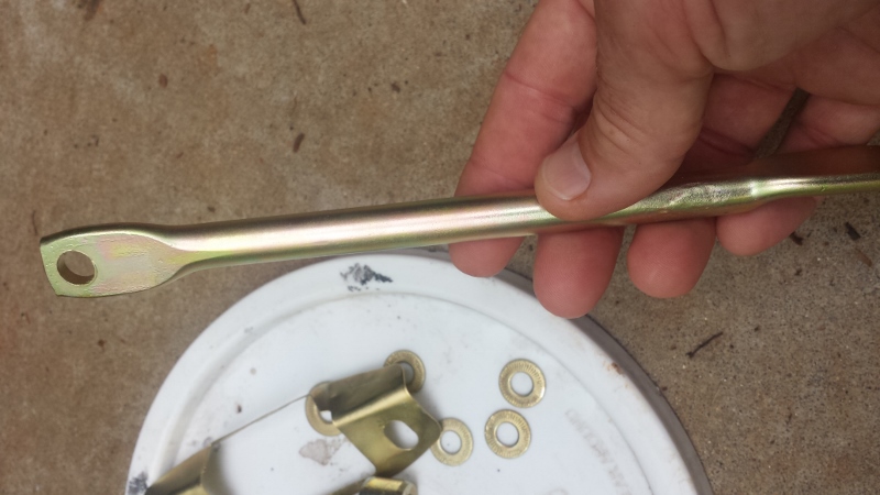

This bar came out really good. Obviously some of these parts are not Z parts. They are off the skid steer I'm working on...

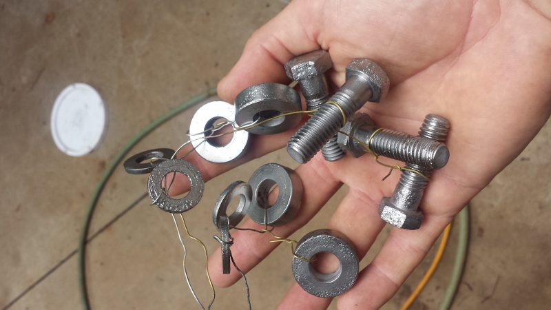

started with some bolts with surface rust

bead blasted

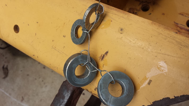

Lightly buff them against a wire brush on the grinder. If you use too much pressure it gouges and scratches the part up. If the pressure is light it makes them shiny. Into the crock pot with SP degreaser. RINSE Then I dip them in Muriatic acid for a pickle dip for 20-30 seconds. They pretty much quit fizzing when I pull them out. RINSE

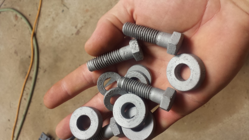

After plating 30 minutes at the calculated .15 amps/in
This is a second batch plated for 30 minutes. I ran these a little higher to try to burn them a little bit

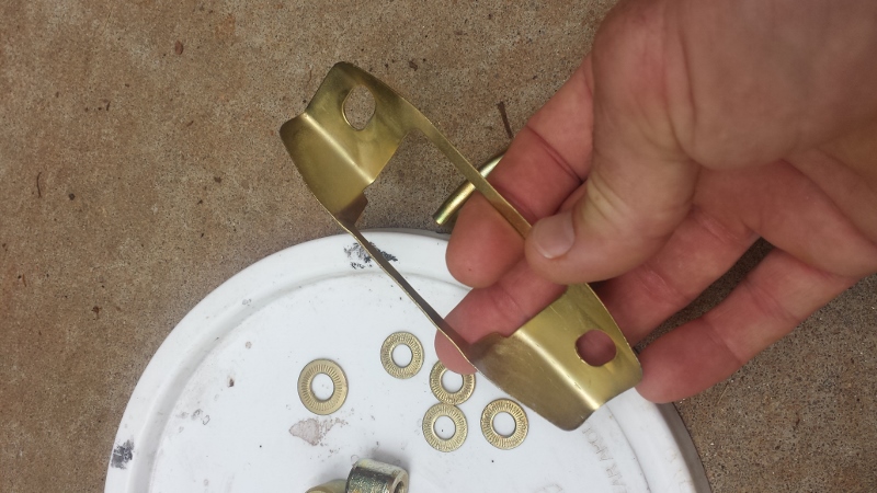

I bought some blue chromate a few weeks ago. This is what it does. I intentionally dipped them only part way to illustrate the affect
This is a 60 second dip in blue chromate
Then I let them hang until dry

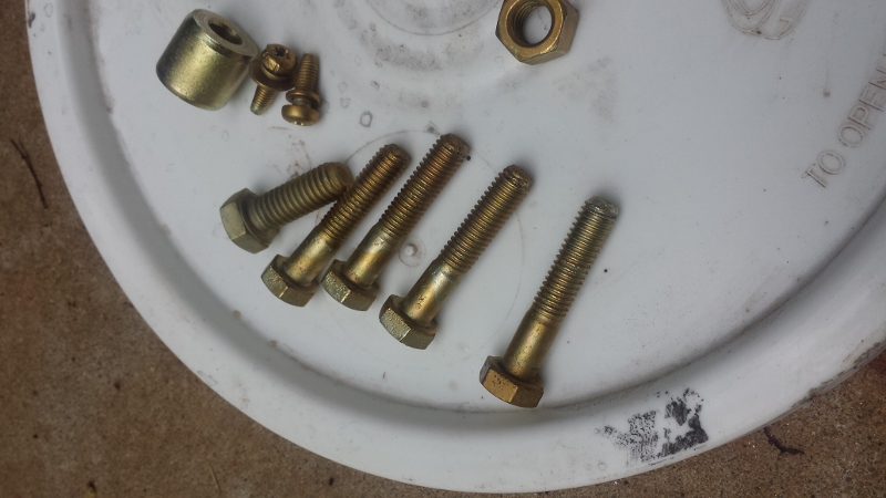

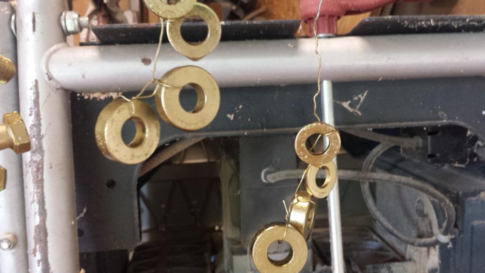

This is after the yellow chromate
I dipped the bolts for 25 seconds and the washers for 20 seconds
Then I lightly rinse with a spray bottle. If you get too aggressive you can rinse the chromate off. Shake the excess off. If it puddles and beads it will make dark spots. For things that really matter I dry them with light compressed air to keep them even...
