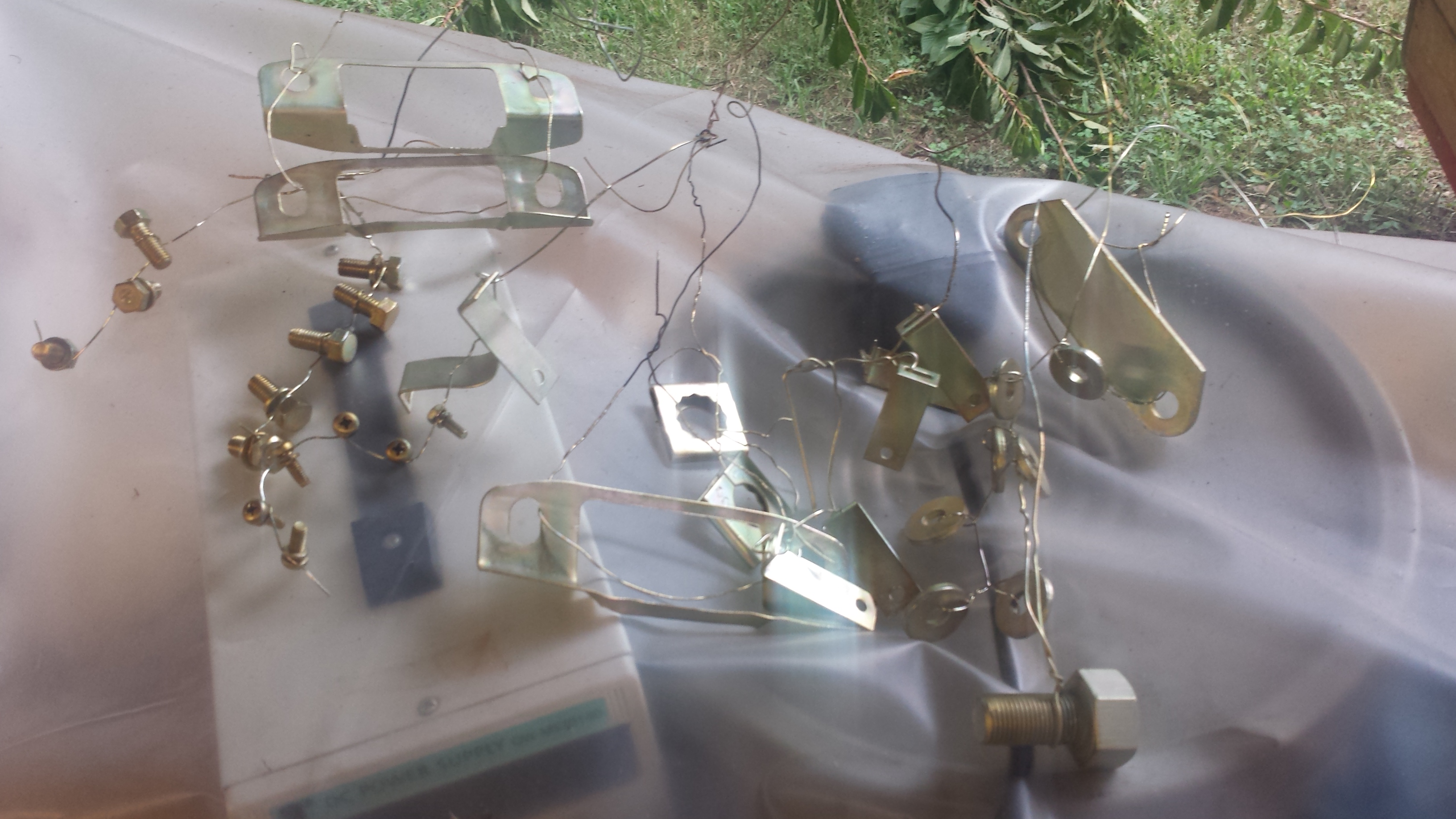

This is what I plated yesterday. Got good results although that may not be apparent in this picture. I would set it up and go check on the golf match or the Olympics. Plated everything for 30 minutes @ 0.14 amps / in
Blue chromate for 60 secs and yellow @ 35 seconds. I rinse it with the spray bottle between chromates and shake them off. I haven't used heat to dry them yet. Let them air dry overnight. The yellow chromate won't scratch off any more since I am going straight to yellow from blue after rinsing...
The finished color is very close to the professional stuff I have had plated
