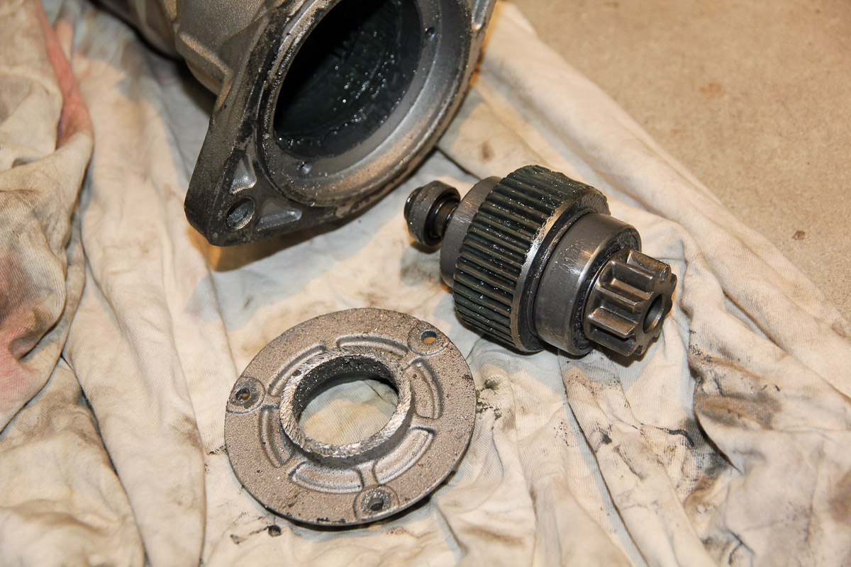

Out of nowhere, there's been a nasty grinding noise whenever I start the car.  Sounds like the pinion gear on the starter isn't retracting.  The starter's pretty new: the old one died at the shop when the mechanic (a local Datsun guy with a good rep) was giving the car a once-over after I purchased it, so I had him replace it then.  I pulled it off tonight to inspect it and promptly had the pinion gear/clutch assembly fall right out onto the ground and saw this:
The three screws that are supposed to hold that housing in place were nowhere to be found and the housing is a bit torn up as well.  I'm assuming the housing got caught on the pinion gear and shoved into the flywheel ring gear.  Should be an easy fix once I can get some screws, but I'm none too thrilled with the mechanic's work right now.

55 minutes ago, Patcon said:
Is the starter a "reman"? That may not be on the mechanic if the starter didn't have the screws to begin with...
 Wouldn't the "local Datsun guy with a good rep" have noticed that and done SOMETHING about it at the time? Seems like it would have been obvious.
It's a remanned unit, but I would hope it would've been noticed and addressed.  Mistakes happen, and maybe I just have bad luck with shops, but darn if that kind of stuff doesn't seem to happen more often than I'd like.  At least it's an easy fix.  Bless those 1970's engine compartments that let you see all the way to the ground.
If I pulled a starter out of a box, I don't know that I would have looked it over or shone a light down past the drive gear to look for missing screws. I would have worked on the premise that all the screws were in it. I suspect they are hard to see around that gear when properly assembled.
I'll never know what happened to them, but I'm 99% sure they weren't there when the starter went on the car.  It's all been degreased, tidied up, regreased, and put back together now (with screws this time!), so that's over and done with.

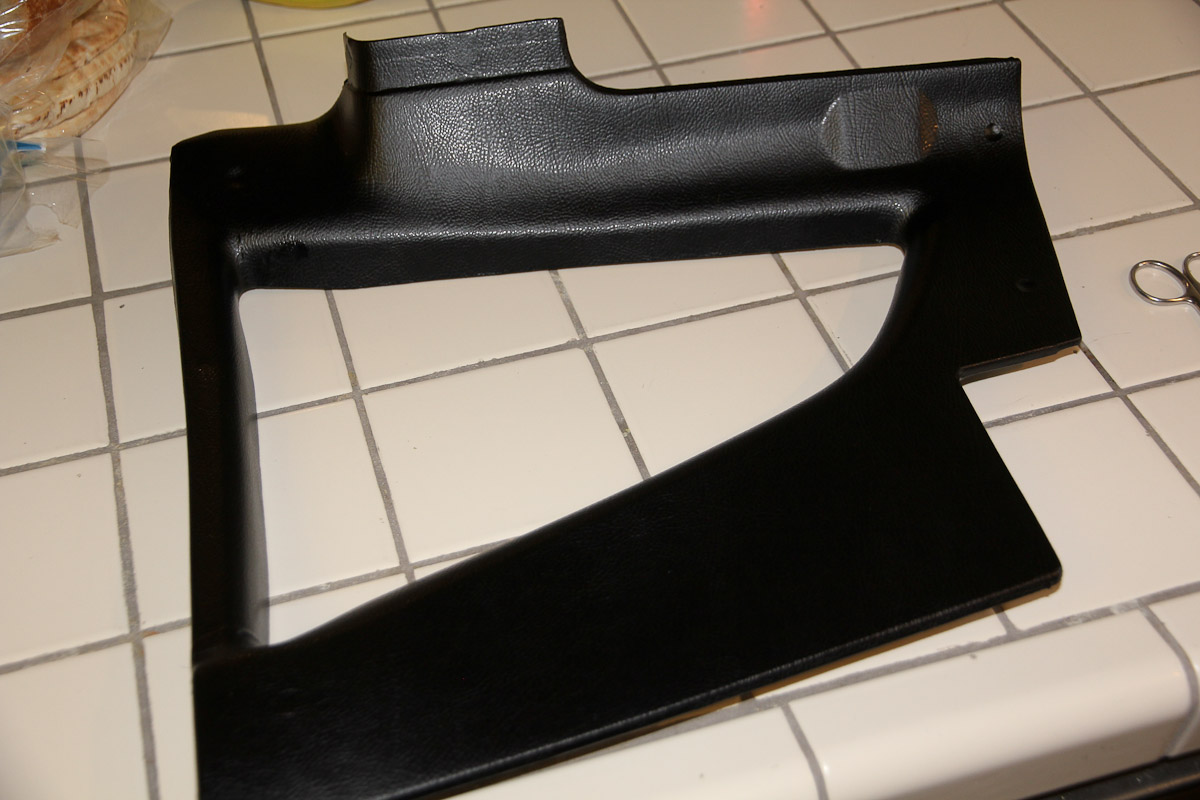

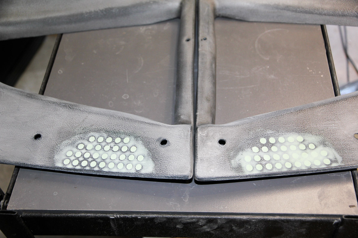

So, window trim.  First step was eliminating the speaker holes, since I'm not going to put speakers there and it won't look good with the vinyl.  Some masking tape on the back side and a bit of body filler.  To give it a little extra support, I tried something new on the back: put a light coat of ABS cement down, then a piece of fiberglass mat.  Wetted that out with more ABS cement.  Worked great.

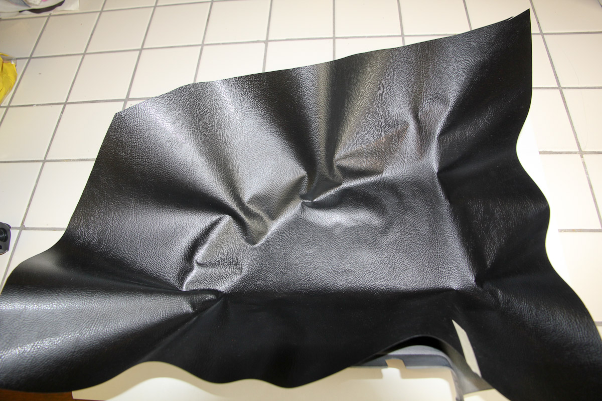

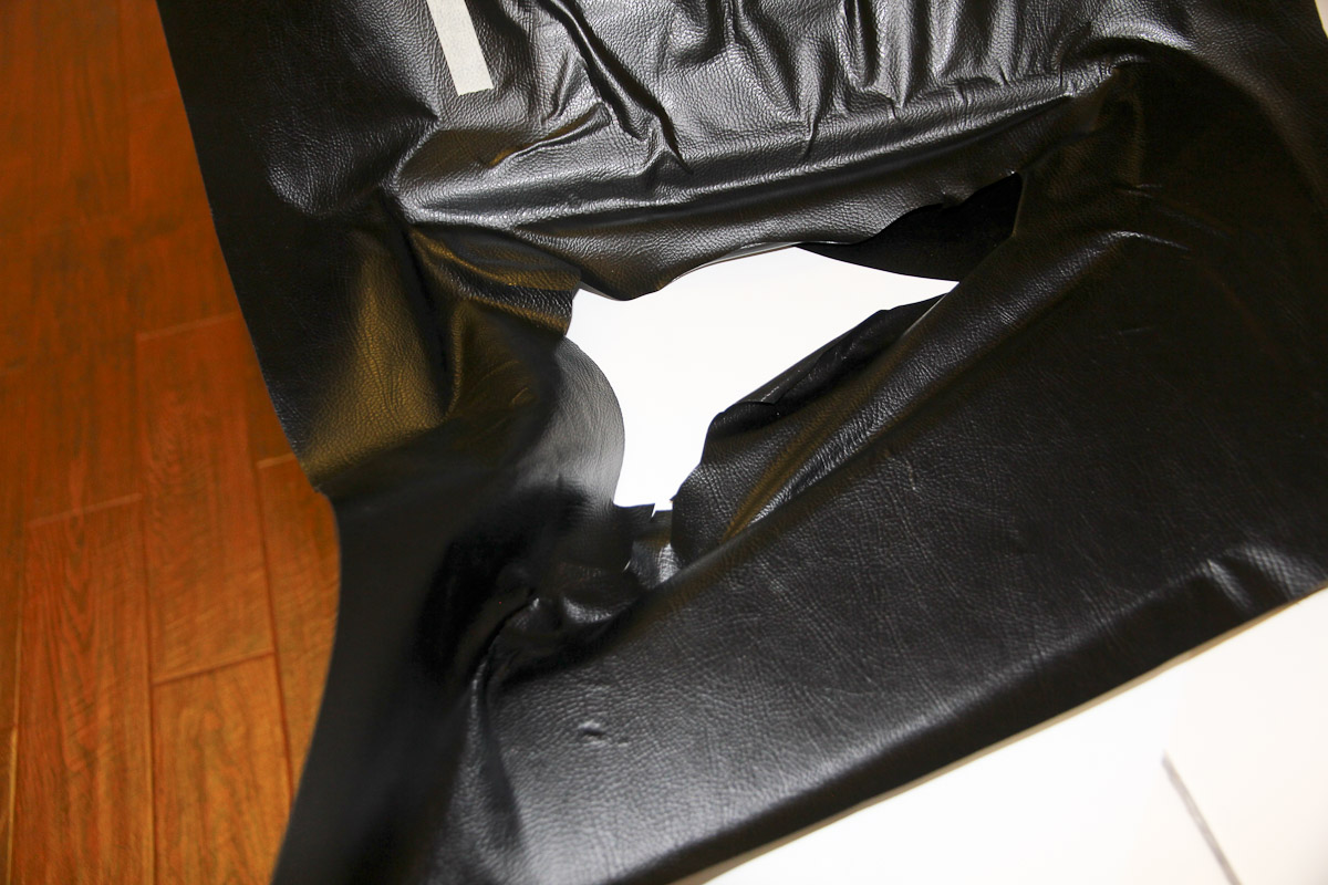

On to wrapping, which was beastly.  I've done a similar inset like this before, so I knew it was gonna be tough.  The hard part is having enough material in the middle to get into the recesses and not have it bunch up on the flat surfaces.

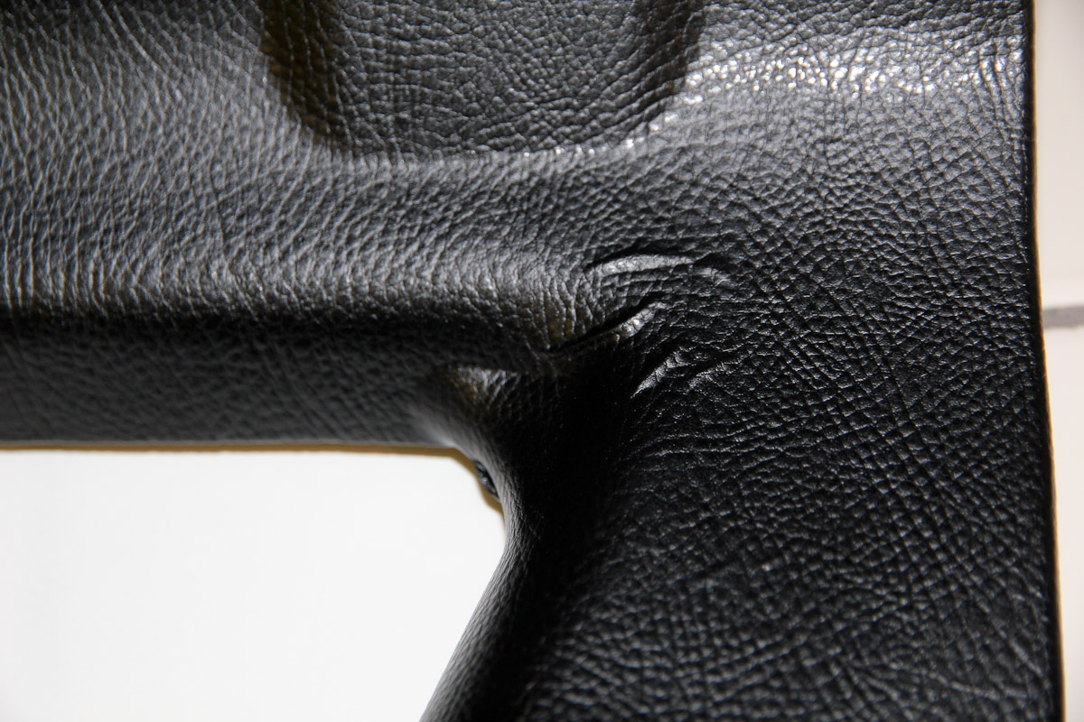

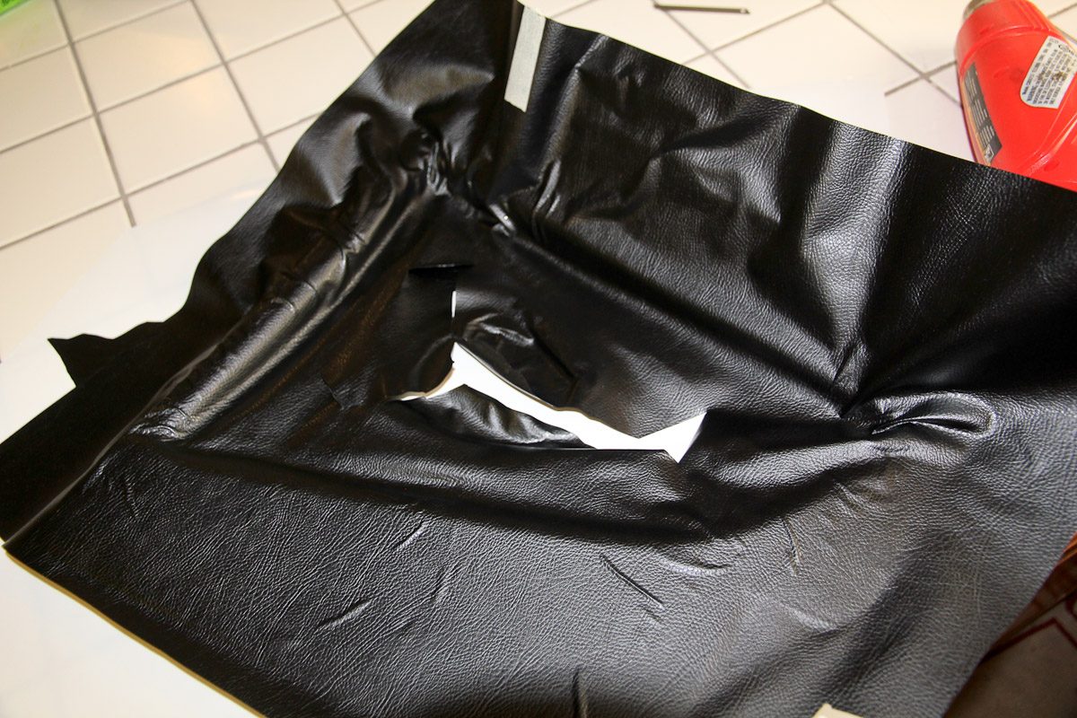

 I tried valiantly, but couldn't get it to sit right, and eventually cut a seam in one of the corners.  Everything got repositioned a bit; the excess material is on the bottom left.
By this point, it was not going well -- the vinyl wasn't laying well, had a lot of wrinkles, and was lifting in the corners -- and I could feel myself getting frustrated with it and was getting ready to throw in the towel.
So, gym break.

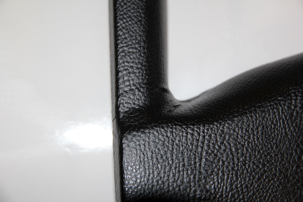

Back at it after a couple hours, and things started going a little better. As expected, the corners lifted, so I shot some superglue in there which should keep it in place (that trick's worked for me before, so here's hoping).  The seamed corner isn't great and there are a couple wrinkles here and there, but the end result is acceptable.  And the other one...I'll wait for tomorrow.
