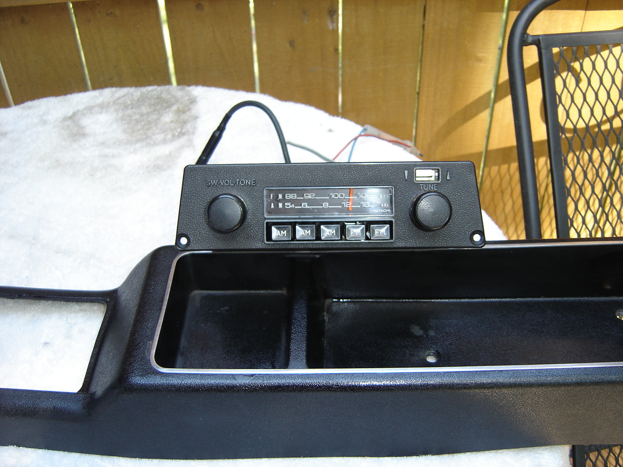

May 9, 20168 yr comment_494577 With all the Bluetooth speakers out now and the micro SD cards for my phone, I've decided to put the original radio back in. It took an hour of hair brained searching to find it but when I did I was happy to see the condition it was in, almost like new other than the silver edging is worn off. Link to comment https://www.classiczcars.com/forums/topic/51367-project-boondoggle-or-so-i-went-and-bought-a-z/?&page=18#findComment-494577 Share on other sites More sharing options...

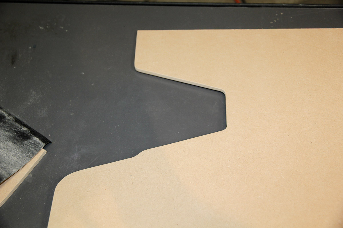

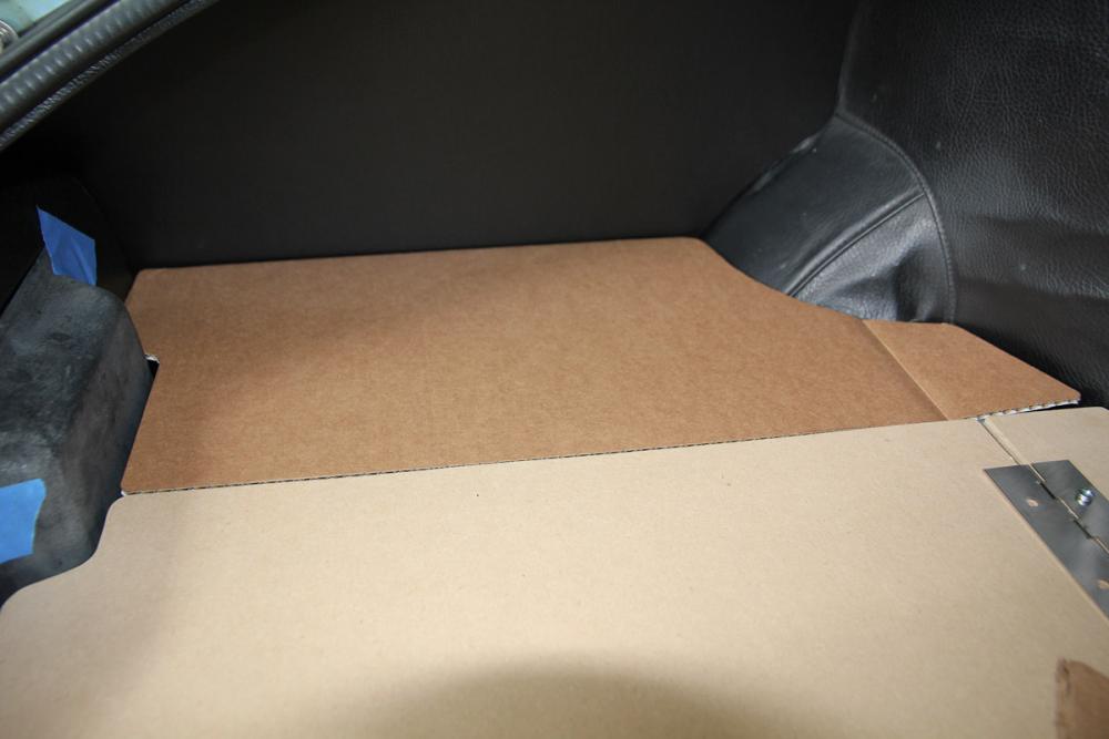

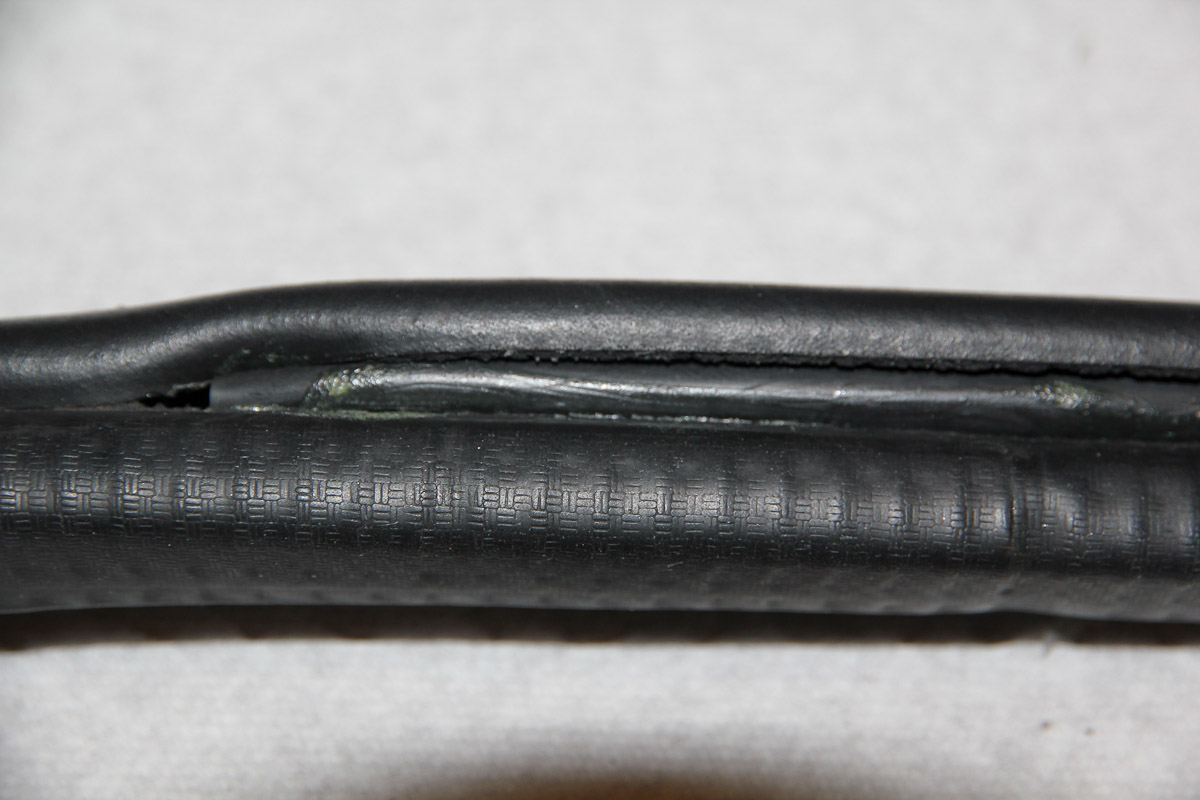

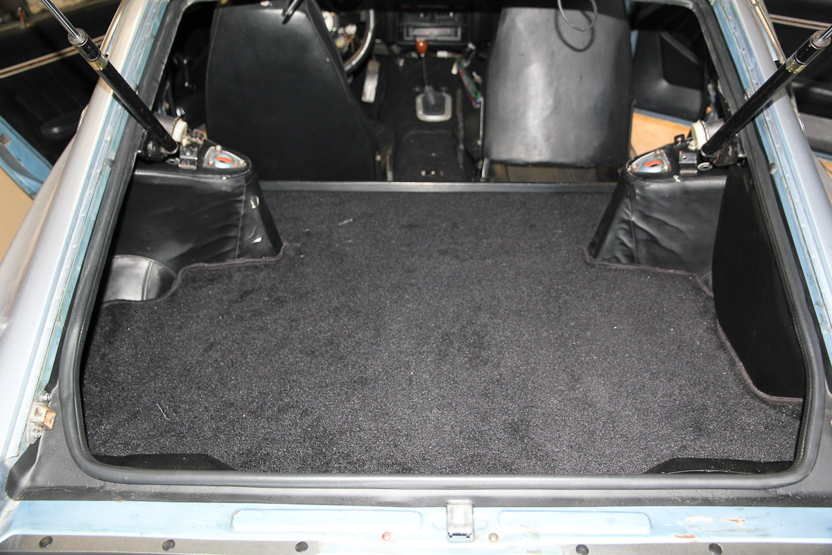

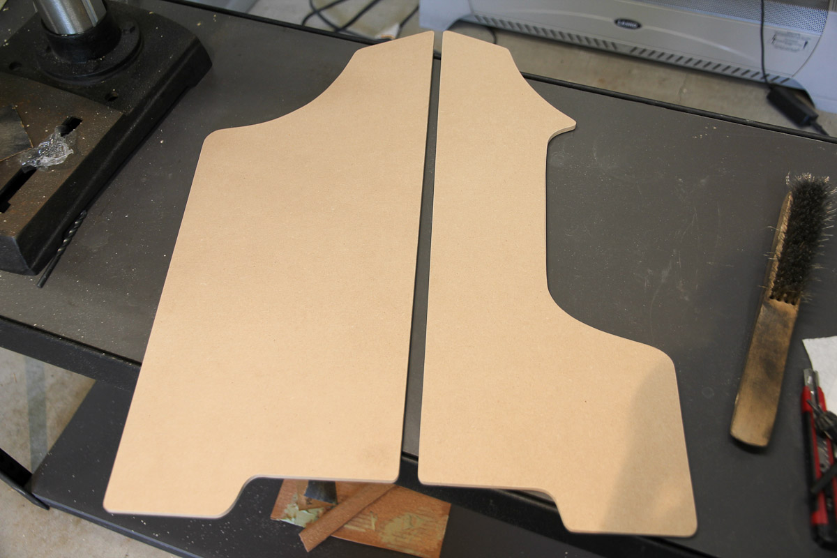

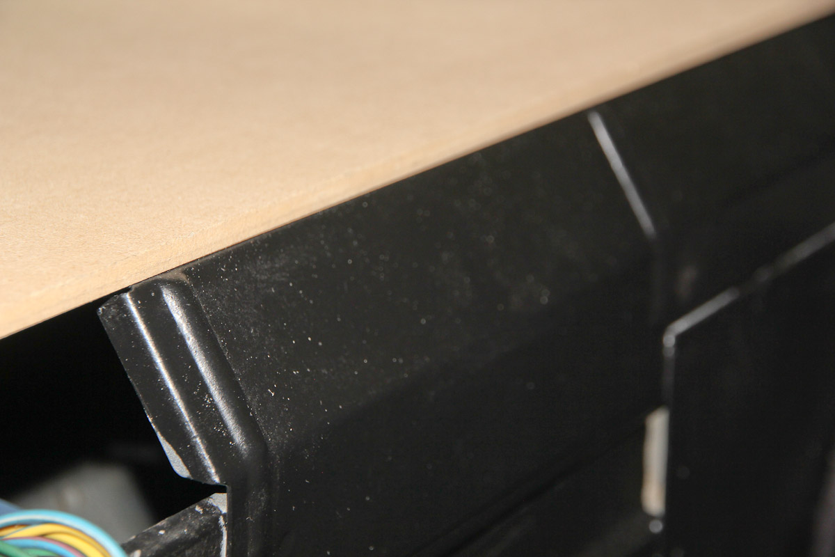

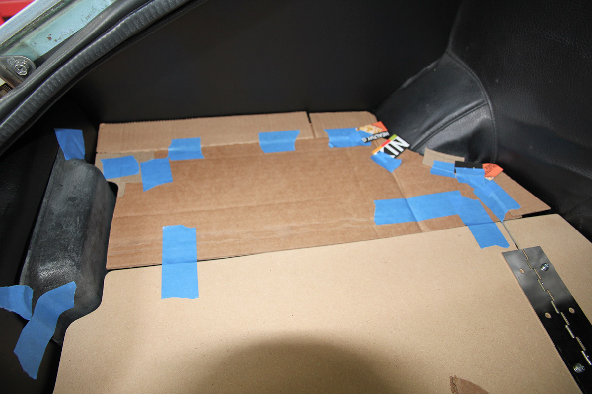

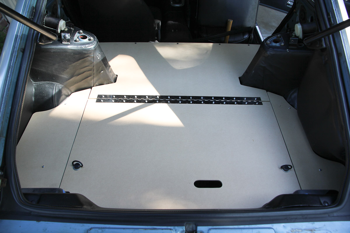

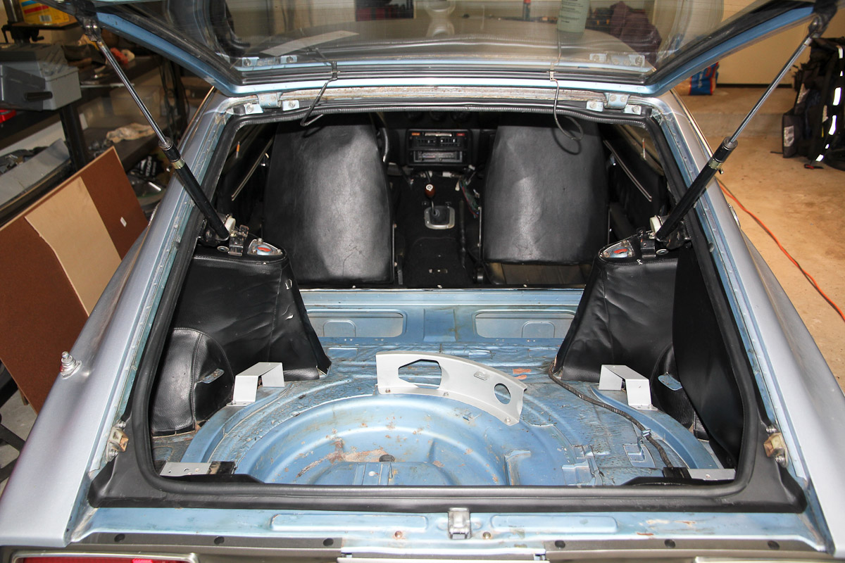

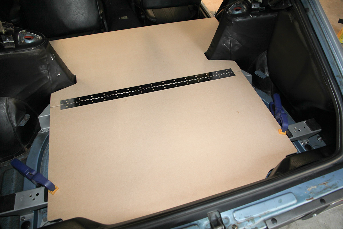

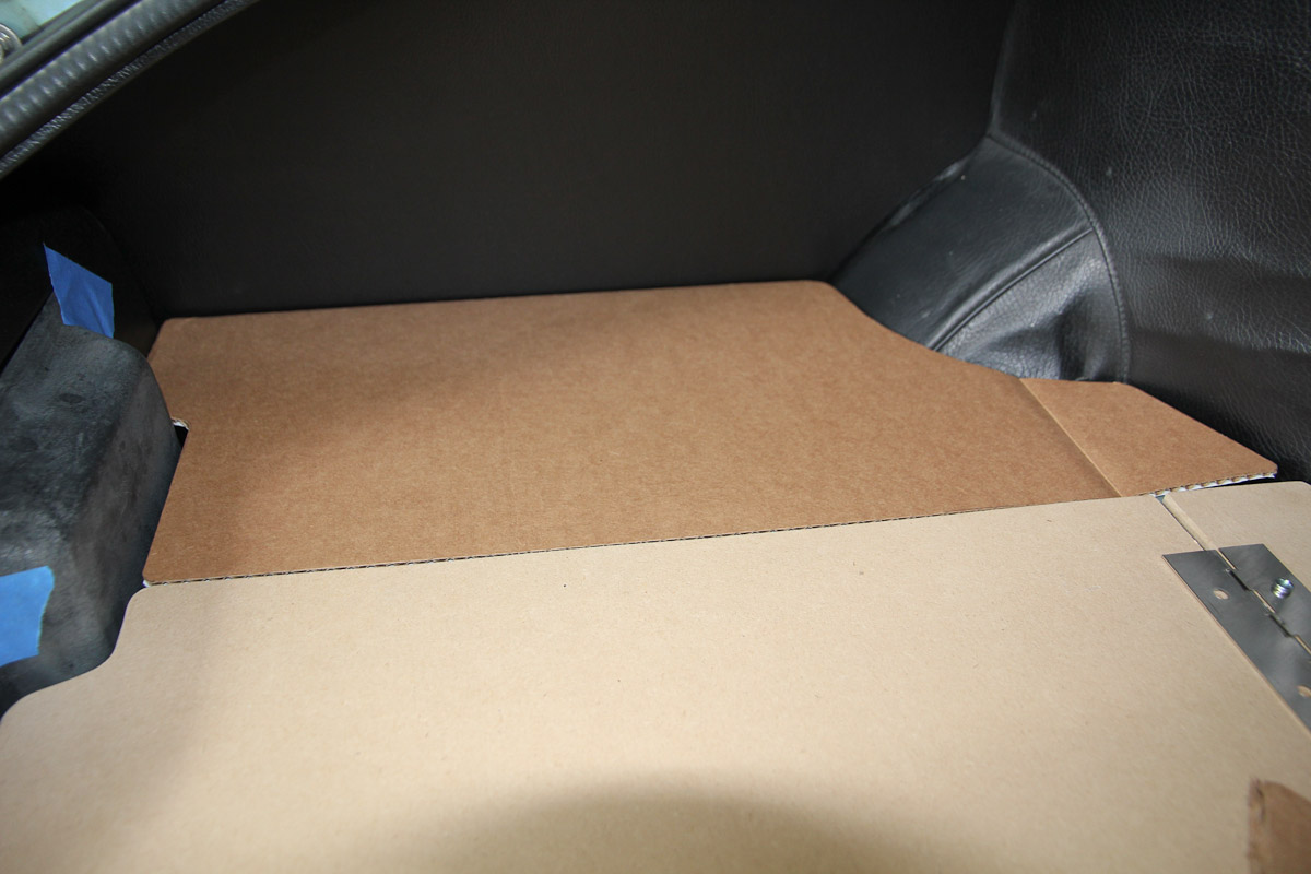

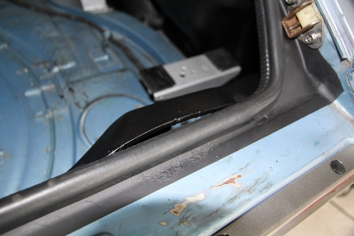

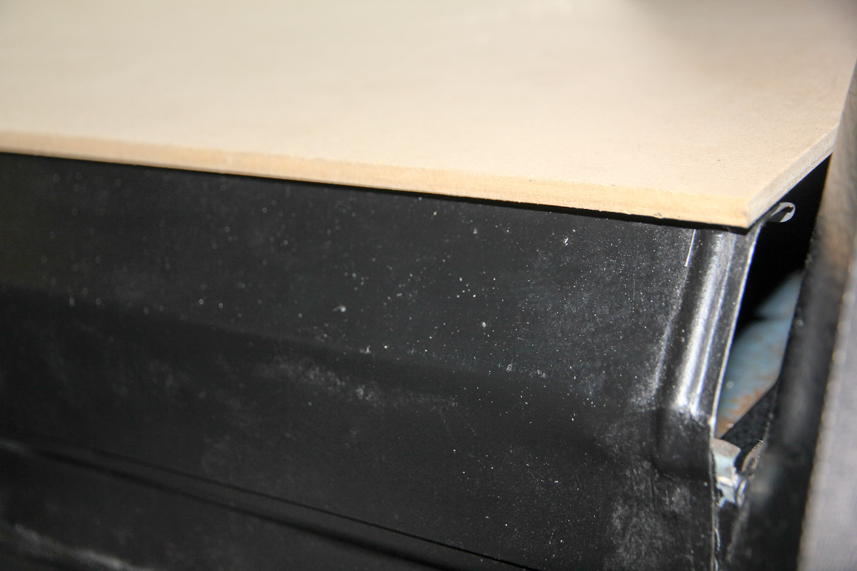

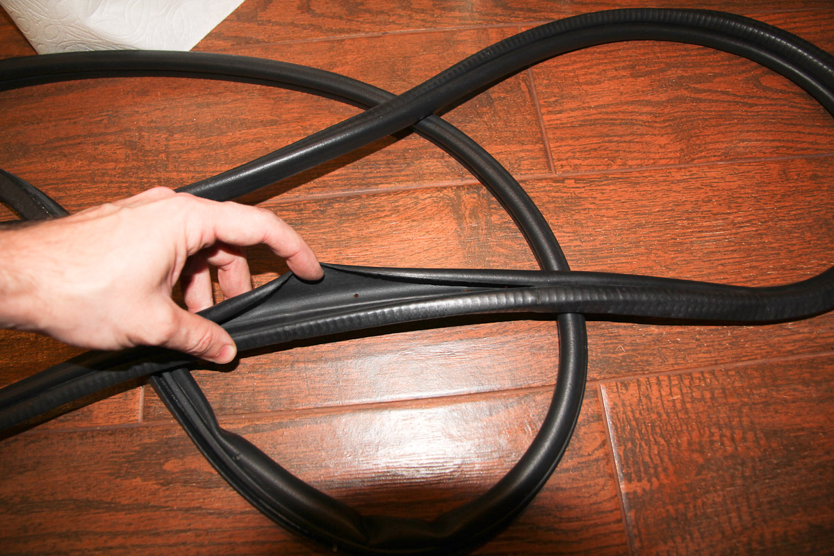

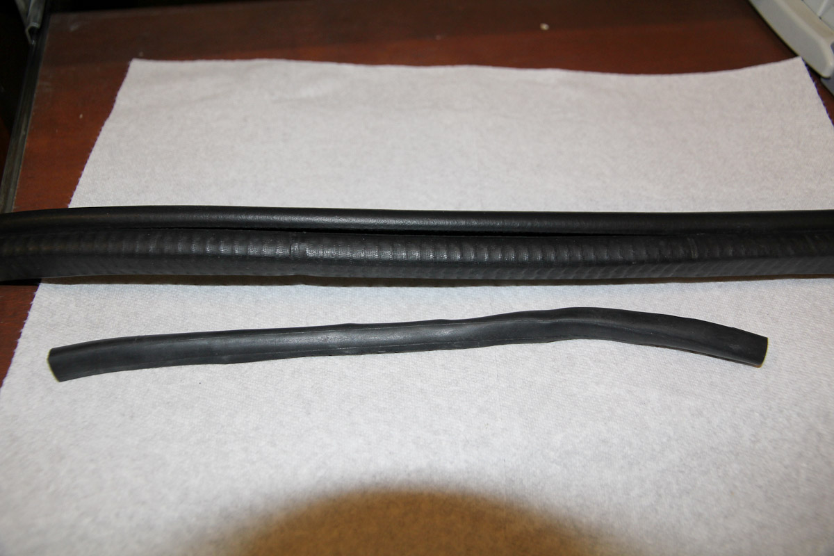

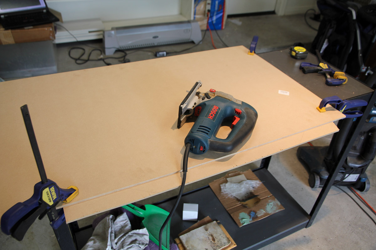

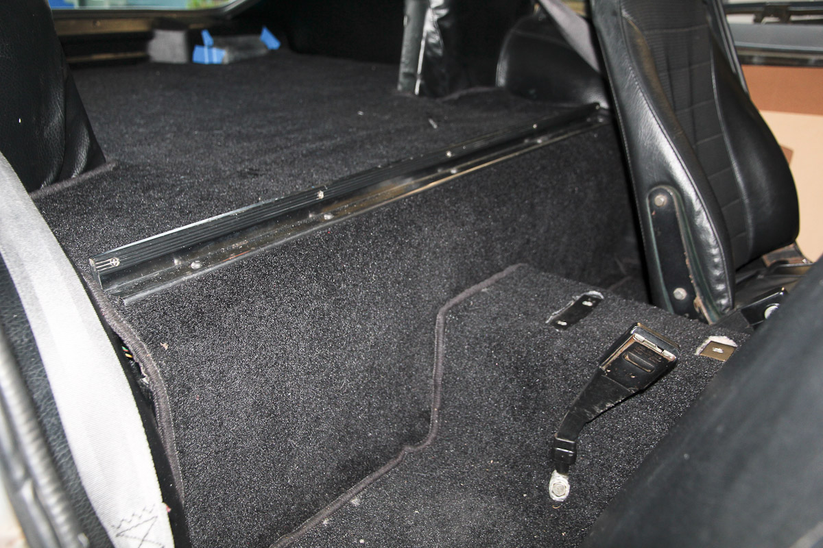

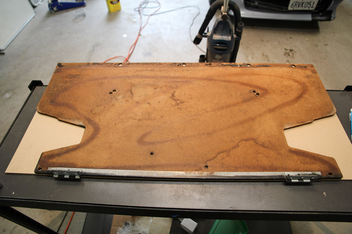

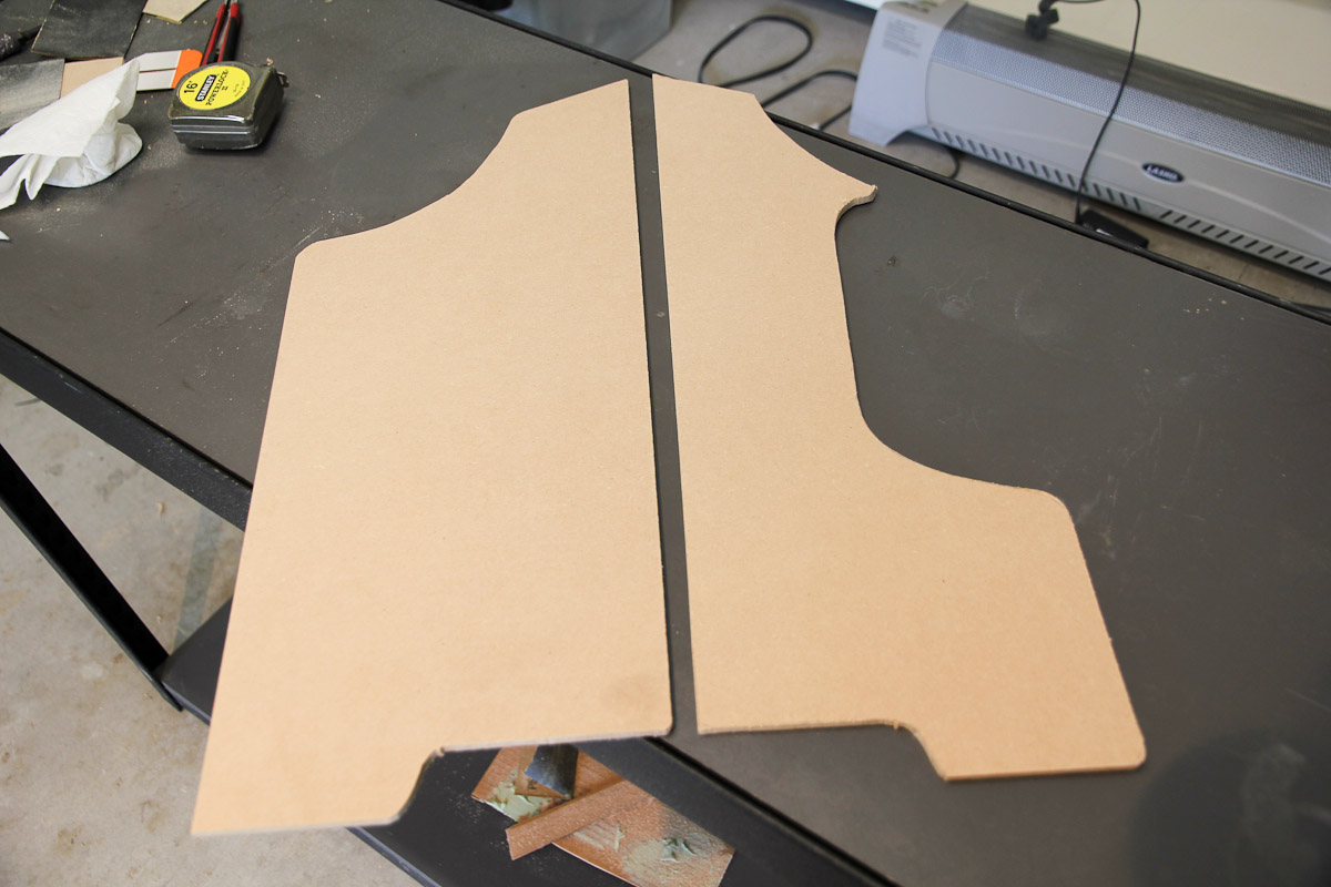

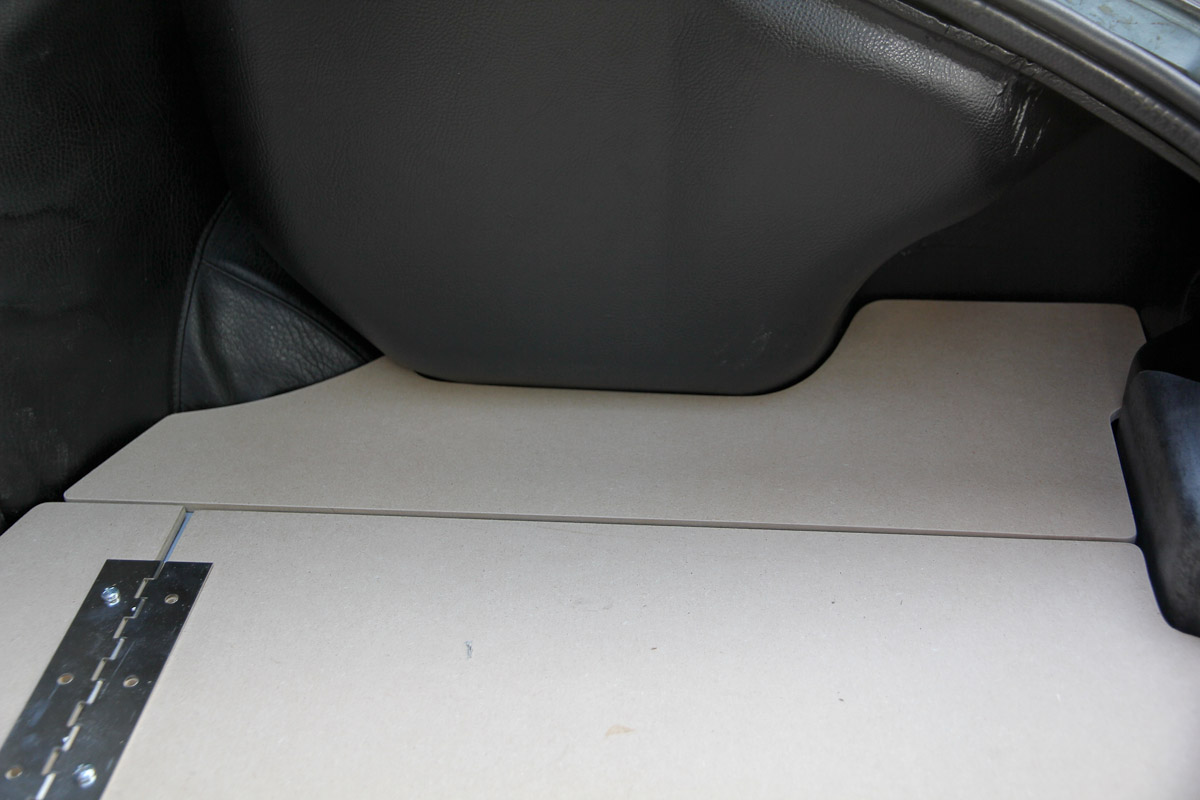

May 26, 20168 yr Author comment_495703 Rear deck is finally done. The panels back there forced the issue with the weatherstripping and I was able to finish that up as well. I grabbed a Kia part on my last junkyard trip and had the brilliant idea that I could fix the one good-sized rip in it with some contact cement and an old bicycle inner tube, and it almost worked...right until I closed the hatch on it! Lesson learned: don't waste your time. New seal is a big improvement over the old one, though. Definitely worth the $5. Only thing I'm not totally happy with is the interior tail light panel. The driver side looks good but the passenger doesn't fit right and leaves a gap. It's probably warped or may have been a low-quality aftermarket part, but there's not much I can do about it at this point. Moving on to the new rear deck panels. Unfortunately, my wood working tools are fairly limited, so I mainly have to make do with little more than a jigsaw and a drill press. I still had the two main panels so those were pretty simple to recreate by tracing. The old hinge is riveted in place and would be difficult to reuse, so got a piano-style hinge to use instead. Did some trimming to get everything to fit, but eventually everything lined up nicely. The side panels were a little more work. My car didn't have them when I bought it, so those were made from scratch using cardboard templates. I spent a hilariously inappropriate amount of time shaping those things to ensure the gaps around the panels were consistent before they got covered up by the carpet. Finally the rear carpet could go on. I've been pretty forgiving of ACC's carpet kit for the rest of the interior, but the piece they provided for the back could use some work. Two of the holes for the trim piece were both incompletely punched out and mis-aligned, so I had to fix those. The whole carpet section isn't as centered as I would like it to be, either. But it's done. In other news, my fuel pump continues to be an issue. Took the Z out today and filled up the tank, only to have the fuel pump stop working when I tried to leave the gas station. Same kind of thing that happened a month or so ago. I fiddled with all the relays and checked all the fuses, to no avail. I gave the fuel pump a couple love taps and that (apparently) got it running again; at least long enough to get it home. So obviously that problem isn't as solved as I thought it was. Link to comment https://www.classiczcars.com/forums/topic/51367-project-boondoggle-or-so-i-went-and-bought-a-z/?&page=18#findComment-495703 Share on other sites More sharing options...
May 26, 20168 yr comment_495707 Looks great! Nice work. Is there a provision in the deck carpet for the cargo straps? Also, are you missing the outer hatch seal, or just not installed when you took the pictures? Link to comment https://www.classiczcars.com/forums/topic/51367-project-boondoggle-or-so-i-went-and-bought-a-z/?&page=18#findComment-495707 Share on other sites More sharing options...
