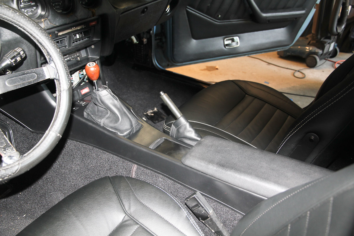

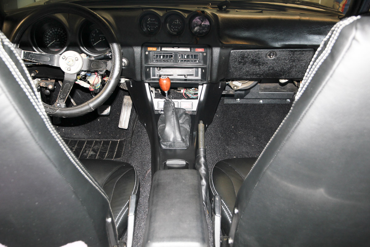

And then the center console.  The one I have is pretty well beat up -- aside from being dirty, it had some bad paint on it, the armrest was broken, ashtray rusty, etc. -- but I don't really want to spend my limited budget on a new one right now if I can get it to Good Enough, so that's what I did.  The ashtray I cleaned up as best as I could with a wheel and sandpaper, then sprayed it with the wheel paint I used for the tail light panels.  The sliding cover got a coat of Rustoleum.
The armrest was cracked along the middle, so that was glued and fiberglassed together.  Someone covered it in the past with some foam rubber, which I left, but the studs for the screws had all been split open or broken off.  Those were glued back together.  I also stumbled upon a way to replace ones that were missing entirely: acid shop brushes dipped in ABS cement and cut to length.
The rest of the console got a thorough cleaning to remove as much of the old paint as possible.  I glued/glassed some cracks back together and tried to fill in the choke slot, which was only a modest success.  I sprayed the whole thing with Krylon Fusion and am hoping it holds up alright.  It looks decent (and way better than it did), so if it lasts for a year (or even until I can do the dash) then that's good enough.

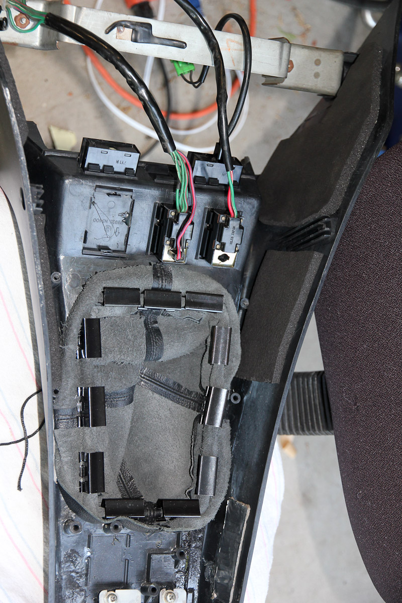

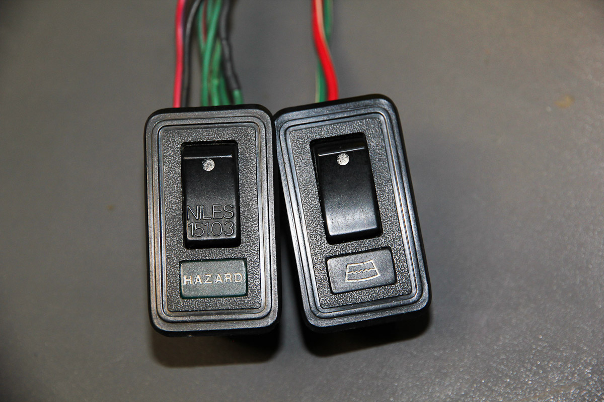

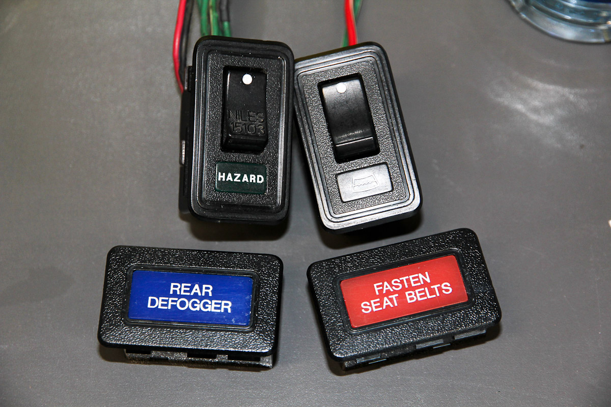

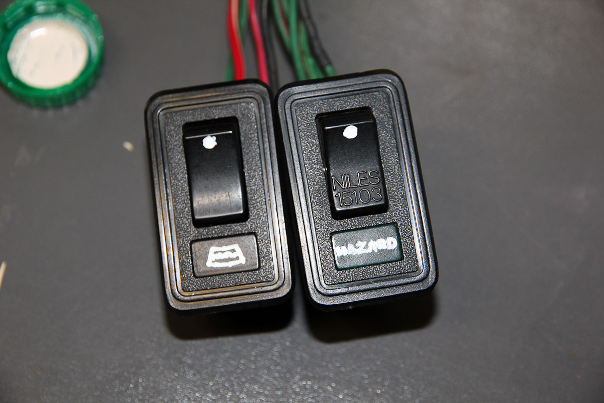

Back from vacation, and finished up the console.  Thoroughly cleaned and touched up the lettering on the switches and indicators (too bad most of them are missing the bulbs and wiring -- more to add to the list).  Raided the office supply closet to get some clips to hold on the shift boot and stuck Raammat and foam in there to beef up the plastic a bit.  Sprayed a couple coats of clear on the console.  It actually came out looking better than I expected it to.  Now I wish I spent more time cleaning up that choke slot.

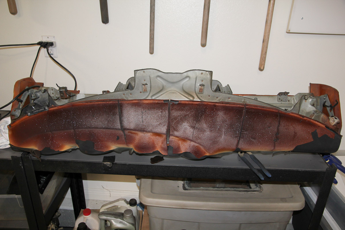

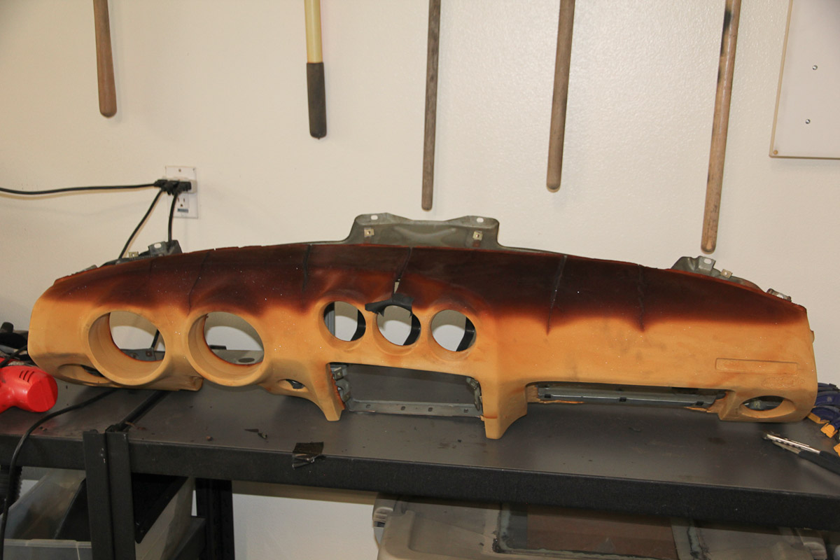

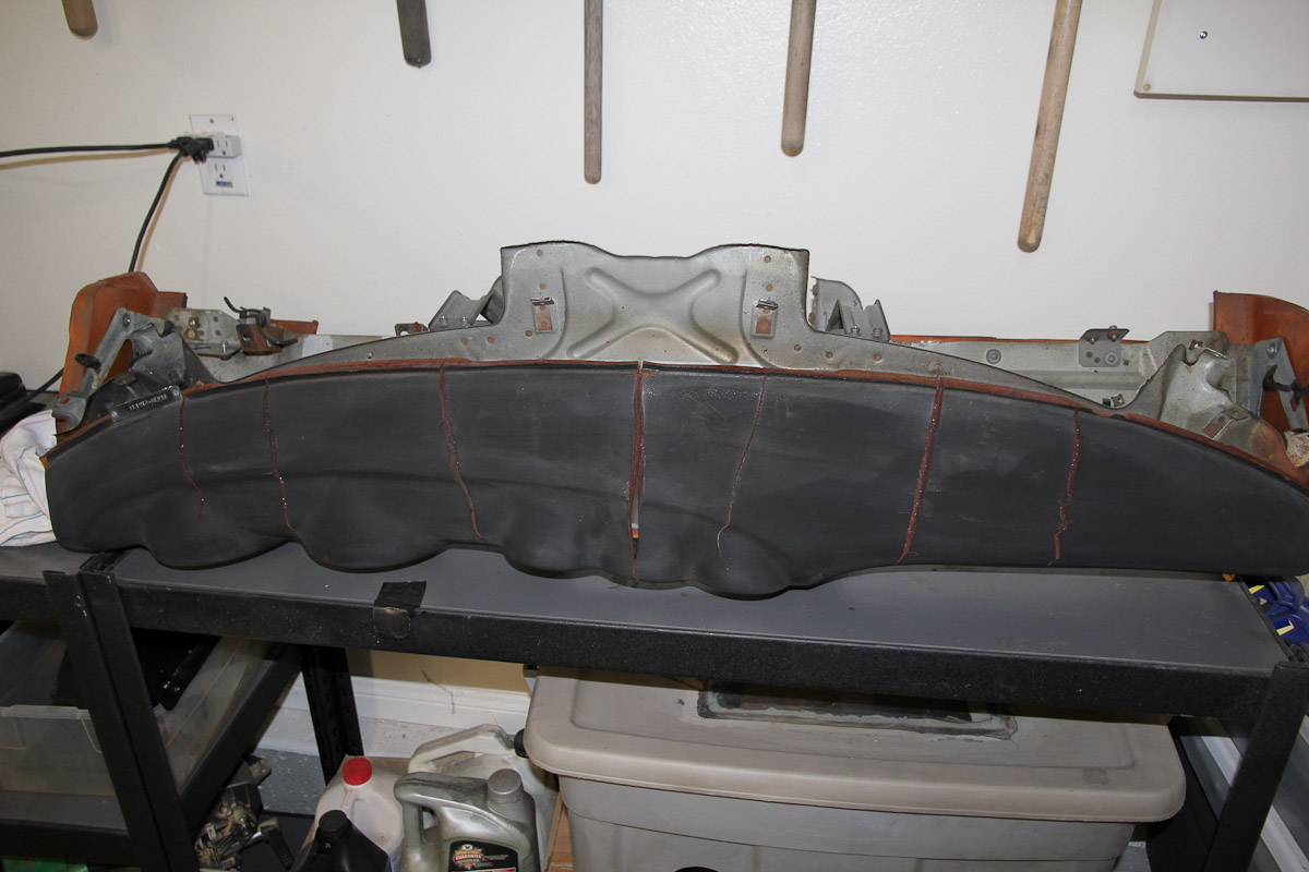

Pulled everything out of the dash the other night and got ready for what I thought would be the incomprehensibly miserable job of removing the original plastic from the foam shell.  Turns out that a heat gun and putty knife make it fairly quick and easy (and clean) to remove.  I got the top half done last night while waiting for the shower, and took off the rest this afternoon.  Fairly obvious what 38 years of sun, heat and other abuse does to the dash!
I'm planning to fill the cracks this weekend.  Once the cloth and epoxy resin gets here I can lay that on.  Everything's in better shape than I expected, so -- fingers crossed! -- fiberglassing looks like it may go well too.  Still debating on finish options.

I know a lot of people who have repaired their dashes leave the old plastic there, but it's old and very brittle and I don't think I could even get it back in the car without cracking again, let alone have it last for years in the future, so the plan was always to fiberglass it.  Considering that resin won't stick to plastic, the plastic is shot anyway, and that fiberglass will add some extra thickness in areas like the gauge pods it made sense to try to strip it off.  Even though the plastic on the lower sides was in good shape, I don't want to worry about any visual or texture mismatches, so it's easier for it all to come off.
I've not done any dash refinishing work, but looking at my failing dash, it appears to me that the expanded foam underneath is suspect too.
Using your forensic analysis skills, what do you think was the progression of events leading to the dash failure? Do you think it's possible to permanently fix a dash without addressing the underlying foam?
The foam is a problem too, Cap. The darkened foam isn't soft or flexible like the yellow foam is.  Totally speculative on my part, but I'm guessing the foam isn't heat stable at the temperatures that it sees from direct sunlight in summer.  The plastic is probably breaking down from a combination of age and UV exposure, and when the foam loses it's elasticity, it's game over.
As long as the new dash skin is strong enough on its own, I imagine a dash could be permanently fixed without addressing the foam.  That's why I'm using fiberglass.
