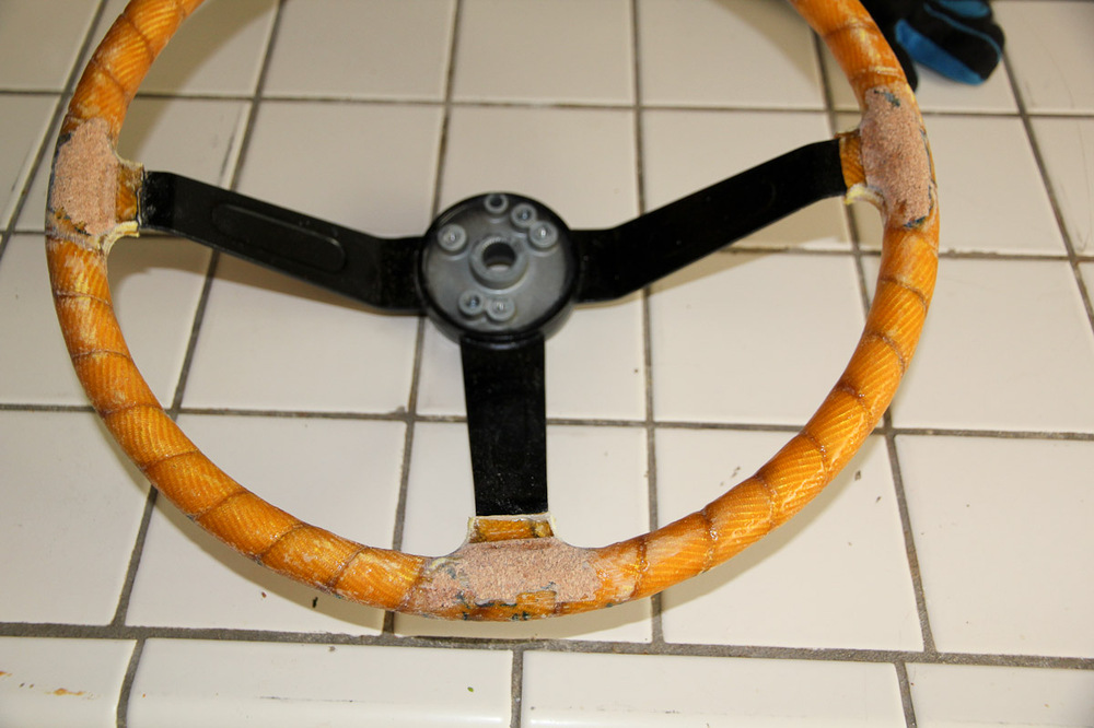

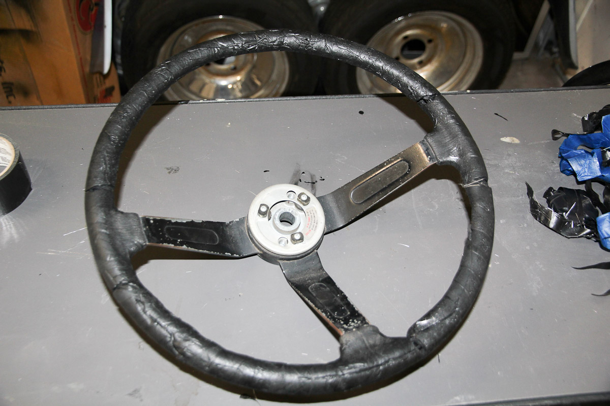

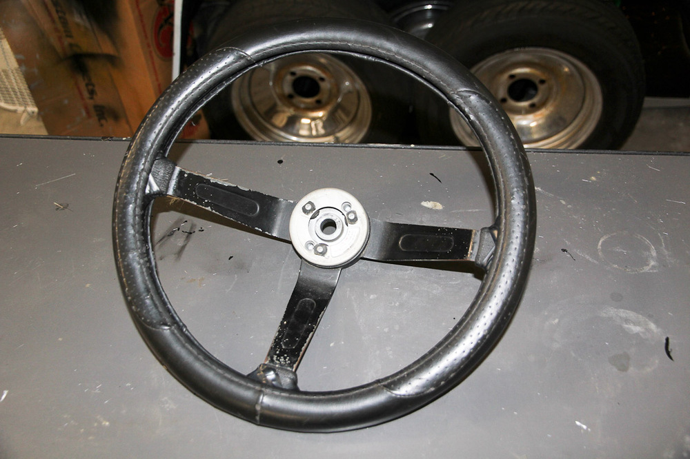

It's in bad shape, and after the dash went back in, it became even more obvious just how bad it was, and harder to overlook: auto parts store cover over electrical tape over masking tape over whatever was left of the original foam.

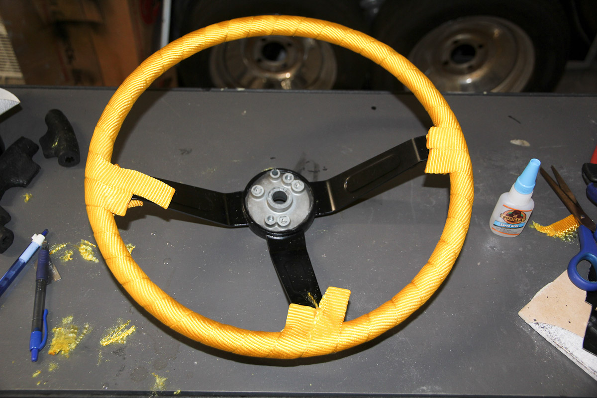

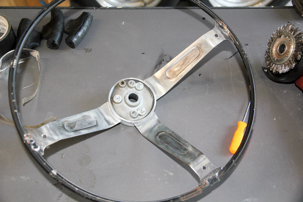

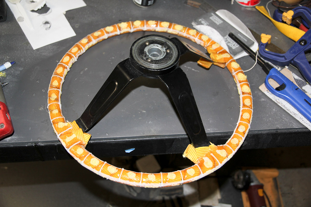

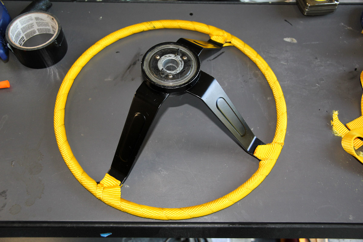

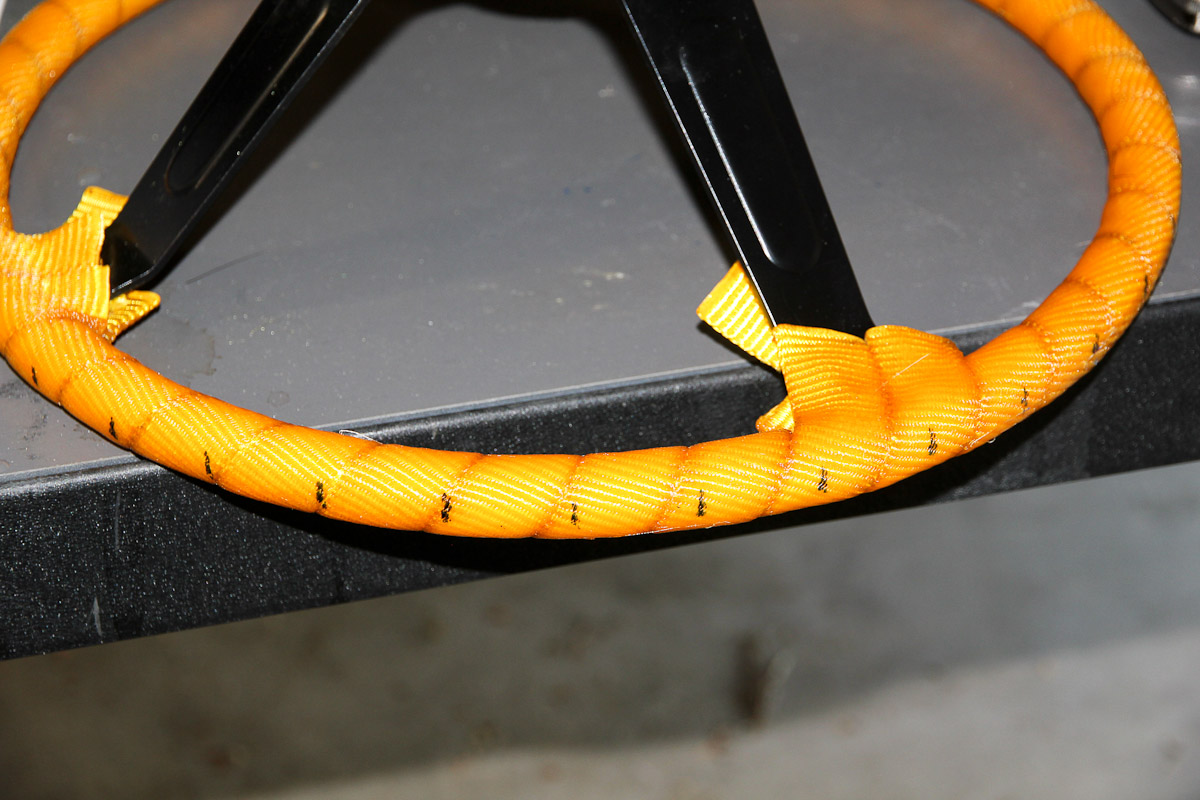

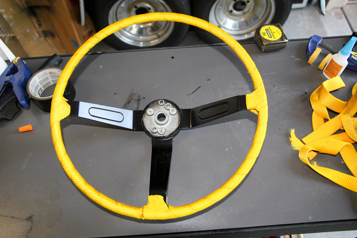

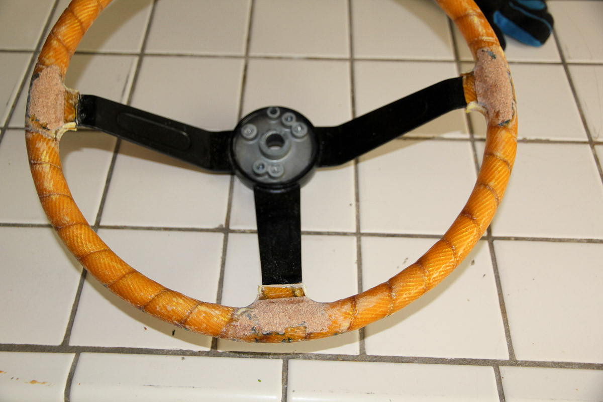

So, having watched a bunch of YouTube videos on steering wheel upholstery and having more enthusiasm than ability or common sense, dove in: stripped everything off and removed the flaking old paint. The spokes were sprayed with some rattle can Rustoleum. I'm now in the middle of building up the wheel. I searched Home Depot for anything I could use to replace the original padding but came up empty -- all the foams I found there weren't dense enough. I dug around the garage and found a bunch of old nylon webbing and thought to do this:

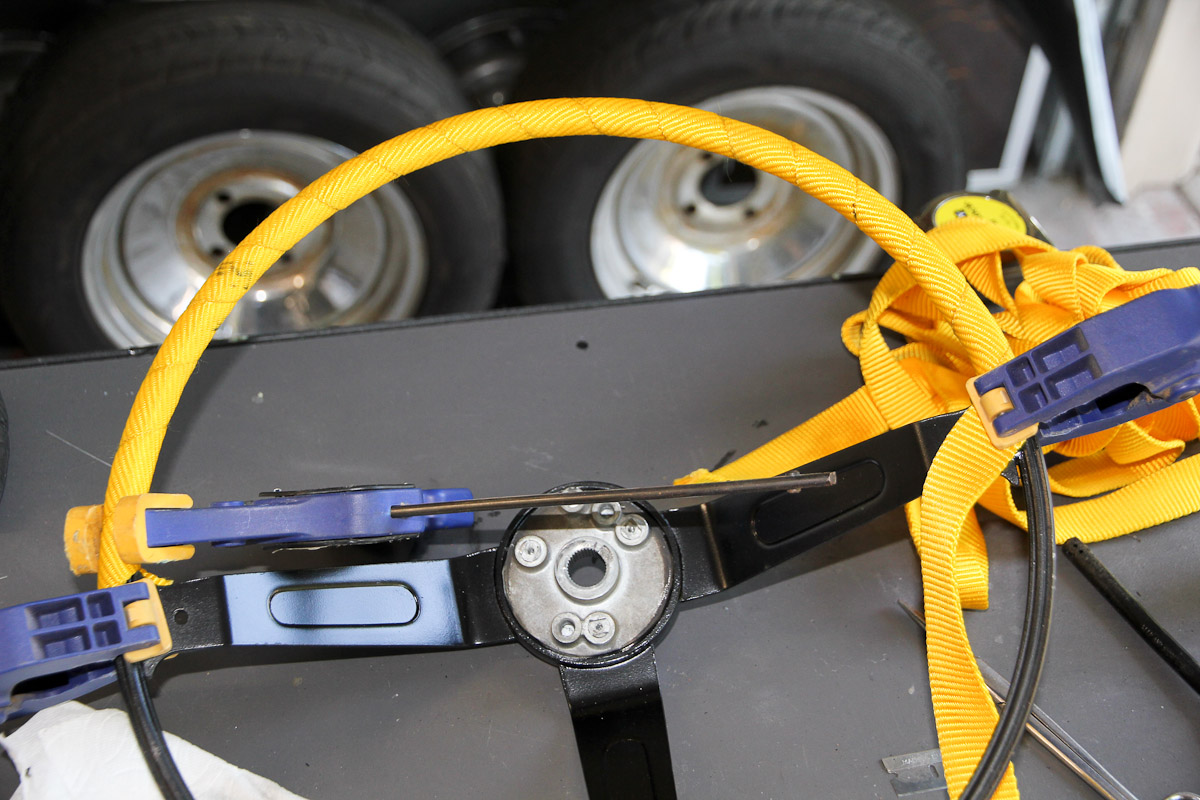

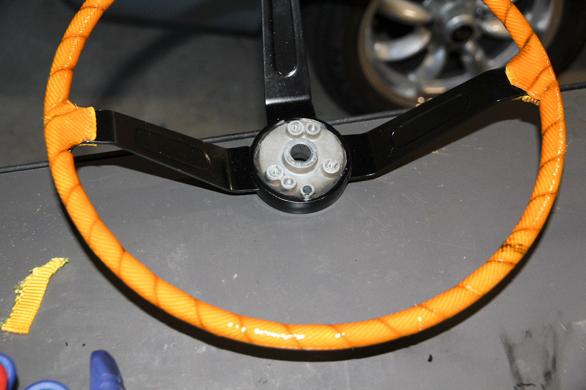

It seems to be working so far. When I tried for the second layer, it was feeling a little less solid than I'd like, so I soaked it with resin.
I need to do at least one, and maybe two more layers of the webbing, but I'm at a bit of a crossroads now: I can't decide what shape the wheel cross section should be. Round would be easiest. My G has more of an oval shape, which I never bothered to notice until I started working on this project, and it seems that's how many wheels are shaped. I could also try and put in the finger indentations, but don't have any idea how I would go about doing so. I also don't know how thick I want to make it. Some unexpected decisions to make here.

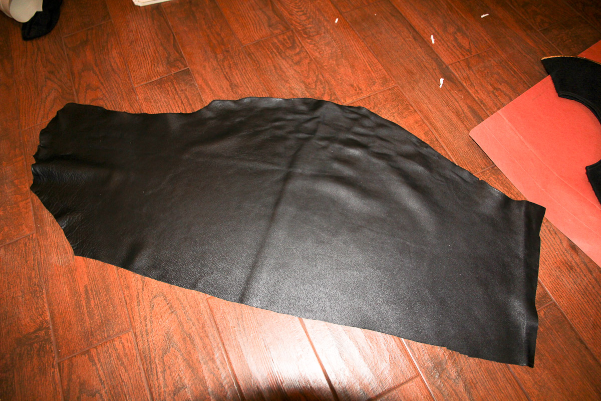

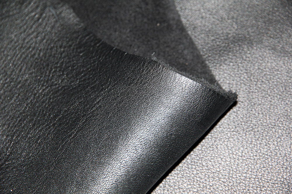

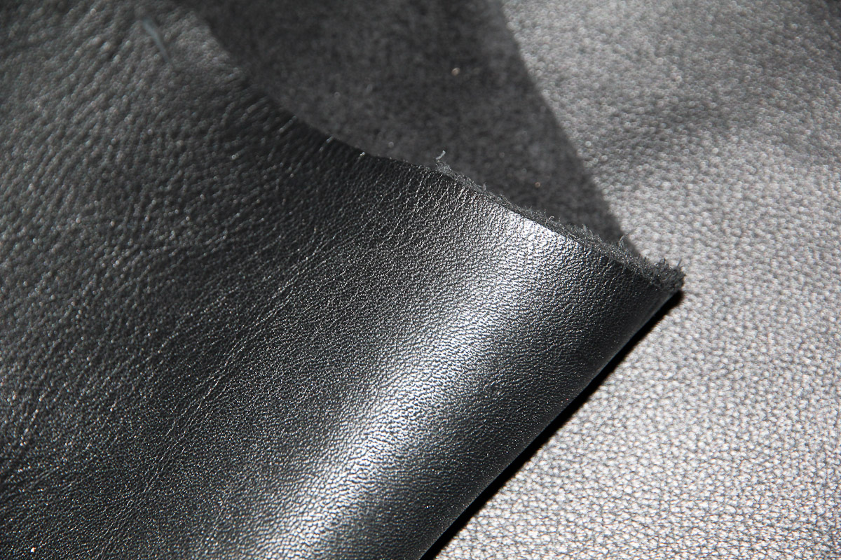

Ultimately, it'll be covered in leather. I got this nice piece from Springfield Leather Company for $35 shipped. So far, it's the only expense I have in this little project.
Every now and then I stumble backwards into something that makes me feel more clever than I probably am...the webbing qualifies here. Once the webbing is done I'll wrap it all with something like bicycle handlebar tape. Then I'll sew on a cover. That'll be the tricky bit.

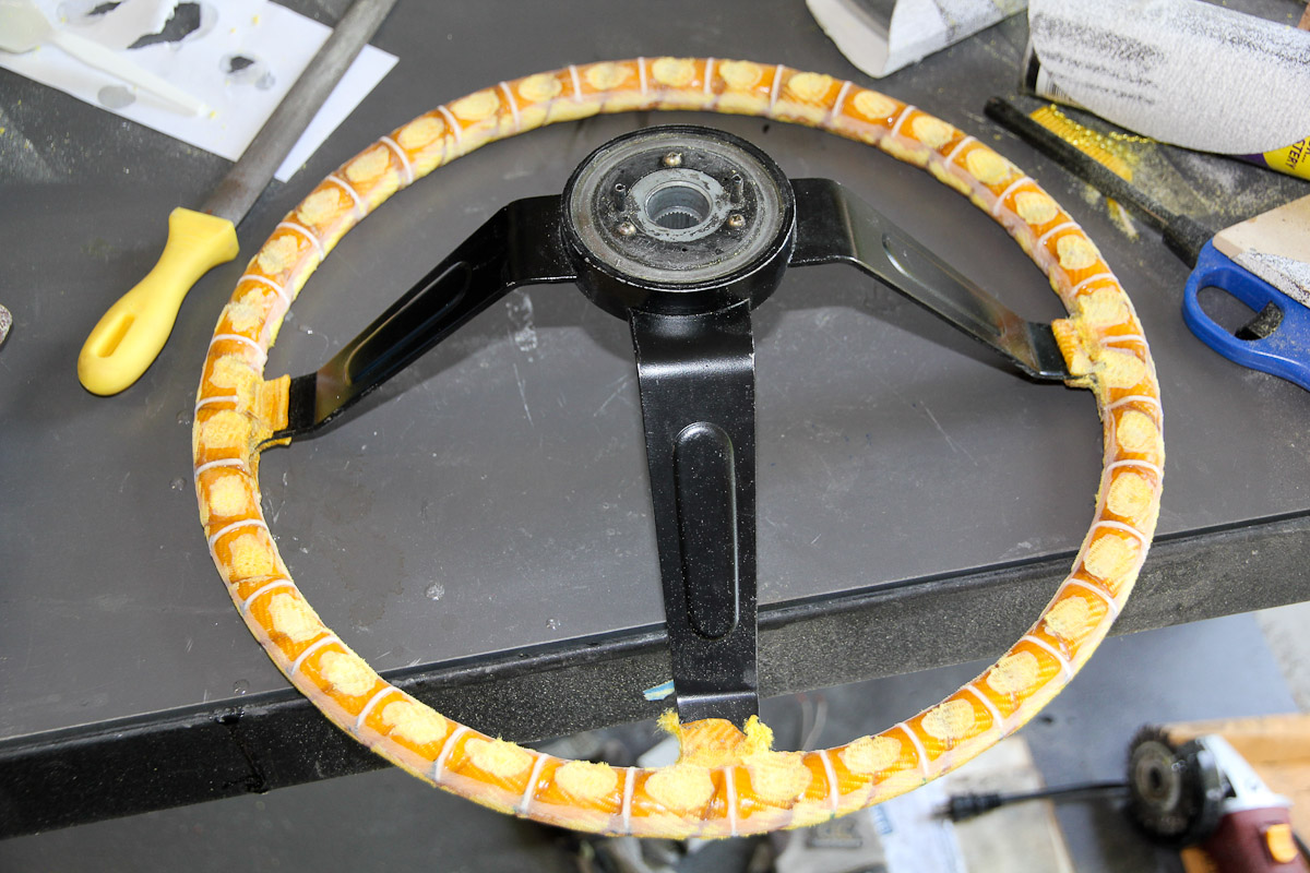

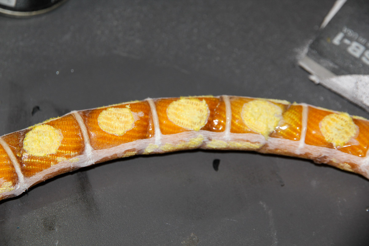

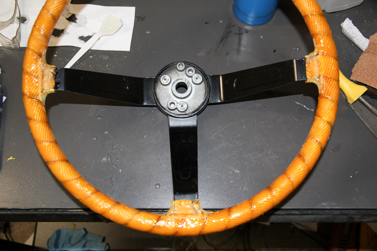

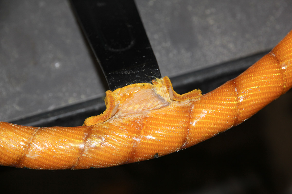

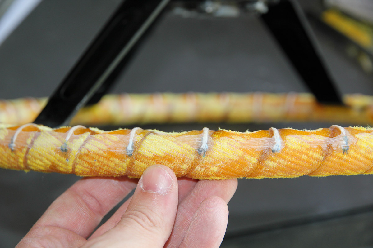

I had one wrap of the webbing at the last update, so added another one and put a coat of resin over it. That gave me enough of a base to work from, so on to the finger indentations on the back. First measured the circumference and then marked off 36 lines and tied kitchen twine around each one, which I hoped -- too optimistically as it turns out -- might do much of the job in creating the indentations after coating it with resin. It didn't, but the profile did help in keeping the indentations centered.
I quickly gave up on trying to make any kind of jig and did them all by hand using a Dremel tool, hand drill with a couple different sized sanding drums, a couple of files, some hand sanding and a propane torch. For all that effort, at least they came out pretty well. By the way: doing 36 of anything is terrible.
The I had to dress up the spokes a bit and do some final cleanup. This part of the job is finally done!

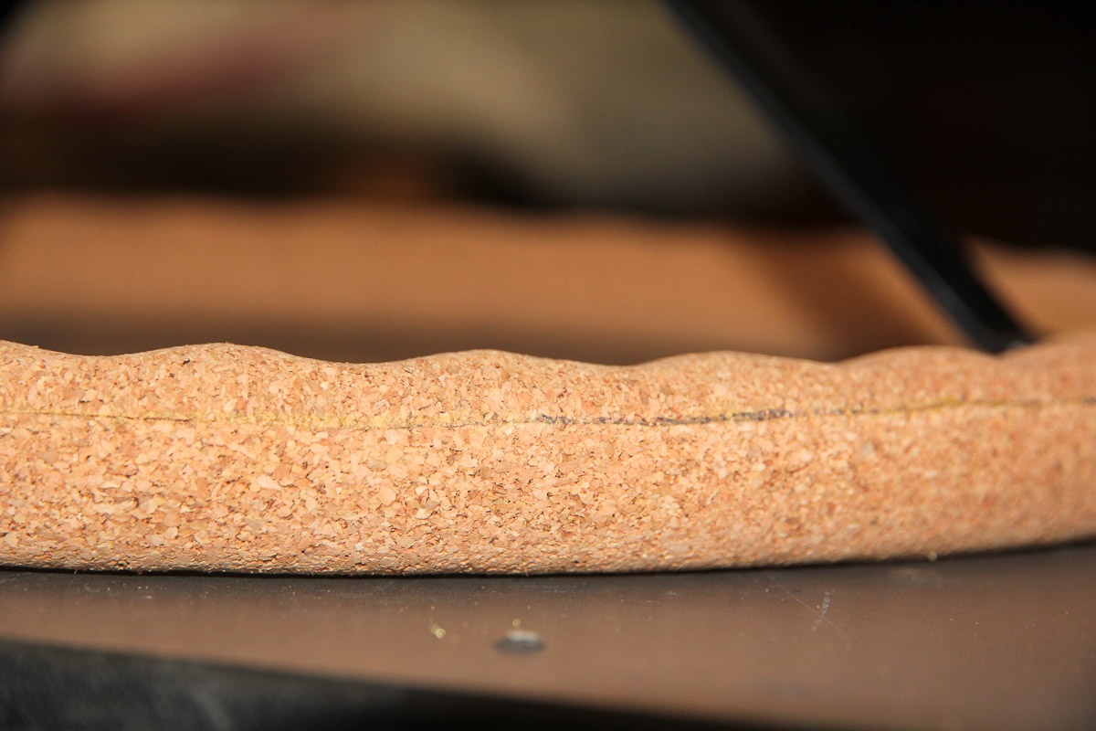

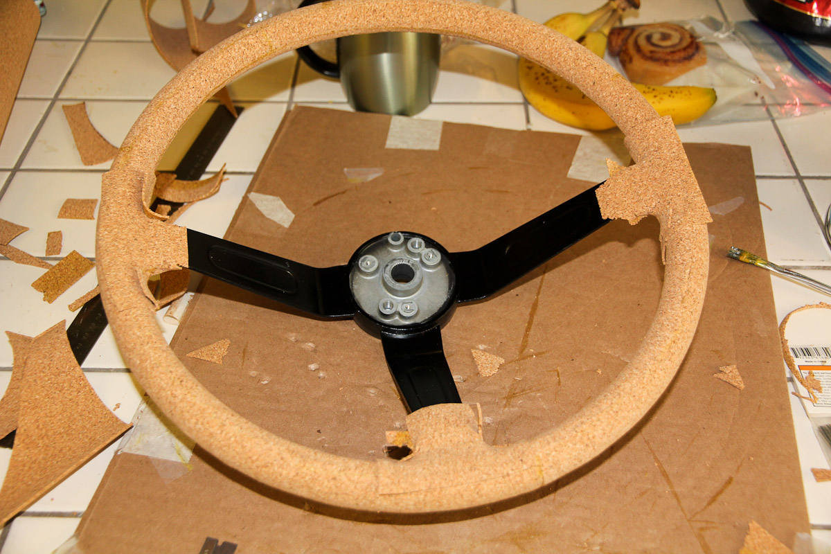

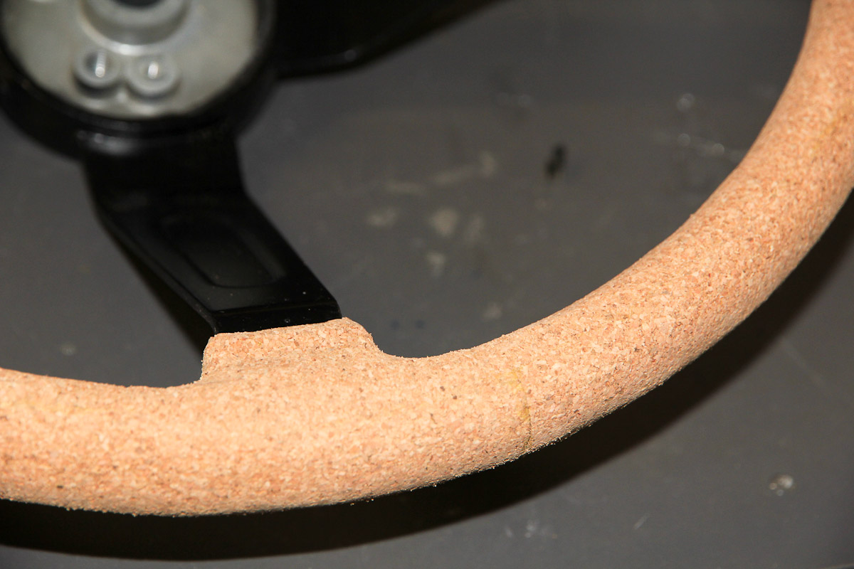

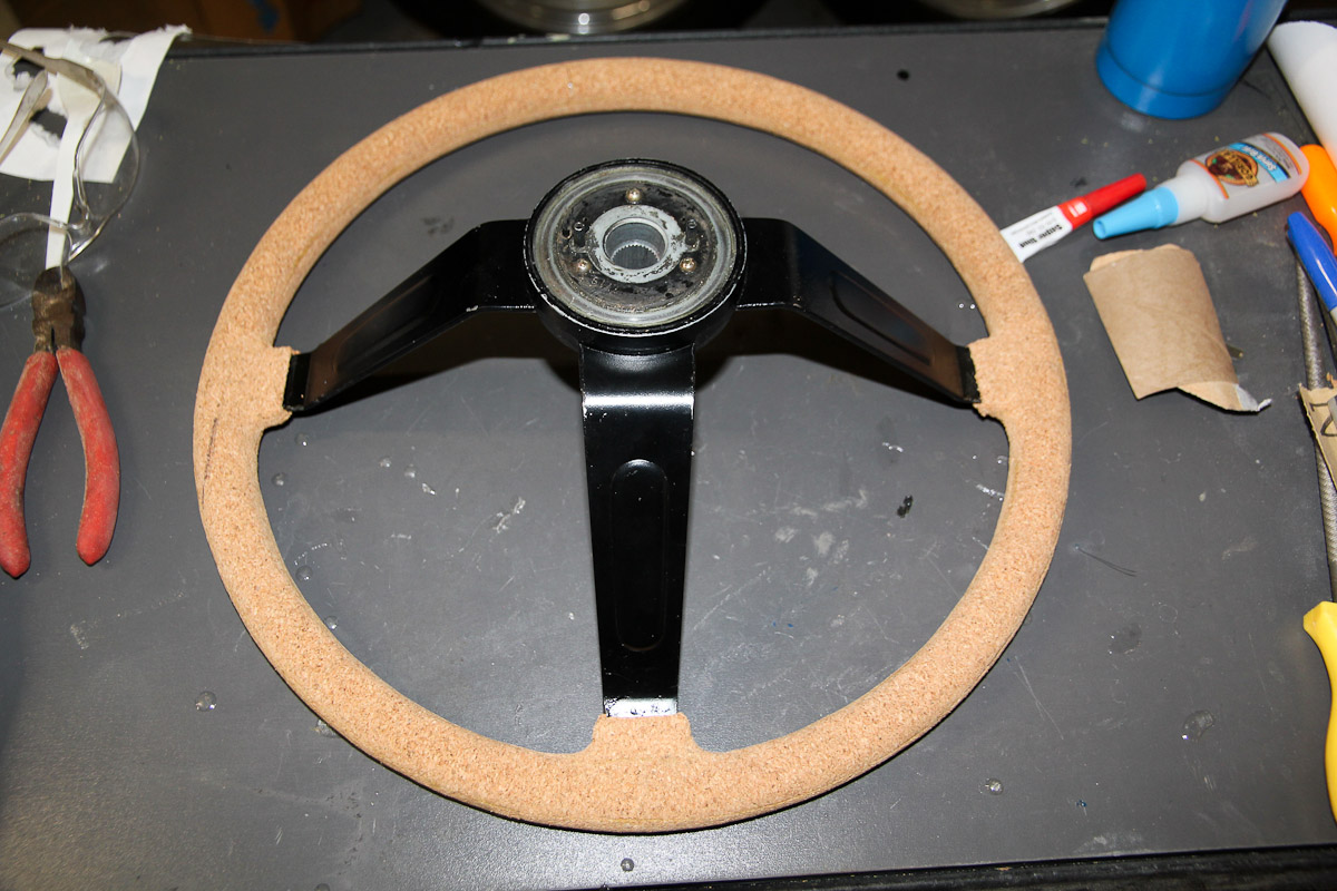

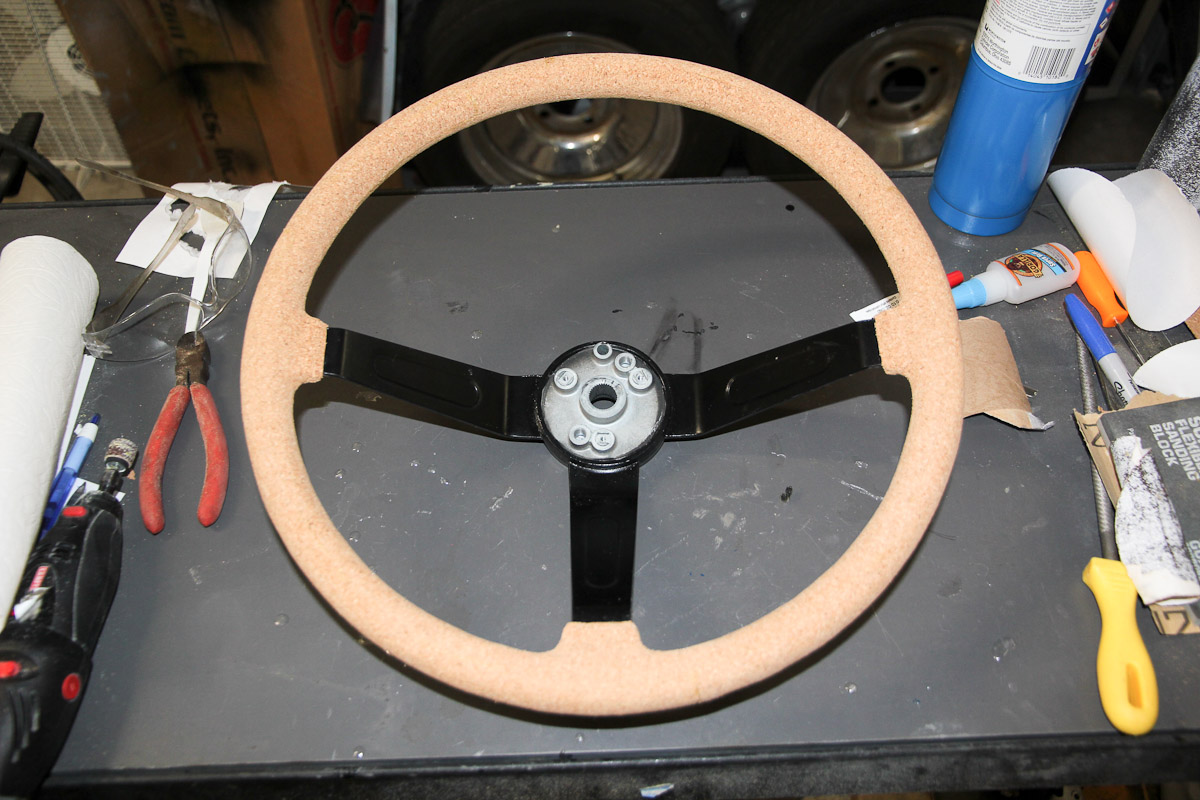

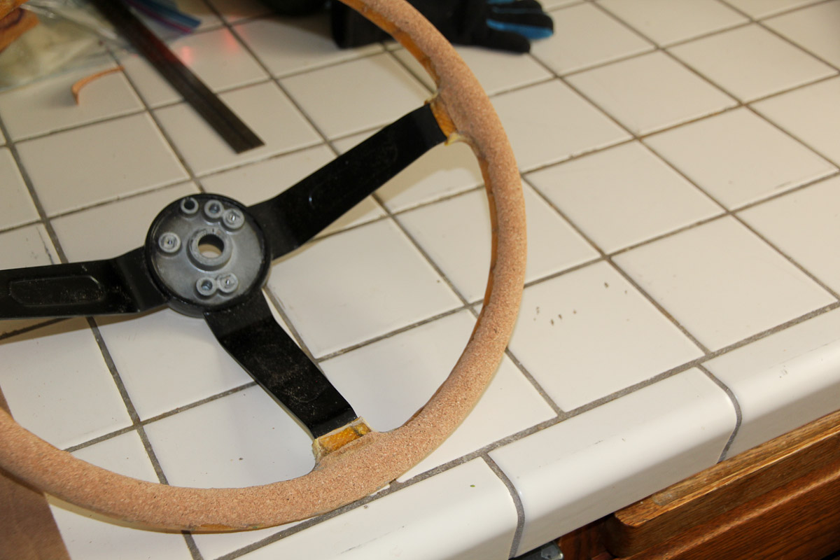

The webbing would be way too hard if I just put the cover over that, so I had to cover it with something that has some give. I thought about bicycle handlebar tape, but it's 1) rather expensive, and 2) has tapered edges that would show through the leather. Good bar tape is cork based, so why not just use that? Turns out OSH sells 1/16" cork sheets for just $10. Onward! The profile on the spoke junctions ended up being a little flat, so first I padded those. Then I wanted to bring a little more height to the wheel profile since the indentations knocked a lot of it off, so I glued up a ring on the top face. My original plan was to wrap the whole wheel handlebar style, but the cork isn't flexible enough to work around in the indentations, so I wrapped the whole thing in strips, then sanded anything that needed a little help.
Considering that I haven't done something like this before, that I mostly used stuff laying around my garage, and that the internet as a whole seems surprisingly lacking in information on steering wheel restoration, I'm pretty much thrilled with the results so far.
