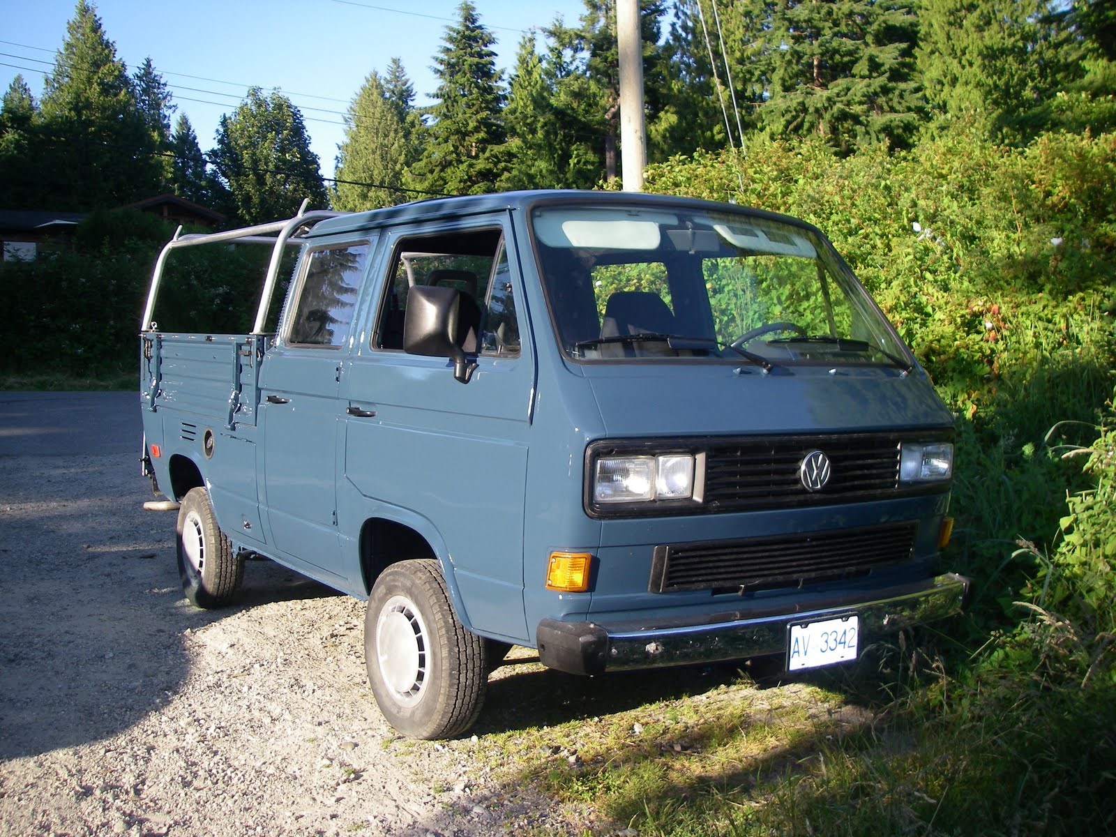

I still don't have a color, but had a pretty productive weekend nonetheless. The three blues I had were BMW Santoriniblau, Rover henley blue, and Alfa polizia blue (in that order on the first picture). In the shade (first picture) they looked...not bad. In the sun, not quite so much. My wife and I both liked the henley blue in the middle the best, but in the sun, it kind of washes out and starts to look a little too close to pastel.
Photos are of colors on cars are hard, but this Mini in the same color is pretty true to life, and it's just not quite what I'm looking for.
After all this, I came to realize that I want a darker color that has more green and less red in it. It's down to WV's dove blue and slate blue.

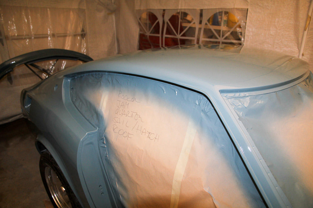

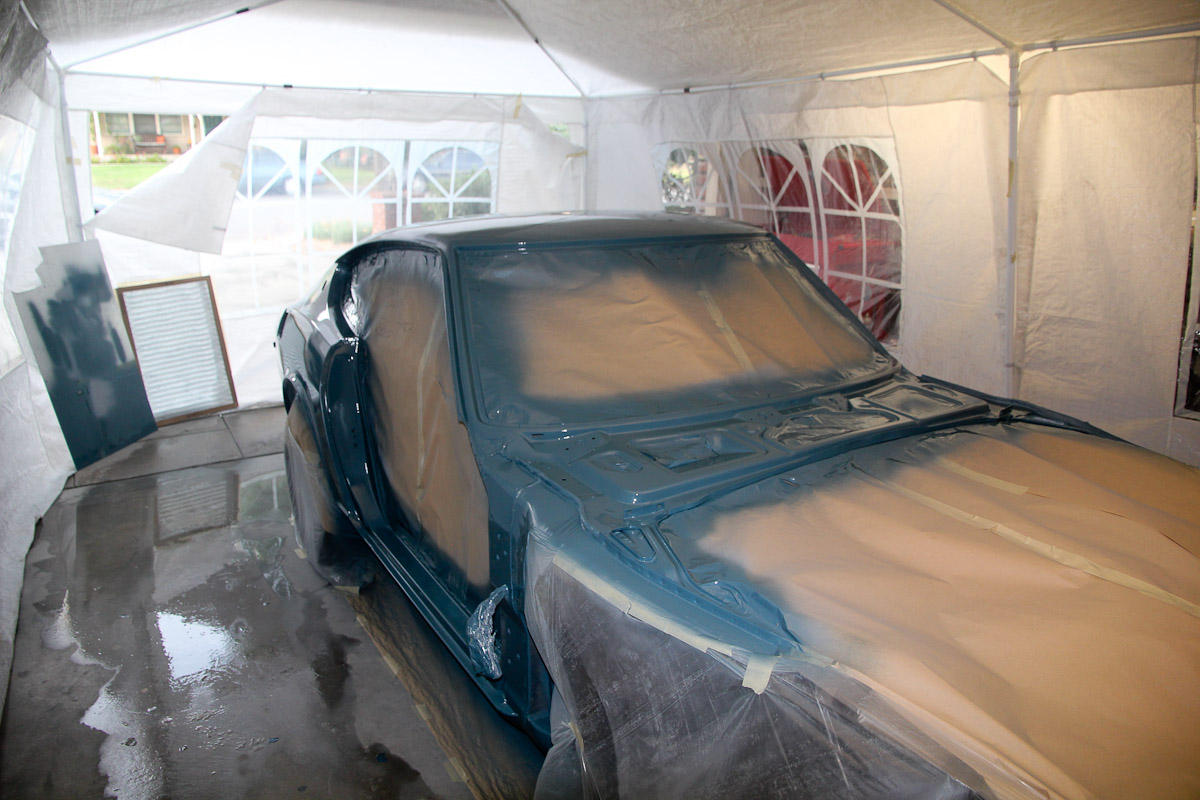

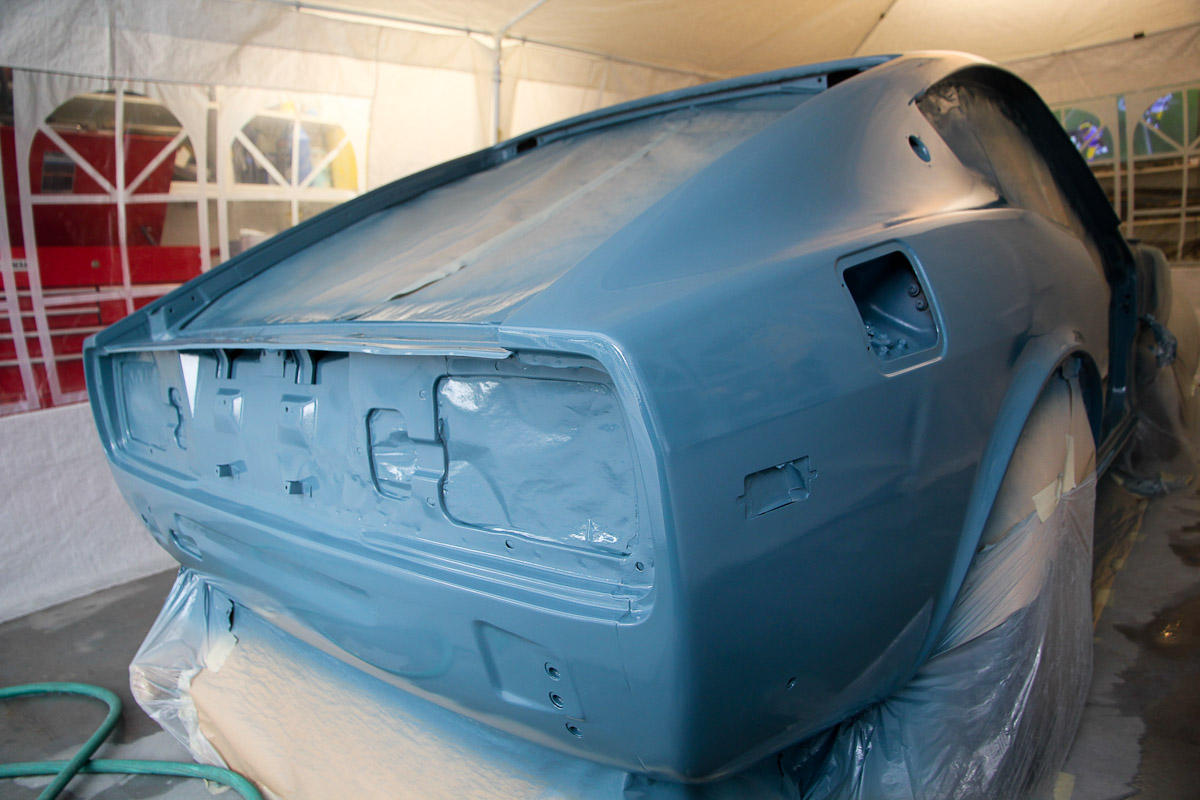

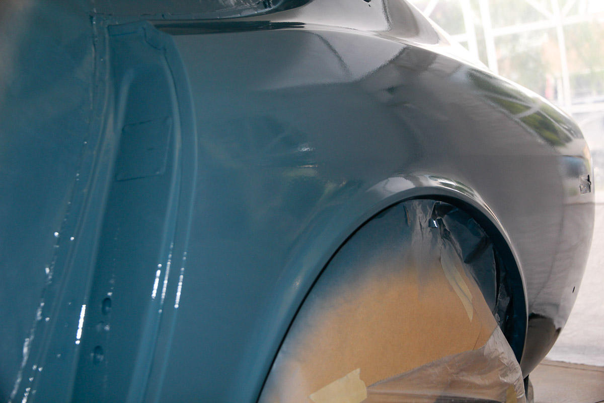

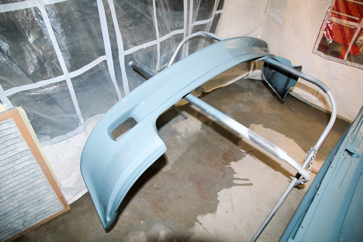

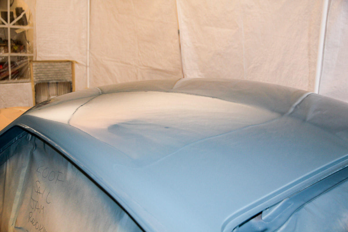

The shell is painted! Also the air dam, but that's less exciting. One coat of epoxy as a sealer, then 3 coats of color. I went with VW's Dove Blue (at least a version of it -- seems like there's some variation out there). Between the color temp in the garage (cloudy + flouro lights), camera flash, and Lightroom processing, I'm not sure any of these pictures are getting the color right, but the rear quarter shots are probably closest.
So far, pretty happy with how I did. My test panels had a fair amount of orange peel, but with the exception of the driver rear quarter, I got the paint to lay on pretty flat and without runs. Body work looks pretty good, but I'll know for sure when I can roll it out into the sun. For now, I've got it in the garage with a space heater keeping everything warm.

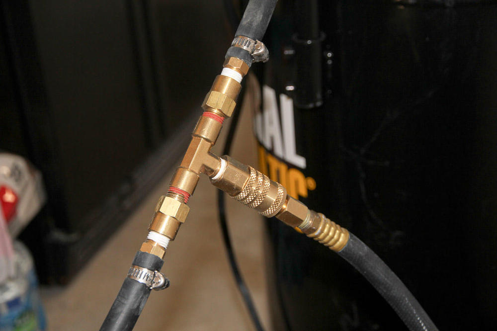

Also, I gotta give a shout-out to some guy on one of the auto body forums I read who had advice on compressors. I don't have a 240 volt outlet at my house, and can't add it as a renter, so all those threads that say "just buy a bigger compressor" aren't that helpful. But connecting two cheap-ish Harbor Freight units with some check valves did the job pretty admirably! The Devilbiss gun wants 13 CFM, but it felt like it was getting enough air the whole time.
Business trip to Vegas at the end of this week, but hopefully I can do all the parts on Sunday. Woo!
