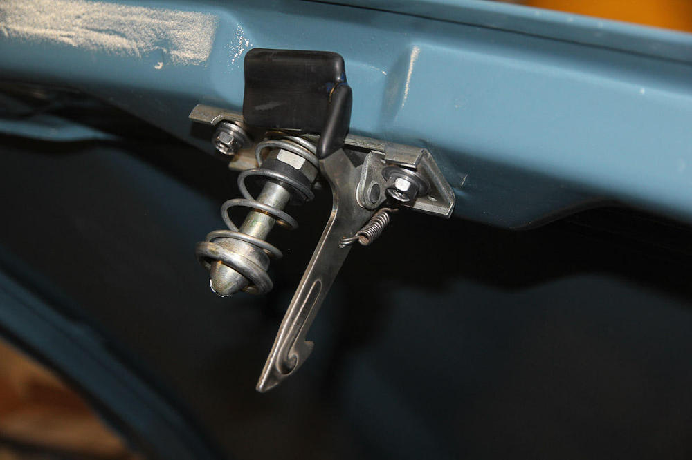

Windshield Wipers and cowl
The wiper linkage was a dirty mess and tough to move. Everything was taken apart, cleaned thoroughly, and re-greased. I cut some new washers from leftover felt that I've been holding on to for about a decade (I knew I might need it some time!). While I was at it, I brushed some black Rustoleum on the cowl and the wiper motor bag.

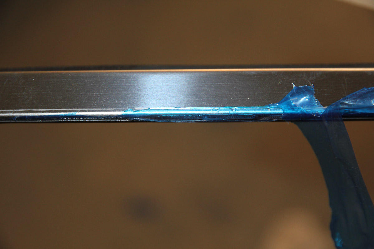

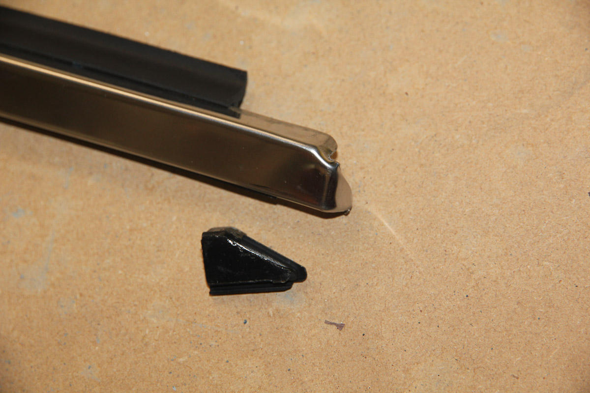

Cleaning things and polishing the shiny bits

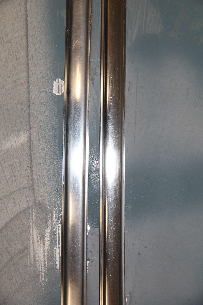

All the nuts, bolts, and other miscellaneous hardware pieces were cleaned up as much as I reasonably could with a red scuff pad, wire wheel, or buffing bad. One day, when I run out of projects, I think I'll try re-plating some of the hardware. Meguiar's 105 did a great job buffing up the stainless trim pieces. My old Black Dragon order also included a new set of outer door window trims. Can't say I'm super happy with them: the tips were bent in transit, the protective film was cut badly and super glued on, and to top it off, don't seem to fit very well.

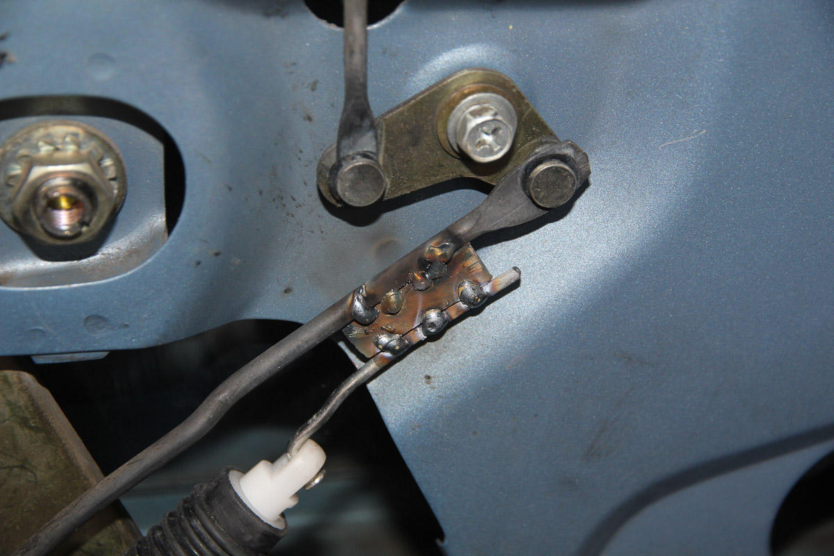

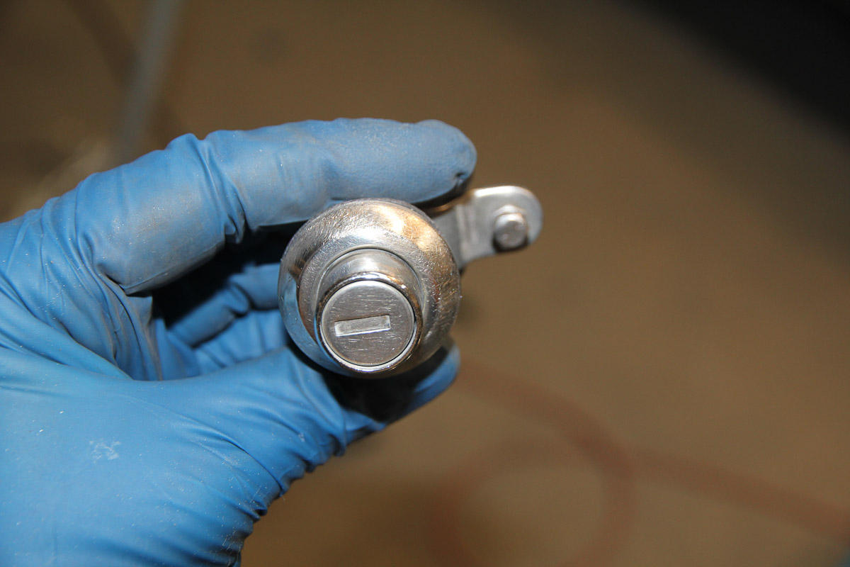

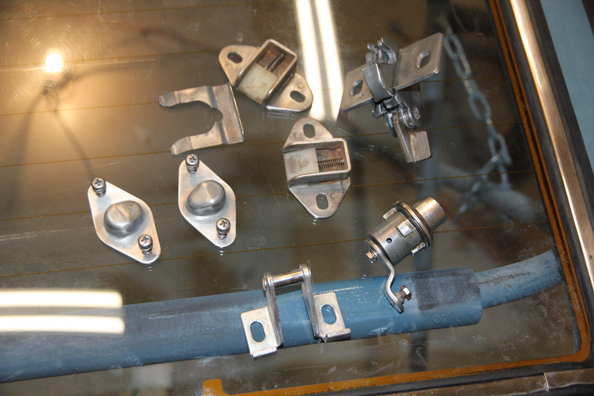

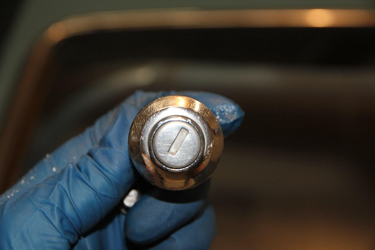

Power Locks
The power lock kit has a soft zinc block that connects the actuator rod to the door rod via set screws. It would always fall off. Never more. Please don't judge my welds.

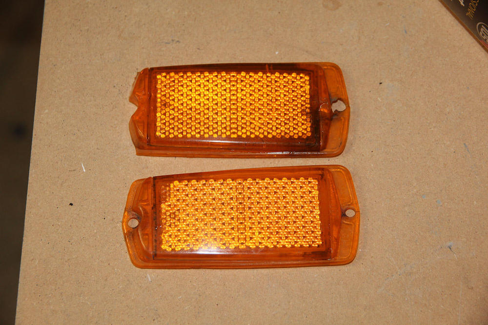

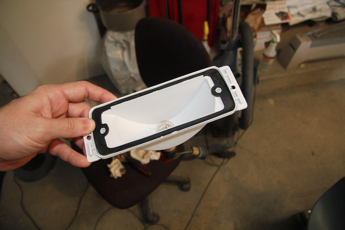

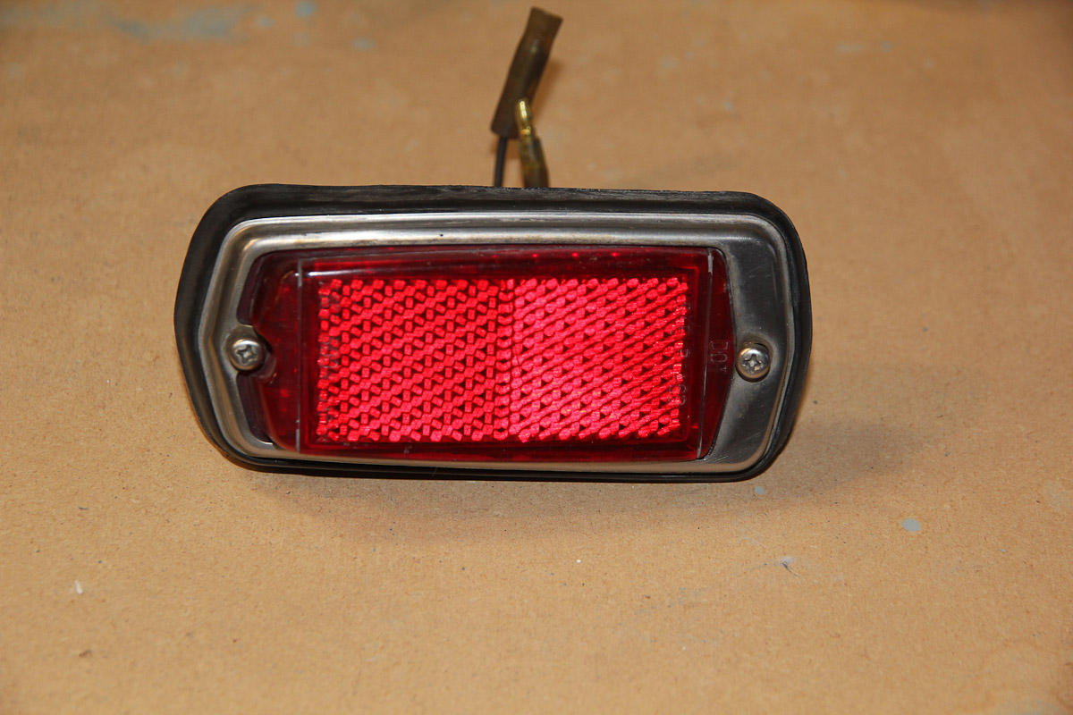

Lights

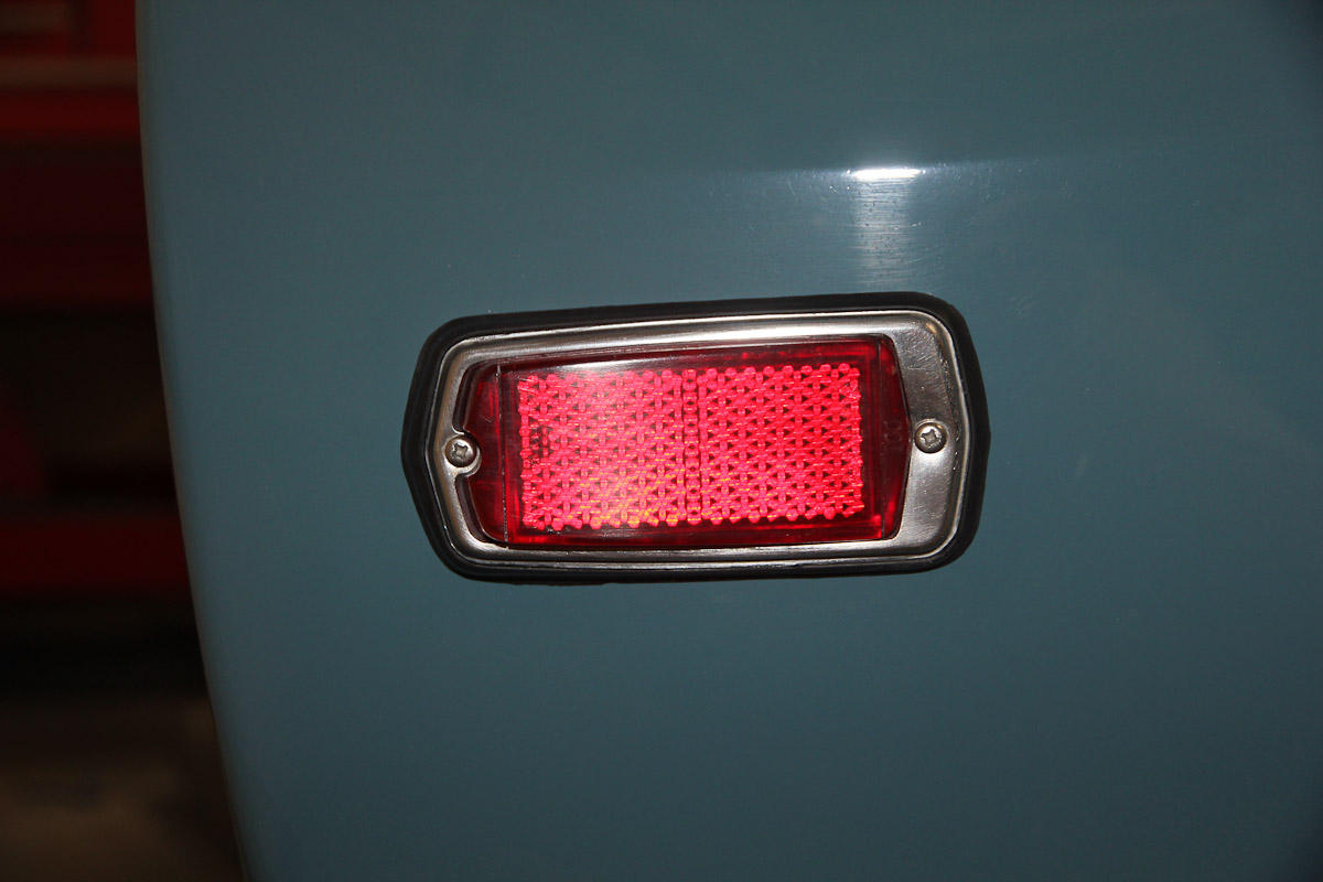

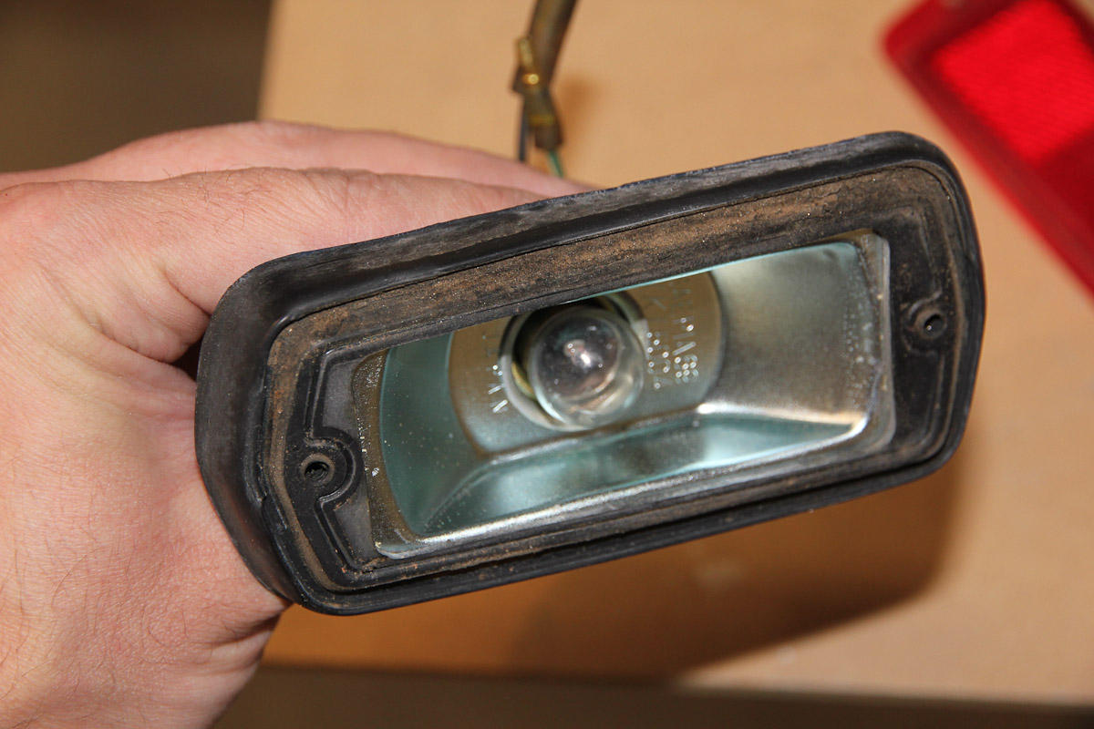

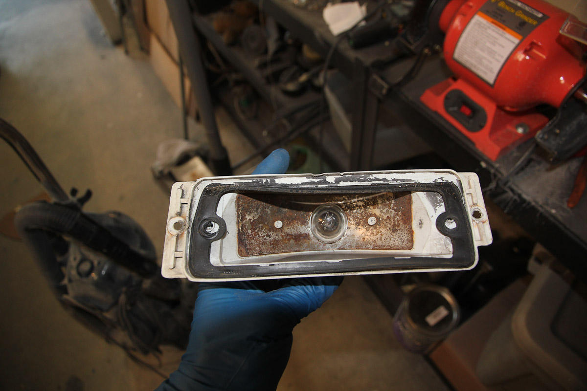

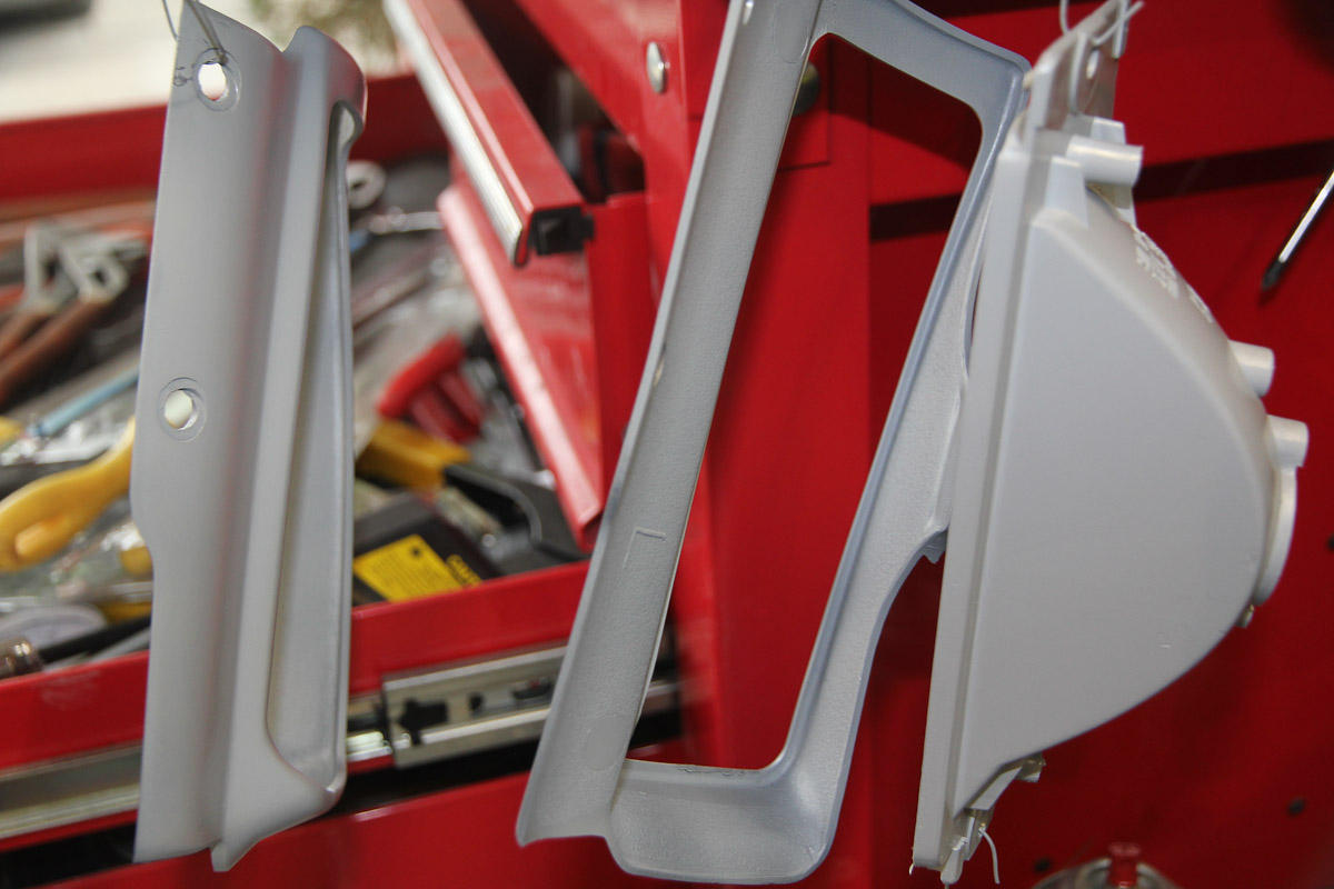

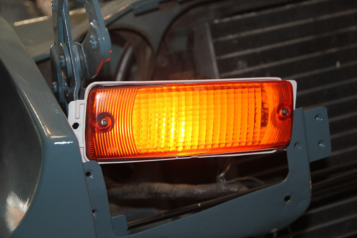

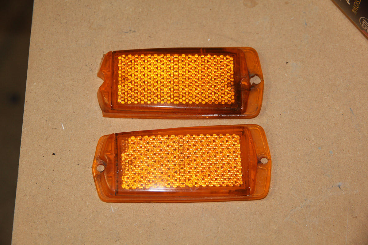

The marker lights were all filthy, but mostly just needed a good cleaning Three out of four are passable, but the front lens on one is a mess. Alt least it's only $30 for a pair of replacement lights. Headlights were cleaned up too. The turn signals needed more attention. The reflectors were rusted, the housings were dirty, and the paint on the surrounds was coming off. I still had material left from the paint job, so everything was cleaned, sprayed with adhesion promoter, epoxy, then rattle can white on the housing, and metallic gray on the surrounds. White is still plenty bright, so rather than trying to repair the reflectors, I left them out entirely.

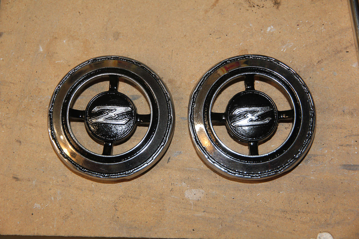

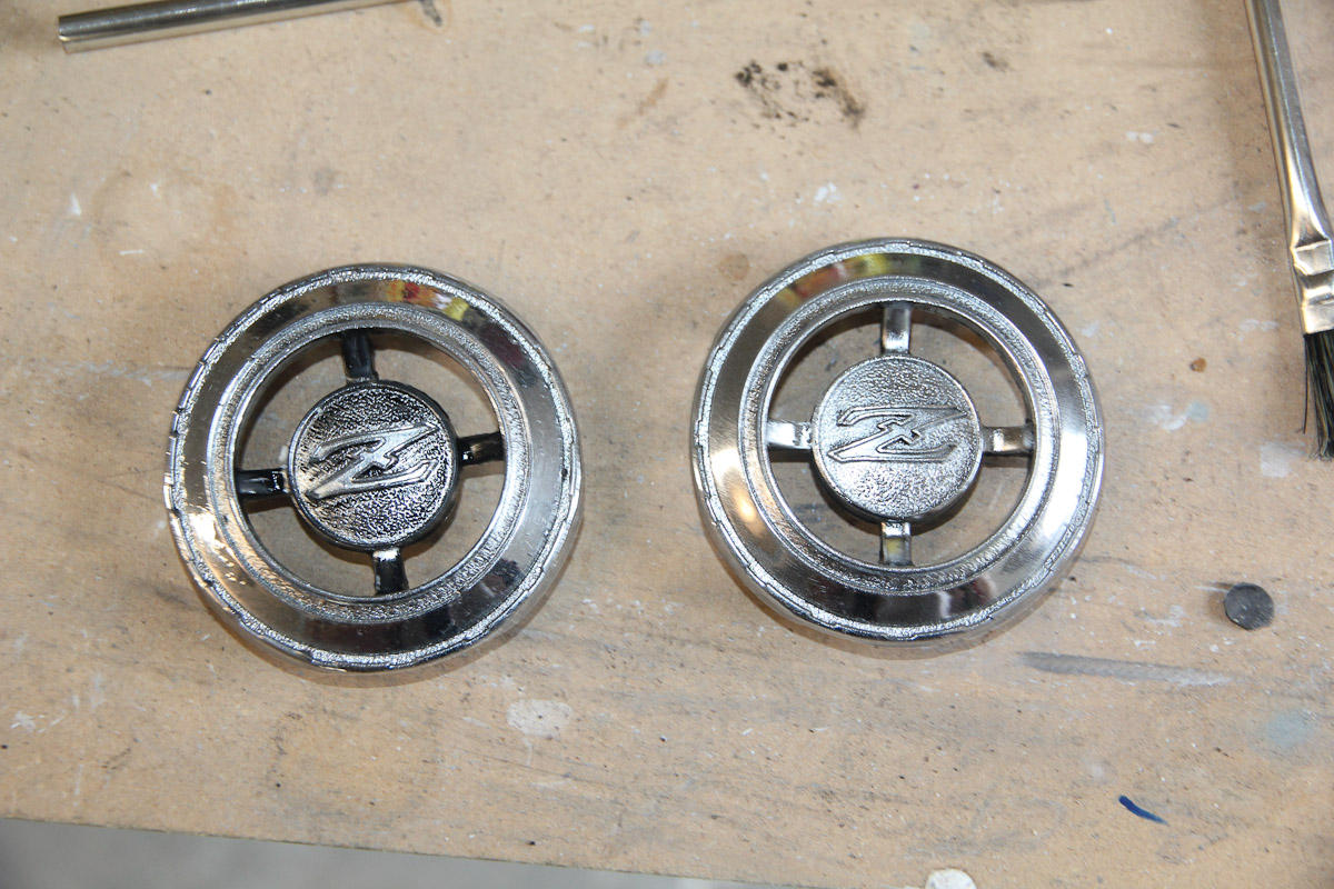

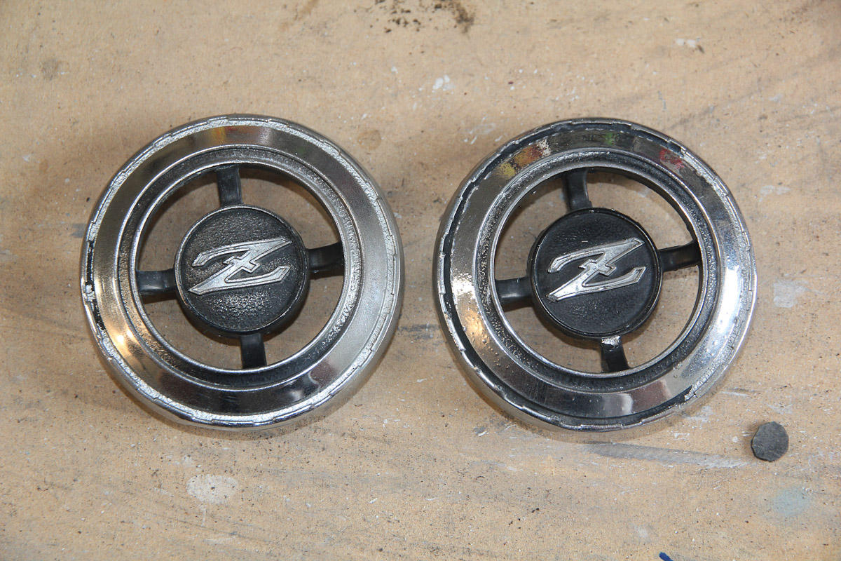

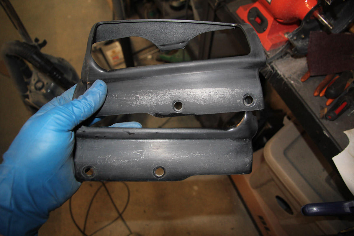

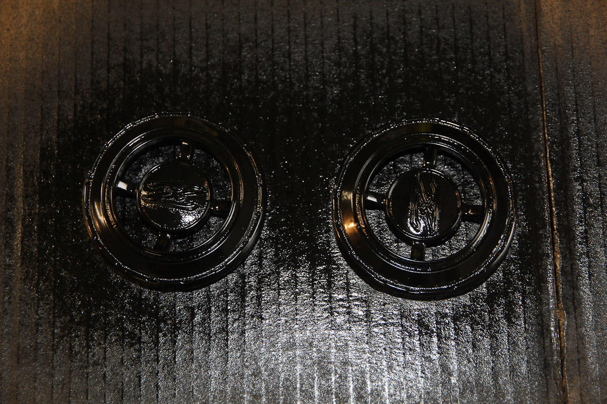

Badges
The only badges I've left on the car are on the vents. Mine were pretty rough. Replacements aren't terribly expensive, but I'll salvage what I can. Removed as much of the old paint as I could, then sprayed with some Rustoleum, and scraped off everything that should be shiny. This'll do; I'll save the hundred bucks for something else.
