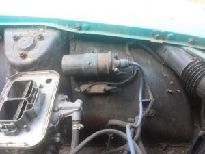

post-22019-0-24065200-1431296731_thumb.j

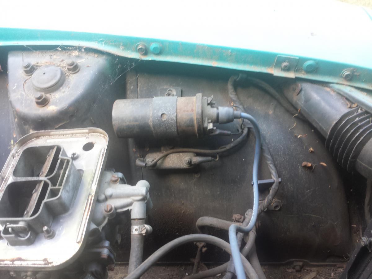

Do you see anything wrong in this picture?
Was messing with the car some today, voltage would be good on the coil with the points closed then weird then good...
Finally looked at the gap and they were scorched. A little sandpaper to clean then up and it sparks like it should.
And the answer is.......
No Condenser. Will have to locate one...
