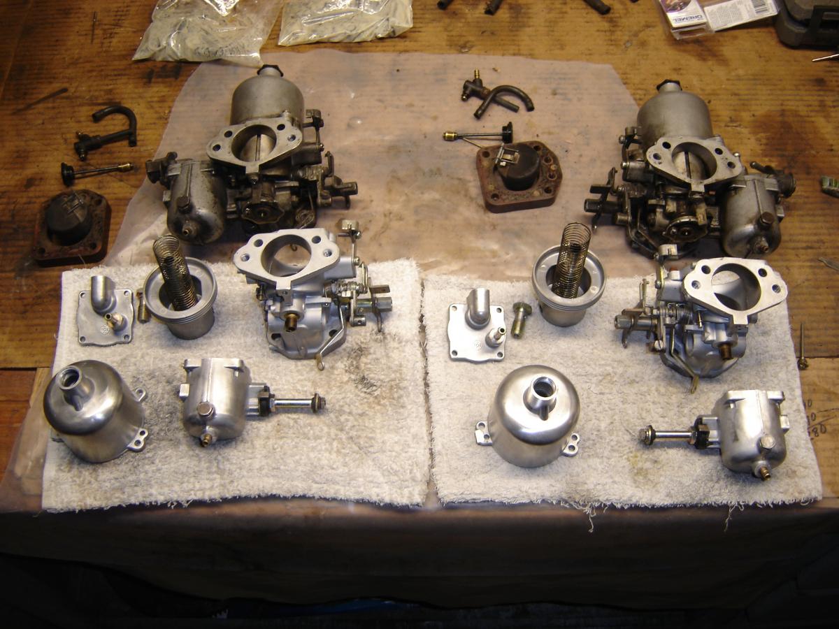

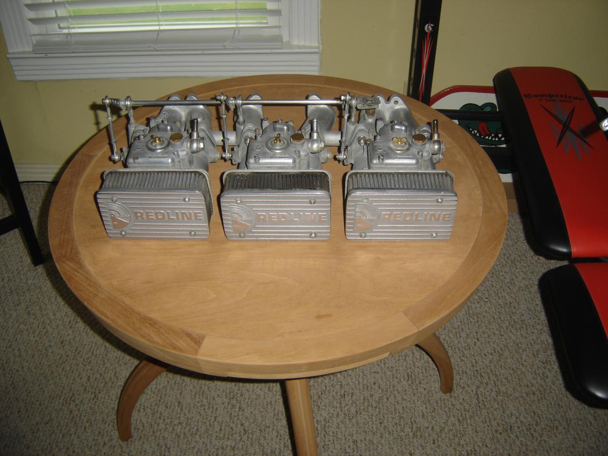

That soda blasting works great on the aluminium.  Messy as hell but it'll all blow away with just the air gun.  It'll make paint disappear too.  Give it a try but make sure your air compressor doesn't have any moisture.  A way to reduce the amount of soda be sucked up is to put a small nut into the pickup end of the tubing, a little less mess.
Here's some carbs I did with the same DIY setup as Chris mentioned above.
