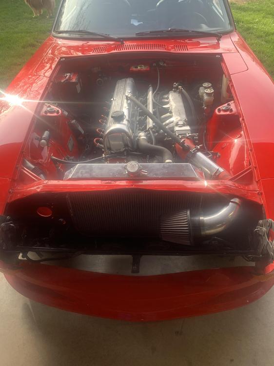

So yesterday was first run . Didnā€™t even bother to install the hood , bumper or even the mirrors . Hell- didnā€™t even wash off the dirt .Ā
All I can say is WOW - amazing power ! The grunt starts so early . Never got over 5k and only poked at WOT a coupe of times . Not used to breaking tires loose so easily . Only got 25 miles on it , but I was smiling after I got over initial anxiety .Ā
Today I look it over and check things so I can play tomorrowĀ

Well I canā€™t keep up with what I post anymore . The 3.2 is now running with the MN47 head again . Since the last post I had put miles on the p90 while I was fixing a 71 for a customer . Meanwhile the MN head got new Manely valves and bronze guides . I swapped it back Iā€™m with the proper head gasket thickness and should be back to 10.5:1 . Cylinder pressure is around 220 with compression tester .
Pistons were pretty much broke in , so just a tune and start flogging . I managed a Ā quick 0-60 time of 4.77 seconds . This is a beast motor . Itā€™s amazing how hard it pulls even in 4h gear .Ā
Dyno appointment is in November - everyone is booked up until then . Ā
