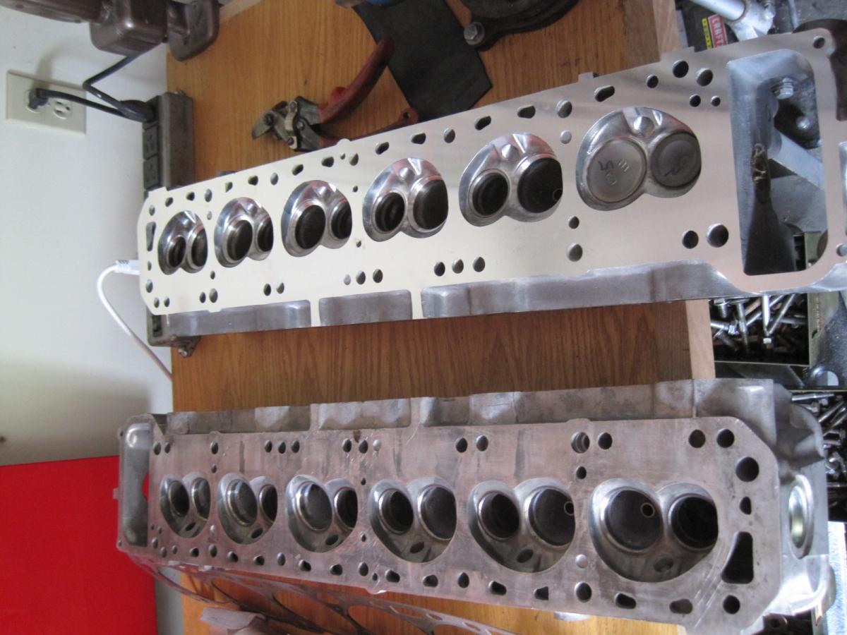

Finally got my MN47 back from the machine shop. Didn't expect the guy to tell me he took .012 off-eek!  The CR is going up as we speak. Looks like I need to get that burret on order and start taking measurements. I want to know exactly where I'm at on this.
The really good news was that everything cleaned up nicely. The one exhaust valve that was bent didn't ruin the guide!
Now rusty looks better than warpy. I had the warped head tanked so I could play around with a clean head. I still plan on trying to straightening it.

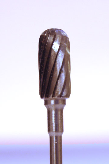

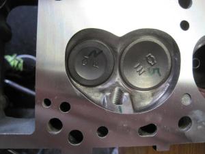

now for the fun part: you can get your dremel out and and bevel the sharps off the perimeter of the chamber (within the fire ring) to minimize potential hot spots.
then port match to your intake runners and clean up the gasket to match and you're on your way to goodness.

I use something like that , but sparingly. All the work on this head will probably be accomplished with sand paper type bits. Those carbide bits can grab a lot material if your not careful. I did use something like that for cleaning up my mikuni intake-bad castings. The "teeth" were clogged up with aluminum which was actually a good thing, so it wouldn' t gouge the project.
I'm figuring I'm down to 38cc right now, but there is room to open up around the valve curtain. that should gain me back some. might wind up grinding reliefs in the pistons which will get me a little more.
