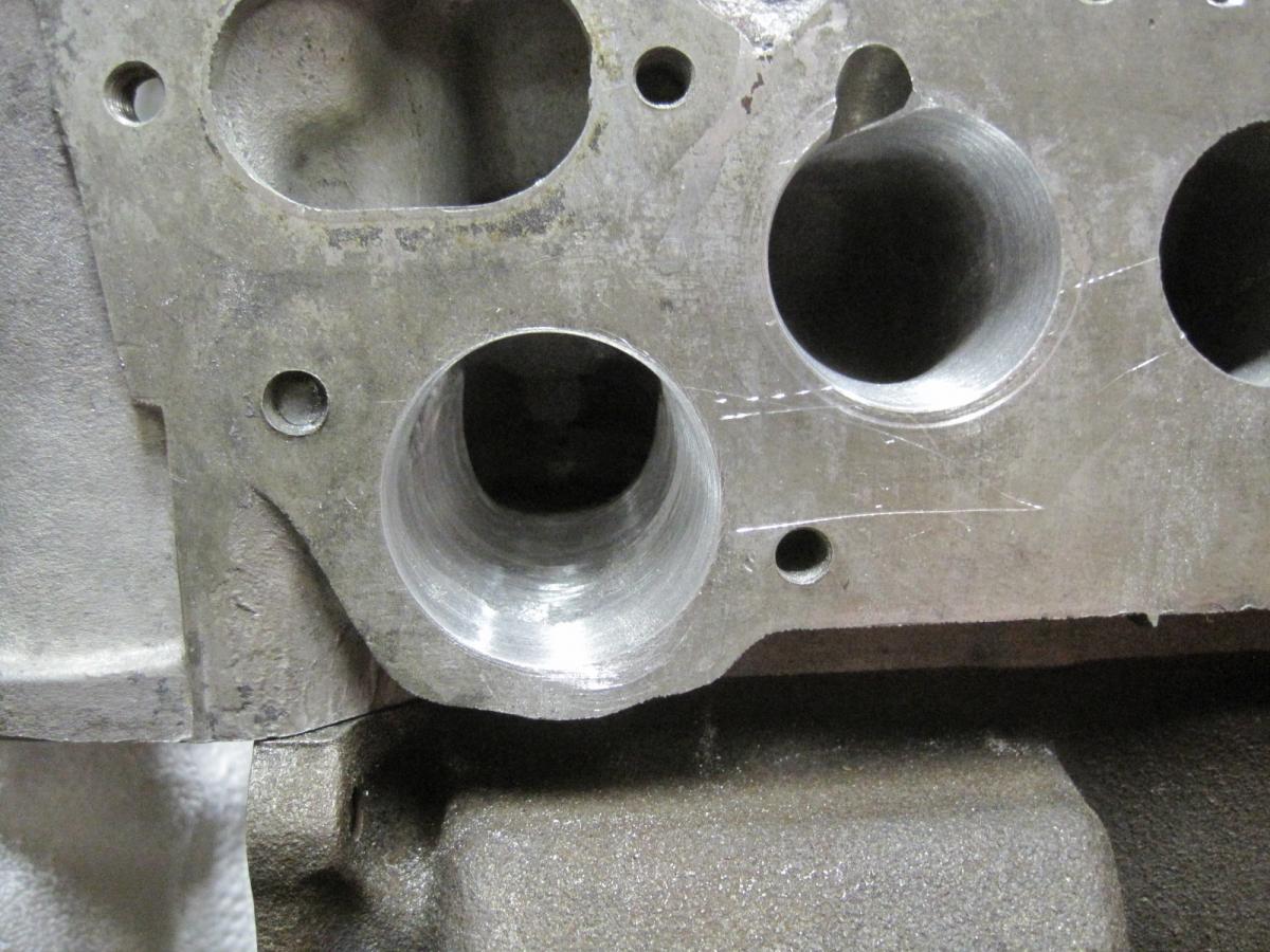

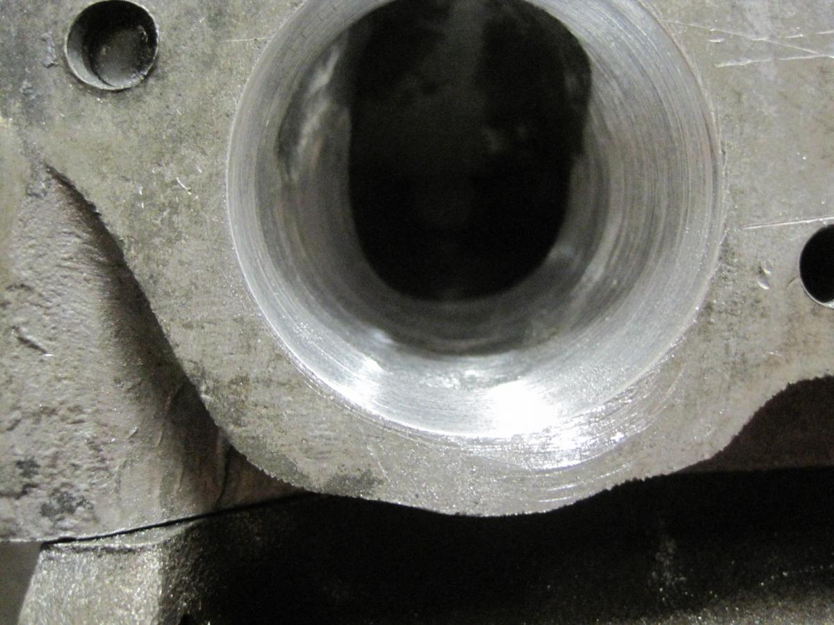

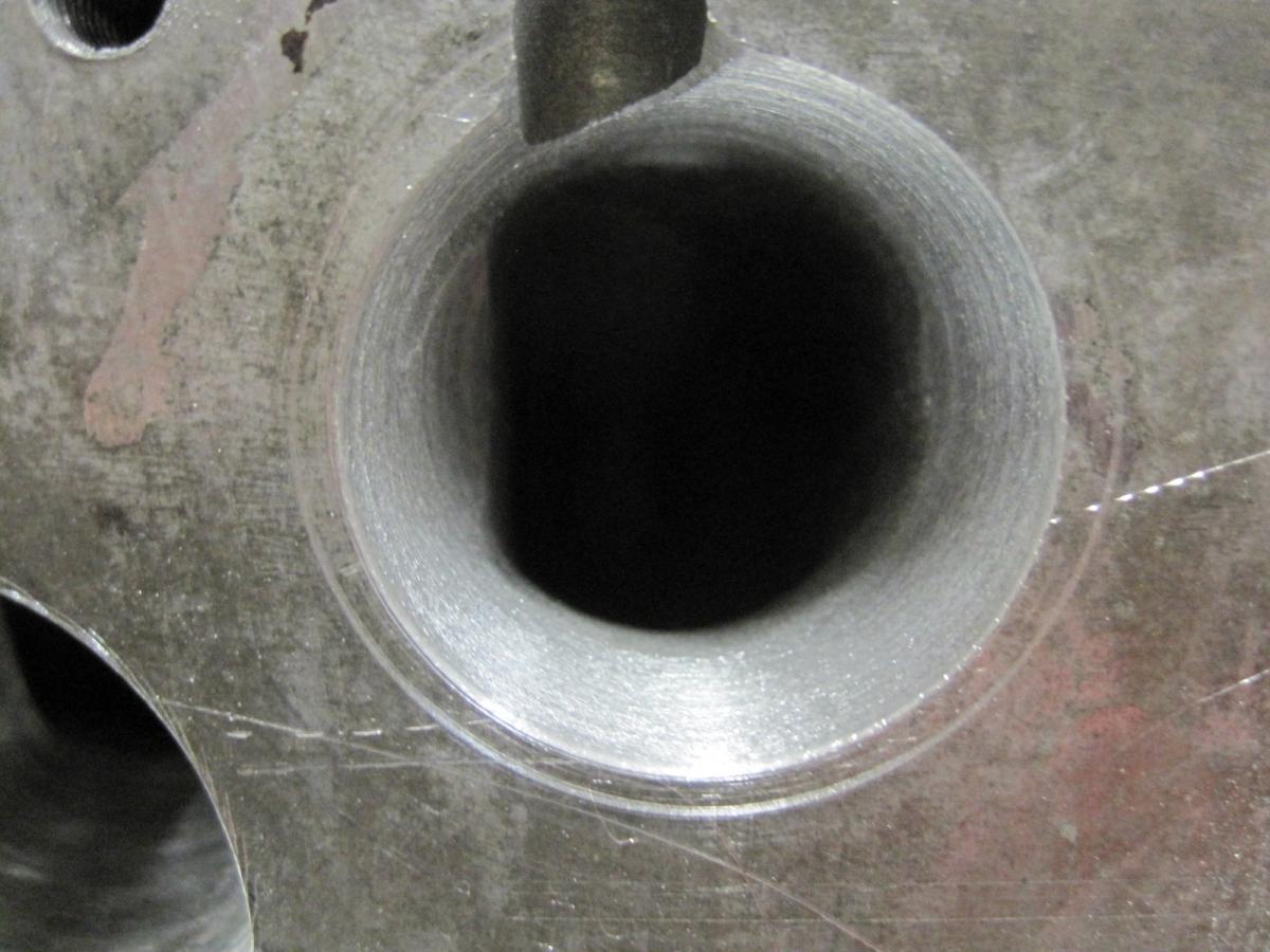

Messed with the MN 47 head today. It was more of experimenting on my head named "warpy", for it's .030 warpage. This is my flow bench head and
practice porting head. I also wanted to remove the liners to see
what's under there. I am curious if there is any usefulness for removing them and how much work was it.
I can say that the liners are in there pretty damn well. It took me about an hour to just get one out. I was trying to be somewhat careful as not to damage valve seat or guide or any surface. The liners leave behind a
lot of work if you are trying to make the port flow. Sharp edges and
raised areas for supporting the liner shells. I don't see myself trying
to use this head without liners, but I will try and make one port flow
without them.

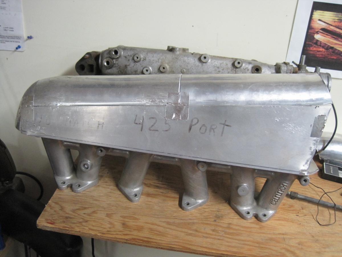

making porting easier. I have a FI intake in the works that has rather
larger ports -37mm- at the head, so I will need to open up a head to use
it.

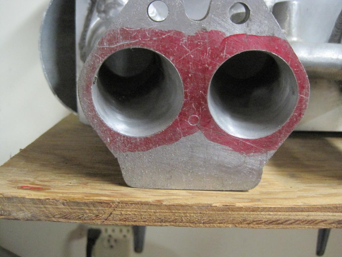

Hmmm... I like that Intake, Is this your own fabrication or did you buy it somewhere. If your own, are you making anymore and how much? TIA.
Richard
Richard,

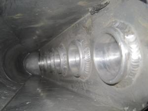

this was an abandoned project that I bought off of eBay . I'm surprised in my postings on here and hybridz that no one has claimed it. It was a very nice start to a custom intake. The runners on the cannon intake were tapered already from 44mm at the plenum and 37 at the head. All the welding you see was also already done and seems to be done very well. The original builder welded a piece of channel to the intake, and I have been finishing the round "topper " using 4" pipe.
the intake also came with 14mm weld on injector bungs which need to be placed.
The "nose " was fun to fabricate. In actuality I prefer doing this type of fab work more than any other.  Need a TIG to finish this out.
I probably will put a 60-70mm TB on this and run it NA .
SO MANY PROJECTS- so little time
I will post up pics of the head exhaust ports. Not sure anything will come about from removing the liners, but I had a spare head to try. The later MN47 heads had better casting support for the liners, so they retained their shape better and held up longer. If I was staying with a round port head, I wouldn't even mess with the early 47. Much better combustion chamber on the mn47

Haven't made much progress on the L28 part but have messed with the MN47 . After cutting on one for a while I think I found the port size that I am shooting for is 35mm(intake). It won't take much more than that without busting thru. That's a 4mm gain so I am pretty happy. I dropped the head off to a local machinist that has a flow bench and he is going to cut on it some more and do some flow testing. I left several chambers stock so we can do a direct comparison. I'm going with a 87mm and 89mm bore size. I figure most guys go over size when rebuilding. He is going to flow test with the 42mm intake and then the 44mm-again for direct comparison. The exhaust side is much easier , not a whole lot can be done.

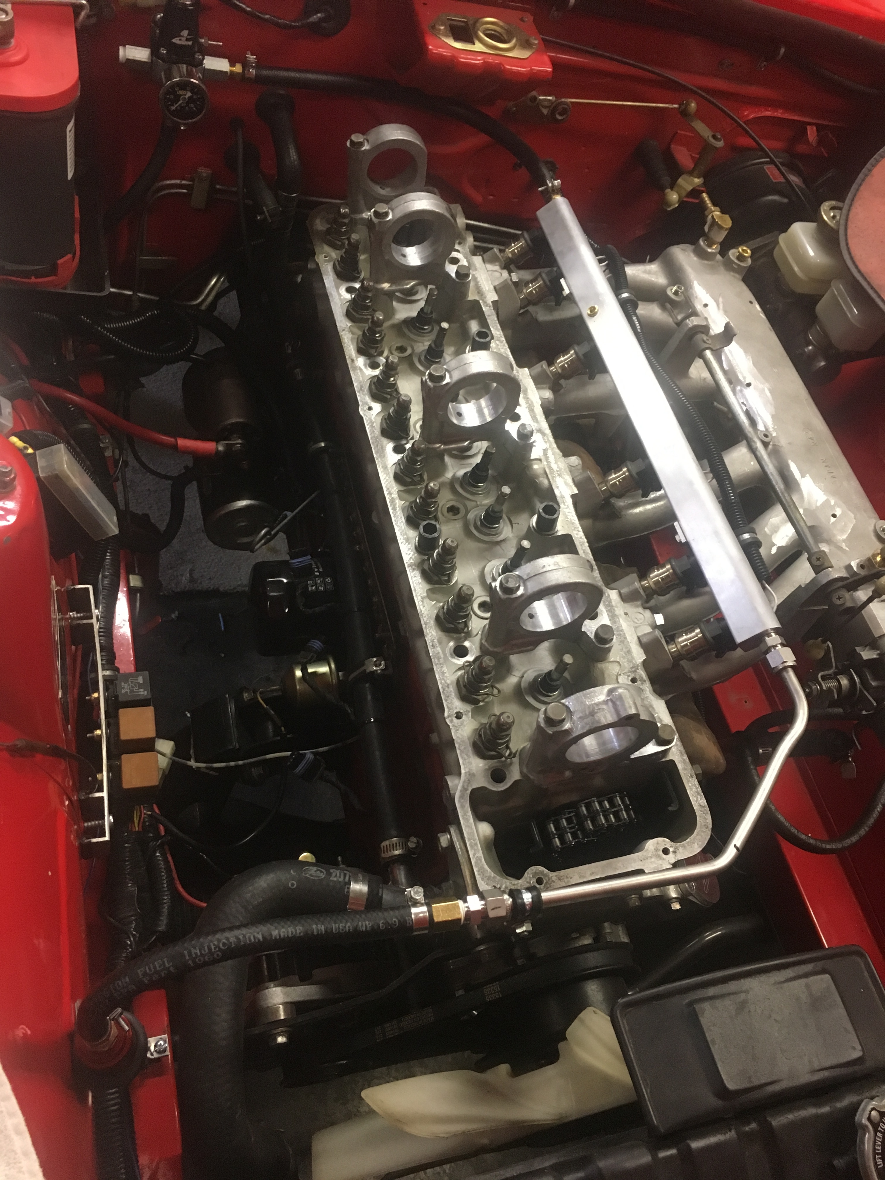

Since I have a plethora of these MN47 heads I am going to mount one on the L24 to get my FI conversion going. A gracious member here (Kenny Seo) basically gave me one of his that he had "beat" on pretty hard -including turbo charging. I dropped it off at the machinist to have pressure checked and cleaned to see if it was serviceable after it's 'Seo' life. The machinist returned to me cleaned up and said it was good to go!! The guides felt good and it was flat, "I'd run it"-he said. Since this head seems to like abuse I am going to port it and keep my other one stock to run on the L24. Confused yet- LOL- I know I am.
So the stock valved MN47 will go on the L24 with a paper thin HG to try and get CR close to 11:1. I'll run the bigger port head on the L28.

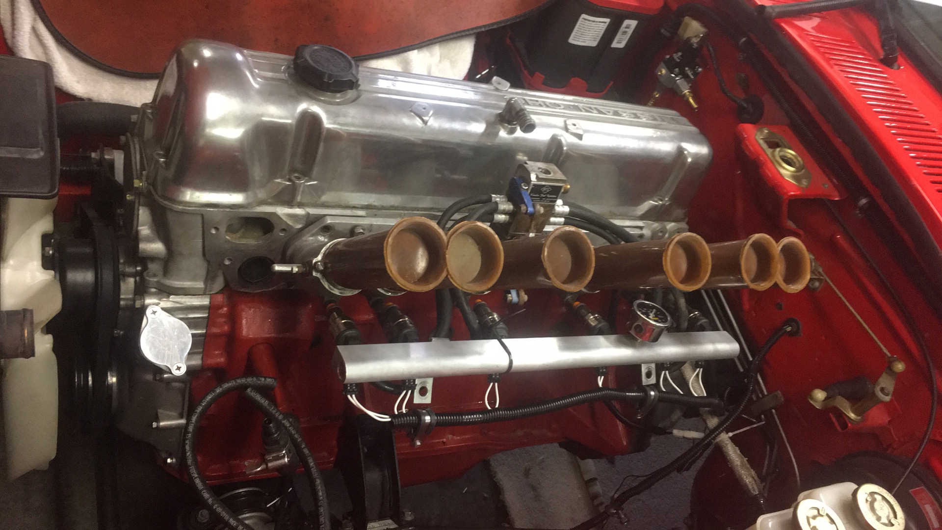

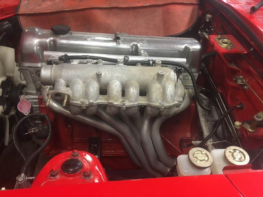

Had some fun swapping parts for some cool pics. Carbs are fun-but FI opens up a lot of options
