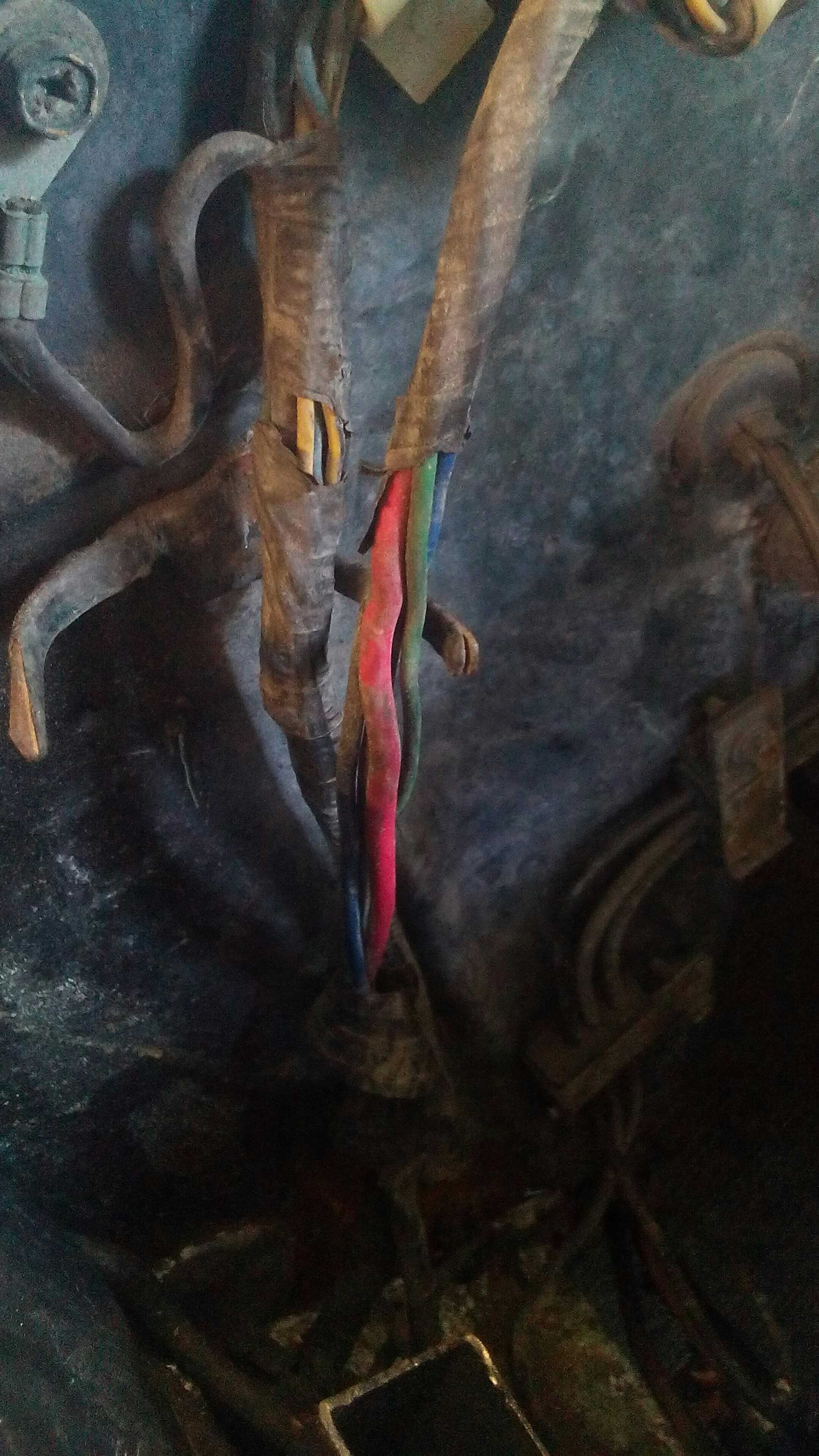

June 1, 20159 yr Author comment_471015 Haha yeah I just can't find where it connects to I figured I'd find two frayed wires on my harness right next to itI've looked on my bros 81 and his goes into the harness by his battery but its like mine never had it connected there Link to comment https://www.classiczcars.com/forums/topic/51532-78-air-intake-probs/?&page=3#findComment-471015 Share on other sites More sharing options...
June 1, 20159 yr Author comment_471016 Here's my harness where I think it goes There's no extra wires Link to comment https://www.classiczcars.com/forums/topic/51532-78-air-intake-probs/?&page=3#findComment-471016 Share on other sites More sharing options...

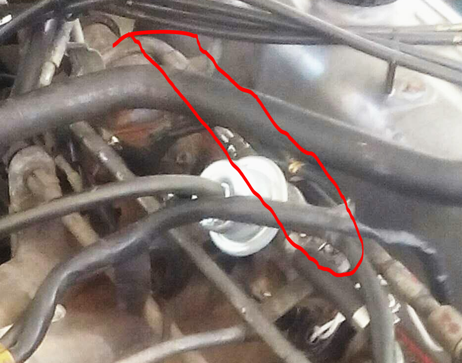

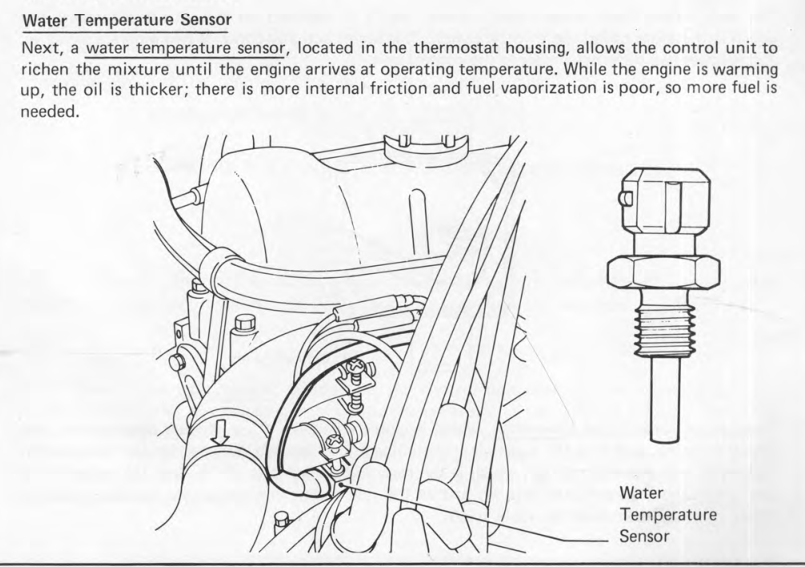

June 1, 20159 yr comment_471023 You're looking in the wrong spot, and maybe at the wrong sensor if you're over there.  Or you have a ZX engine with a CHTS.  Added a picture that shows where 78 wiring would be.  Here's some links to various helpful sources -  Guides, use the 1980 one - http://www.xenons130.com/reference.html  FSM, read Engine Electrical and Engine Fuel - http://www.nicoclub.com/FSM/280z/   Link to comment https://www.classiczcars.com/forums/topic/51532-78-air-intake-probs/?&page=3#findComment-471023 Share on other sites More sharing options...

June 1, 20159 yr comment_471028 The wire to your sensor should be in the red circle in my picture. Â That was my point. Â Not where your picture showed. Â Think it through. Link to comment https://www.classiczcars.com/forums/topic/51532-78-air-intake-probs/?&page=3#findComment-471028 Share on other sites More sharing options...

June 1, 20159 yr comment_471030 Your coolant sensor is on the front of the engine close to the distributor, for 1978. Â The wires to it come from the same harness that injector wires do. Â ZX engines use a CHTS that looks just like it, but it's mounted on the back right side of the engine close to the battery. Â It's pretty common to find a ZX engine in a Z. Â Â Â Â Link to comment https://www.classiczcars.com/forums/topic/51532-78-air-intake-probs/?&page=3#findComment-471030 Share on other sites More sharing options...
