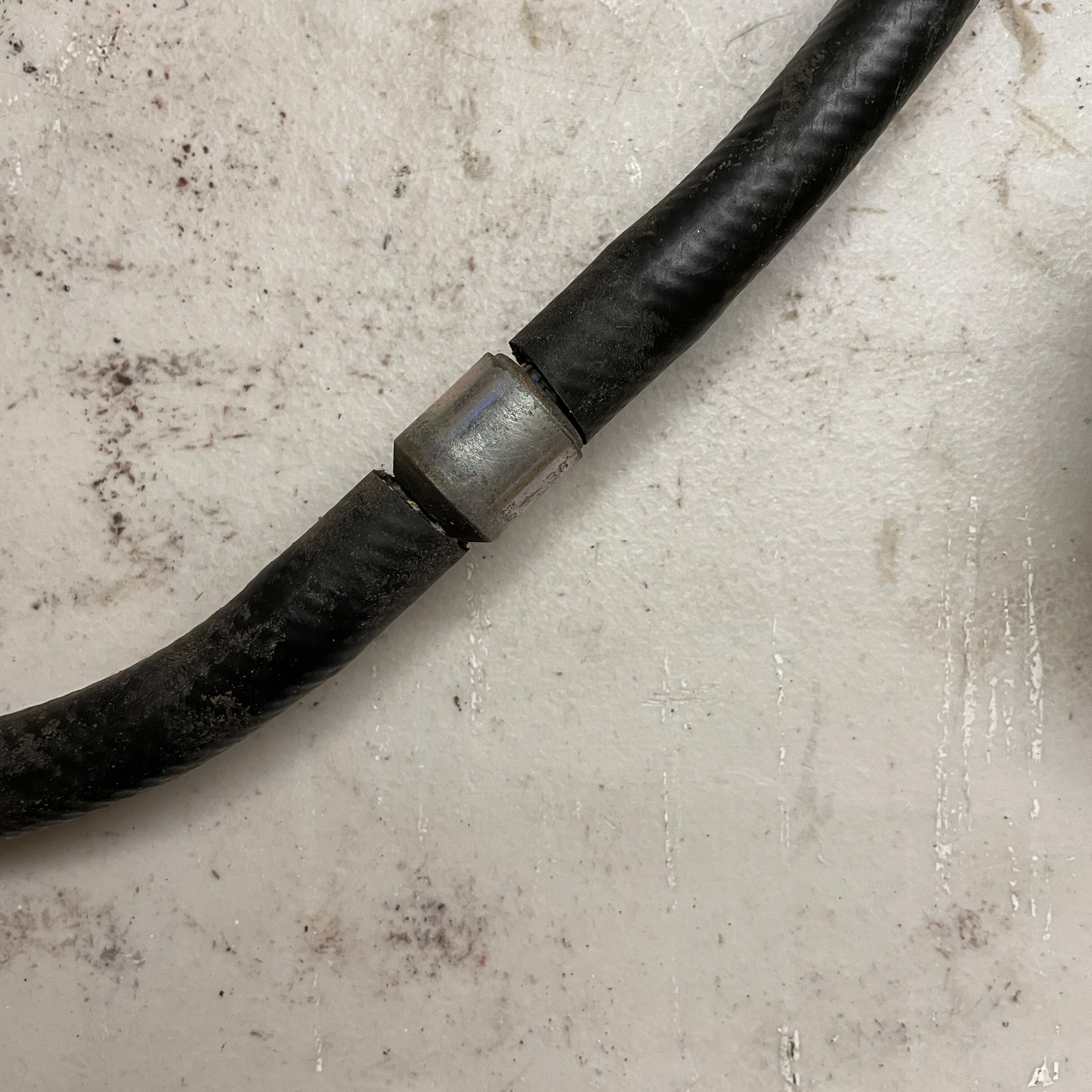

November 19, 20231 yr Author comment_659590 Here’s the fuel hose check valve that isn’t in the diagrams: Link to comment https://www.classiczcars.com/forums/topic/51541-1973-rebuild/?&page=100#findComment-659590 Share on other sites More sharing options...
November 19, 20231 yr comment_659591 Pretty sure what you have there is the brake booster vacuum check valve, I just painted it to keep the rust off. Link to comment https://www.classiczcars.com/forums/topic/51541-1973-rebuild/?&page=100#findComment-659591 Share on other sites More sharing options...

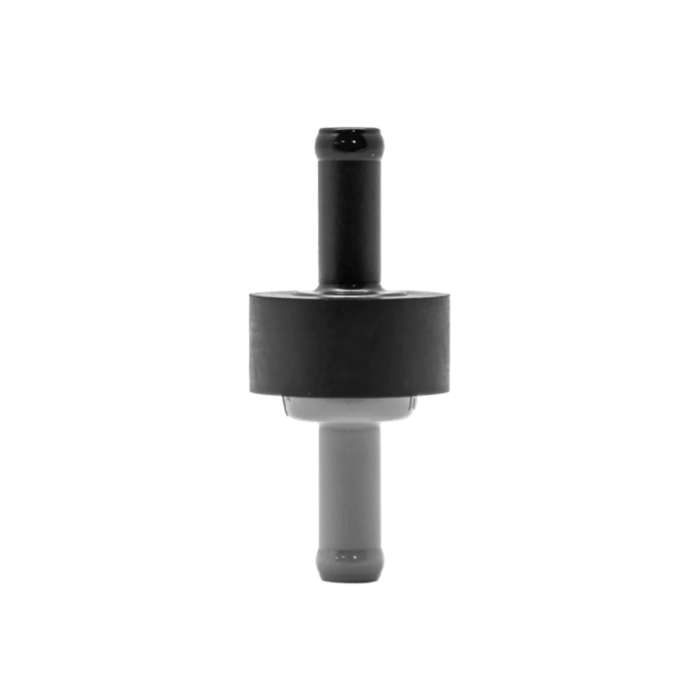

November 19, 20231 yr Author comment_659593 Oh jeeez. What a mess. Okay. I also have one of these in a box somewhere: I understood that to also be a brake booster check valve. Link to comment https://www.classiczcars.com/forums/topic/51541-1973-rebuild/?&page=100#findComment-659593 Share on other sites More sharing options...

November 19, 20231 yr Author comment_659599 Thanks for the info everyone! Okay, quick recap: 1. The silver check valve connecting two black hoses is for the brake booster vacuum. The black and gray one I have is also a brake booster vacuum check valve. The red ring is for the silver valve. I will test the silver one. If it works I’ll use it. 2. The 240 Z did not have a check valve in the vapor lines prior to (I think) 8/73. There is one on the brake booster, one on the smog system, and a flow valve on the left inner fender for vacuum lines. There IS one on the vapor line for cars that came with a charcoal canister (9/73?). I think there is also a fuel check valve between the fuel pump and the fuel rail on FE equipped cars. *** I think I will set up the fuel lines as they were OEM and investigate having one after the fuel pump somewhere (both placement and necessity). Edited November 20, 20231 yr by Matthew Abate Link to comment https://www.classiczcars.com/forums/topic/51541-1973-rebuild/?&page=100#findComment-659599 Share on other sites More sharing options...

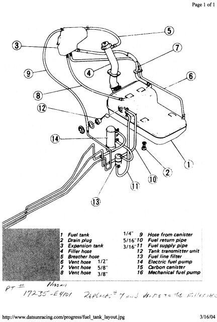

November 20, 20231 yr Author comment_659631 Can anyone show me a photo of the REAR 240z fuel filter bracket? I can only seem to find the ones for the 280z or the front one for 240Zs and I don’t think I have one. It would secure #13 in the diagram below: Edited November 20, 20231 yr by Matthew Abate Link to comment https://www.classiczcars.com/forums/topic/51541-1973-rebuild/?&page=100#findComment-659631 Share on other sites More sharing options...
November 21, 20231 yr comment_659656 20 hours ago, Matthew Abate said: Can anyone show me a photo of the REAR 240z fuel filter bracket? Hihi.. I would like to see that one to! Hihi.. i don't remember i ever have seen one. A 240z has a fuelfilter under the hood.. that's it.. Other (later) s30 and s130 have a electric pump and a filter in the rear (and a puls dampener for the electric fuelpump.) For as far i know.. Link to comment https://www.classiczcars.com/forums/topic/51541-1973-rebuild/?&page=100#findComment-659656 Share on other sites More sharing options...
November 21, 20231 yr Author comment_659659 I found that diagram on a thread about refurbing gas tanks with por-15. I thought I saw it somewhere else where @Captain Obvious had commented but can’t find it now. Anyway, this is the setup my car has. I have accounted for everything except the filter bracket and the routing of hoses 8 and 9 through the body (I’ve only found one grommet hole) and that’s keeping me from finishing the tank installation. Link to comment https://www.classiczcars.com/forums/topic/51541-1973-rebuild/?&page=100#findComment-659659 Share on other sites More sharing options...
November 21, 20231 yr comment_659661 So, I can't find the source for that diagram. I couldn't find it on carpartsmanual. Is it in the factory parts manual? I don't have those. I was trying to find the part number. Post it up if you can find it Link to comment https://www.classiczcars.com/forums/topic/51541-1973-rebuild/?&page=100#findComment-659661 Share on other sites More sharing options...

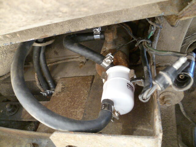

November 21, 20231 yr comment_659663 Here's a crappy pic from a 74 260Z. Note that it's not the correct filter. Nipples aren't in the correct location, but it was what I could find at the time: Pic is a little too close-up to get a good handle of what's going on, but that's all I could find in my files. And also, I'm not even sure if the 260 is the same as your 73 240Z. But hope this might help some? Link to comment https://www.classiczcars.com/forums/topic/51541-1973-rebuild/?&page=100#findComment-659663 Share on other sites More sharing options...
