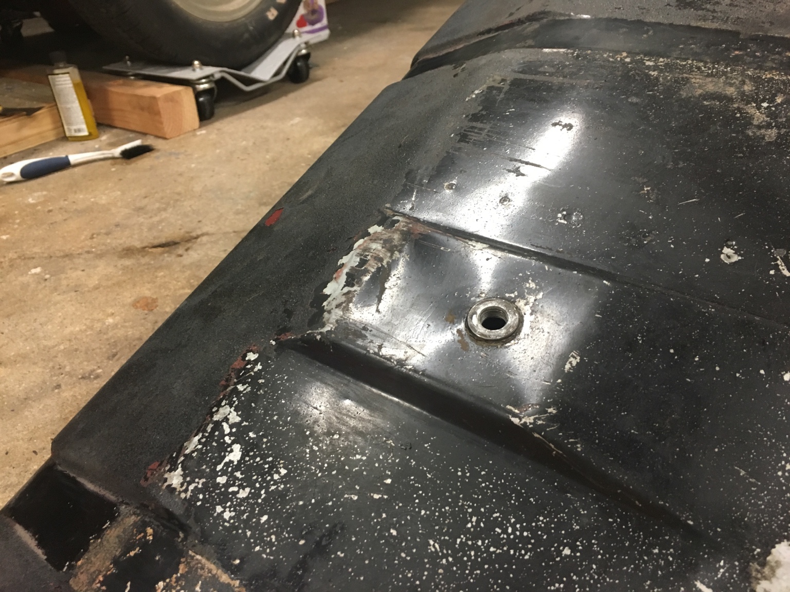

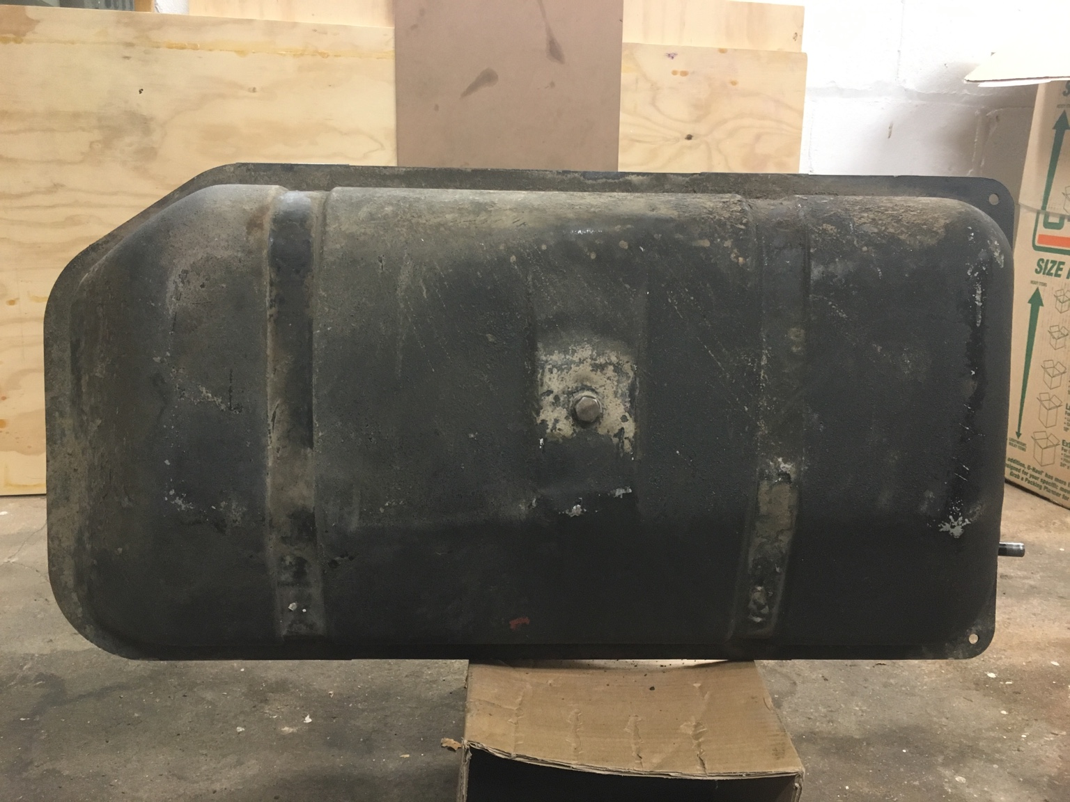

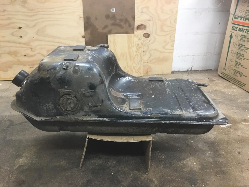

Look what came in the mail:
Nearly perfect. The rectangular bowl where the drain plug is located is slightly caved in, but I have a plan to make a slide hammer out of 3/8ths square steel rod and use my dollies to tap it back to where it should be.
Huge shout out to Mark Maras for finding, securing, and Greyhounding this to me. Gonna focus on this piece until it's finished while my head is off getting worked on.

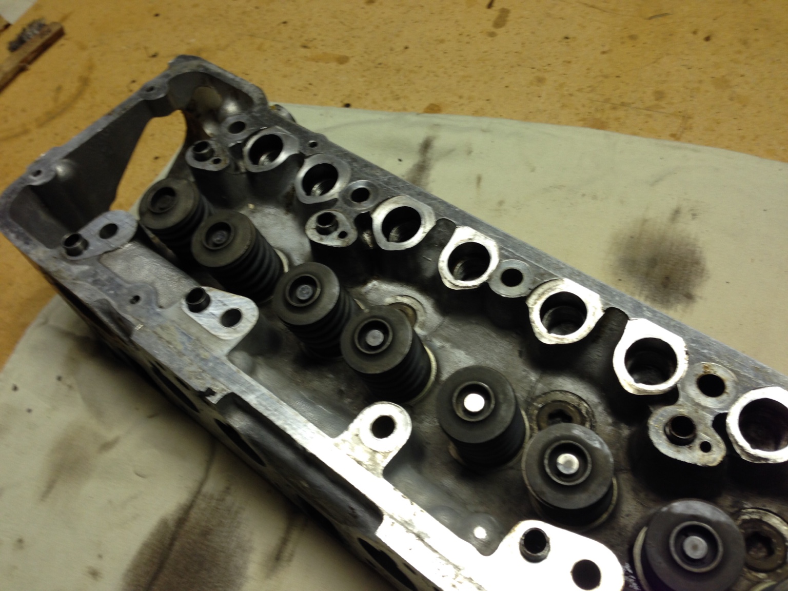

I've got that same spring compressor, it's great once you get it adjusted.  I was kind of worried at first that I was too tight with it but that's what it takes.  I found that a pen type magnet helped a lot for grabbing the retainer keepers.
3-pcs-Lot-Portable-font-b-Telescopic-b-f
You probably already know this but I like to blab so if you'll put a small piece of wood about an inch think under the valves face then put an appropriate sized socket over the retainer, spark plug socket was what I used, and whack it with rubber mallet it'll break those keepers loose beforehand.  Makes it a little easier, they'll fall out when you clamp the compressor down.
