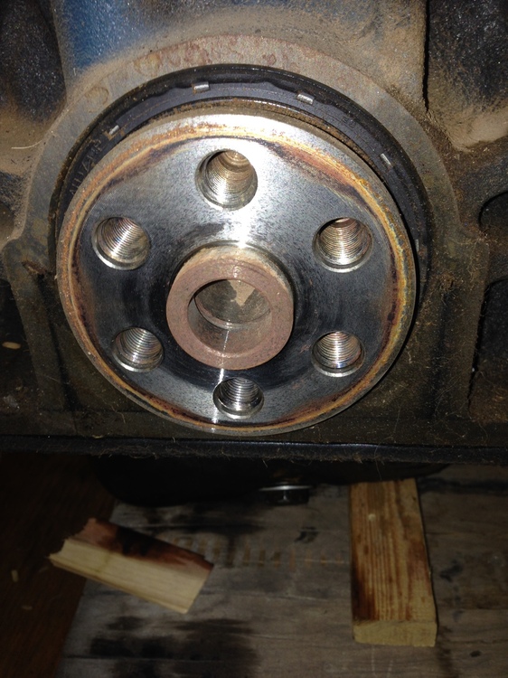

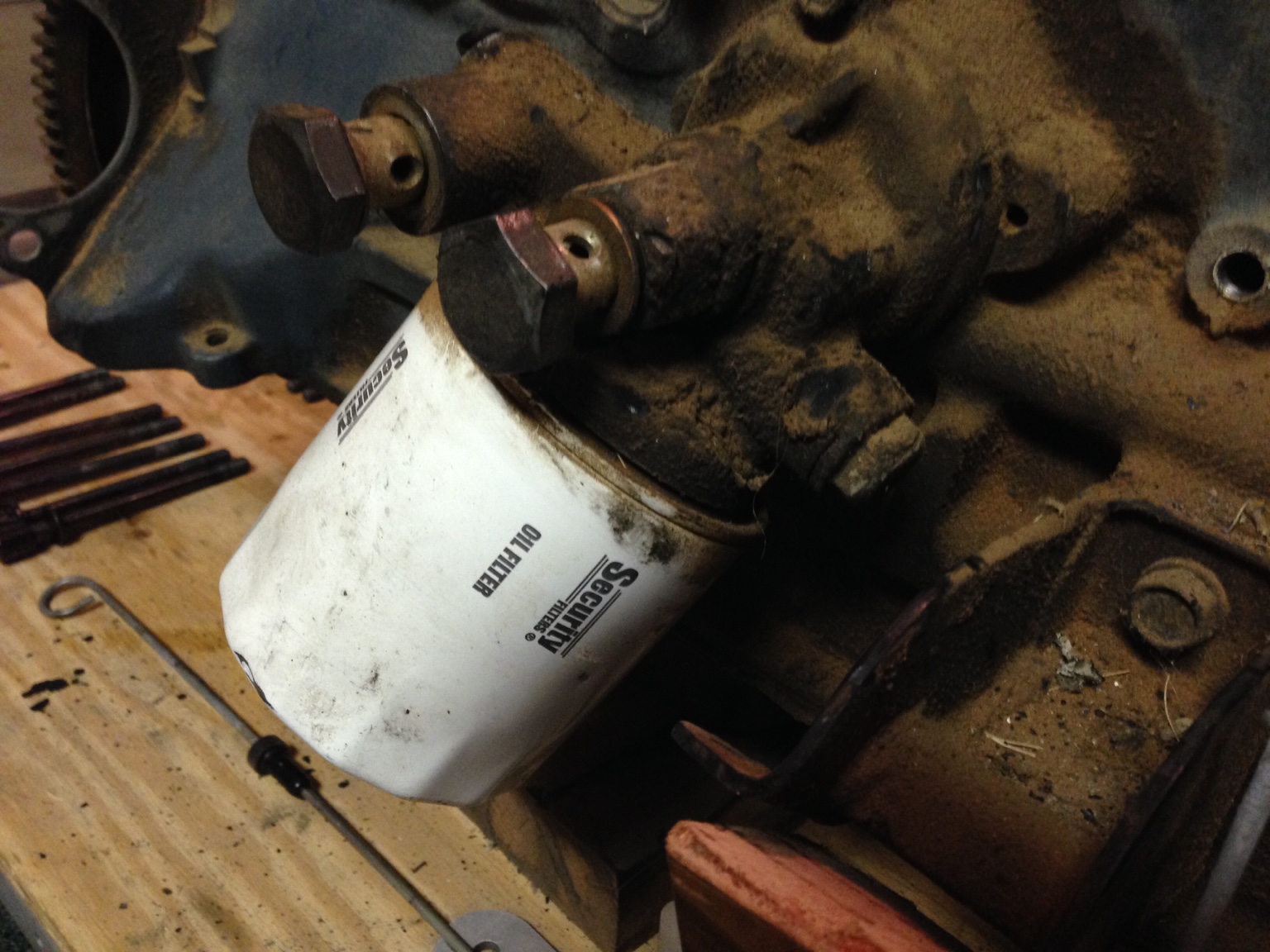

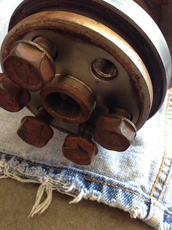

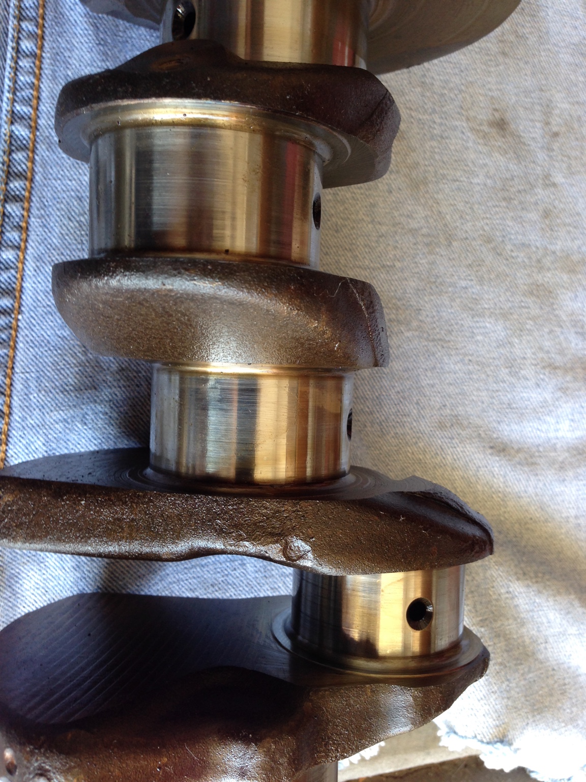

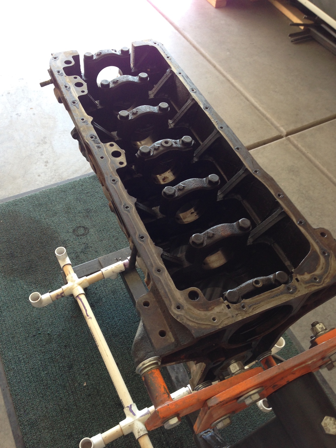

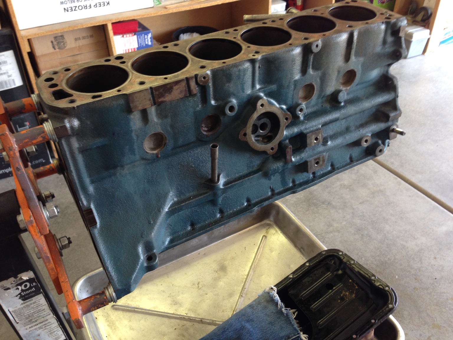

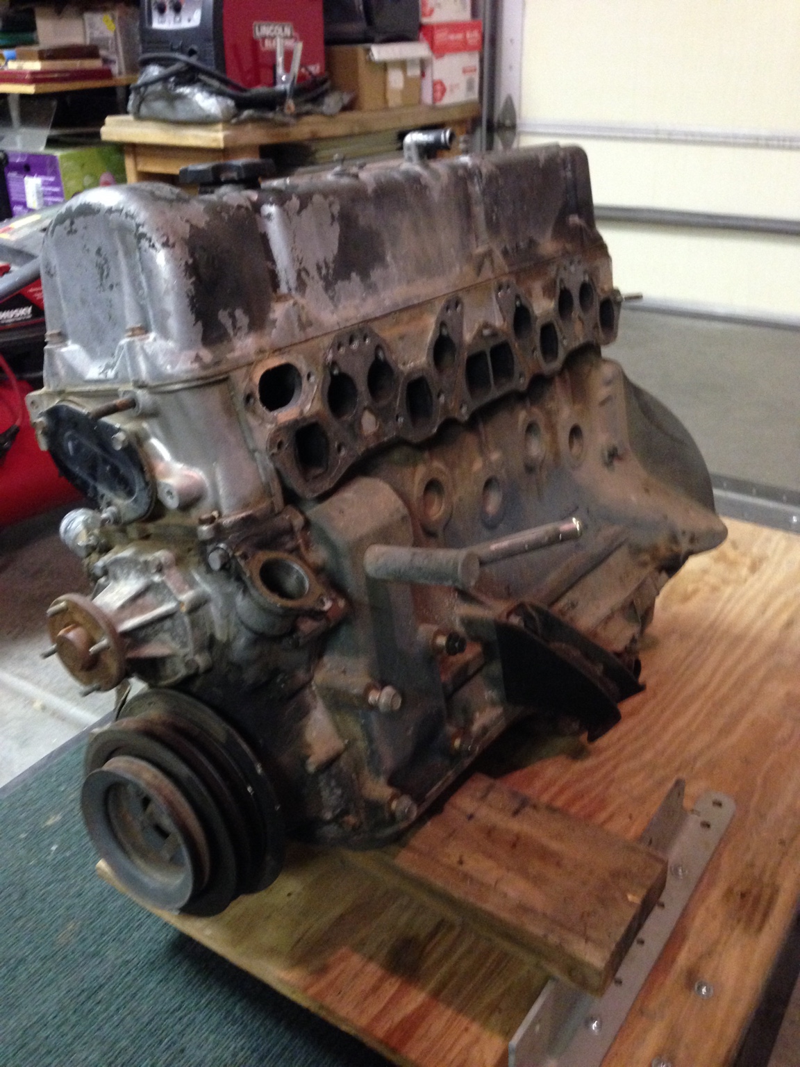

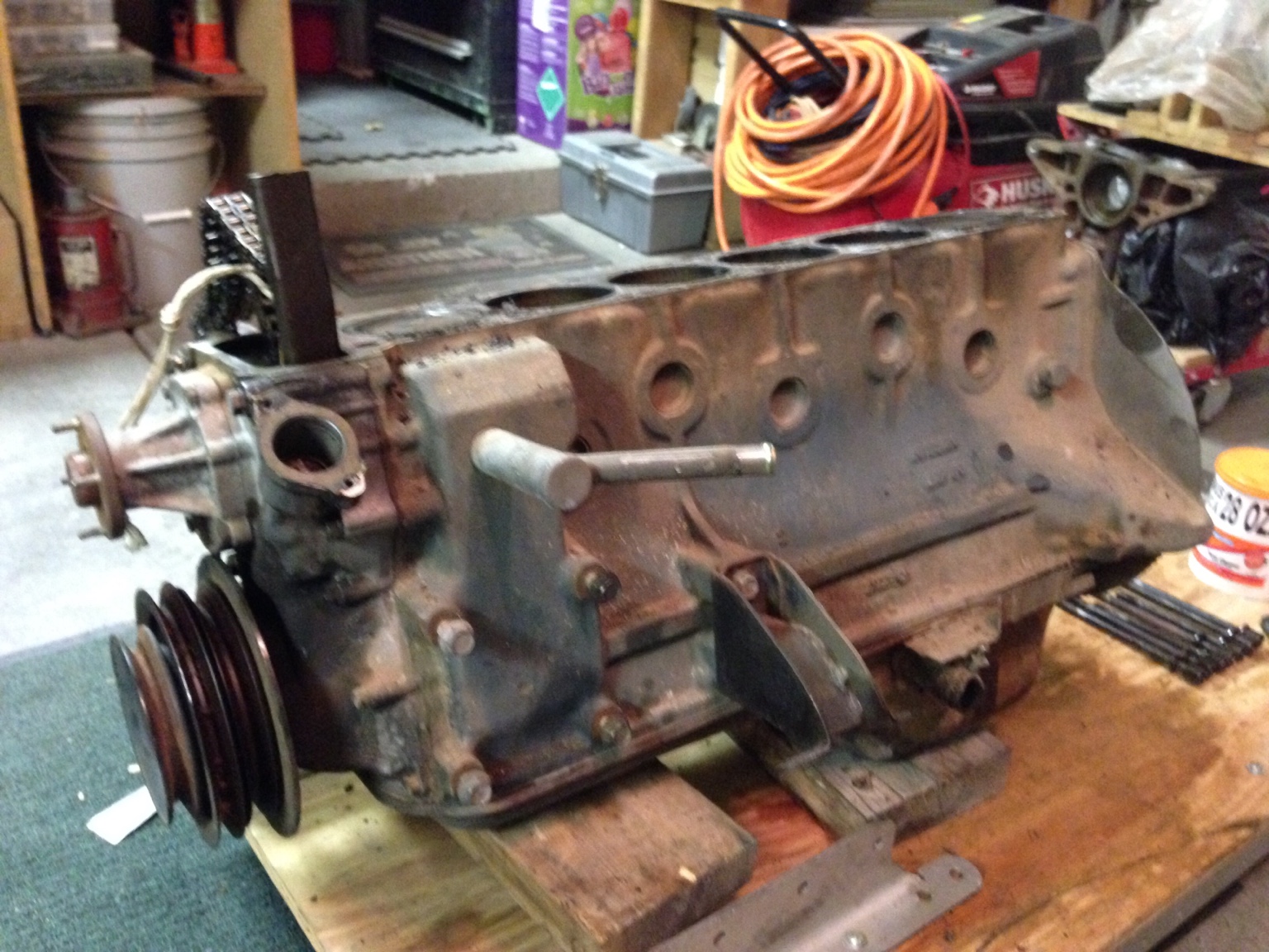

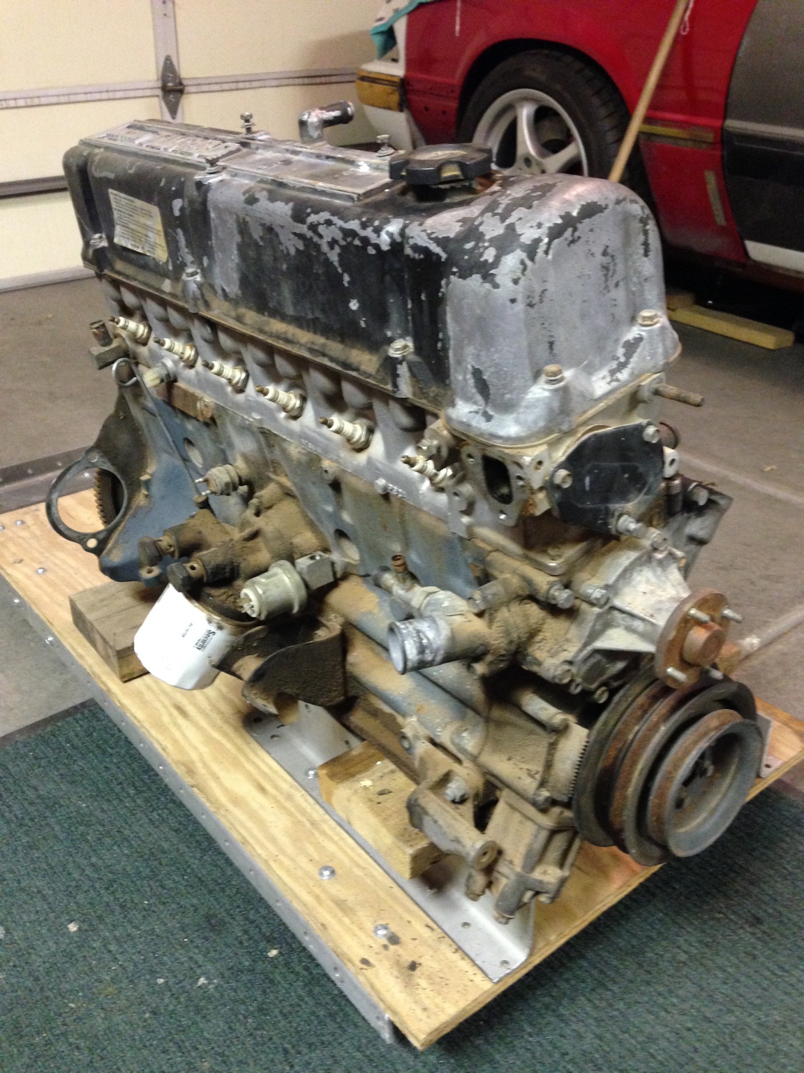

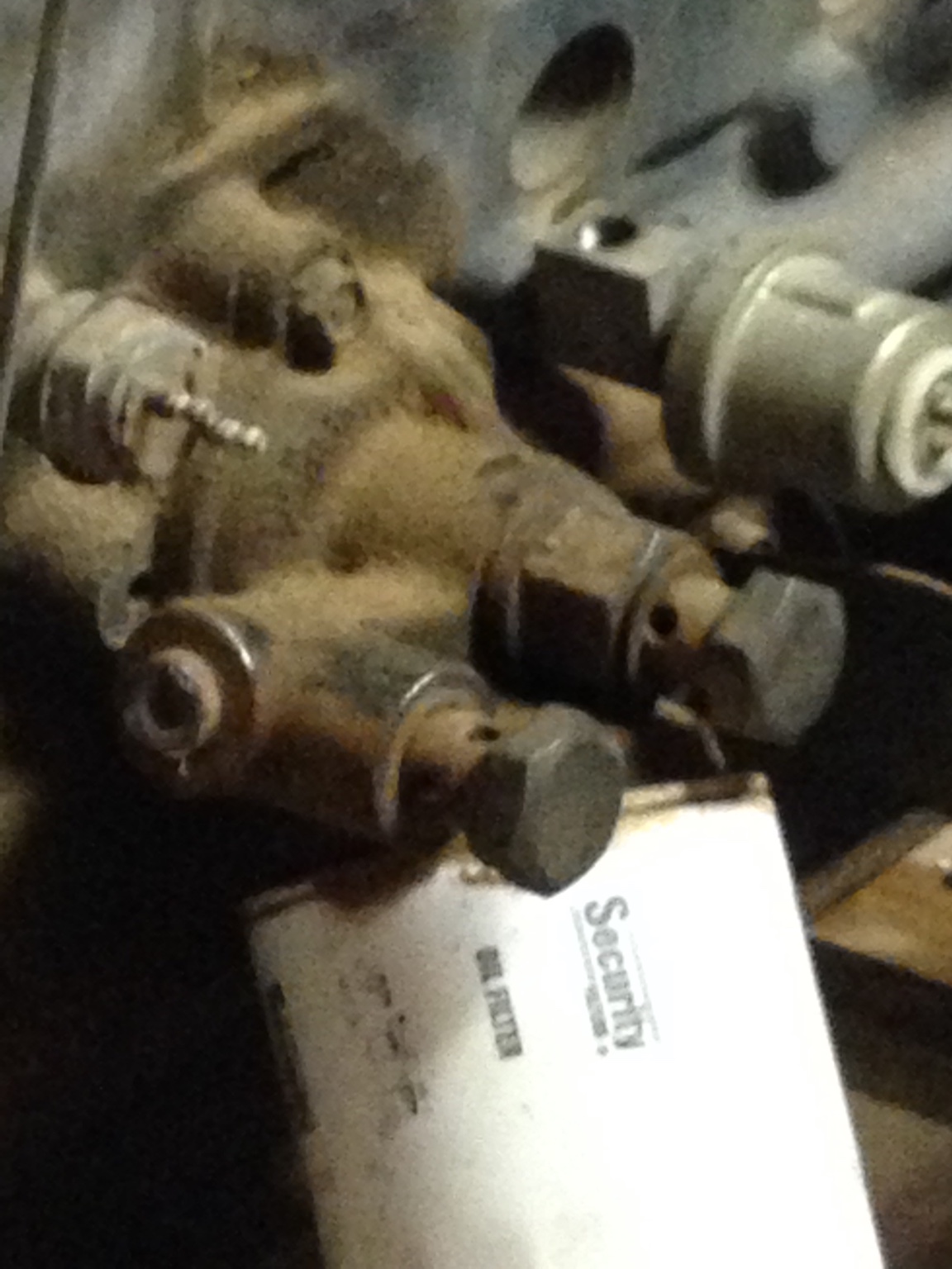

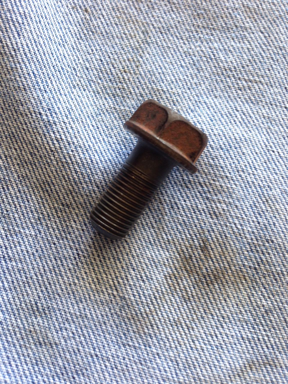

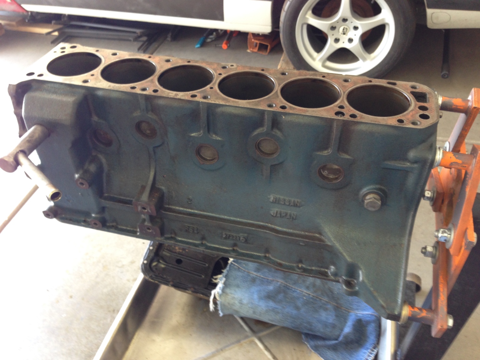

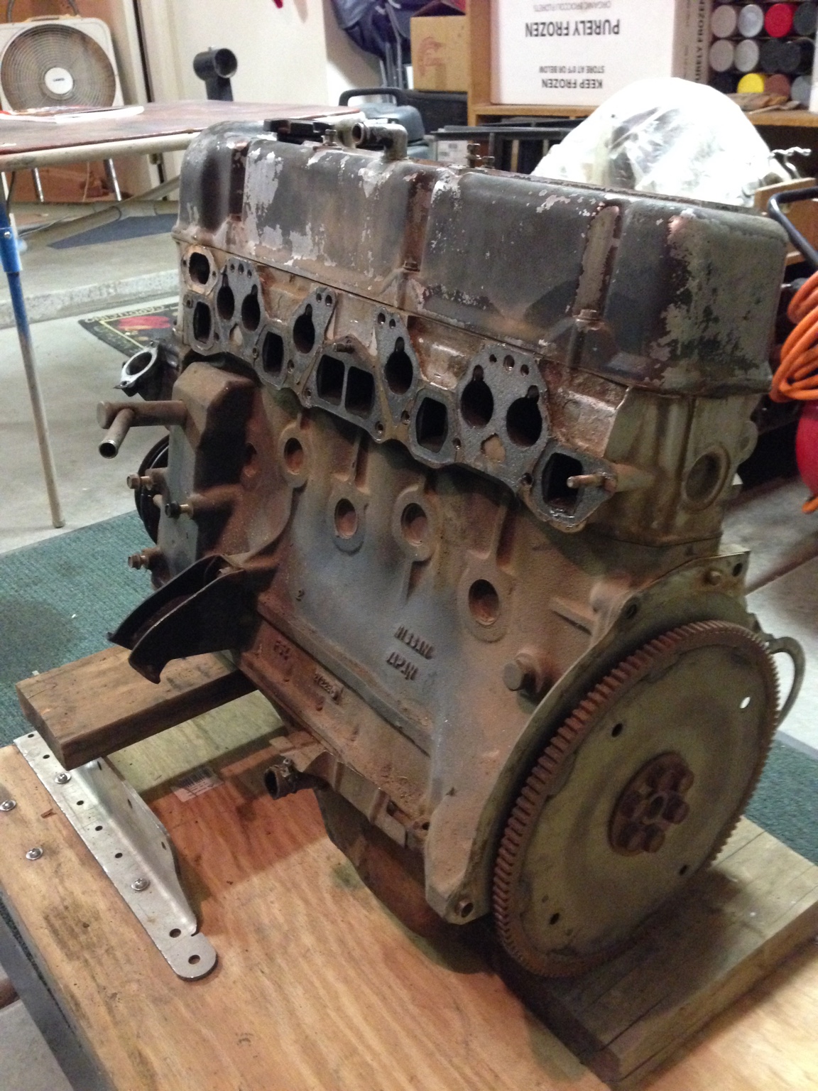

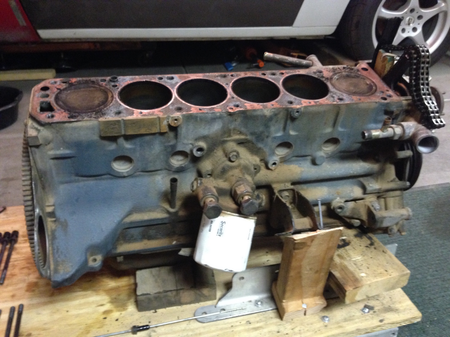

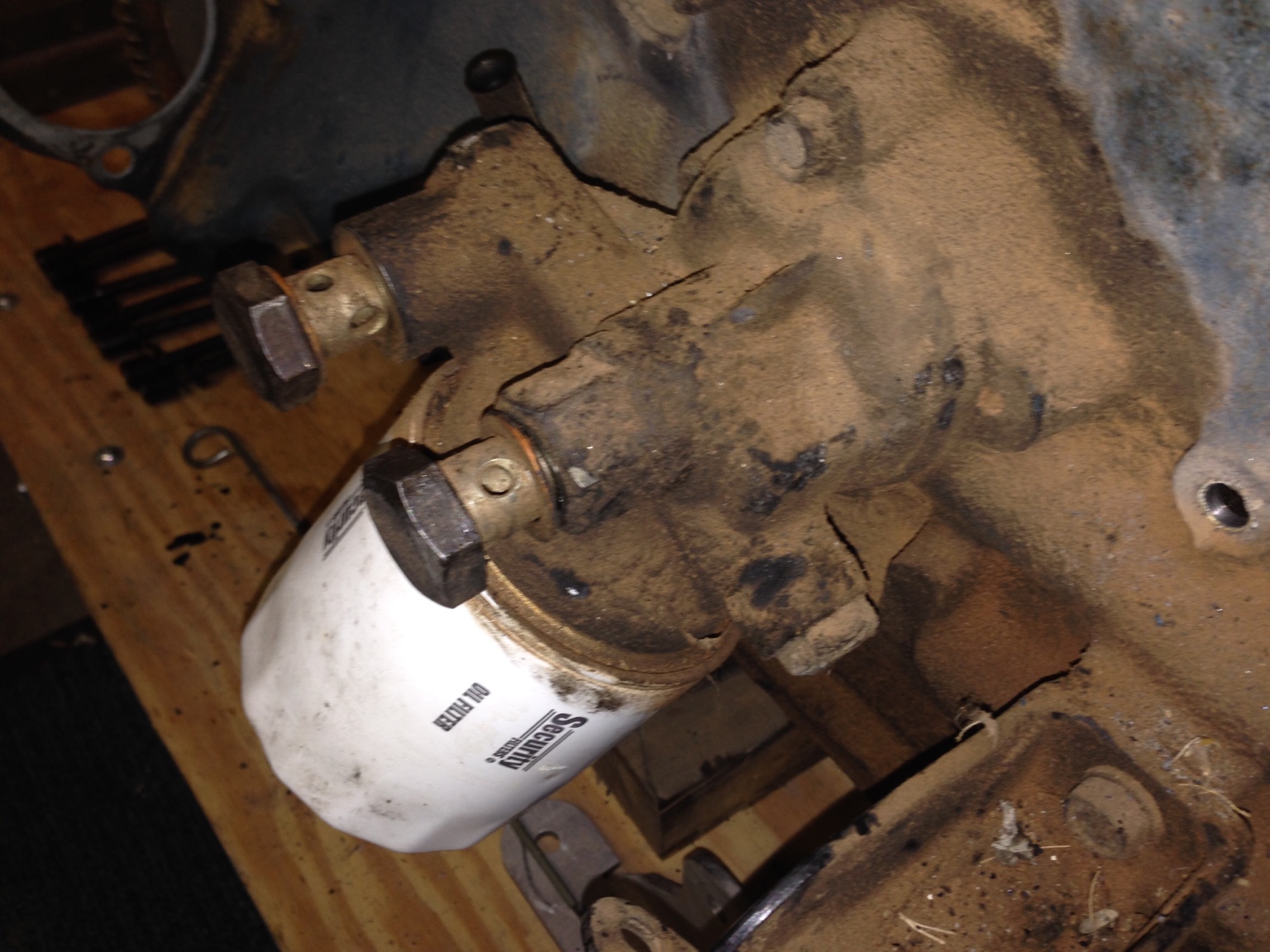

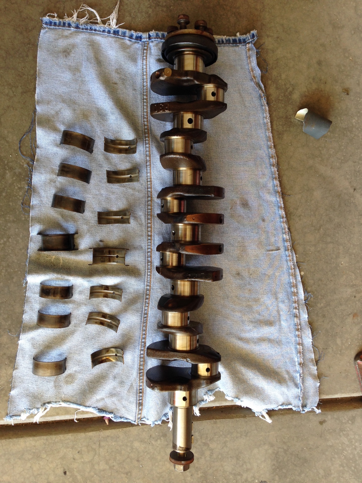

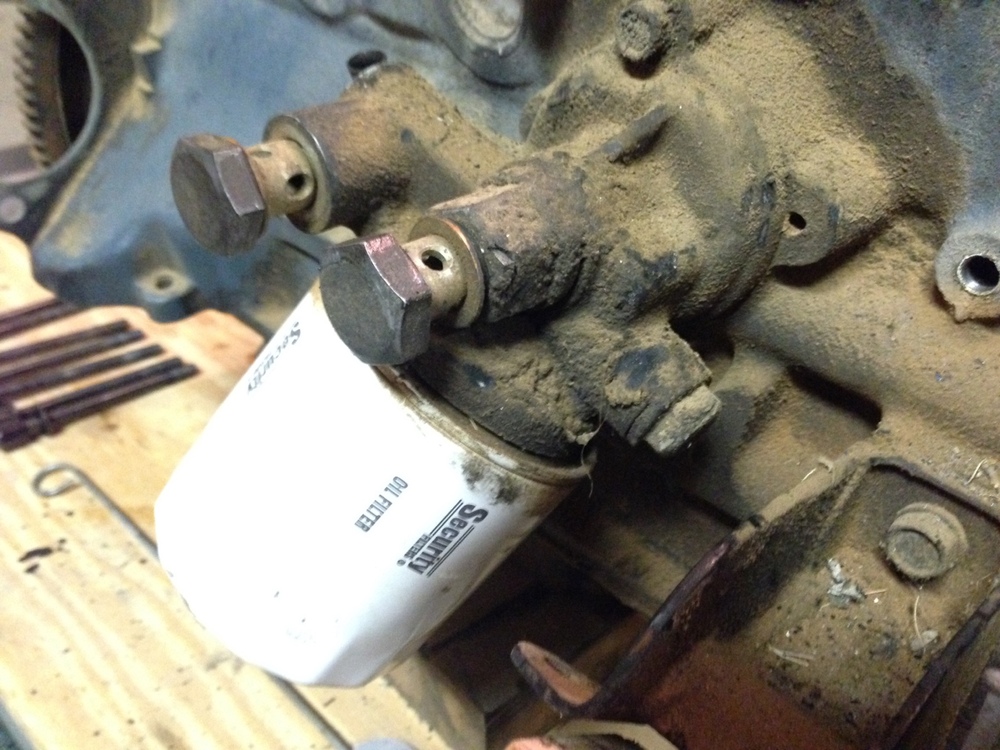

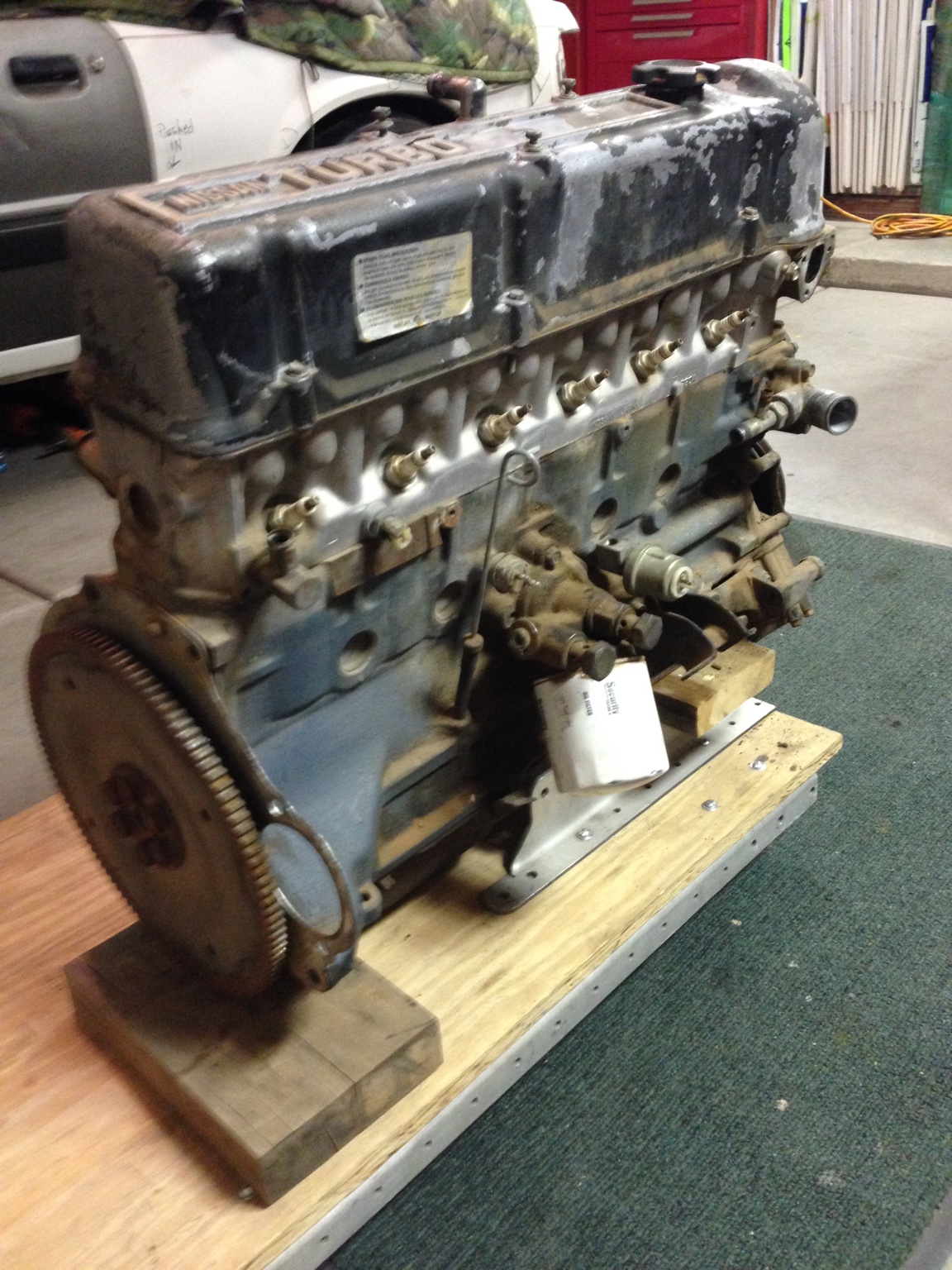

August 20, 20168 yr Author comment_501501 More tear down pics: Link to comment https://www.classiczcars.com/forums/topic/51541-1973-rebuild/?&page=28#findComment-501501 Share on other sites More sharing options...
August 20, 20168 yr comment_501506 Mathew, Do you have little kids that walk? If you do, be careful about leaving things that could turn over on them as they toddle about the garage. The engines aren't very stable and they are about 600#'s or so. Think about a ratchet a strap or bolt them down. I saw the screw into the block in the later pictures but probably needs to be a little more stout. Would hate to see something bad happen...I have had them turn over... Link to comment https://www.classiczcars.com/forums/topic/51541-1973-rebuild/?&page=28#findComment-501506 Share on other sites More sharing options...
August 20, 20168 yr Author comment_501526 It's actually at the machinist now, so all clear, but thanks for looking out.Normally I keep all this under a staircase in the basement with ratchet straps holding everything in place and 4x4s wedged in as bracing.Sent from my iPhone using Tapatalk Link to comment https://www.classiczcars.com/forums/topic/51541-1973-rebuild/?&page=28#findComment-501526 Share on other sites More sharing options...

August 23, 20168 yr Author comment_501637 6 minutes ago, ksechler said: Yep, I used to do that. Superglue and baking powder, too. Man that stuff would cook off quick! And that little puff of smoke would burn the hell out of your eyes. Seriously, though, why reinforce the roof? That seems like a solution to a non-existent problem. I brought it up at the very beginning of my Z lifespan, mostly because the seller told me this had been done and I was sort of incredulous. I'll be stripping the car, so his effort will have been a waste, but one of the body shops I spoke to said they would probably do it anyway. I think it sounds like a great way to cause a rust problem. One thing I WILL be doing, though, is spraying the inside of the roof with Lizard Skin or something similar to cut noise. Switching gears, right now I am looking into the gains that come (or don't) from boring. It turns out that my block and crank are pretty much immaculate. The machinist said I will probably be able to just go with a quick hone on the cylinders and polishing the crank, so we are trying to decide whether or not to spend the $150 on boring it out. This will have zero impact on the budget beyond the machining costs, but I am suspicious that the performance gains would be canceled out the increased weight of the pistons. From what I can tell from the internet, there's no one out there who has figure out what boring to 87mm will do when no other changes are made. Going from the gains from the non-US 240z to the non-US 260z was about 10-12 PS, but that was accomplished by increasing the stroke. Going from 83mm (L26) to 86mm (L28) is inconclusive because I can't find data on the L28 that came with carburetors other than that the Nissan 280C only made 127 PS, probably because of the head or other junk. I need to figure this out so I can move forward. If going to 87mm won't change the budget other than the $150 machine cost and won't change compression because the pistons are being designed after this decision is made to hi 9.9 no matter what the bore is, the only real considerations are how much mass will this add to reciprocation and how much PS will I get? Edited August 23, 20168 yr by Matthew Abate Link to comment https://www.classiczcars.com/forums/topic/51541-1973-rebuild/?&page=28#findComment-501637 Share on other sites More sharing options...
August 23, 20168 yr comment_501681 Mathew, Are you asking about gains from boring a stock L24 block? If you are, there aren't going to be any! Admittedly there will be some small gain but it will be negligible. Not worth the cost. Also does your $150 increase in building cost include the new pistons and rings? That seems kind of cheap for the machine work and the new parts... Now increased compression will help but the small over bore not so much Link to comment https://www.classiczcars.com/forums/topic/51541-1973-rebuild/?&page=28#findComment-501681 Share on other sites More sharing options...
August 23, 20168 yr Author comment_501690 The compression will be 9.9 either way. The $150 is the cost to bore six cylinders only. The cost of the Pistons is exactly the same whether they are 86mm or 87mm.Everything is literally the same except for the bore in this scenario, and I think the gain in PS/HP/kW is cancelled by the increased mass, at least partially.If I could find out what the factory specs on an L28 set up like an L26 (same or similar head, fuel system, etc.) I would at least have a place to start, but I can't find specs on an L28 anywhere. L28e and L28et? Sure, all over. But nothing from 1975 with factory carbs.I suppose the flip side of this would be if it's only $150 and nothing else is changing why not do it. Link to comment https://www.classiczcars.com/forums/topic/51541-1973-rebuild/?&page=28#findComment-501690 Share on other sites More sharing options...
