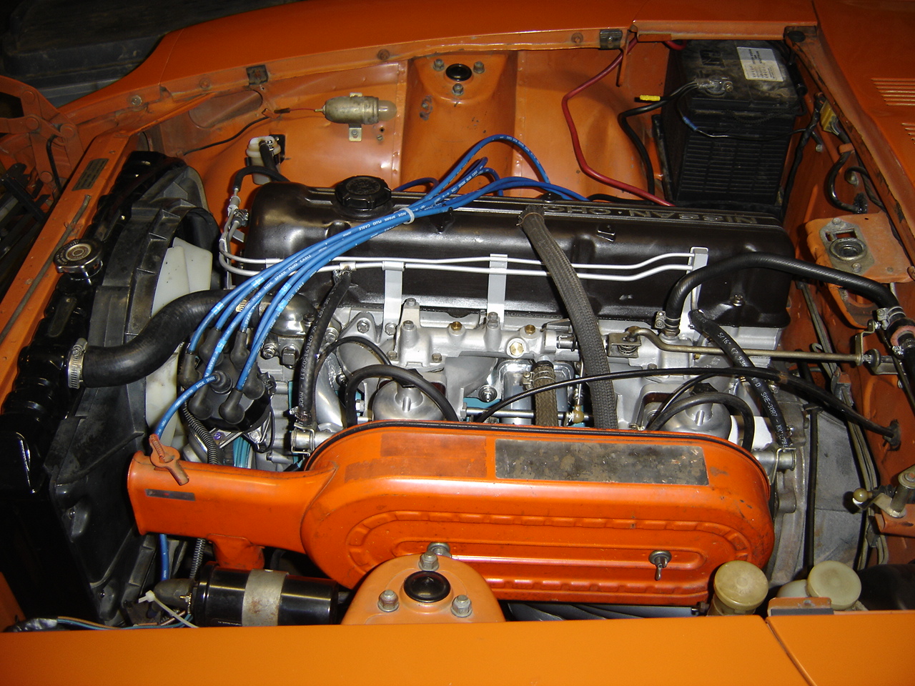

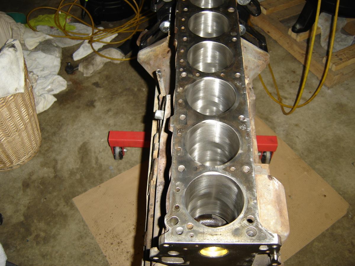

February 11, 20178 yr comment_512582 Looks great! I can definitely see the cross hatch now. Keep on marching... Here's mine after the machine shop. Edited February 11, 20178 yr by siteunseen Link to comment https://www.classiczcars.com/forums/topic/51541-1973-rebuild/?&page=43#findComment-512582 Share on other sites More sharing options...

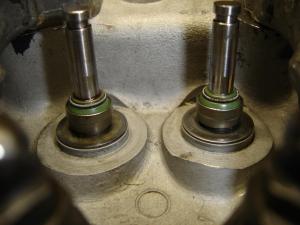

February 11, 20178 yr comment_512583 I can't remember if y'all are using a ground down cam but if you are do you know about the shorter valve seals fro Fel-Pro? Anything more than .460 needs these if I recall correctly. It's discussed in this thread about OE seals squashing down. http://forums.hybridz.org/topic/68120-problem-with-viton-valve-seals/ Link to comment https://www.classiczcars.com/forums/topic/51541-1973-rebuild/?&page=43#findComment-512583 Share on other sites More sharing options...
February 11, 20178 yr comment_512584 Hello, "Site". Glad to know you're moving forward with your build, as well. I read that you need shorter stem seals with the high lift cams but didn't know were to get them; now I do -- thanks! Are you posting your build? Do you know theie height? We have seals in our gasket set and we're using a cam with 0.458" lift, so I think we'll be okay. I'll double check the clearence when I get to that point in the build. Link to comment https://www.classiczcars.com/forums/topic/51541-1973-rebuild/?&page=43#findComment-512584 Share on other sites More sharing options...
February 11, 20178 yr comment_512586 I'm sorry for not mentioning that was a year old picture. I've got over 1,000 miles on it now and it's just now "loosening up". I believe like Matt does, get a strong reliable motor 1st and all the small stuff is actually fun doing, drinking beer makes it fun for me. Edited February 11, 20178 yr by siteunseen Link to comment https://www.classiczcars.com/forums/topic/51541-1973-rebuild/?&page=43#findComment-512586 Share on other sites More sharing options...
February 12, 20178 yr comment_512637 6 hours ago, siteunseen said: I'm sorry for not mentioning that was a year old picture. Very nice!!! Matt would like to finish his valve cover just as you did. Can you tell us how or where it was done? Link to comment https://www.classiczcars.com/forums/topic/51541-1973-rebuild/?&page=43#findComment-512637 Share on other sites More sharing options...
