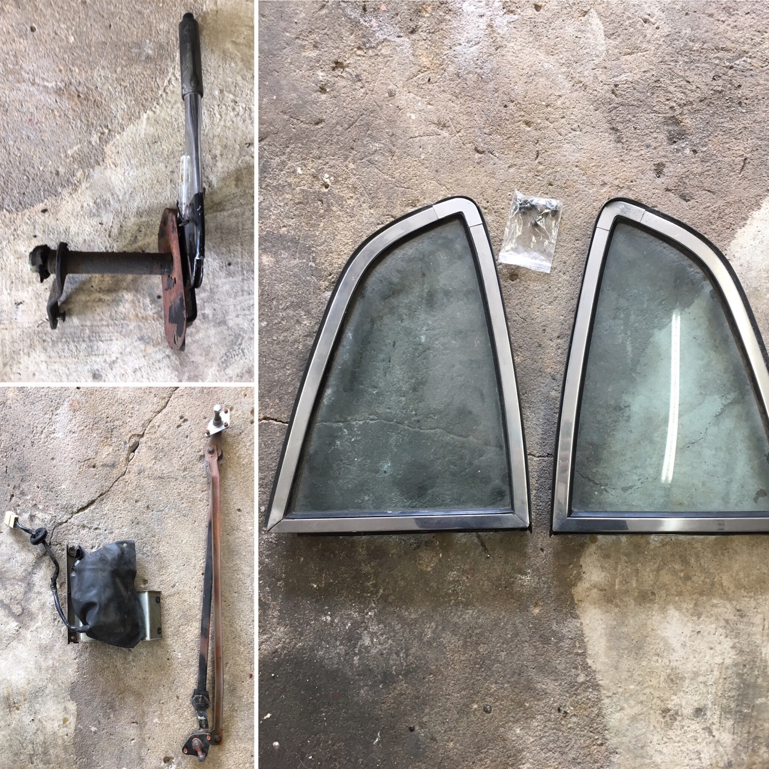

February 22, 20178 yr Author comment_513638 More random parts off the car. Link to comment https://www.classiczcars.com/forums/topic/51541-1973-rebuild/?&page=46#findComment-513638 Share on other sites More sharing options...

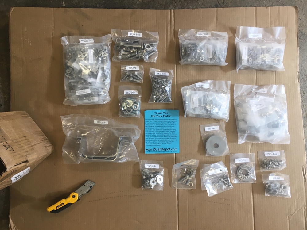

March 5, 20178 yr Author comment_514504 Today's Progress:Today's Delivery:1 Z-worth of stainless hardware (engine hardware went to AZ). Link to comment https://www.classiczcars.com/forums/topic/51541-1973-rebuild/?&page=46#findComment-514504 Share on other sites More sharing options...

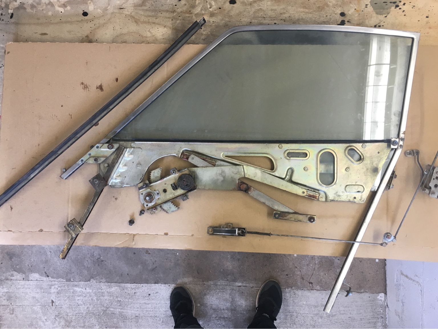

April 8, 20177 yr Author comment_517559 If I can get the driver's window, windshield, and back hatch off by the end of the month I'll be ready to buy a rotisserie and hang the car.Sent from my iPhone using Classic Zcar Club mobile Link to comment https://www.classiczcars.com/forums/topic/51541-1973-rebuild/?&page=46#findComment-517559 Share on other sites More sharing options...
