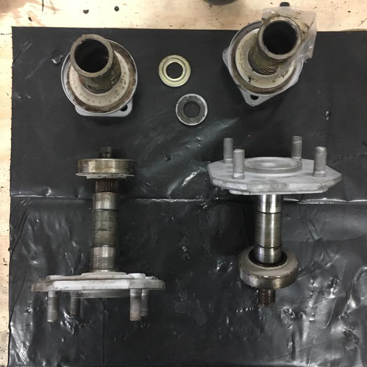

While you are doing the rear wheel bearings, you might consider upgrading to the newer 77-78 style two piston rear wheel cylinder design instead of the earlier floating cylinder design? You need the newer backing plate which requires taking the stub axles out. But if you're doing bearings and will have the axles out anyway...
I'm mobile and can't post pics right now, but basically until 76, they used a single piston rear wheel cylinder where the one and only piston pushed against one shoe, and the whole wheel cylinder slid (floated) on the backing plate and pushed against the other shoe. Worked well enough until the cylinder froze in the slot.
Then in 77 they changed to a fixed location cylinder with two opposing pistons. Same breaking performance (when everything is working as intended), but I consider the non-floating design much more reliable. I believe the chances that everything works as intended much higher for the later design.

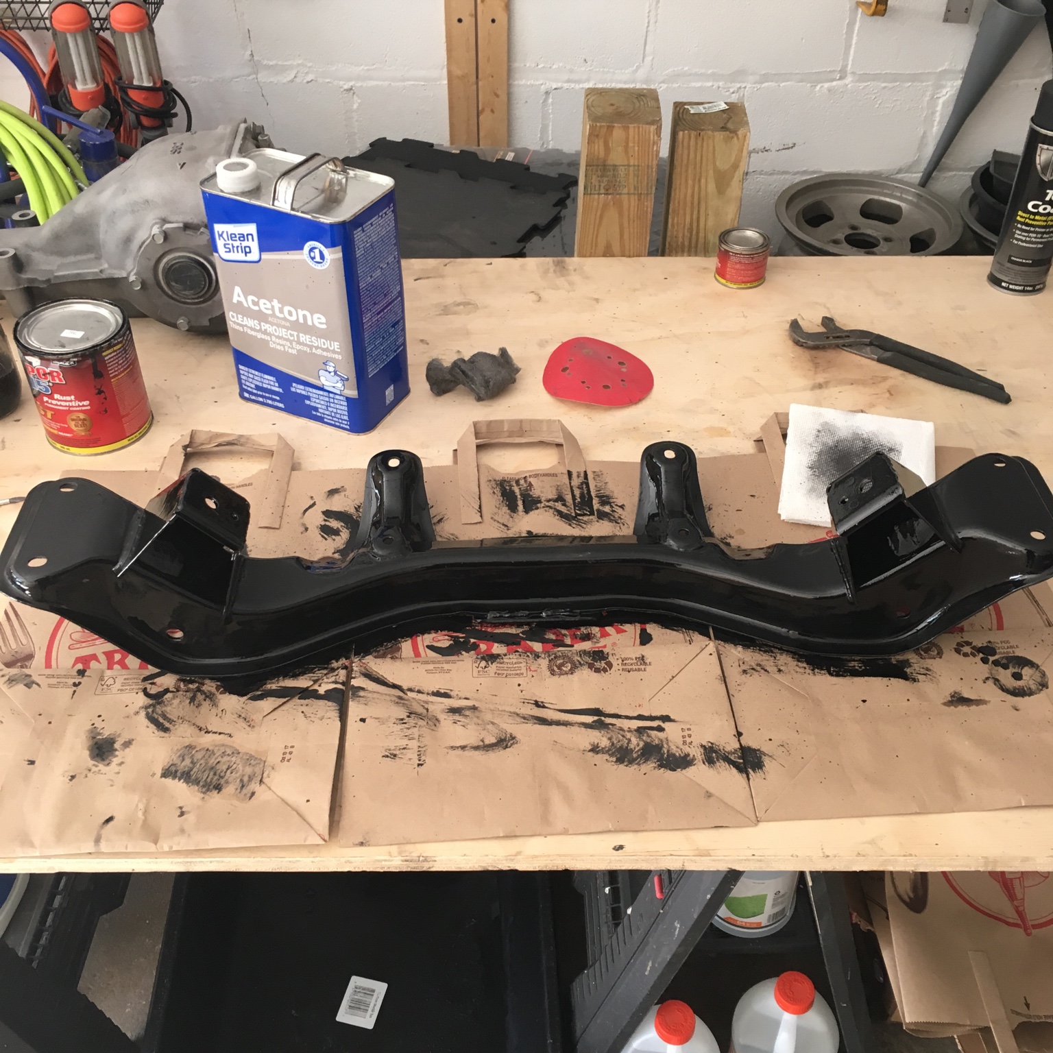

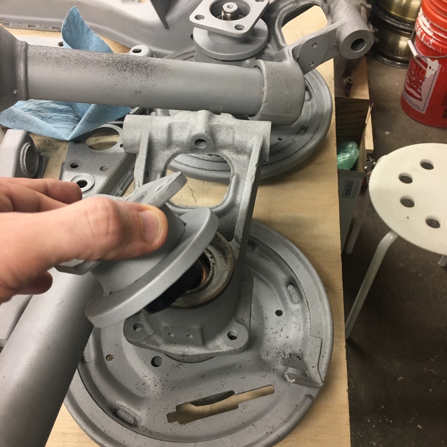

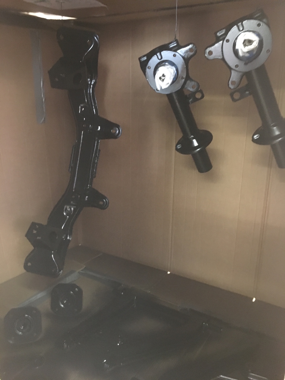

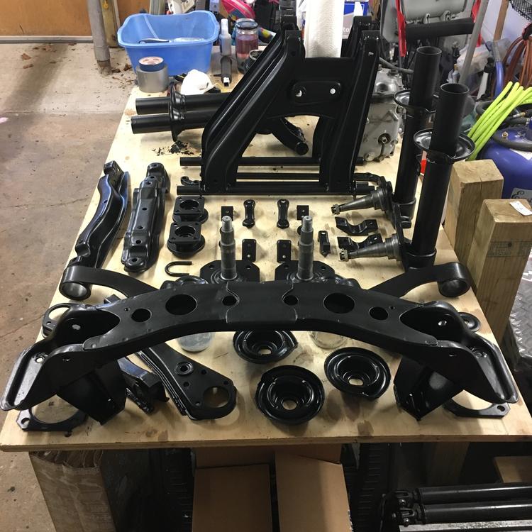

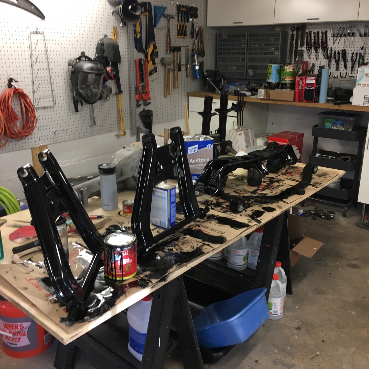

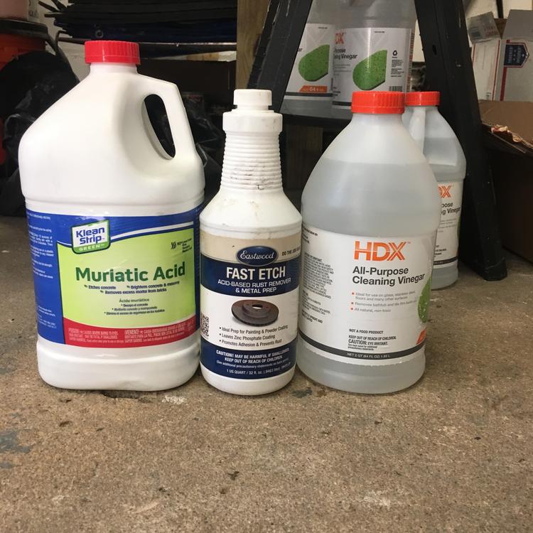

Five months after starting this suspension refresh by pulling the wheels off I am over the hump!
After blasting I put the parts through a rinse. The middle bottle worked the best: not to harsh but still effective.
Acetone to neutralize the acid in the rinse.
POR-15
Spray booth and POR-15 Top Coat
Not sure if I should paint these or not. Opinions?

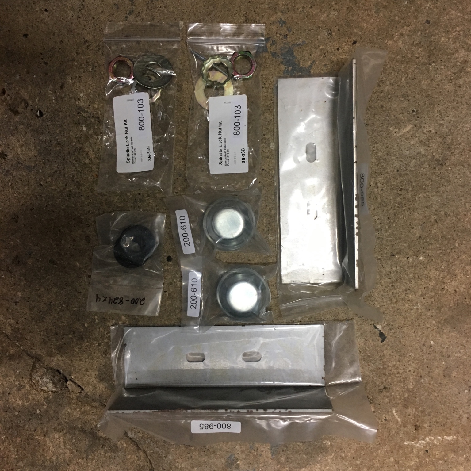

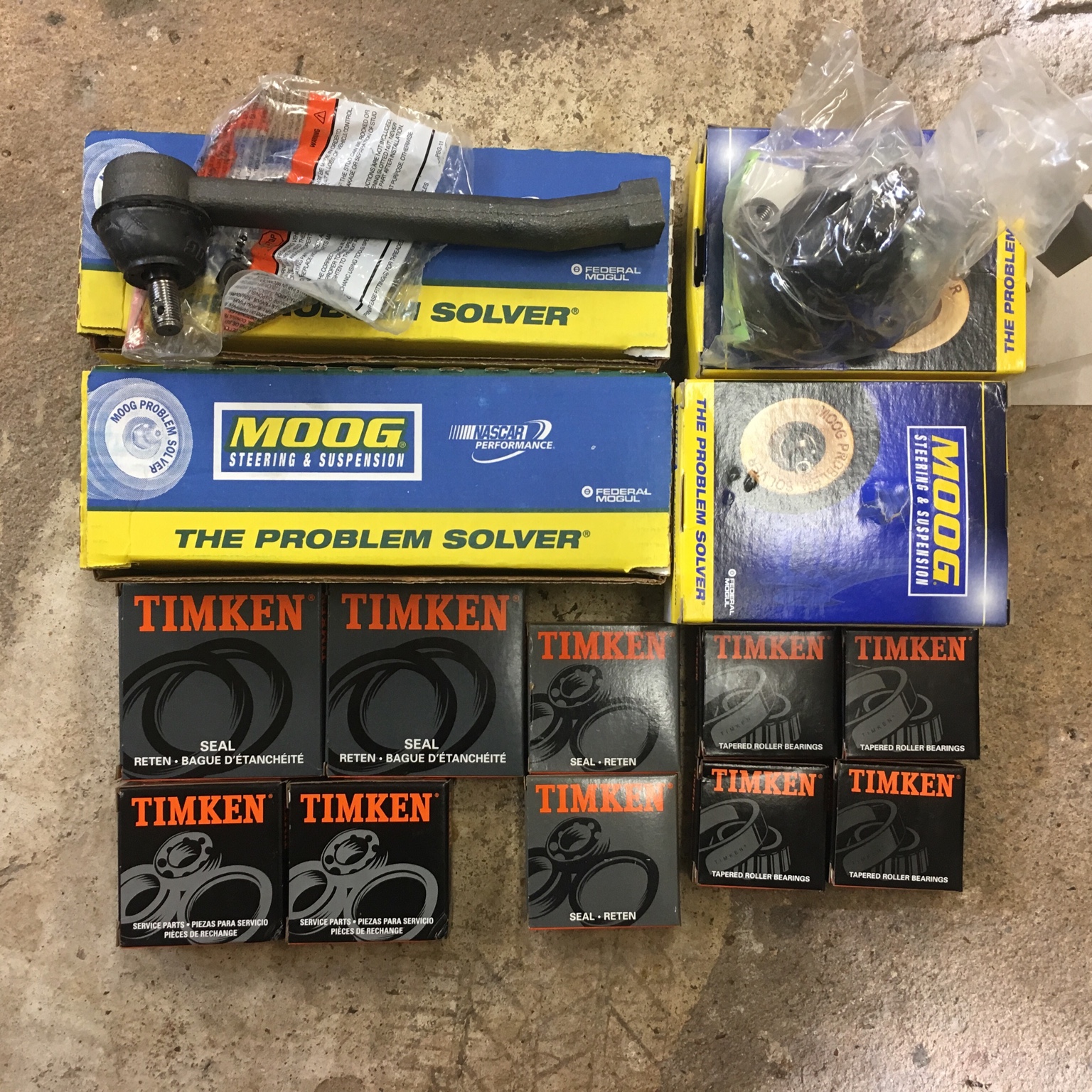

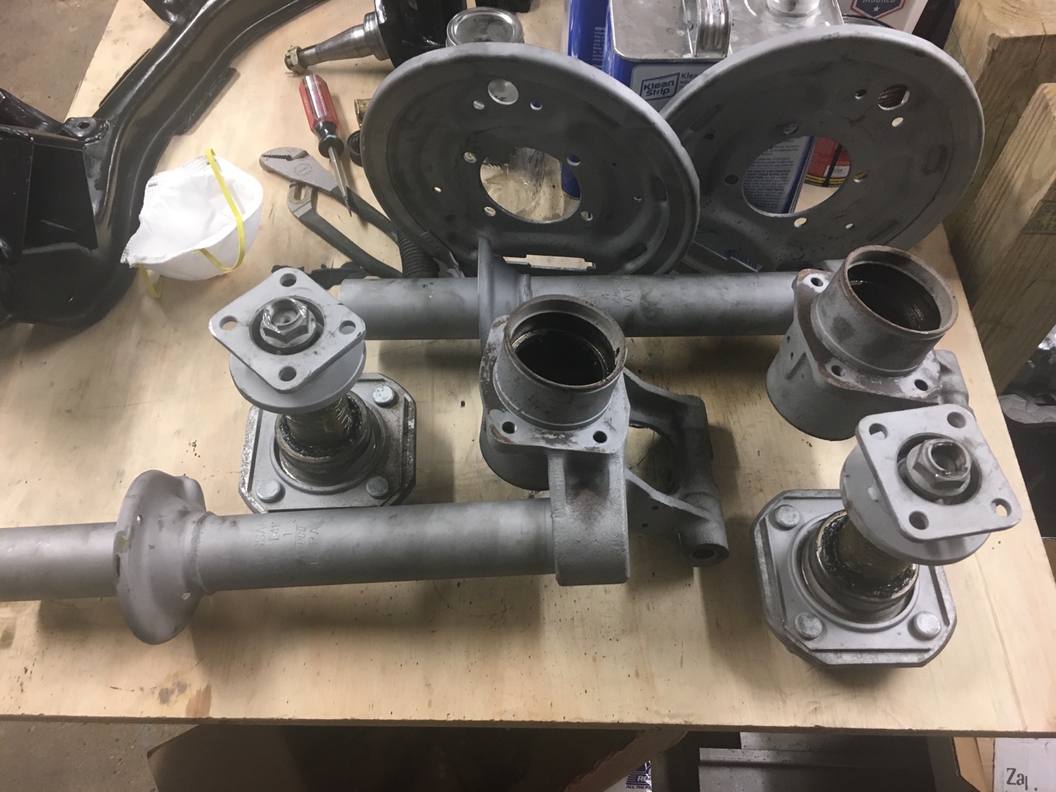

Still waiting for my rear inner bearings and some random hardware. Once that comes I’ll start reassembly. After that I’ll flush and repaint the differential. Then it gets new bearings and seals, even though it’s only three years old. I’m just paranoid about the possibility it had dirt in the bearings from sitting in the junk yard.
