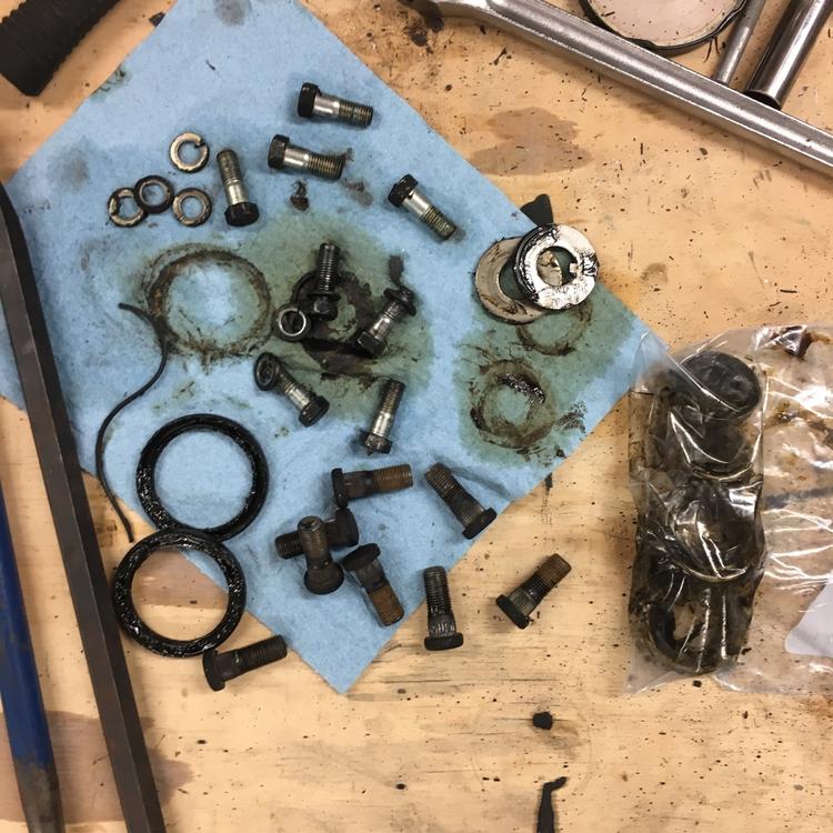

Note the helicoil that came out with this bolt:
Time-sert installation:
Finishing:

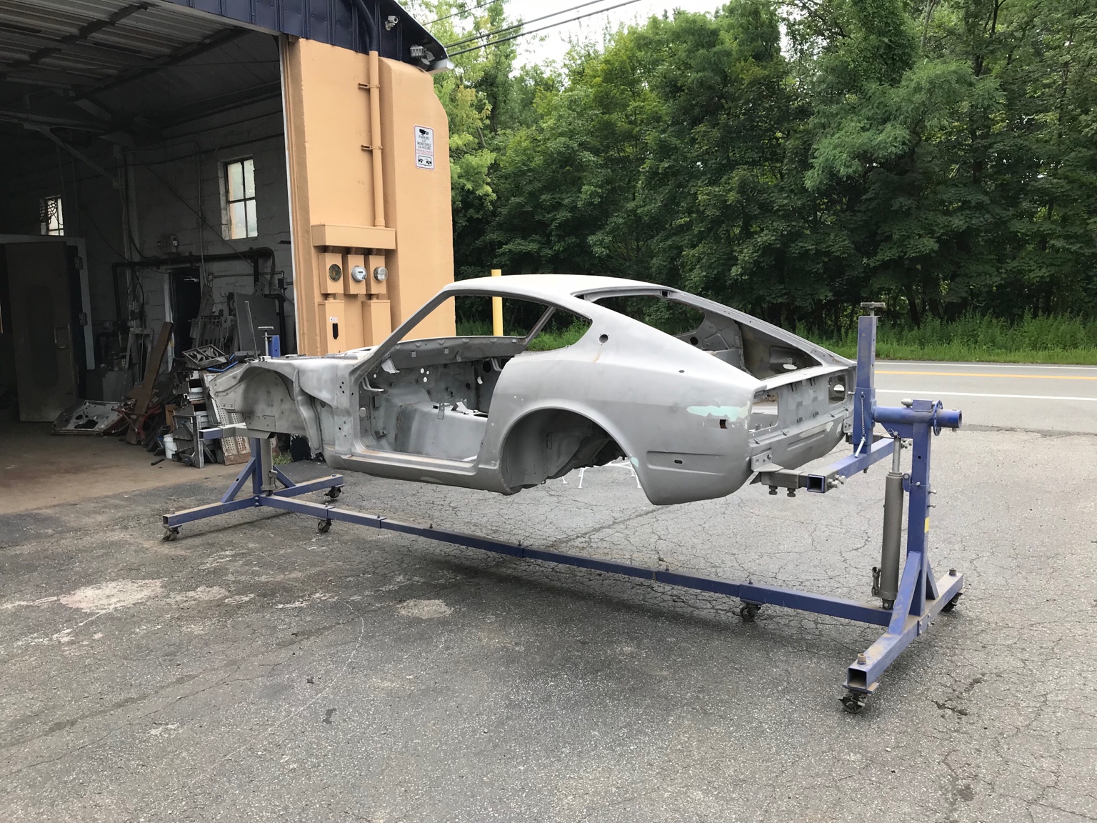

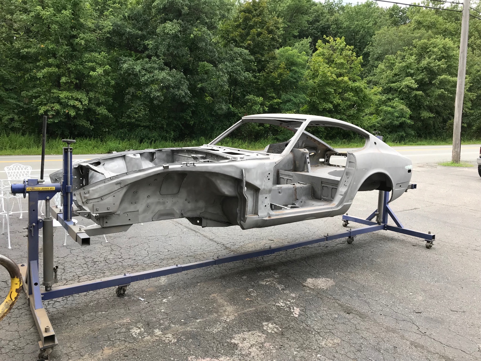

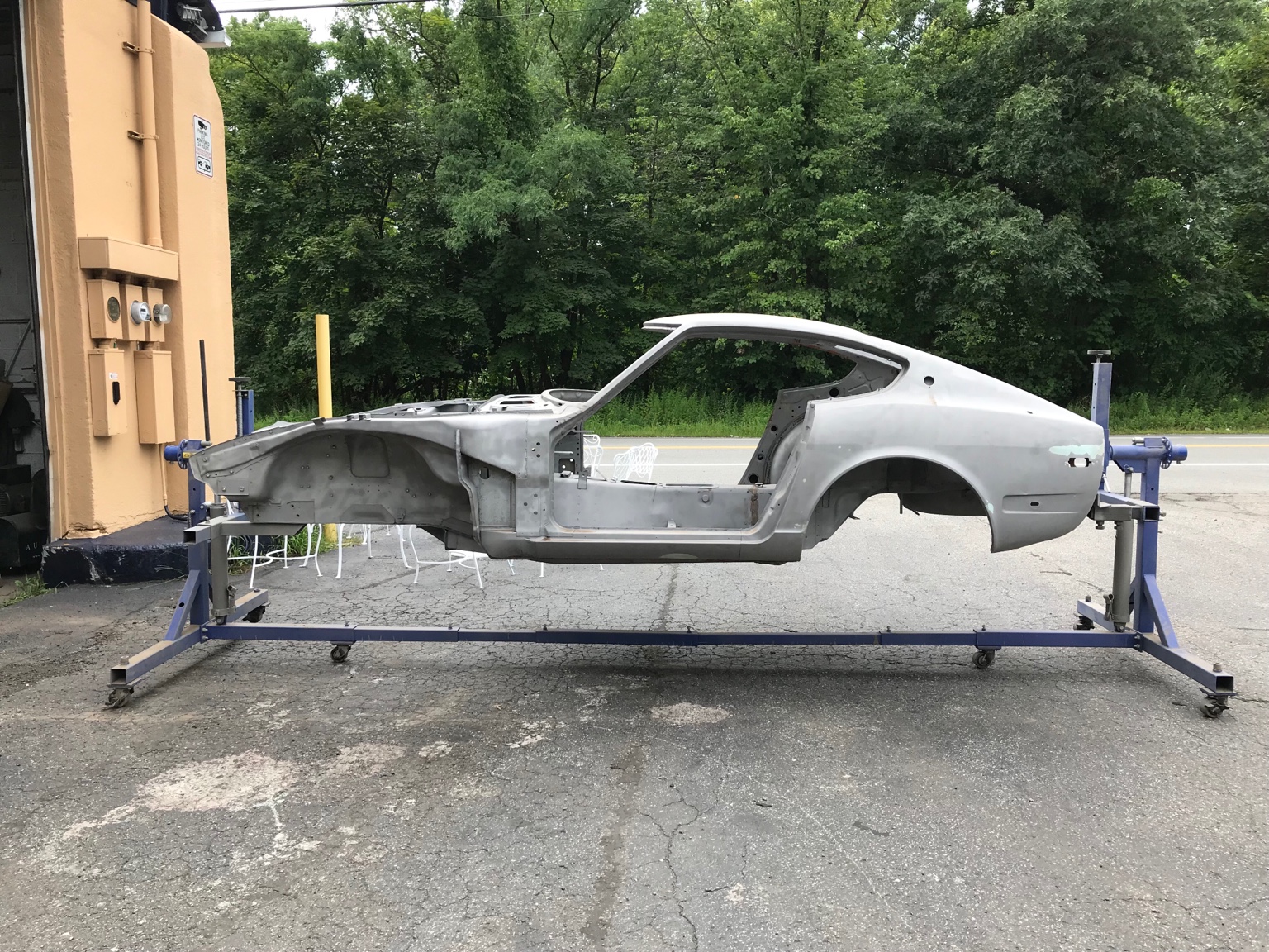

Body status:

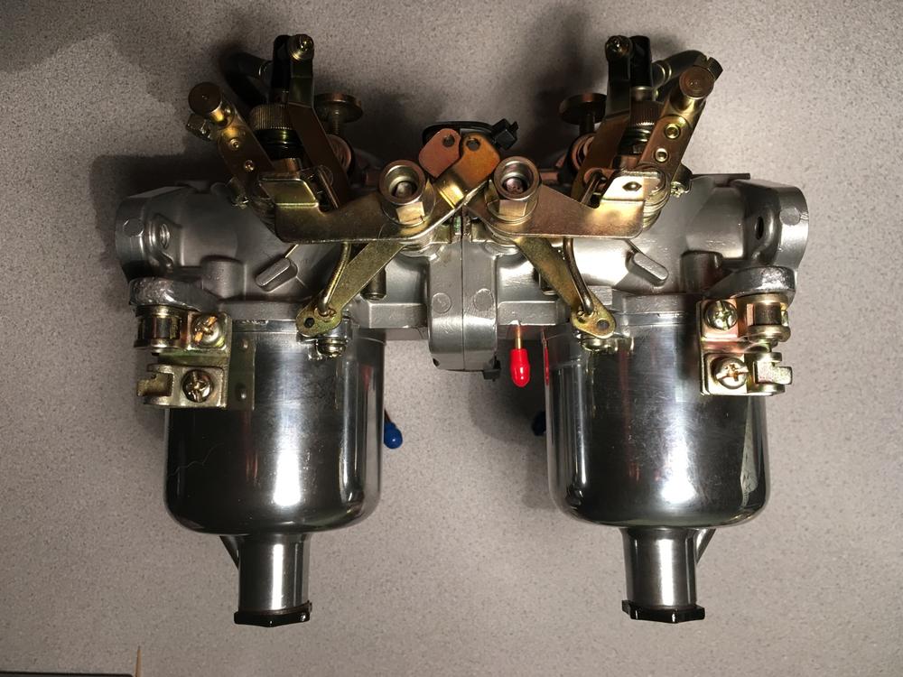

Carbs back from Z Therapy:

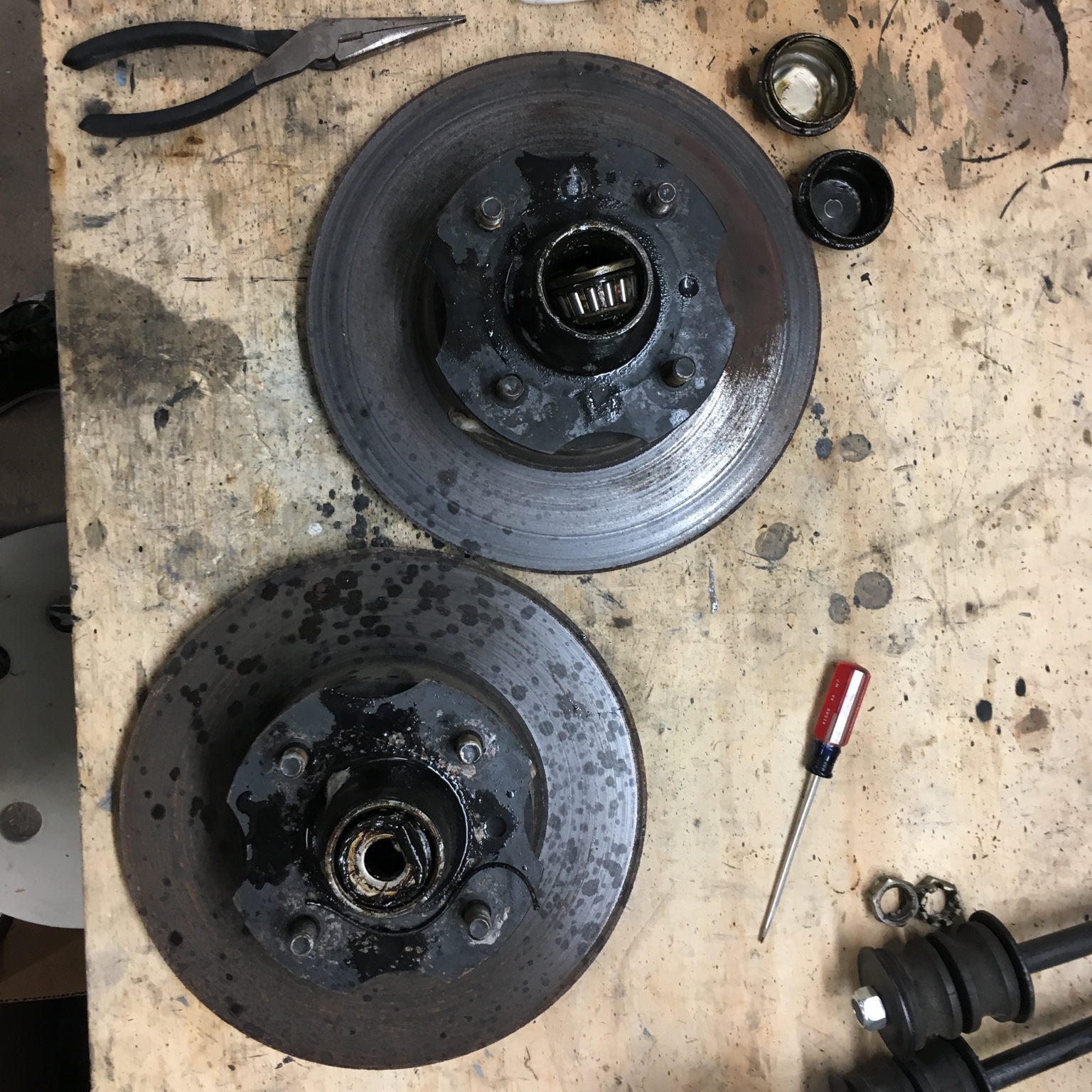

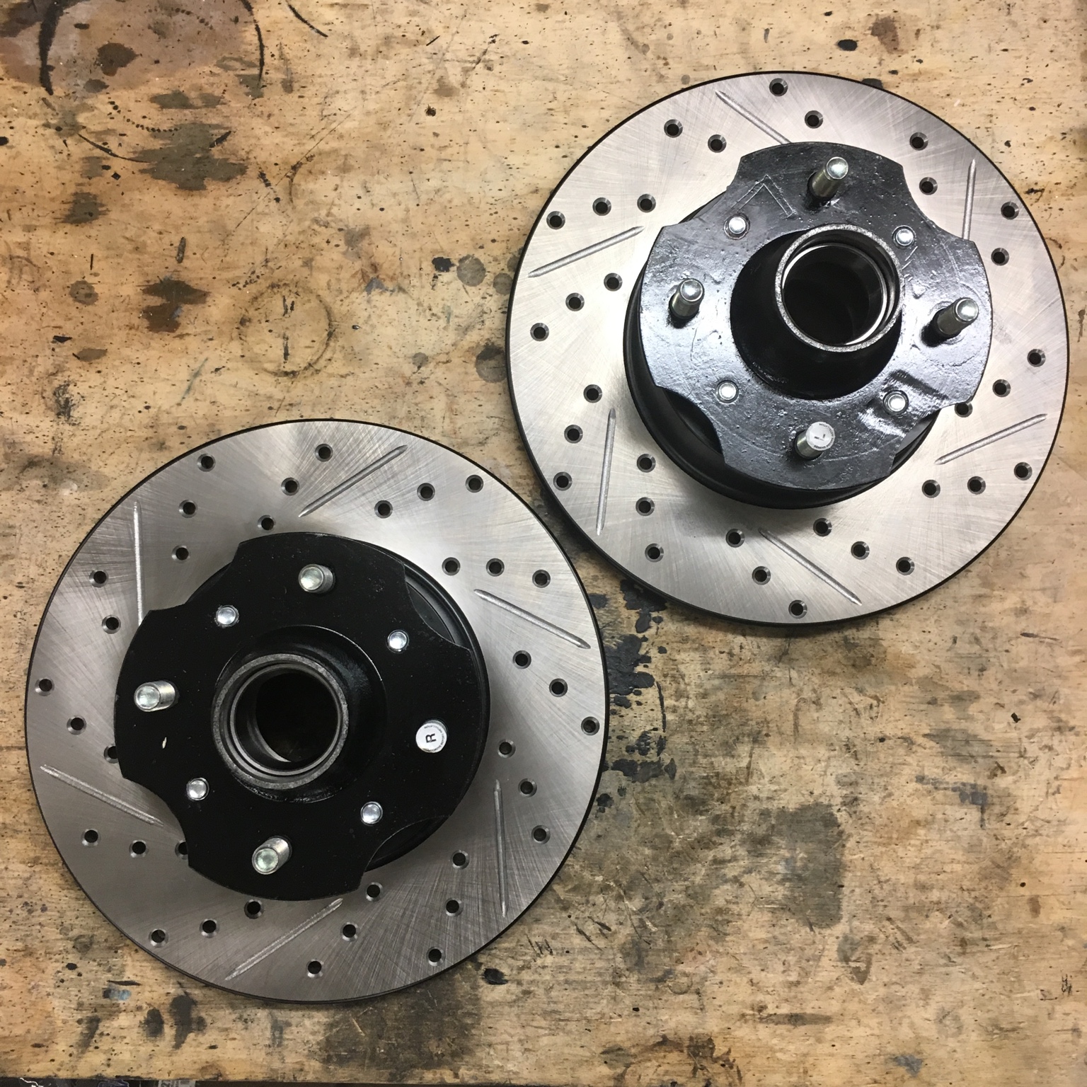

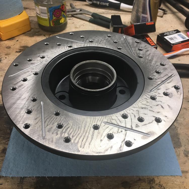

Got the hubs and rotors together...
... but...
... notice anything?
The hub bolts are protruding. They will hit the wheel if I leave them like that and prevent a solid mating surface between the hub and wheel.
This could mean one of, or a combination of, three things: the new bolts are longer than the OEM bolts, the new lock washers are thinner than the OEM lock washers, or the new rotors are thinner at the mounting point than the OEM rotors.
I’m going to pull a bolt and double check the length as soon as I have time, but I suspect that it’s the rotor. They have a recess where the bolt hole is and I think it’s too deep.
If the new bolts and washers are the same measurements as the OEM bolts I’ll have two options: grind the bolts shorter or find thicker lock washers.
