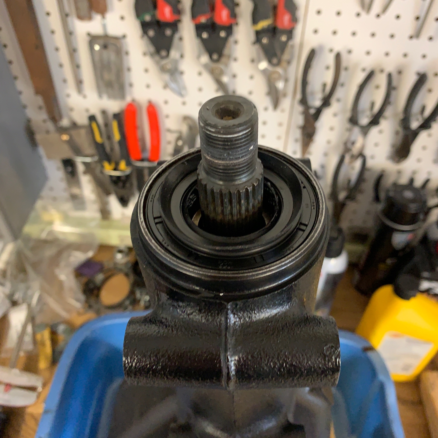

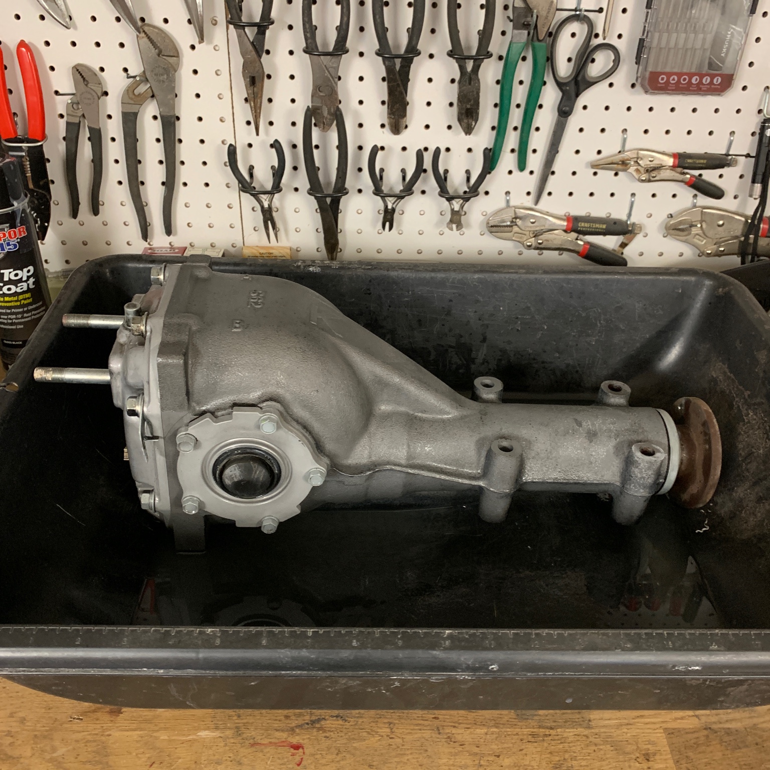

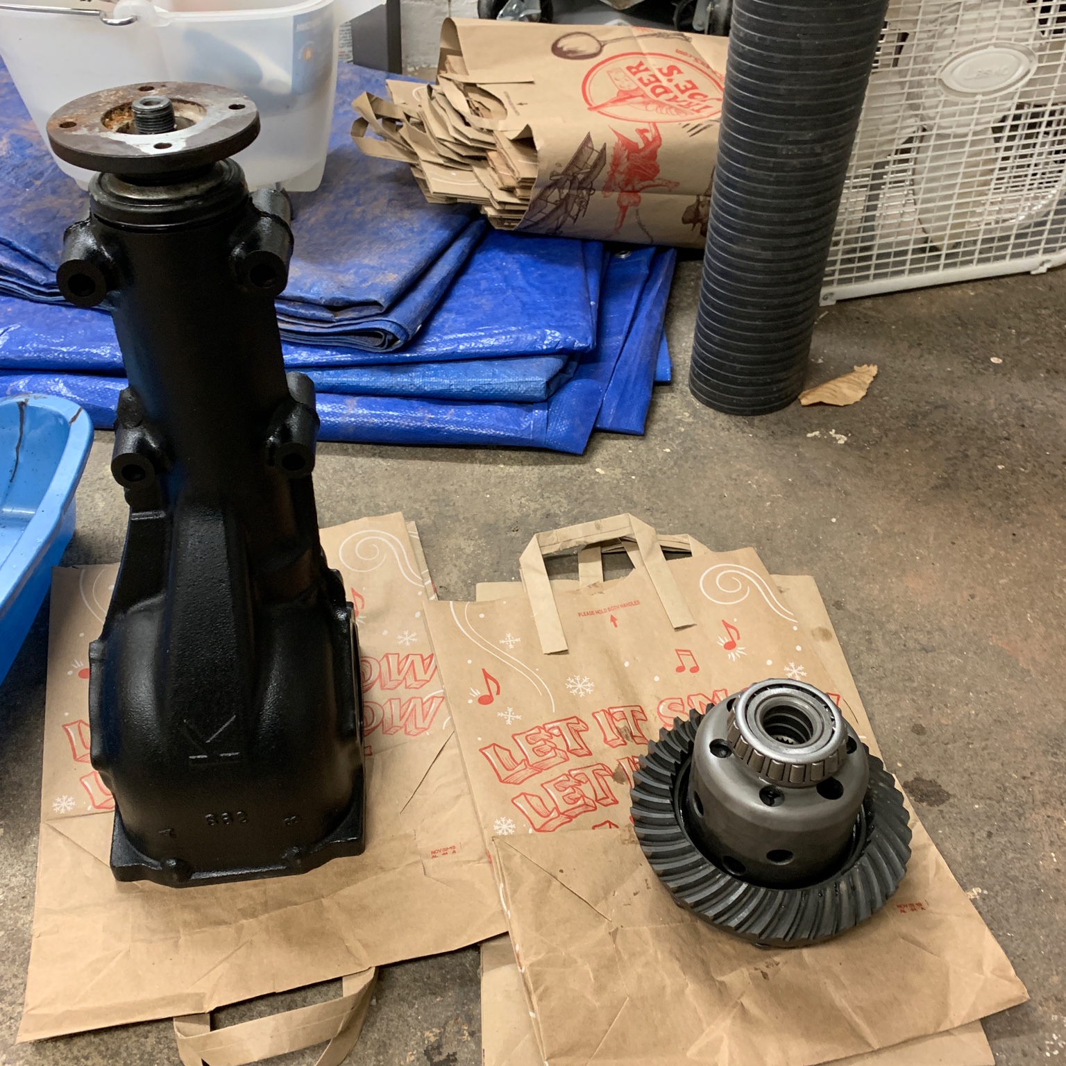

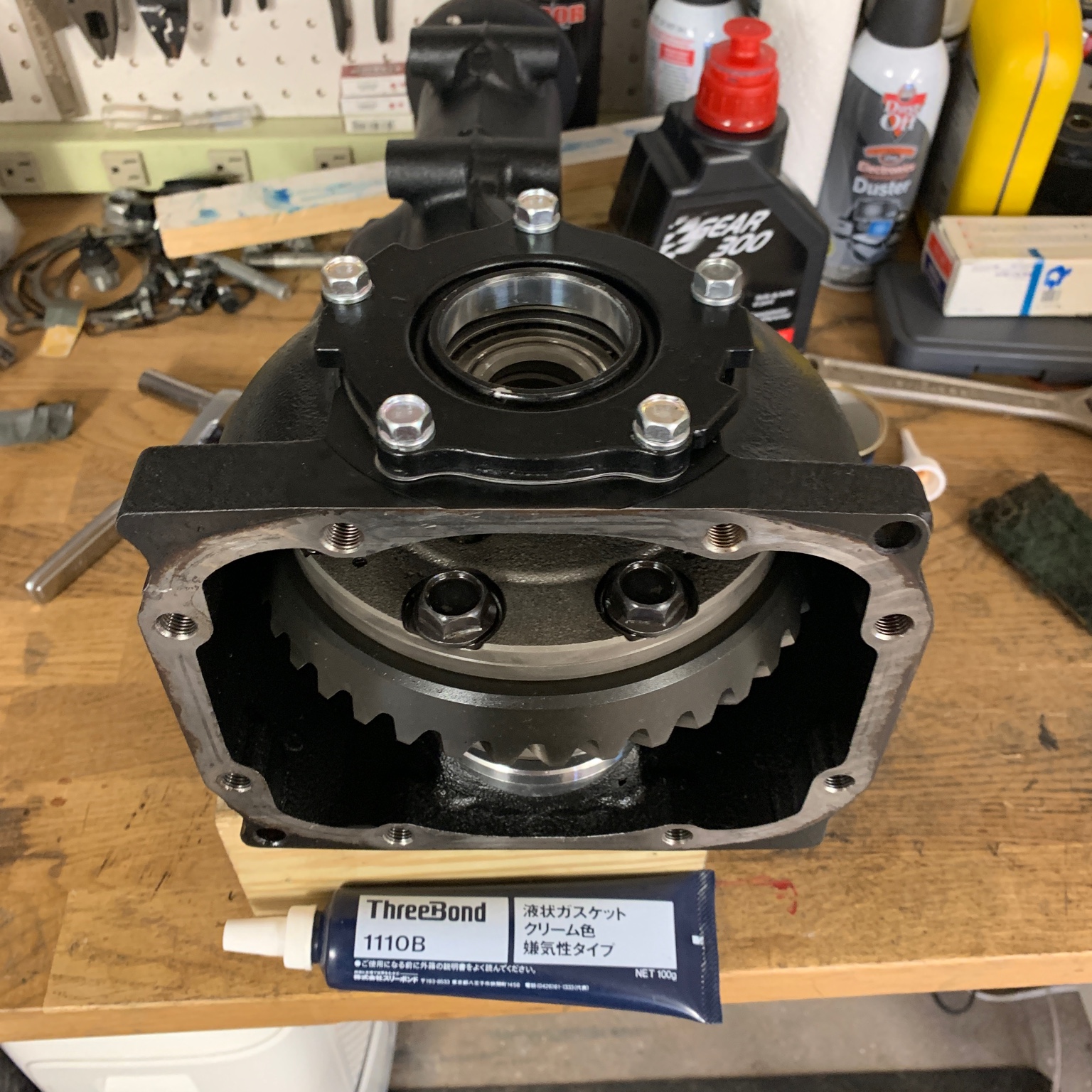

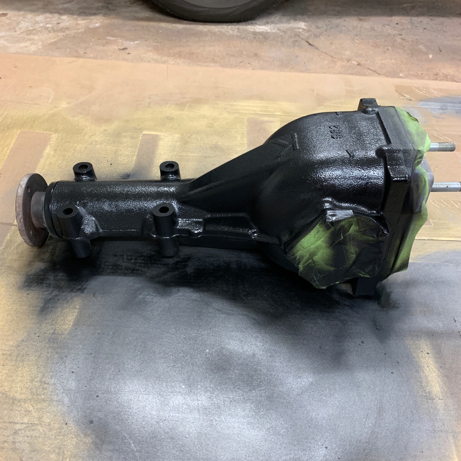

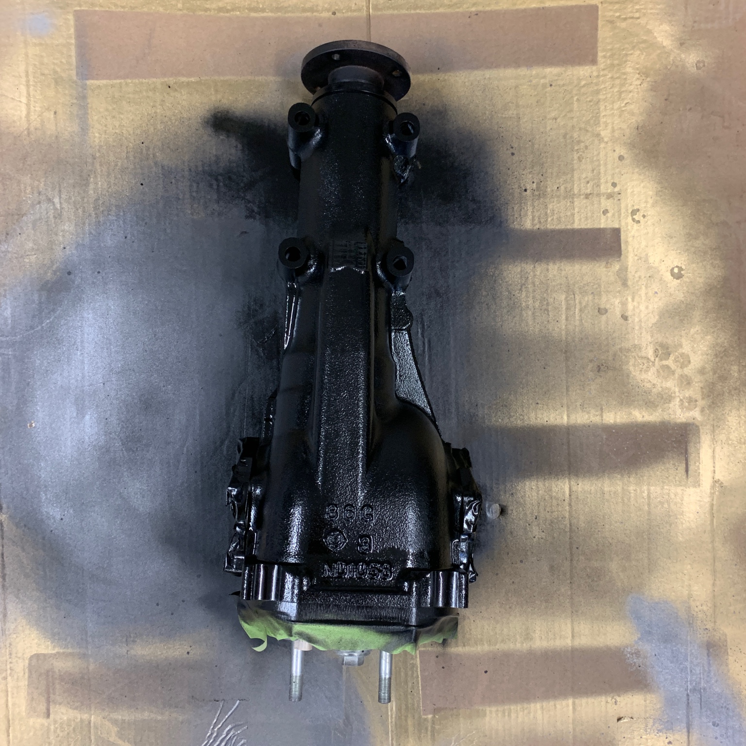

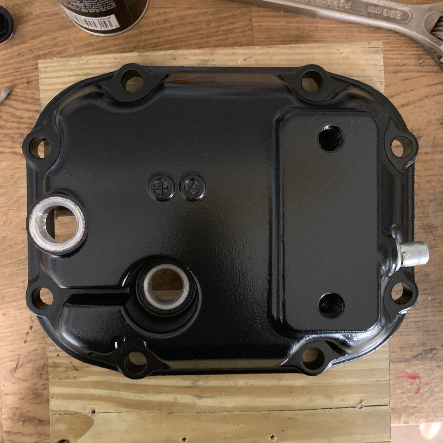

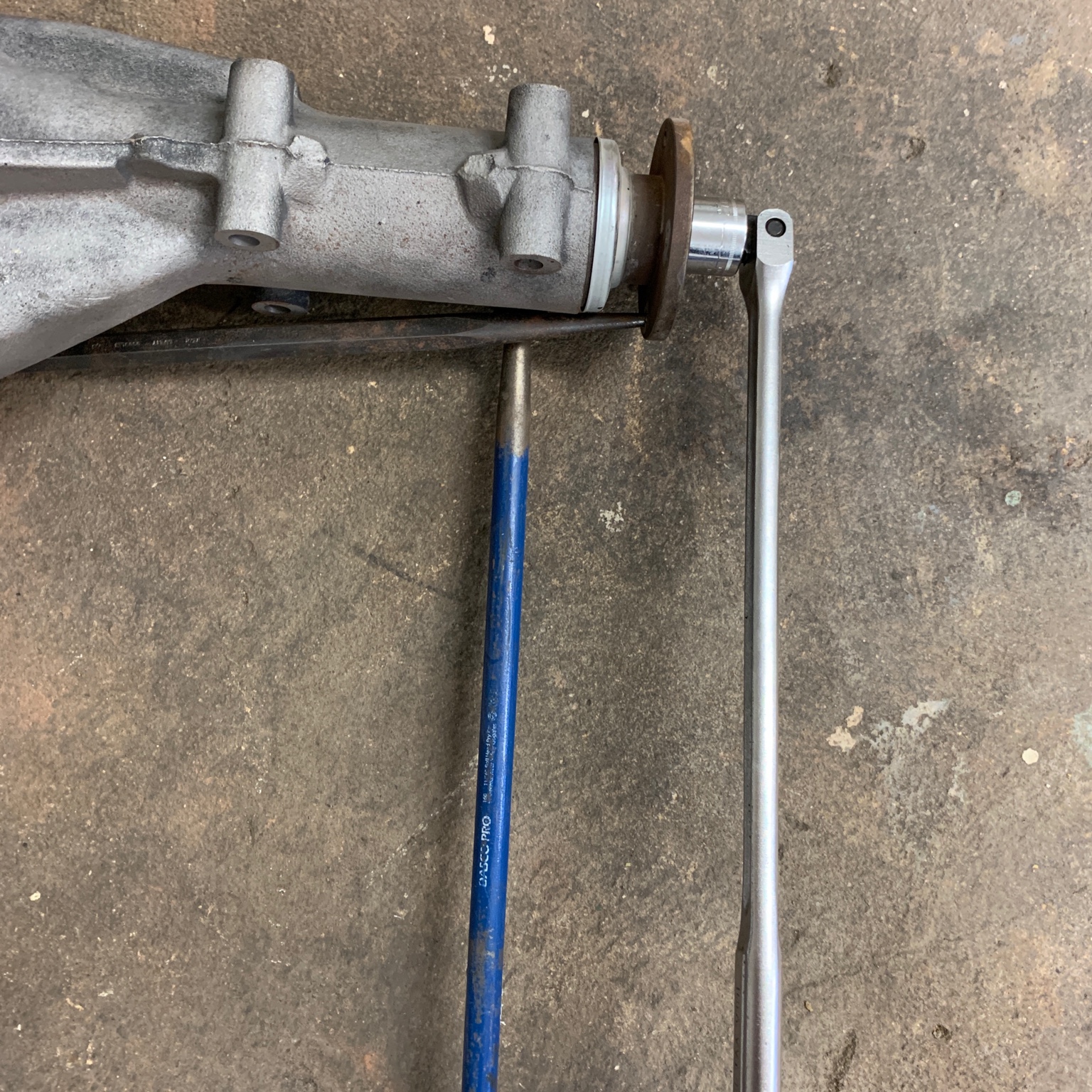

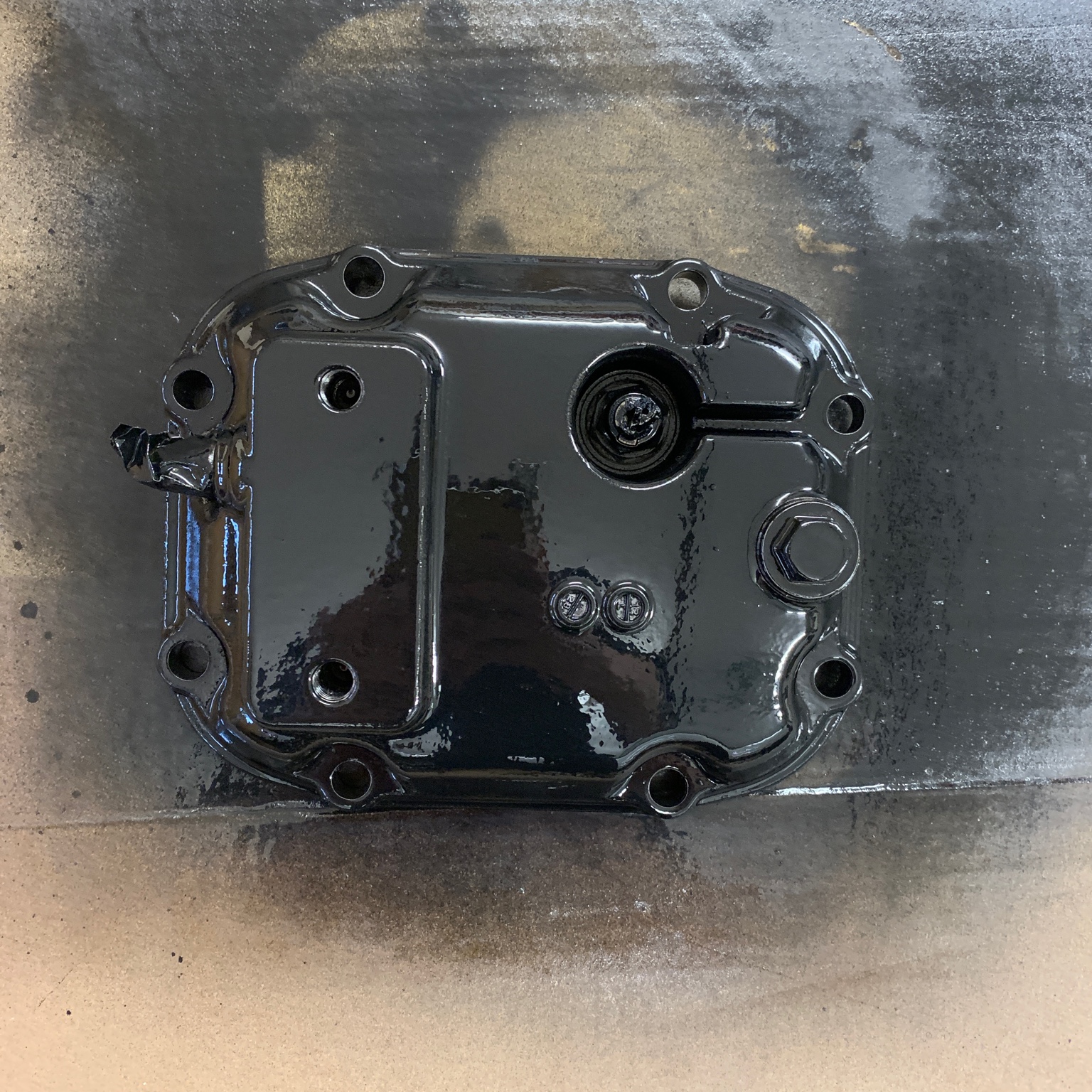

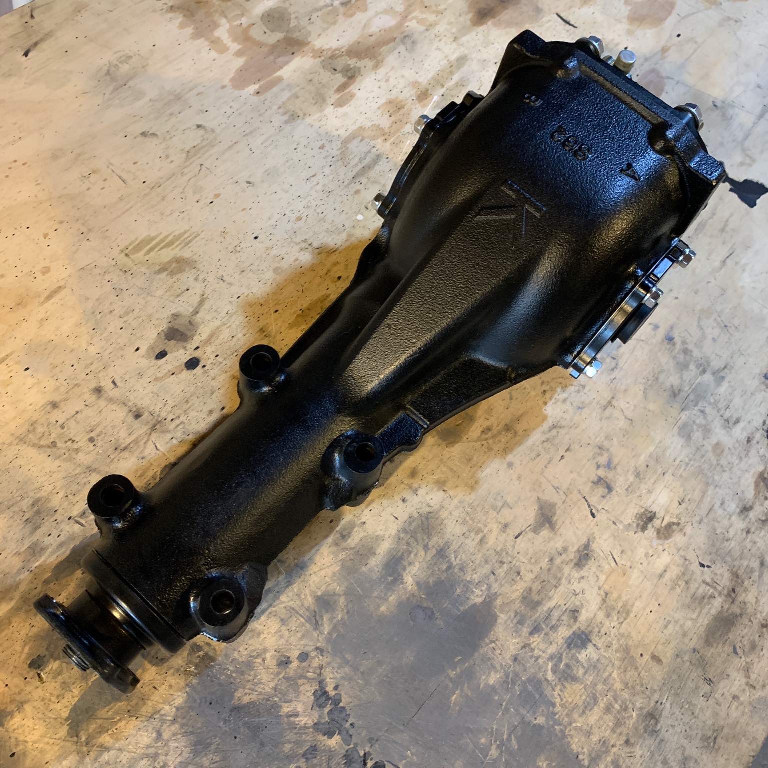

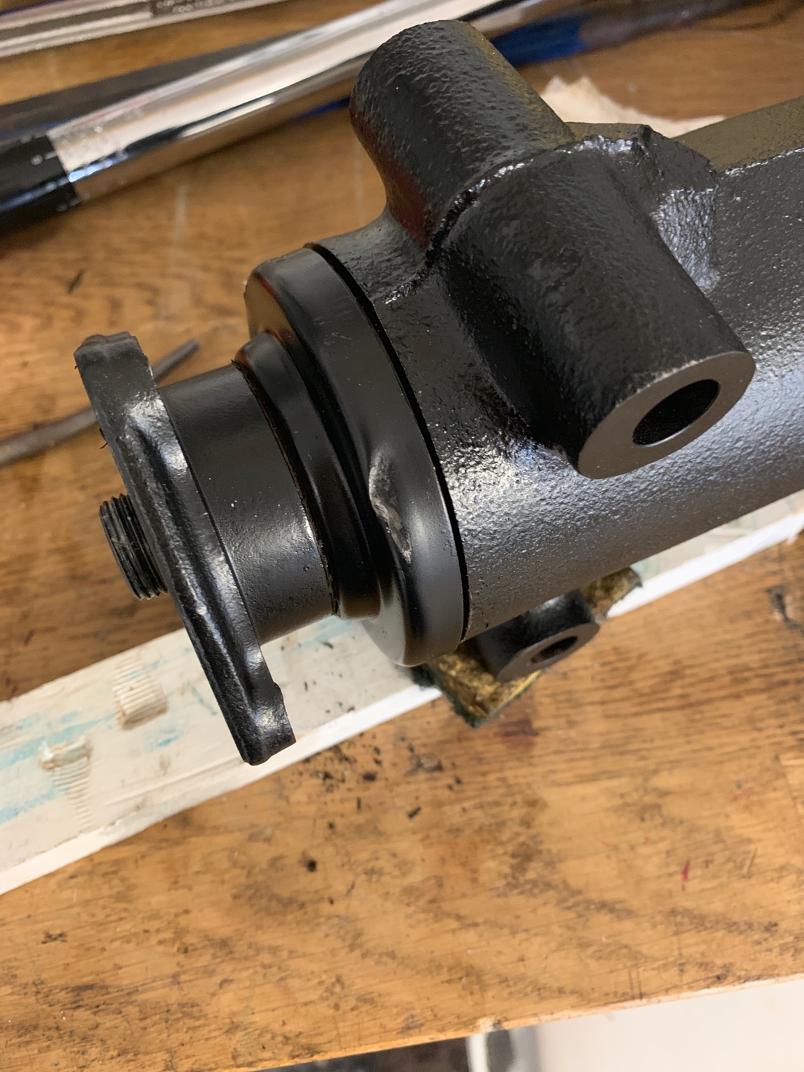

March 24, 20196 yr Author comment_571753 Update: So the Subaru dif is mostly done. It needs to be flushed again and I think the cover gasket is leaking, but since I bent the dust shroud on the input flange I’m putting this in storage until I’m in the mood to mess with it again. It needs to be sitting on the wheels to get that front lock nut torqued to 195 nm, otherwise I’m only going to continue messing up my hard work (see 2nd to last image). Link to comment https://www.classiczcars.com/forums/topic/51541-1973-rebuild/?&page=66#findComment-571753 Share on other sites More sharing options...

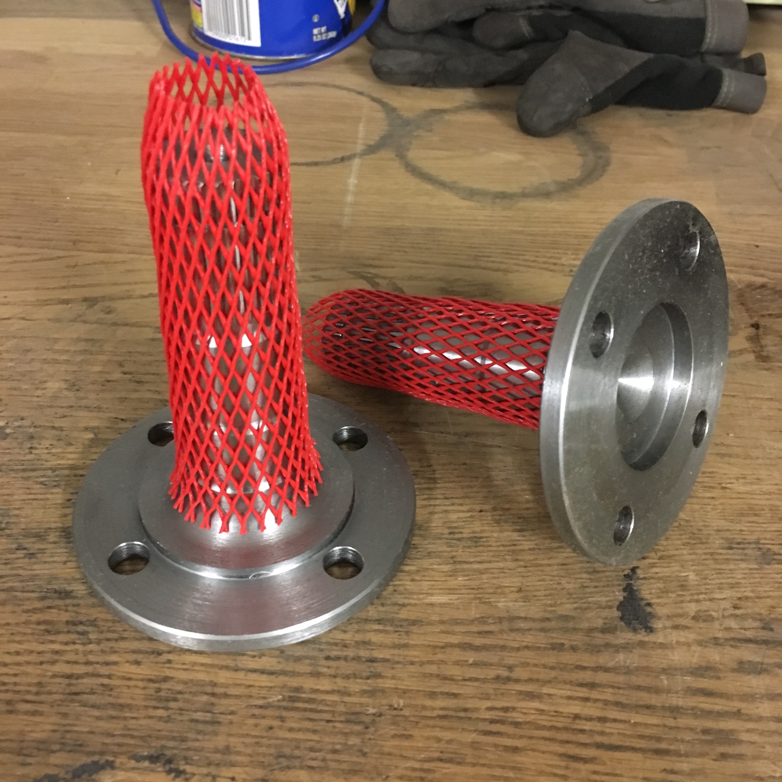

March 24, 20196 yr comment_571762 What are you using for half shafts? Link to comment https://www.classiczcars.com/forums/topic/51541-1973-rebuild/?&page=66#findComment-571762 Share on other sites More sharing options...

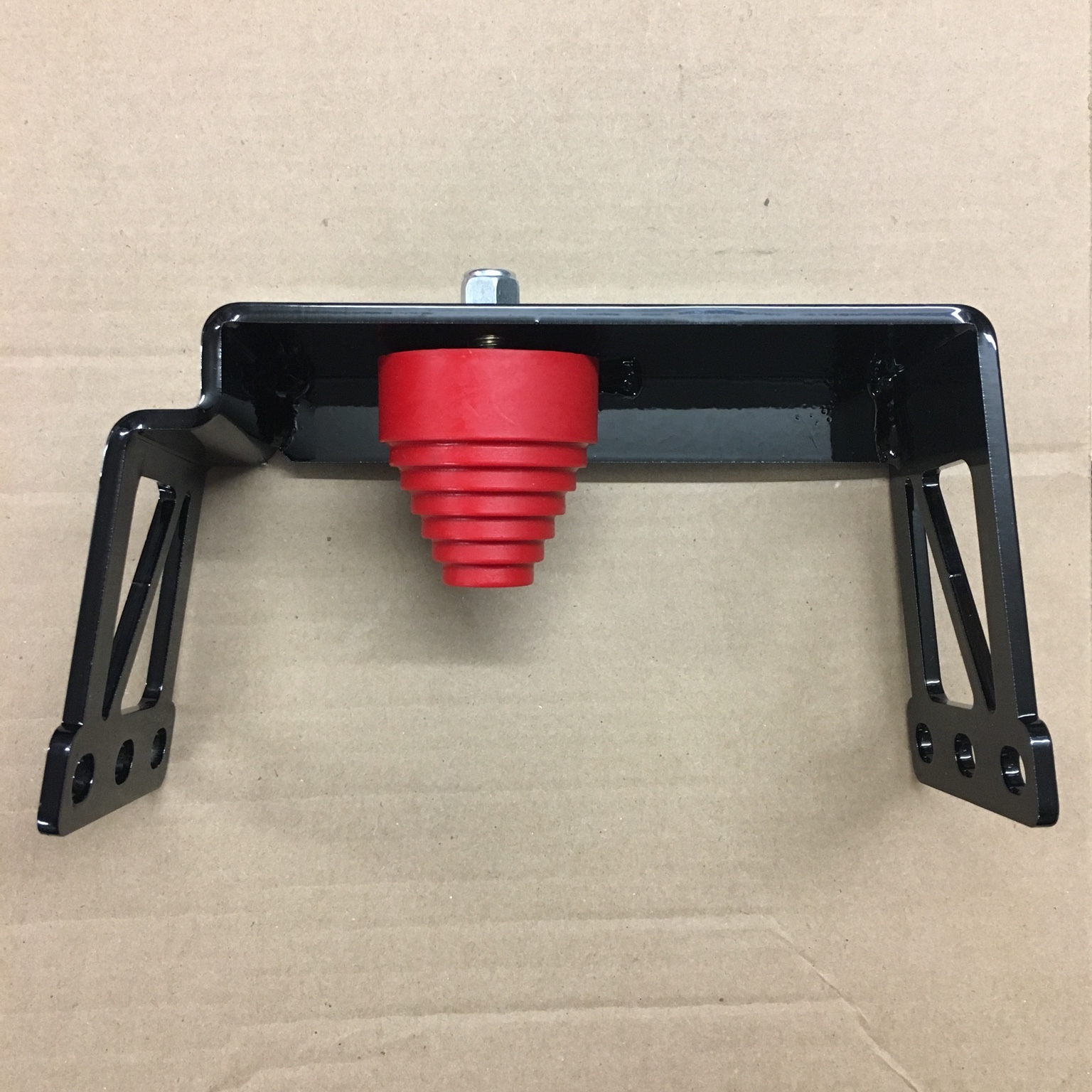

March 24, 20196 yr Author comment_571763 I picked up some way back. Can’t remember who from. I think Z car depot.I also using one of these: Link to comment https://www.classiczcars.com/forums/topic/51541-1973-rebuild/?&page=66#findComment-571763 Share on other sites More sharing options...
March 24, 20196 yr comment_571770 So those stub axles will mate up to the original halfshafts... Link to comment https://www.classiczcars.com/forums/topic/51541-1973-rebuild/?&page=66#findComment-571770 Share on other sites More sharing options...

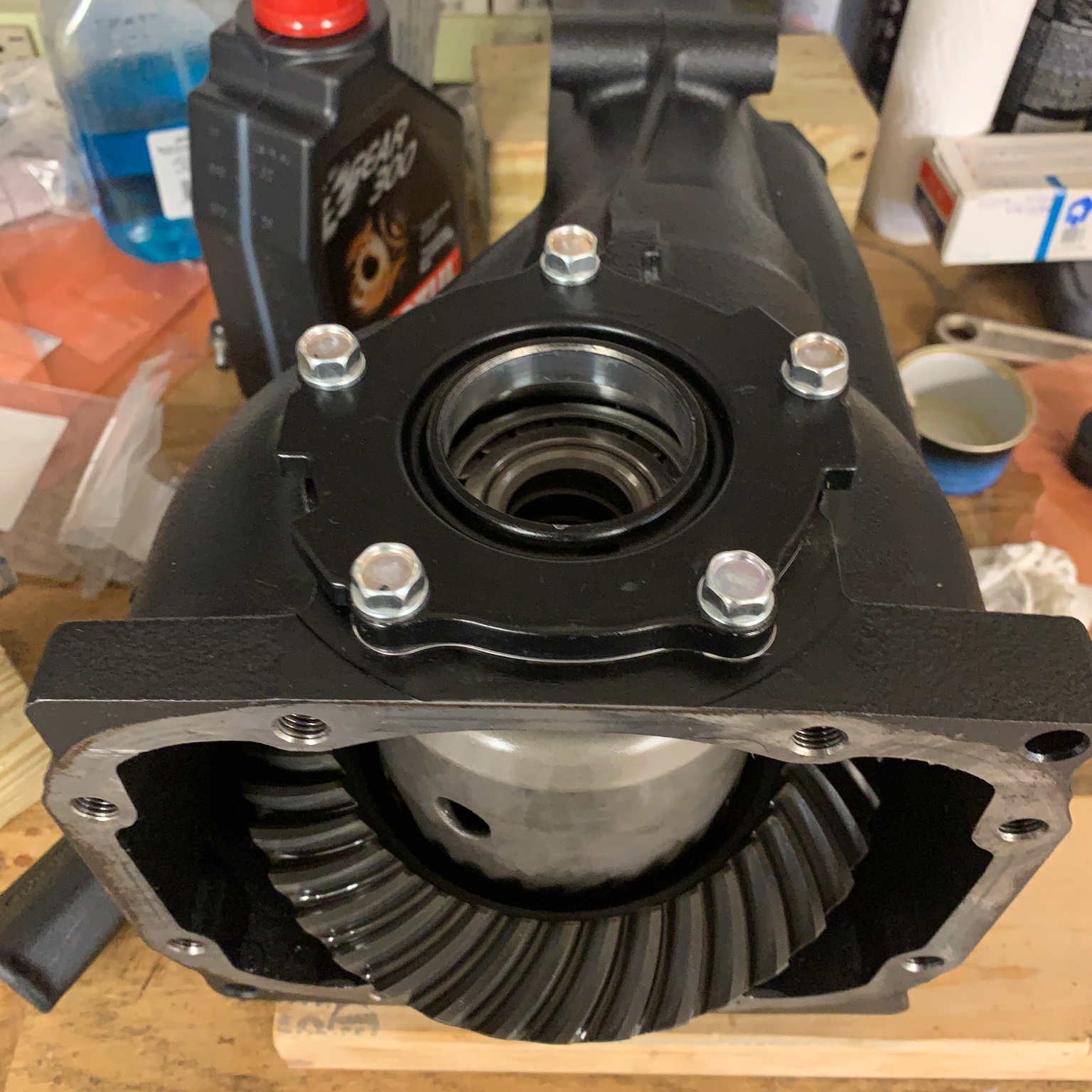

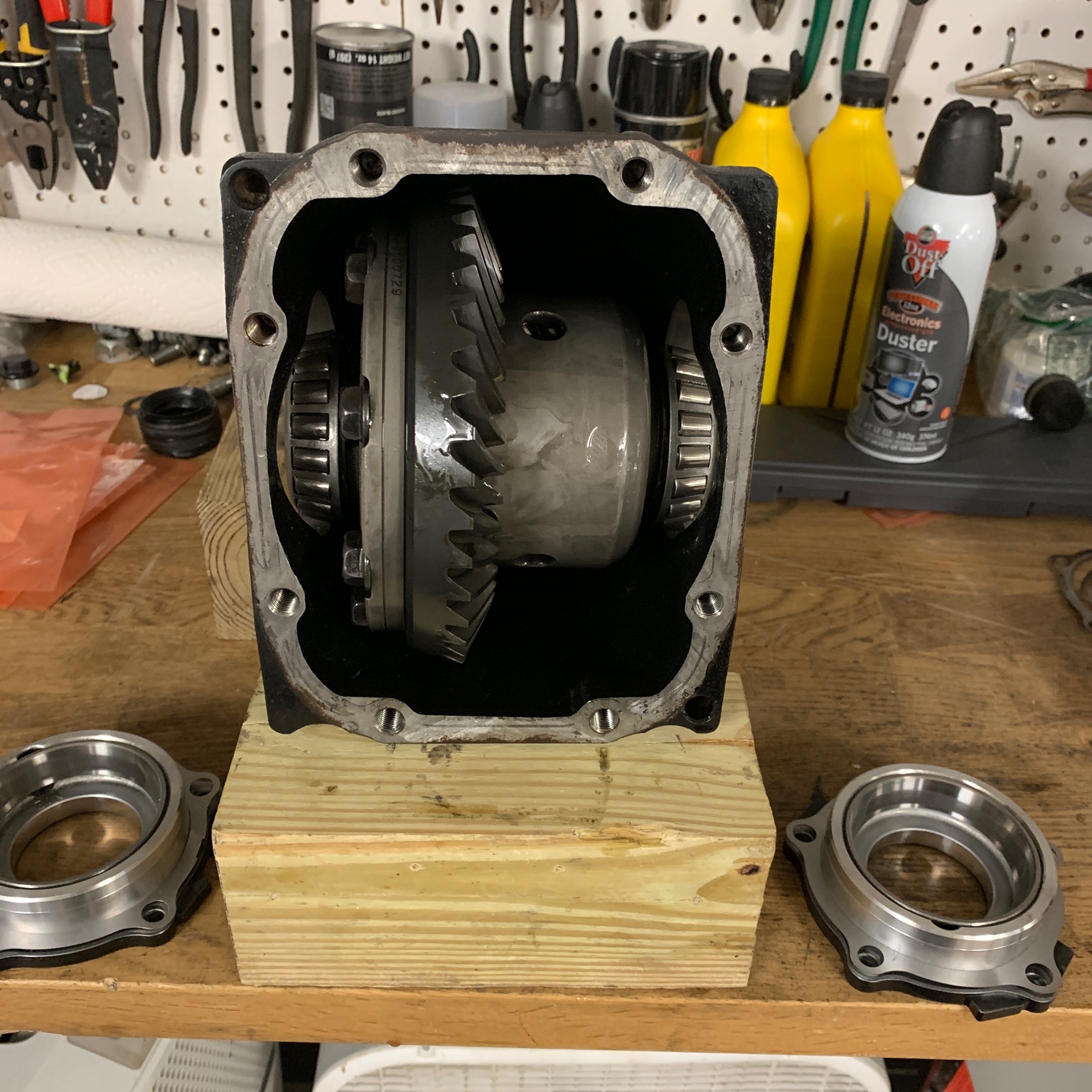

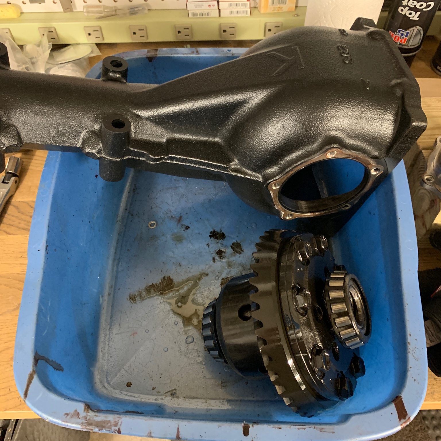

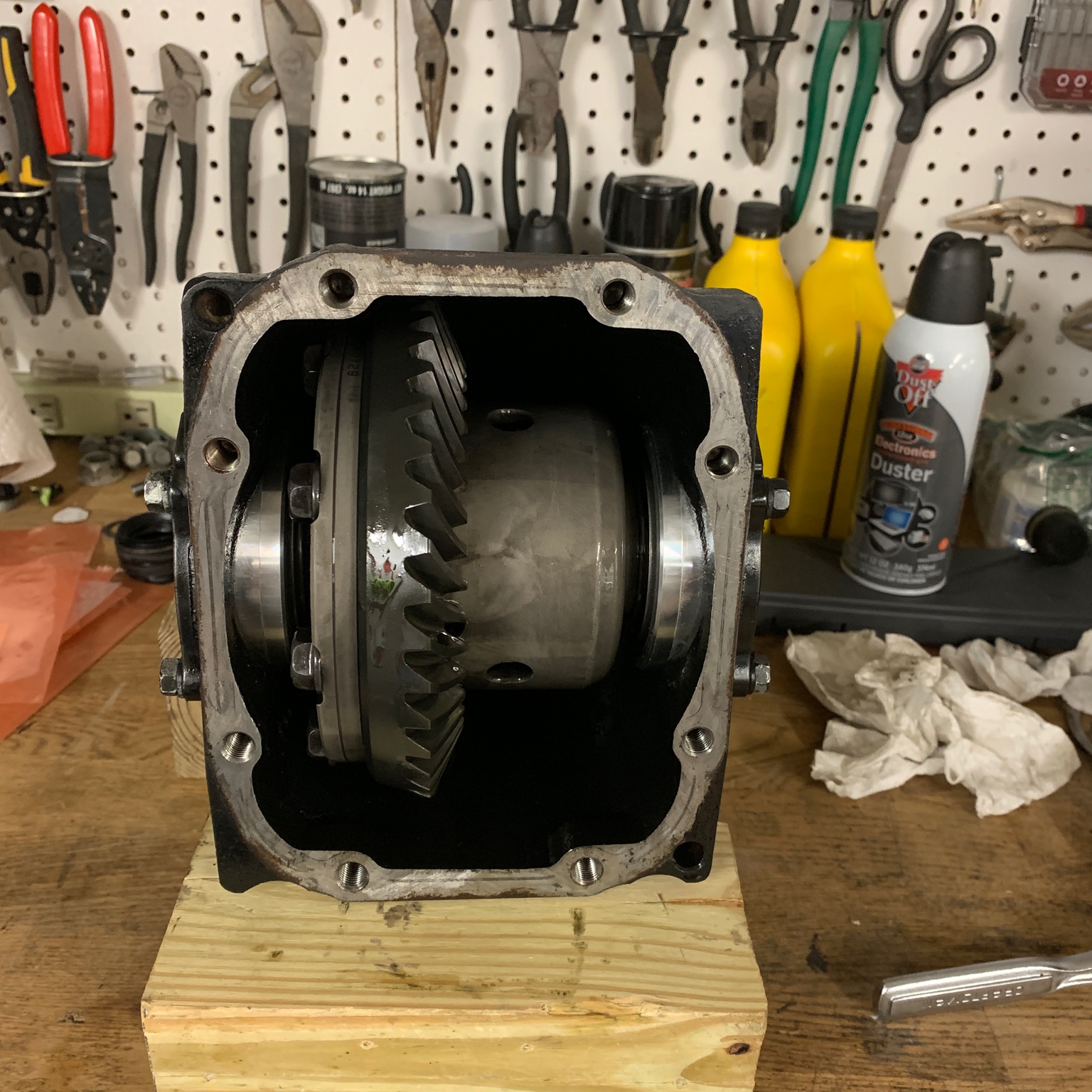

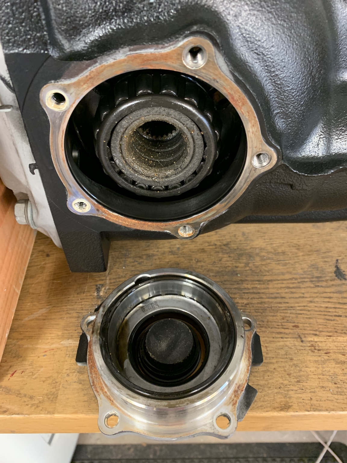

March 24, 20196 yr comment_571771 What was the purpose of removing the carrier from the diff? Link to comment https://www.classiczcars.com/forums/topic/51541-1973-rebuild/?&page=66#findComment-571771 Share on other sites More sharing options...

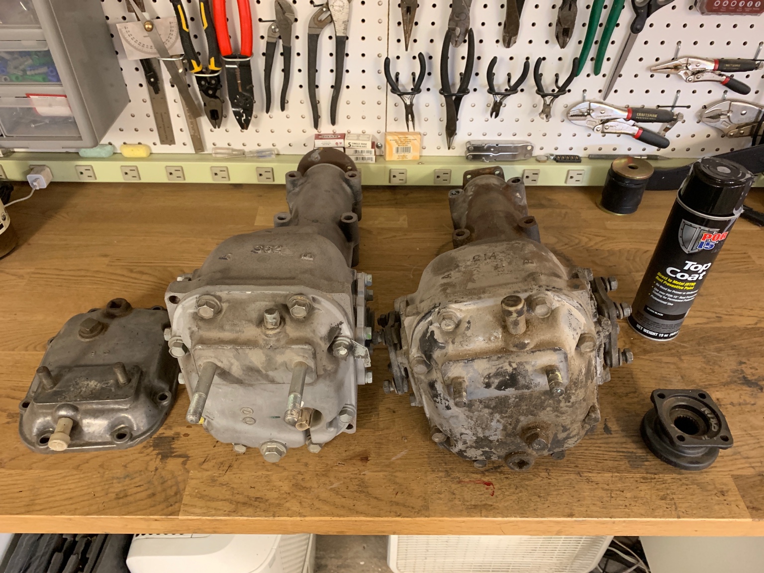

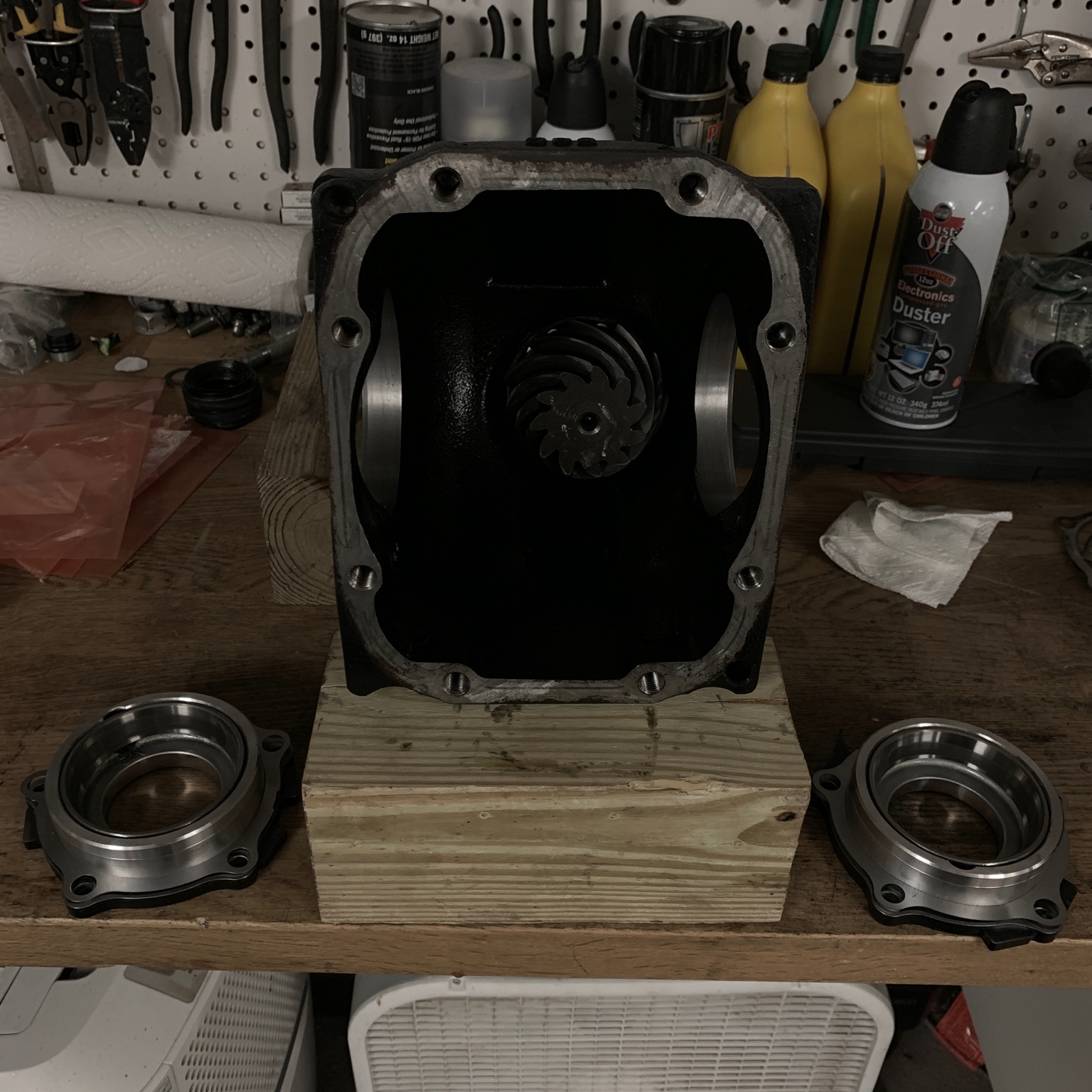

March 25, 20196 yr Author comment_571832 The diff had been sitting outdoors with no axels and was full of mud. I took it apart to clean it out, inspect it for wear and rust, and replace all the seals and whatnot. Thankfully it had enough grease on it that everything was peachy. Edited March 25, 20196 yr by Matthew Abate Link to comment https://www.classiczcars.com/forums/topic/51541-1973-rebuild/?&page=66#findComment-571832 Share on other sites More sharing options...
