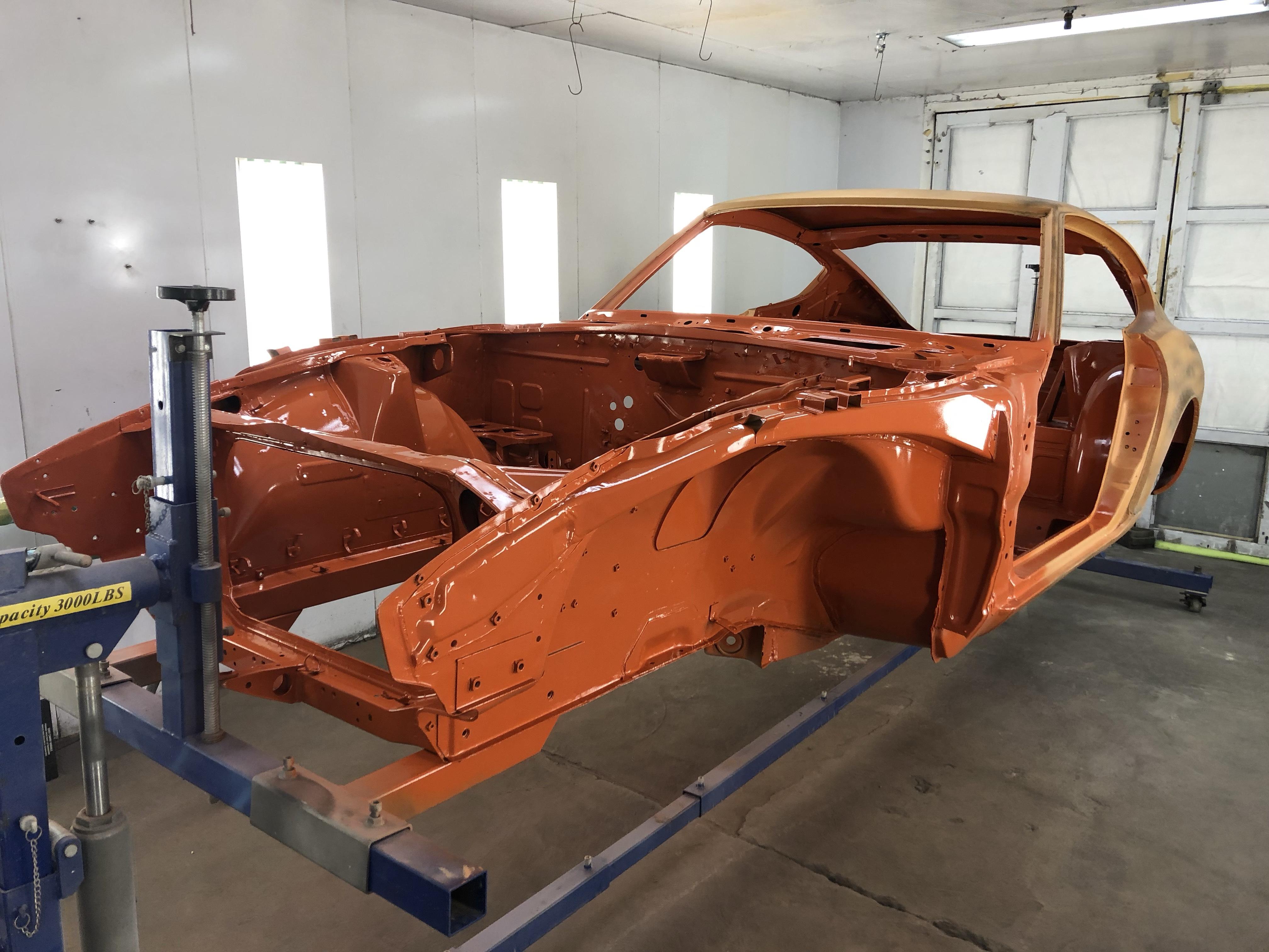

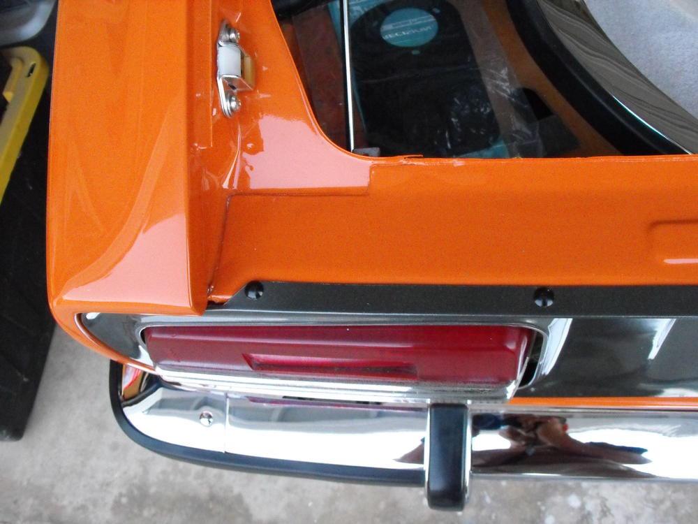

Did you go with #918?  That's what i have and it has a brownish tint too.  It looks darn good though to me.  Here's a shot of mine right after a cutting and wax.
Yes, 918. It looks great, I just hadn’t seen it up close in real life. I’ve only seen one 918 Z in my life and it was 200ft away going the opposite direction on an interstate.
I'm stoked for it, but I was a bit surprised by it. The photos you find online are no way to tell, and it wasn’t the original orange when I bought it.
I held this photo (found somewhere on this site) up to the samples and they were really close:
Edited by Matthew Abate

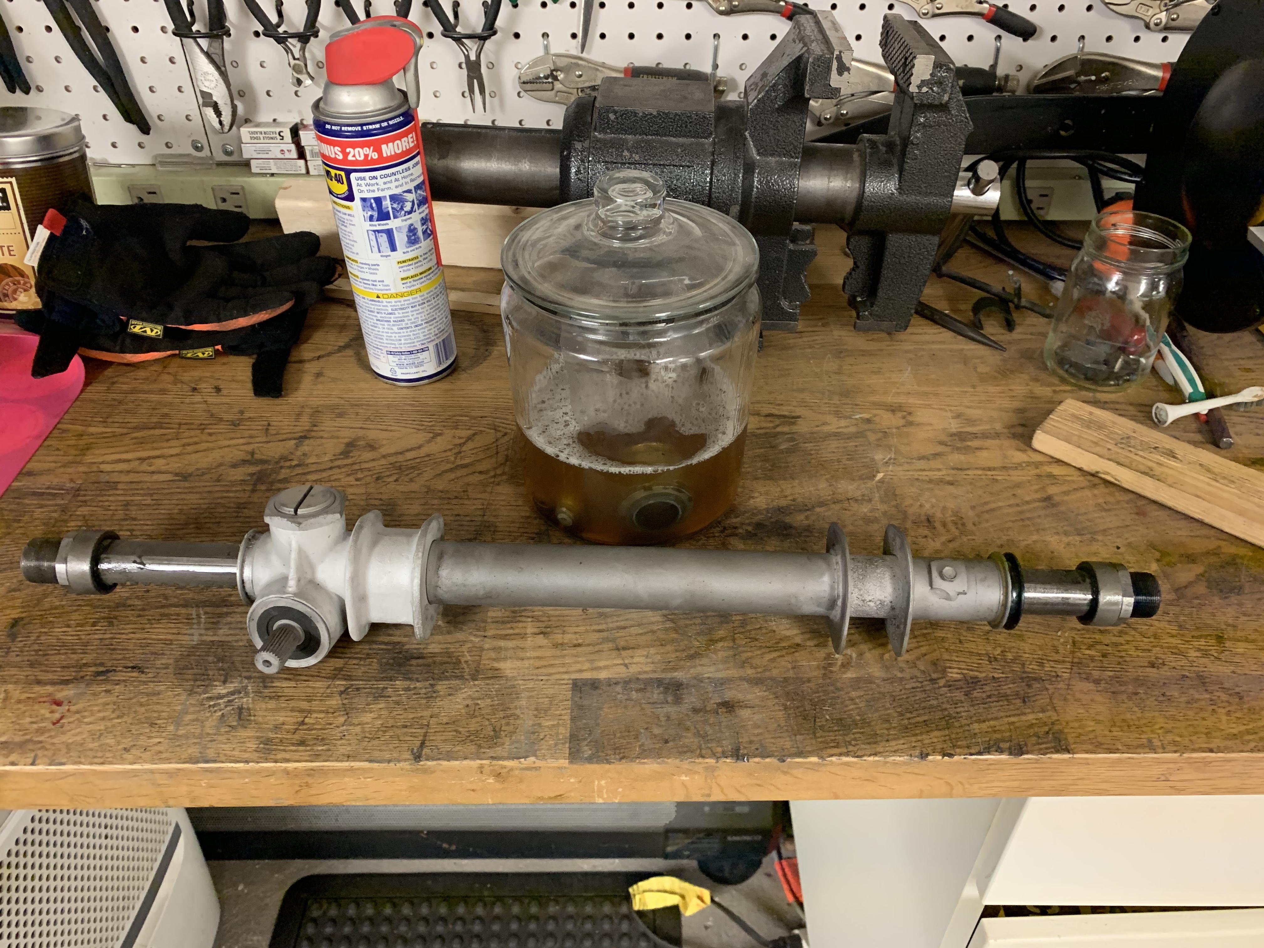

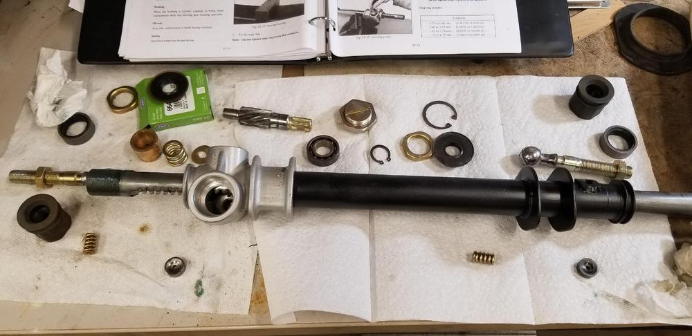

Okay, so this is where I’m at so far with the rack:

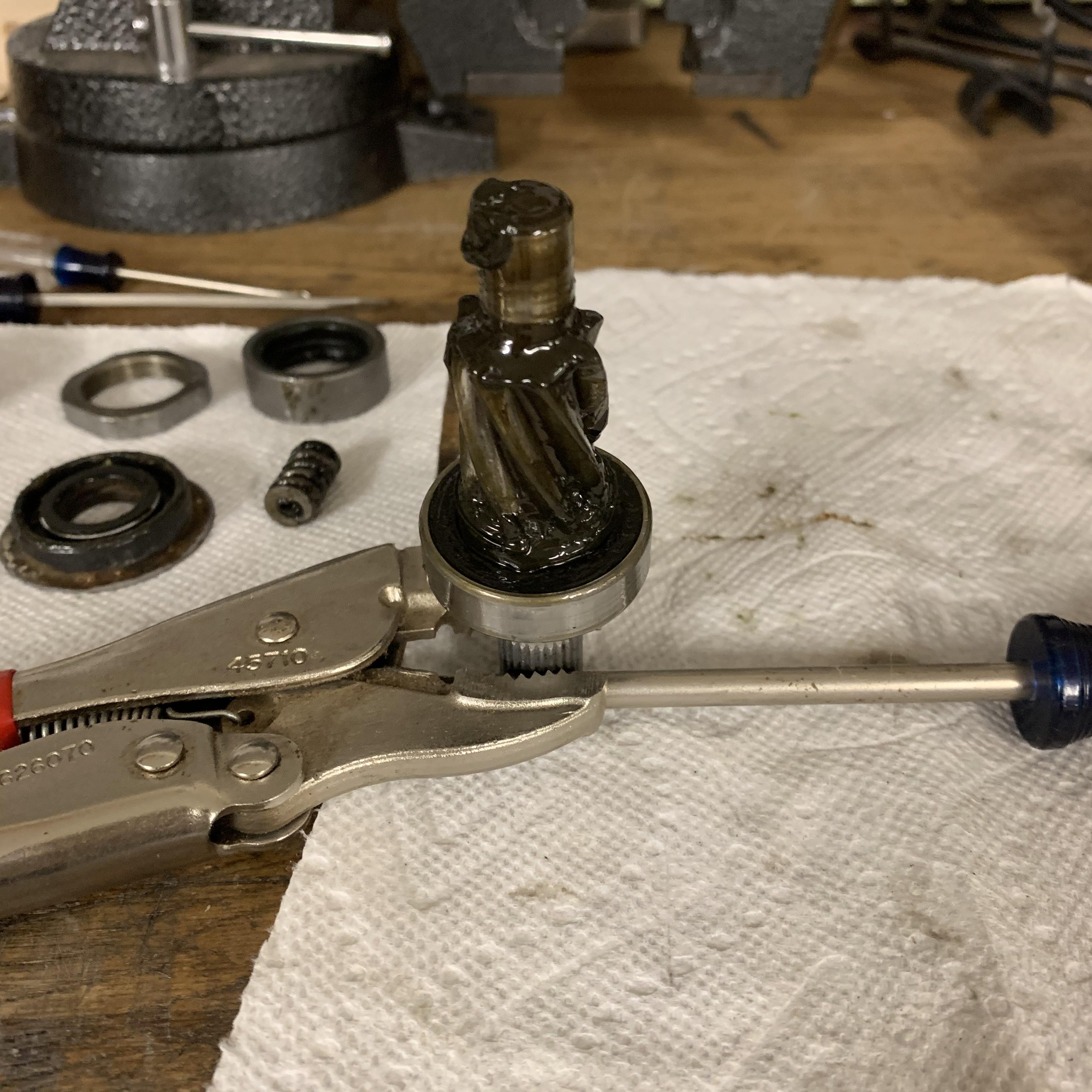

I used vice grips to clamp a screwdriver in the divot in the pinion. I placed a set of old crappy channel locks on that to be an anvil for a brass hammer and gently tapped it out, pinion pointing down. Everything else was a breeze to take apart.

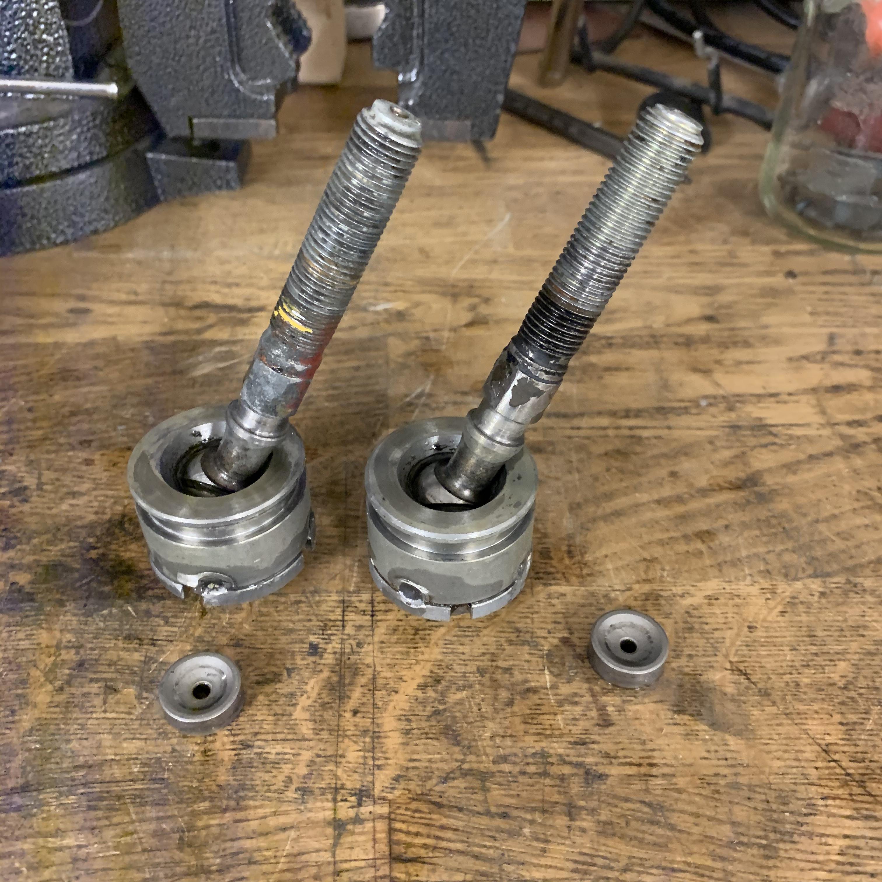

The grease is pretty chunky, but it’s not crusty. I think these are original inner tie rod ends after comparing to other threads, so I’m thinking it’s never been disassembled. Anyone know?

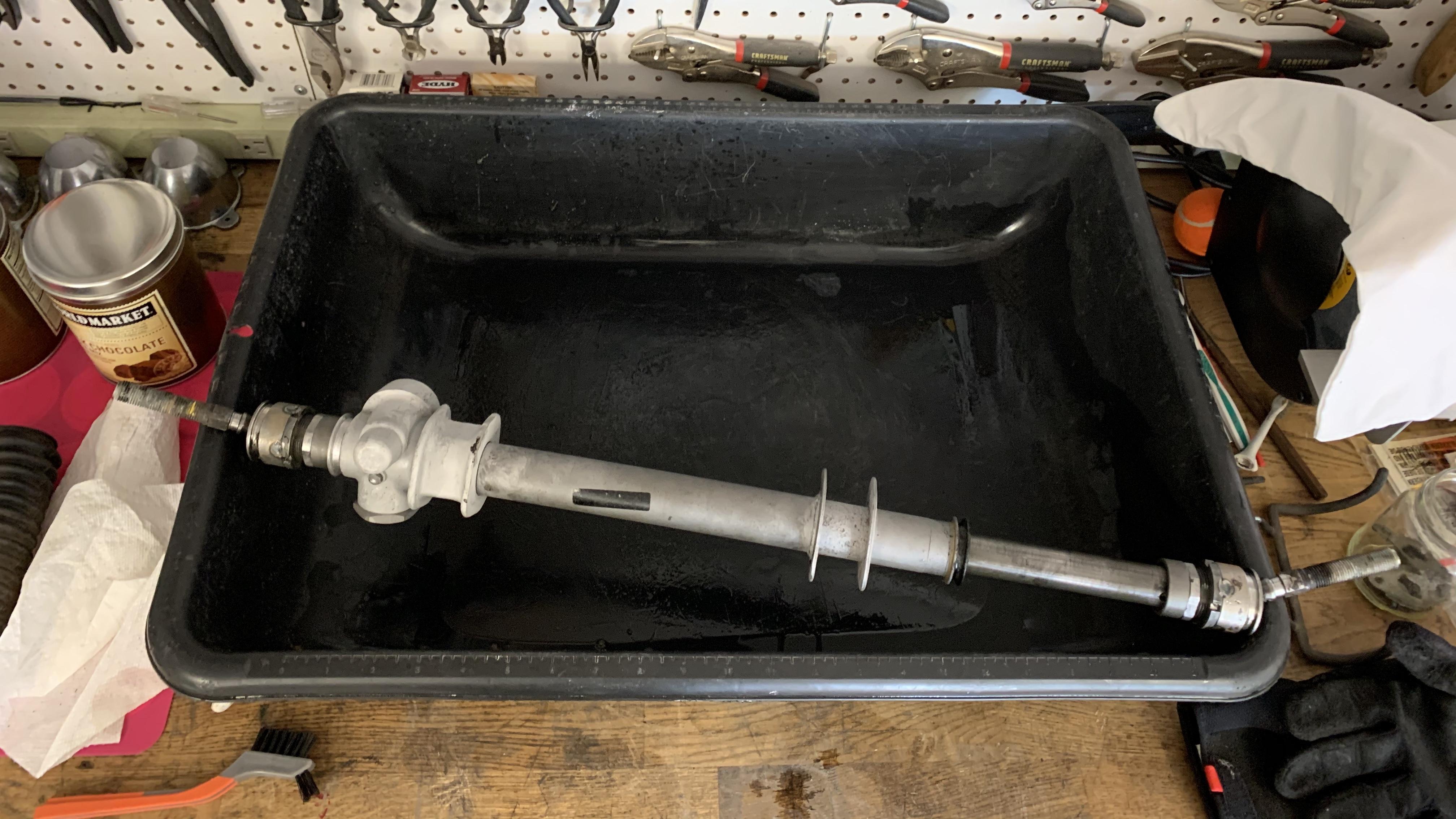

Right now everything is sitting in a coat of WD-40 so it does not flash rust after the quick bath I gave it all. I’ll clean it for real later.
Mine did not look like that. Those look to have the four welds around the perimeter like CO disassembled.Unless the 73 was different than a 71, I would say those have already been replaced once. Mine could be fully disassembled.

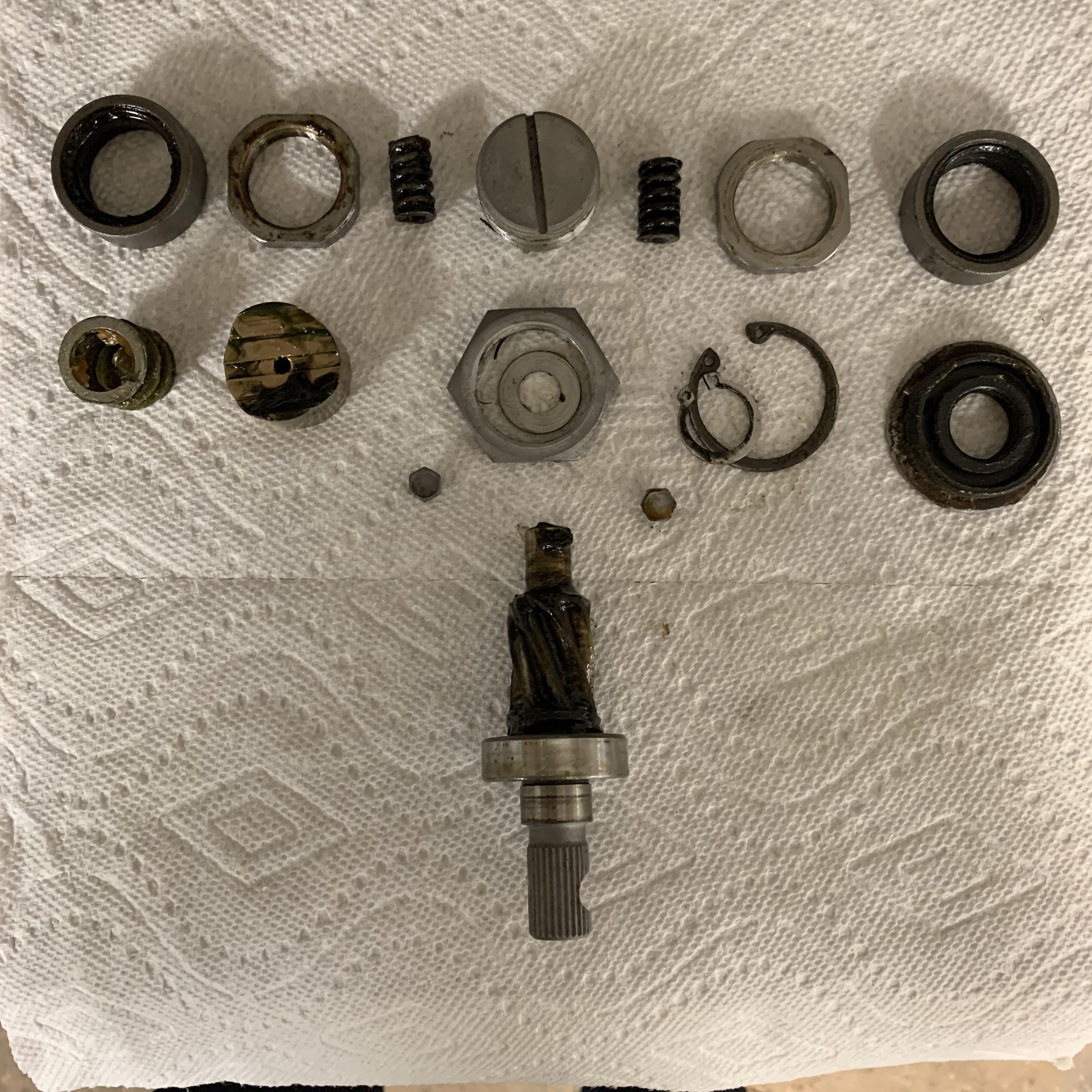

In this picture you can see the inner rod studs (replated yellow) then the larger piece that threads onto the ends of the rack. The stud goes in first, from the back, then the small spherical washers go against the back of the inner stud. Then the springs I believe. The large squarish lock nuts (plated yellow) go on the rack ends first then the ball assembly get threaded on. You tighten them until the proper movement torque is achieved then the 30mm lock nuts get tightened down

I’ve been looking but can’t find a new part number for the two snap rings that is cross referenced to the old part numbers (48265-78500 & 48271-78500). How did you solve this problem? Is this something I can just measure and buy from Napa or something?
Edit: I did find a Nissan part site that had some numbers I’m not familiar with associated with these part numbers: 48265-78500 had T=1.04-1.14, and 48271-78500 had T=1.55-1.60.
I am assuming that I can just buy an assorted box of snap rings similar to a box of cotter pins and should be good to go, right?
