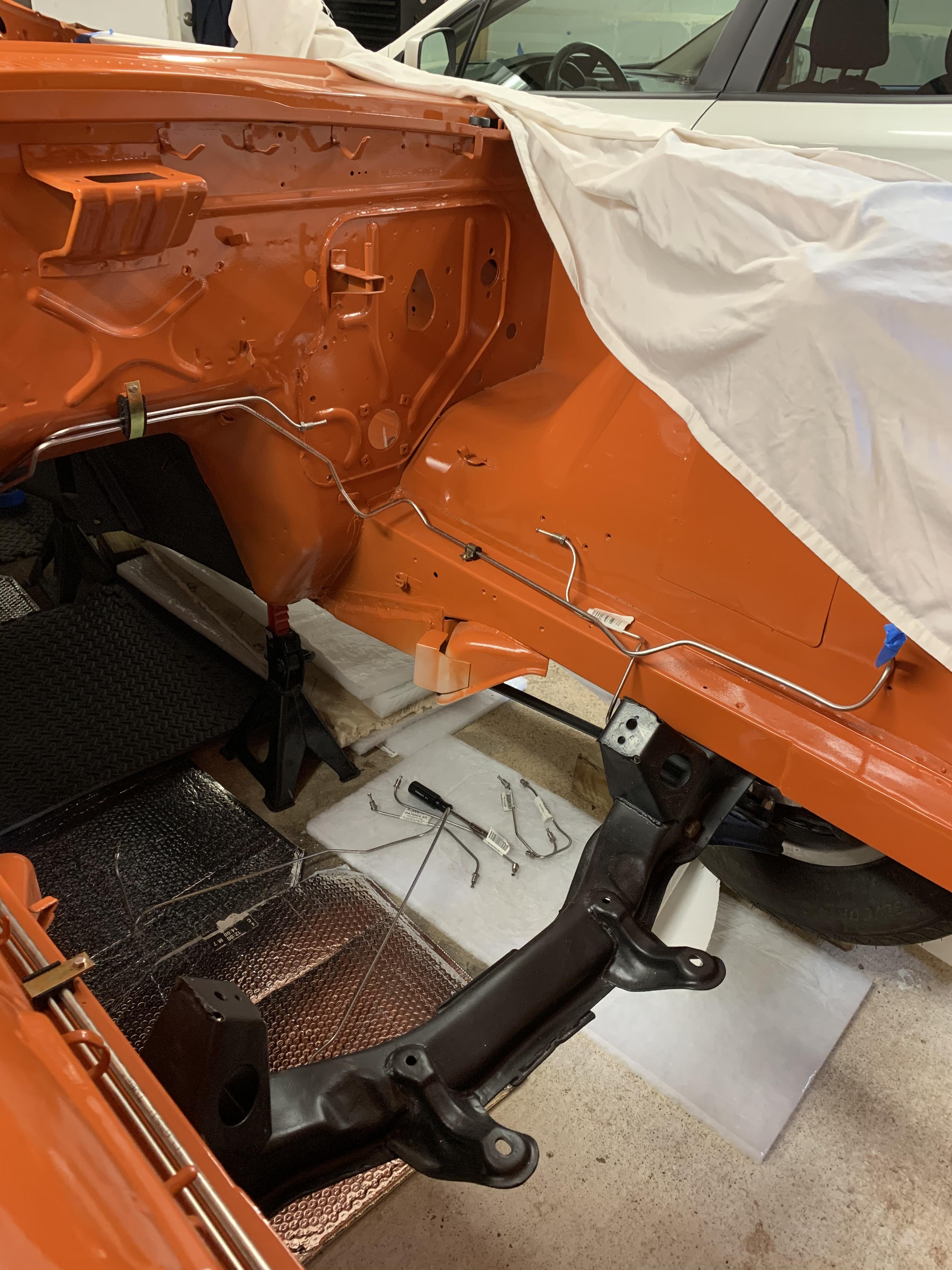

Any chance you can post a few photos of how this vapor line is secured to the engine bay? I’m trying to figure out how to rout it through all of the insulator clamps that hold it onto the car.
I found this build log that has some usable photos, but the vapor return line is significantly different from mine. I’m thinking these Classic Tube lines have some incorrect bends, or they are at least twisted.

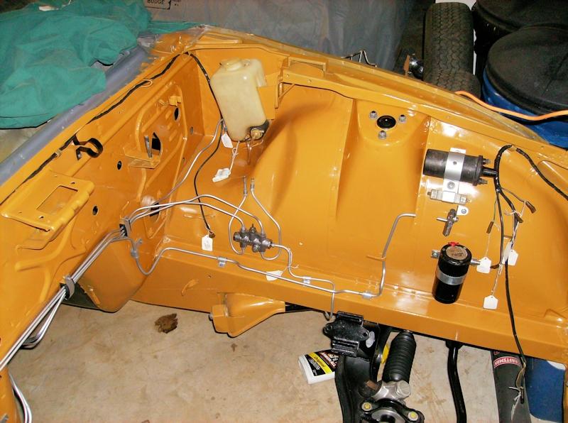

Matt,
I think this should meet your need. The vapor line gets connected to the vapor valve with a short length of hose, not yet installed in this pic. The vapor valve is just below the ballast resistor. FYI - the not-stock item below the vapor valve is a compressor for air horns. Let me know if any questions.
Jim
Thanks, Jim. Yeah. My vapor line is substantially different. I bought the one for the ‘73 and didn’t realize I wouldn’t be able to figure it out.
There are some hard to see but usable photos here that will help. I think I need to get the brake lines in before I continue with the fuel lines, plus it looks like I have a few things wrong with how it’s mounted right now.

Okay. Got the four main lines in The tunnel tonight. I had to mess with these Classic Tube lines quite a bit to get them in, and I’m a little unsure about how they are in the back, but I’ll leave the Dif out for now in case I need to mess with them more.
the main issue is the vapor and main fuel lines are a bit long and the fuel line was missing a few bends in the middle for the trans mount support and had an extra two bends in the back, at least as compared to my old lines.
whatever. They’re in. Now on to the rear brake lines.

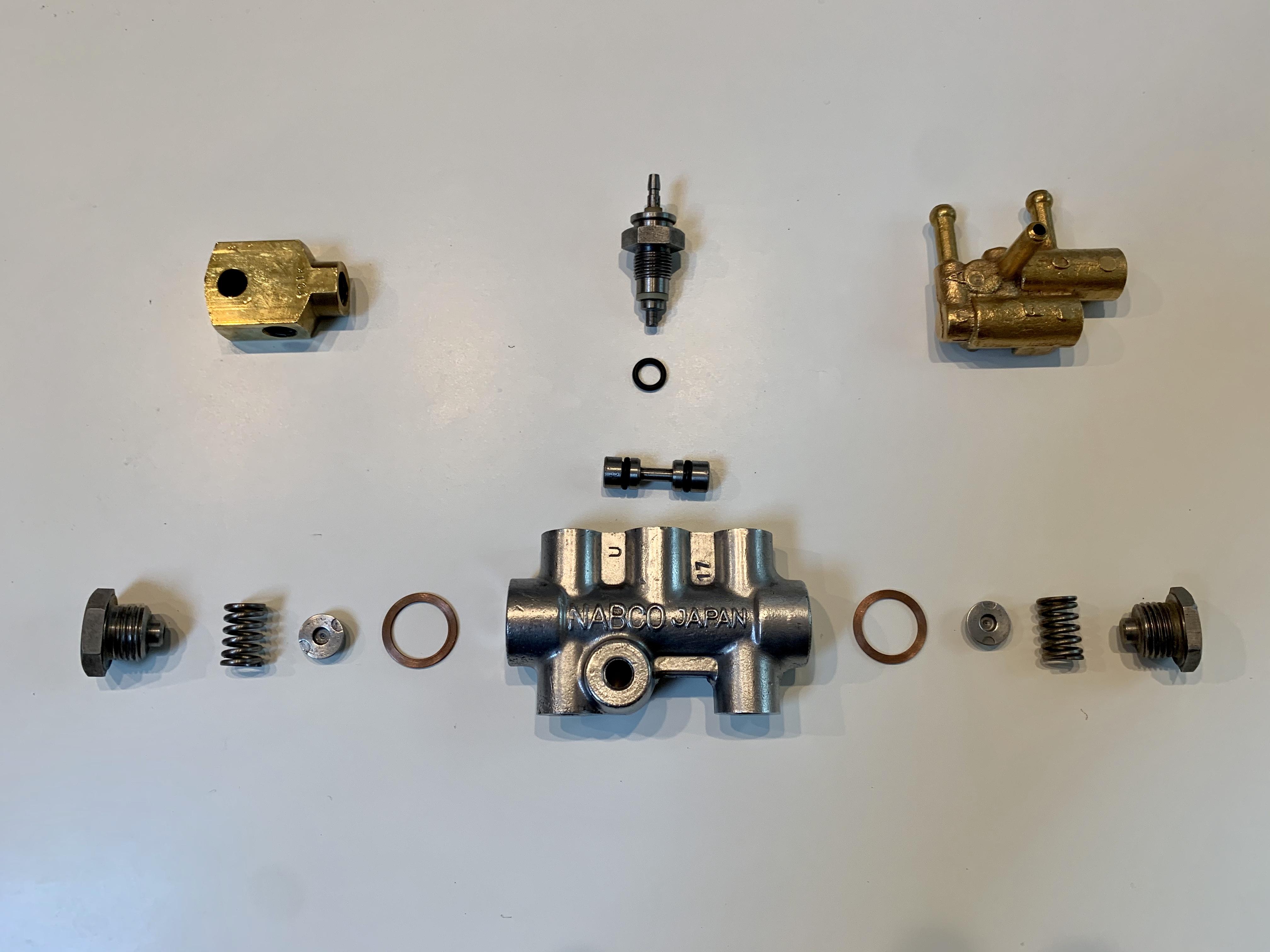

I woke up this morning and had a flash of a realization that I am wasting my time cleaning up my proportioning valve because I am putting discs on the back, so I need to put an adjustable proportioning valve on the car. Naturally I have a bunch of questions as a result.
First, is there a Nissan adjustable proportioning valve out there? It seems that everyone is using the small Willwood one.
Second, is this larger Willwood valve actually meant to replace the distribution block (middle in the photo below)? I have read here that this should be kept factory original.
Third, I have a '73 made in July, which has the proportioning valve in the engine bay (bottom in the photo below), 280z style, and the small t-block (top in the photo below) that will be left alone.
These are my parts:
I’m thinking of going with a valve from Tilton because it has 10mm ports and I won’t need adapters. Anyone have any comments? It’s not super pretty but I’m concerned about failure at unnecessary connections.
