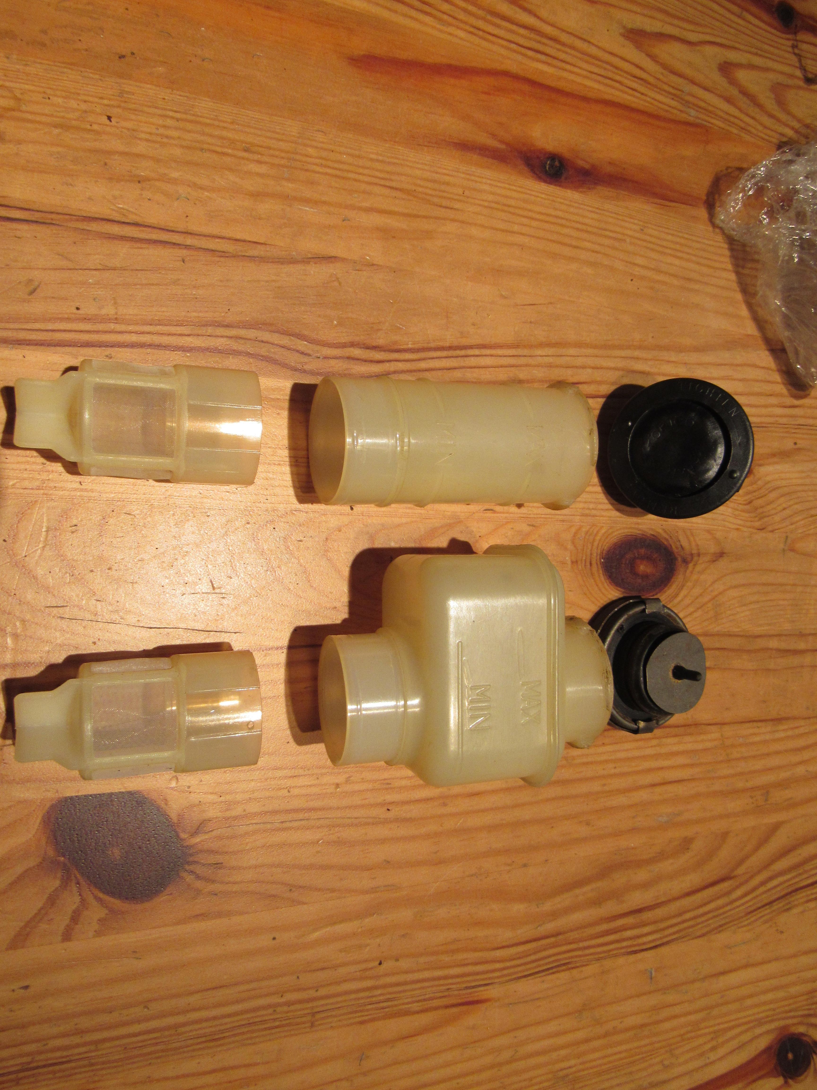

So, I’ve been collecting random brake parts, and one of the things I grabbed was a 79 ZX master cylinder. I am planning to rebuild it, and I have everything, but the reservoirs look... questionable. They still hold fluid and don’t leak, but they aren’t pretty.
I know it’s a long shot, but what are the chances I can get a NOS pair from someone who’s been hoarding a set in their basement? I actually only need the big one (46090-P6500) because I have a little one that is close to if not exactly the same as the original  (46091-U0502).
Its either that or I reuse these or get some tilting tanks or something.

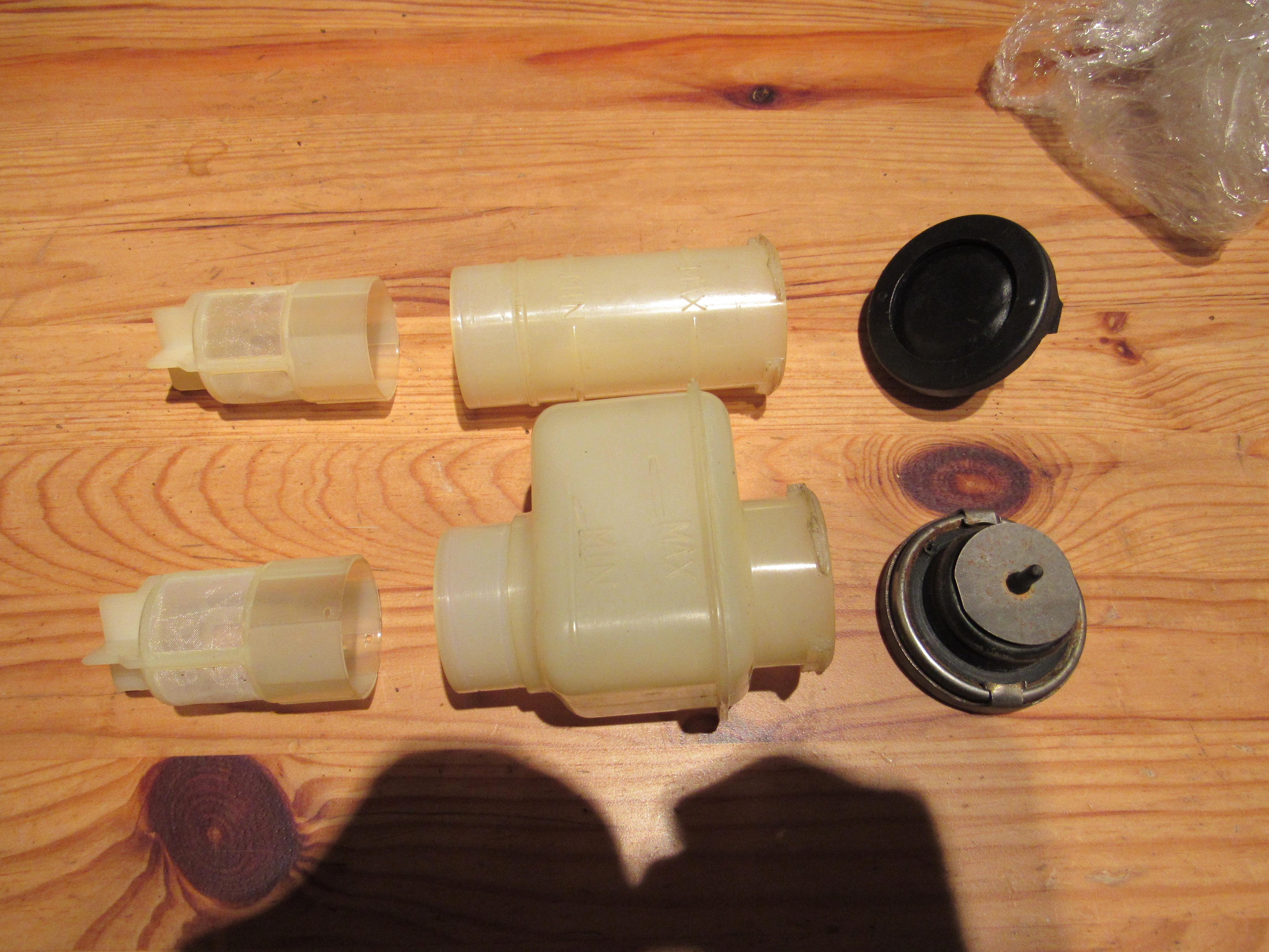

On 1/28/2021 at 6:05 PM, grannyknot said:
These aren't pristine but they are presentable, came off a 72 240, with a Hydrogen Peroxide treatment they might come out a bit whiter.
Thanks, but I want to stick with the ZX-sized tanks. I found a set on eBay and picked them up. They were more than I wanted to spend but I will have them Wednesday, so ¯\_(ツ)_/¯.
