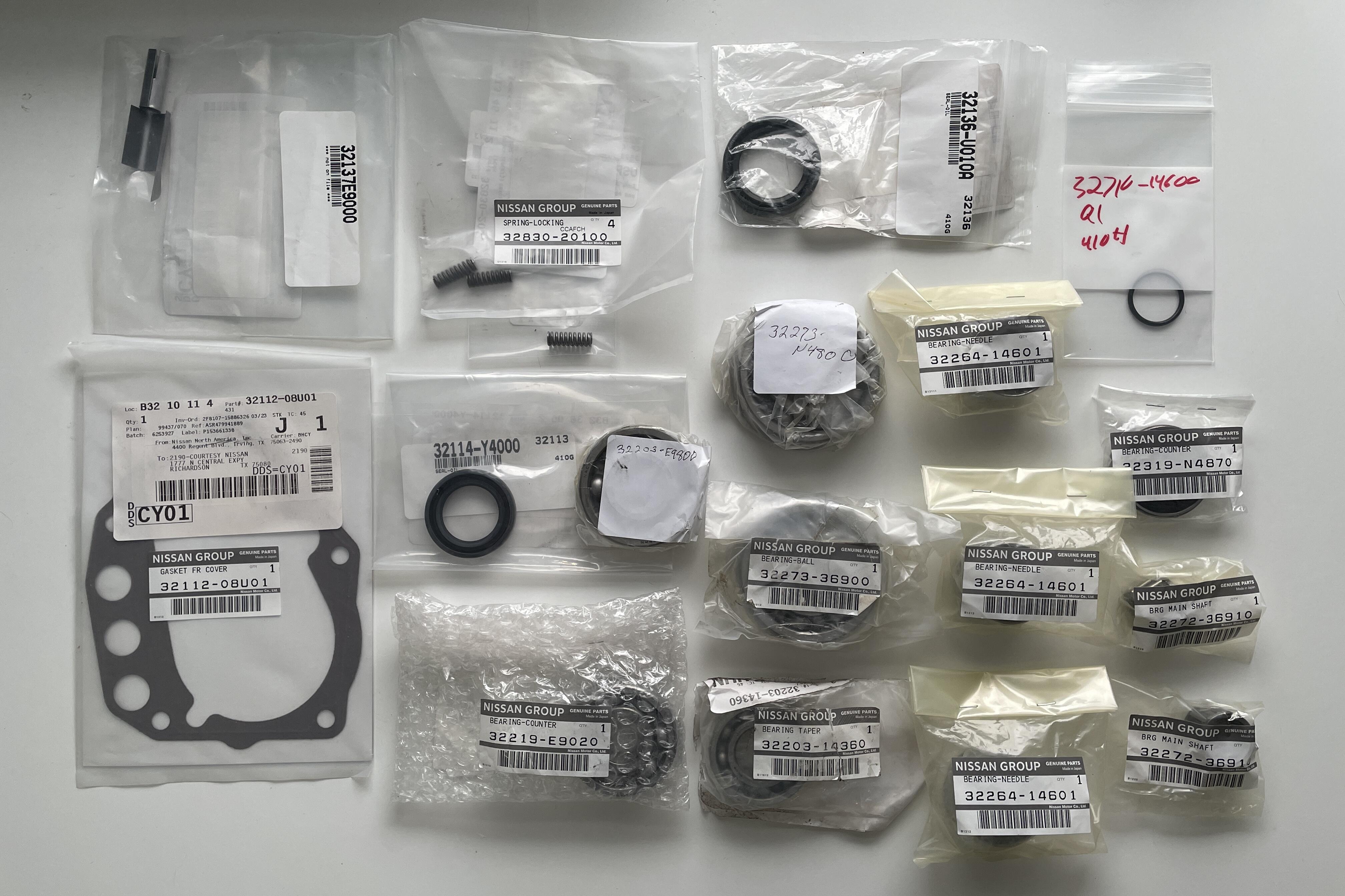

August 30, 20222 yr Author comment_644703 Side Project: I was able to find Nissan OEM versions of everything I need to overhaul the five speed. Luckily, I don’t need synchros, although you can still get them OEM from Courtesy Parts and the handful of Nissan dealers I called. I had to use a handful of places to get all of these, and I’m not 100% certain two of these are OEM despite reassurances from the retailer, but it wasn’t difficult to get it all in hand. Maybe 30 minutes on Google. I dropped these off at the transmission shop yesterday. I have no idea how long it is going to take for him to get it done, but I’m hoping to have it back by the end of September. Here's my parts list: - 1x Main Input Shaft Bearing (PN 32273-N4800) - 1x Main Input Shaft Bearing, Adapter Plate (PN 32273-36900) - 1x Main Input Shaft Bearing, Extension Housing (PN 32203-14360) - 1x Pilot Bearing, Input / Output Shafts (PN 32272-36910) - 3x Needle Bearing, Main Shaft Gears (PN 32264-14601) - 1x Counter Shaft Bearing, Front (PN 32219-E9020) - 1x Counter Shaft Bearing, Adapter (PN 32203-E9800) - 1x Counter Shaft Bearing, Rear (PN 32319-N4870) - 1x Reverse Idler Gear Bearing (PN 32272-36910) - 1x Front Cover Gasket (PN 32112-08U01) - 1x Oil Gutter (PN 32137-E9000) - 1x Front Seal (PN 32114-Y4000) - 1x Rear Extension Seal (PN 32136-U010A) - 3x Checking Spring (32830-20100) Edited August 30, 20222 yr by Matthew Abate Link to comment https://www.classiczcars.com/forums/topic/51541-1973-rebuild/?&page=88#findComment-644703 Share on other sites More sharing options...

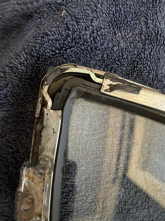

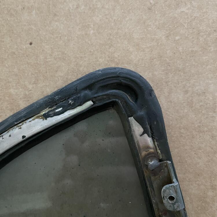

September 1, 20222 yr Author comment_644788 Question about the black goop inside the frames for my rear quarter panels: what is it? I was thinking RTV or body caulk. It doesn’t seem like it’s weatherstrip adhesive. I want to be able to replicate this after I clean all my parts up. Edited September 1, 20222 yr by Matthew Abate Link to comment https://www.classiczcars.com/forums/topic/51541-1973-rebuild/?&page=88#findComment-644788 Share on other sites More sharing options...
September 1, 20222 yr comment_644790 Some kind of rubber sealant they used to keep the joints from leaking around the frame. I cleaned it off and duplicated it as best I could with Ultra Black RTV. Seems to work ok. Link to comment https://www.classiczcars.com/forums/topic/51541-1973-rebuild/?&page=88#findComment-644790 Share on other sites More sharing options...
September 17, 20222 yr Author comment_645504 RTV seems to do the trick. unrelated… Does anyone know of a build thread with really good pictures of the original copper 280z air conditioning lines and hoses? I want to see how those were routed and where they went through the firewall so I can approximate that with my setup. I haven’t been able to find a diagram that show the actual routing. Edited September 17, 20222 yr by Matthew Abate Link to comment https://www.classiczcars.com/forums/topic/51541-1973-rebuild/?&page=88#findComment-645504 Share on other sites More sharing options...
