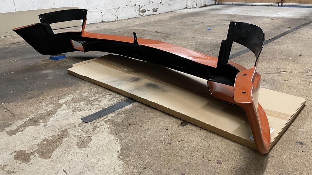

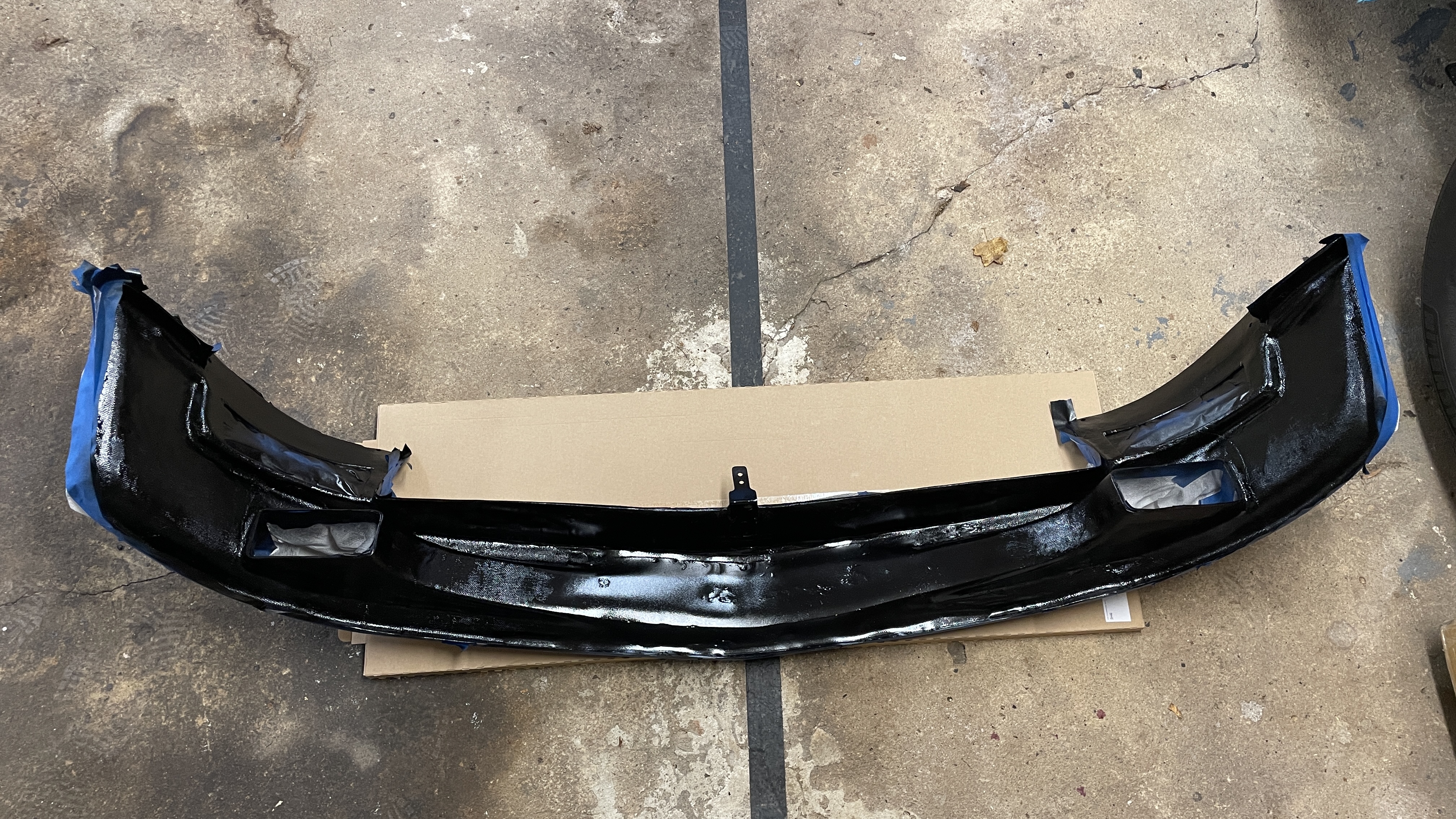

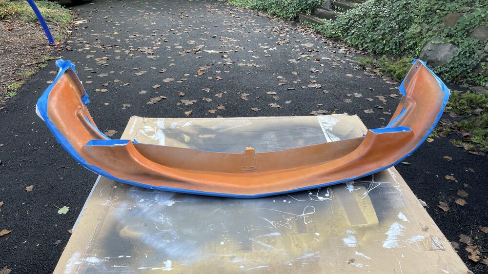

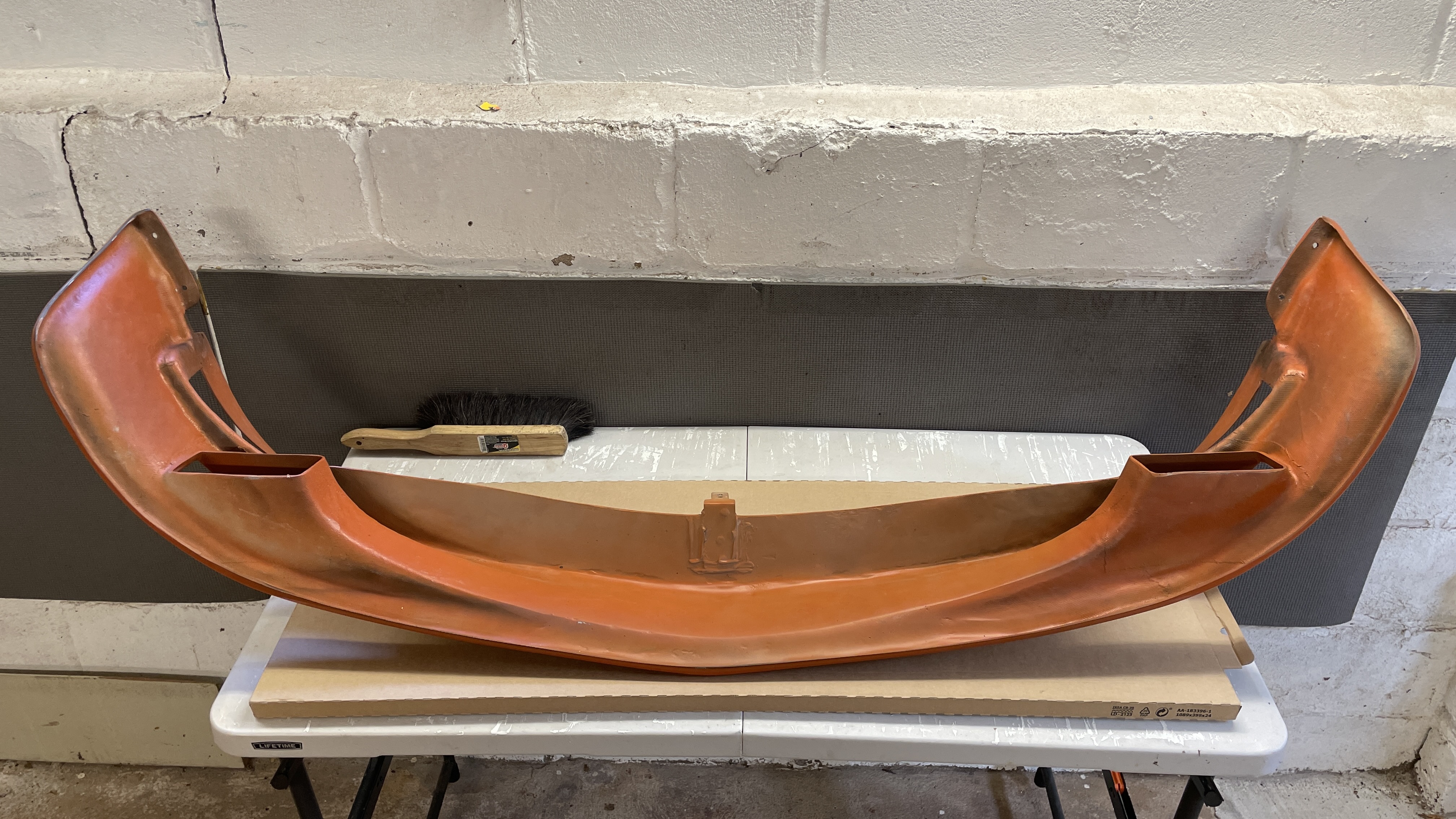

September 10, 20231 yr Author comment_656913 One of the many, many things the painter screwed up on my car was not painting the back of the air dam black like I asked him to. Not the most egregious screwup by far, but still annoying when compounded with everything else. I hit this with gloss black and it helps. Doesn’t fix the spots where the primer is showing through the orange but it’s better. Link to comment https://www.classiczcars.com/forums/topic/51541-1973-rebuild/?&page=94#findComment-656913 Share on other sites More sharing options...

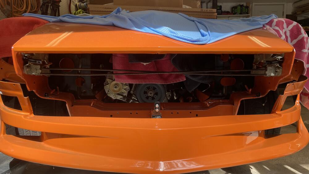

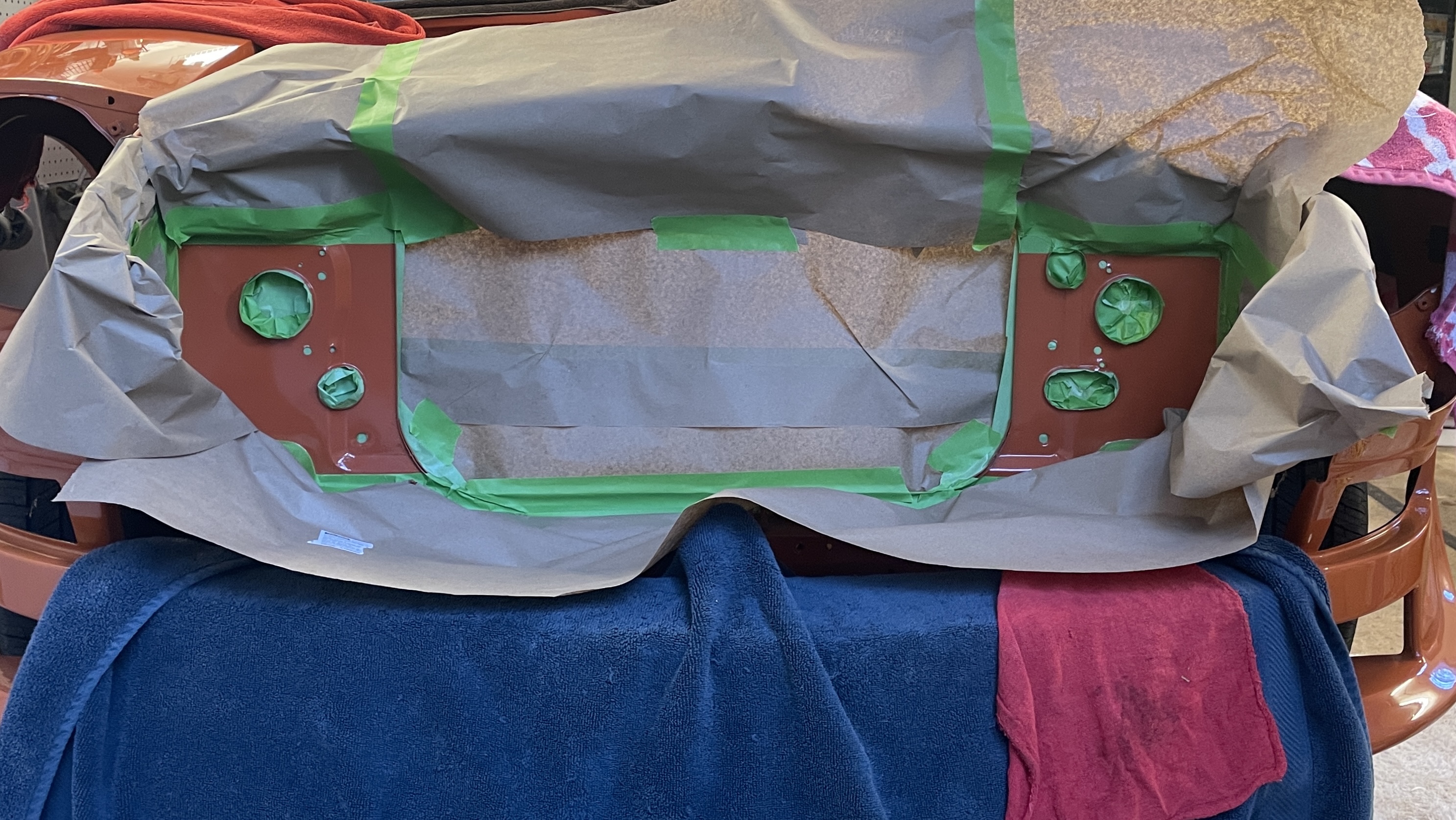

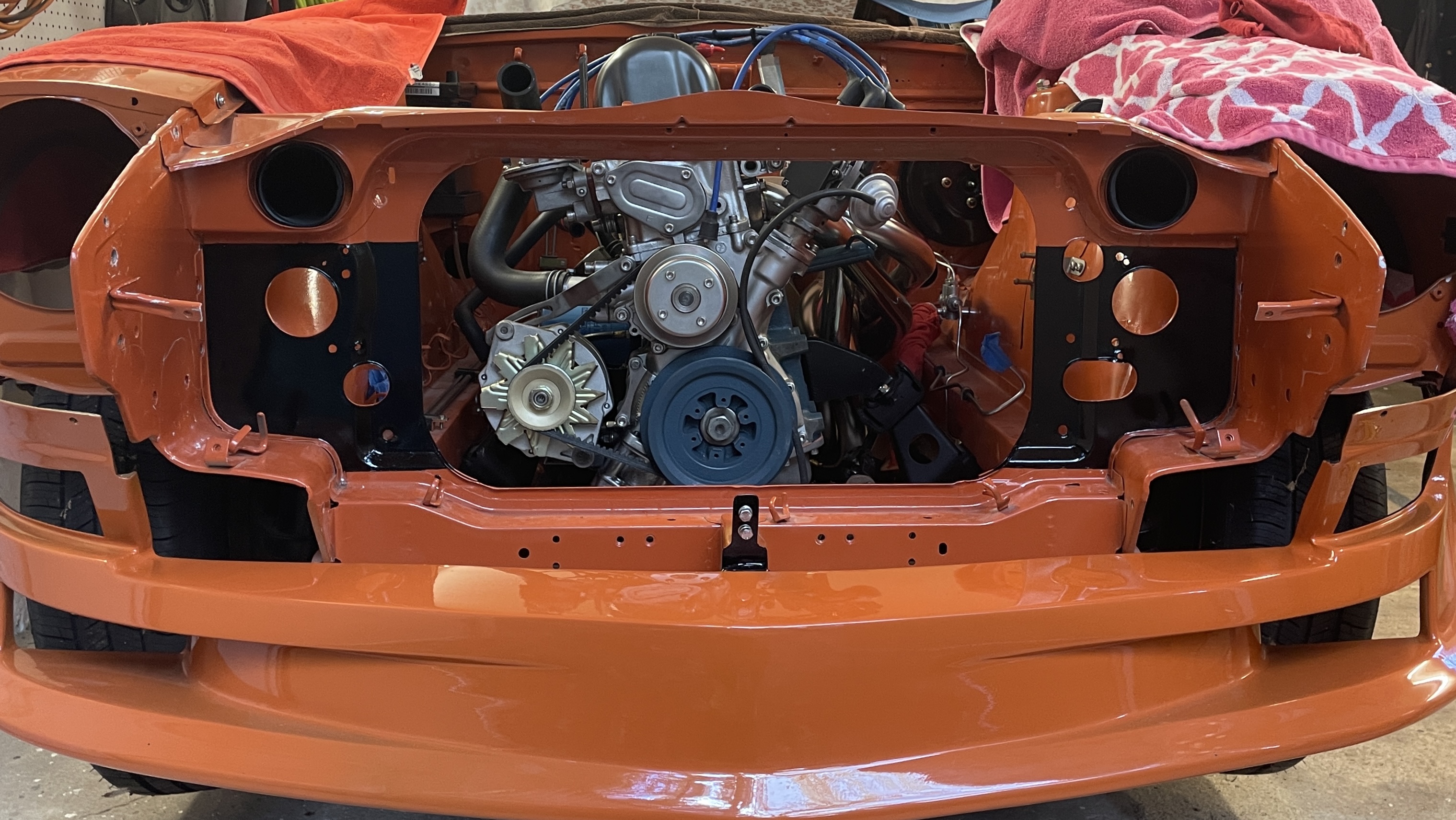

September 16, 20231 yr Author comment_657107 I blacked out the radiator bulkhead and grill tabs (thanks @Patcon for the thread showing how that’s done). Now I just need a 280z harness boot and I can put the engine harness in. Link to comment https://www.classiczcars.com/forums/topic/51541-1973-rebuild/?&page=94#findComment-657107 Share on other sites More sharing options...

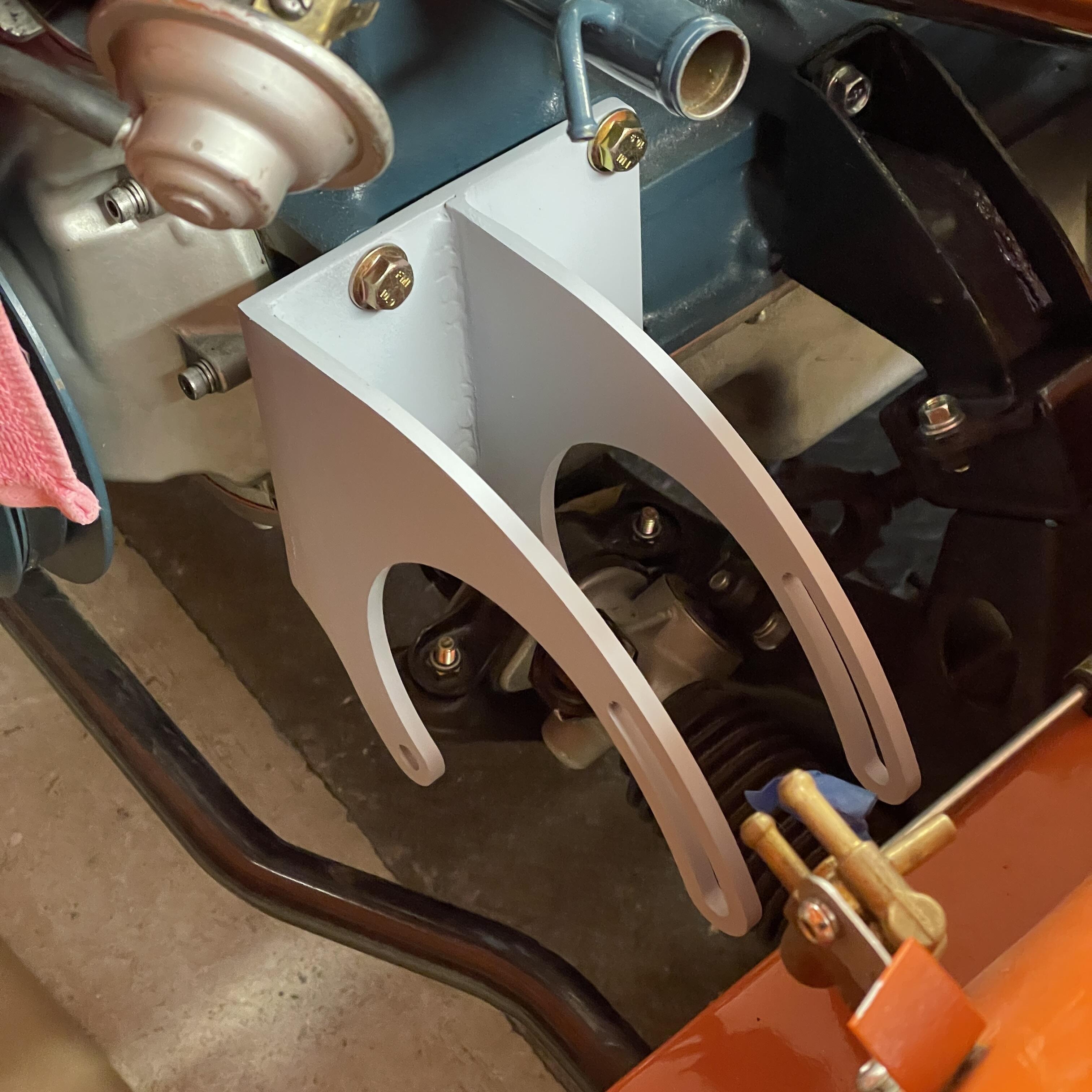

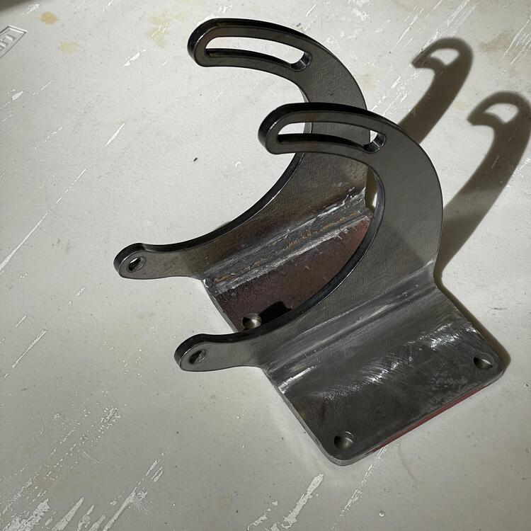

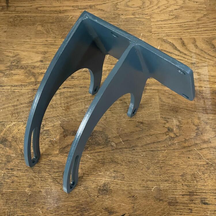

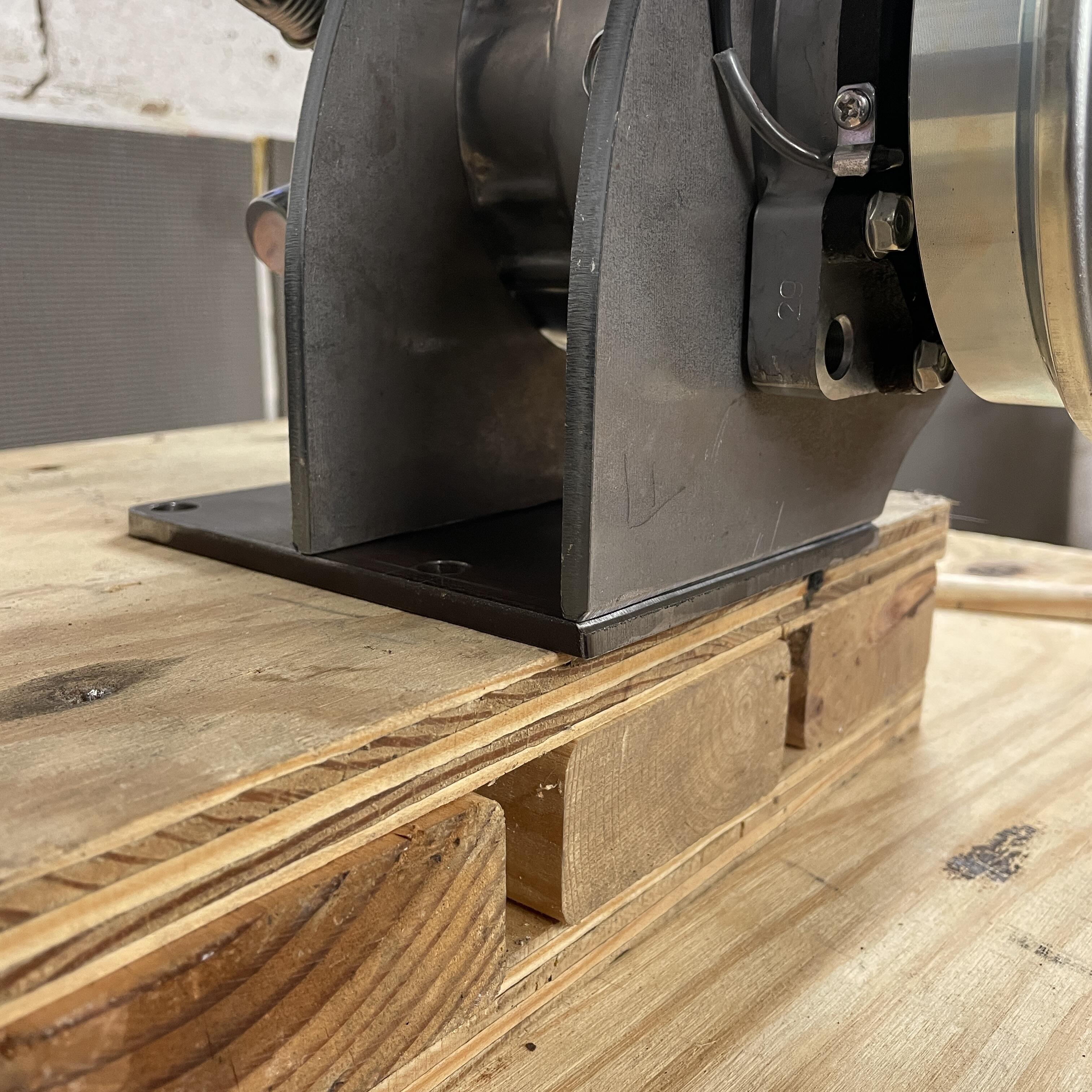

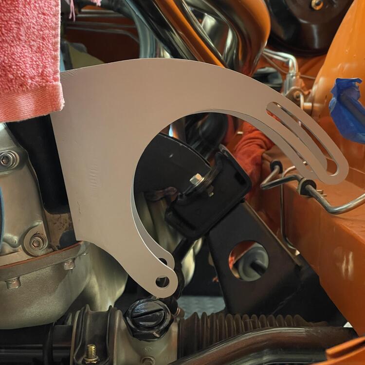

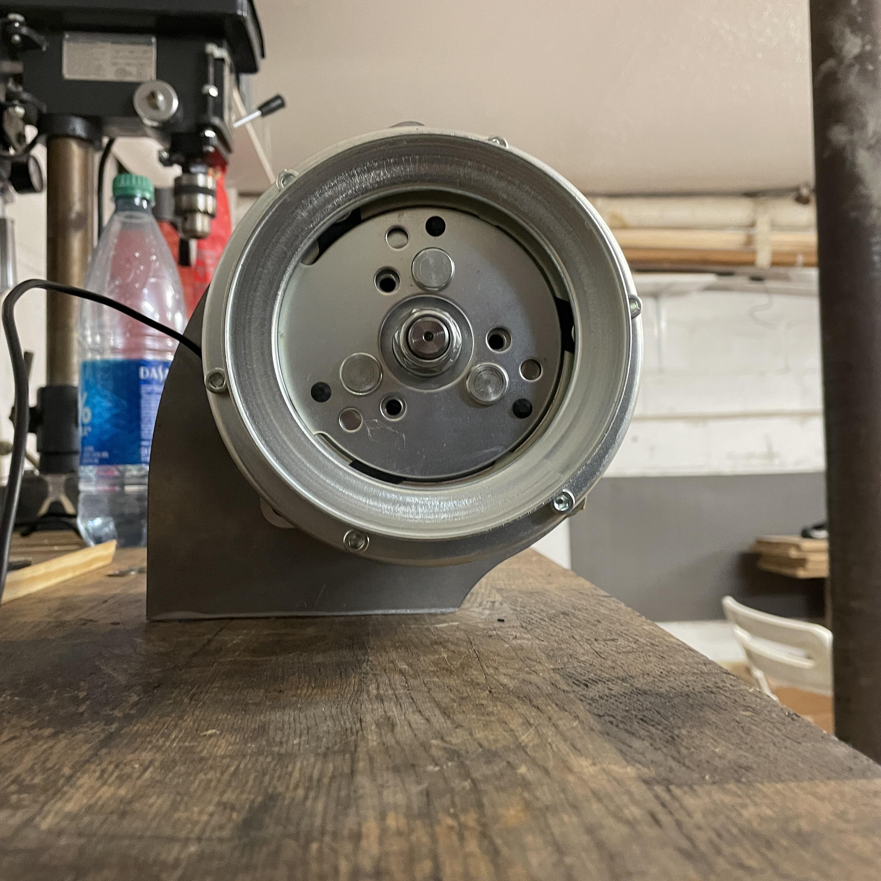

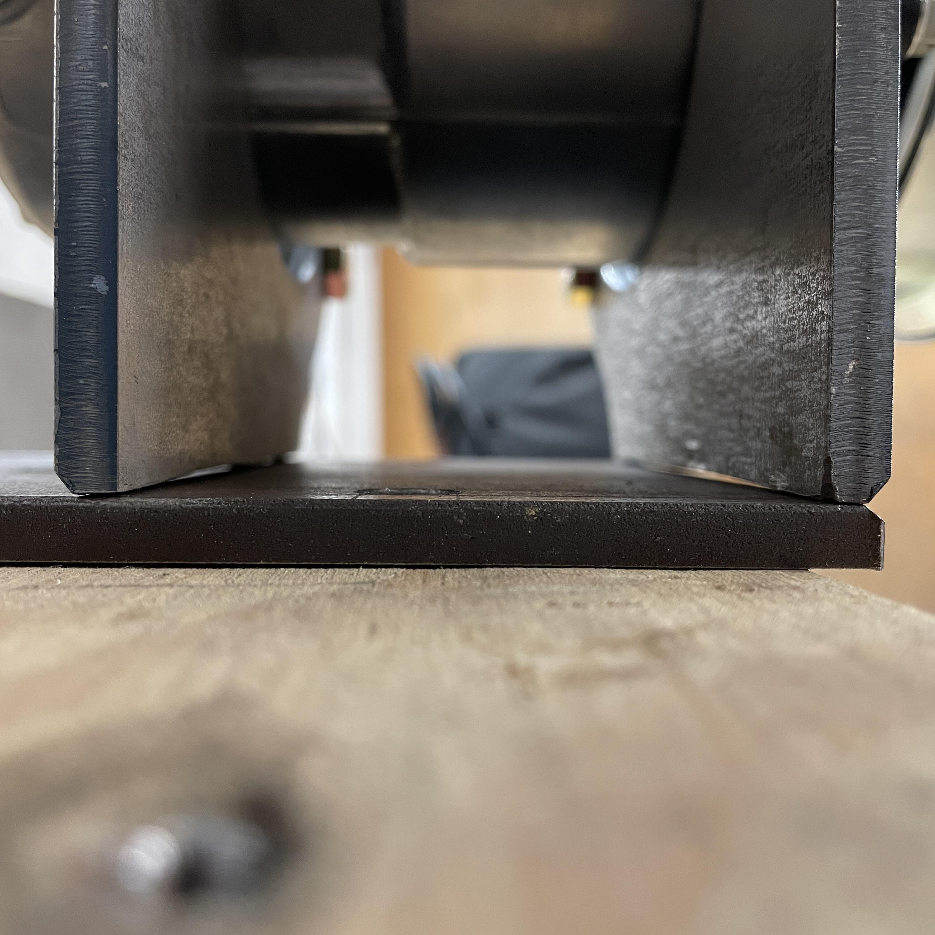

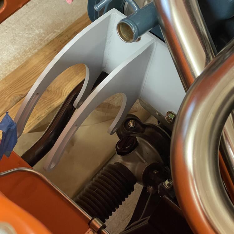

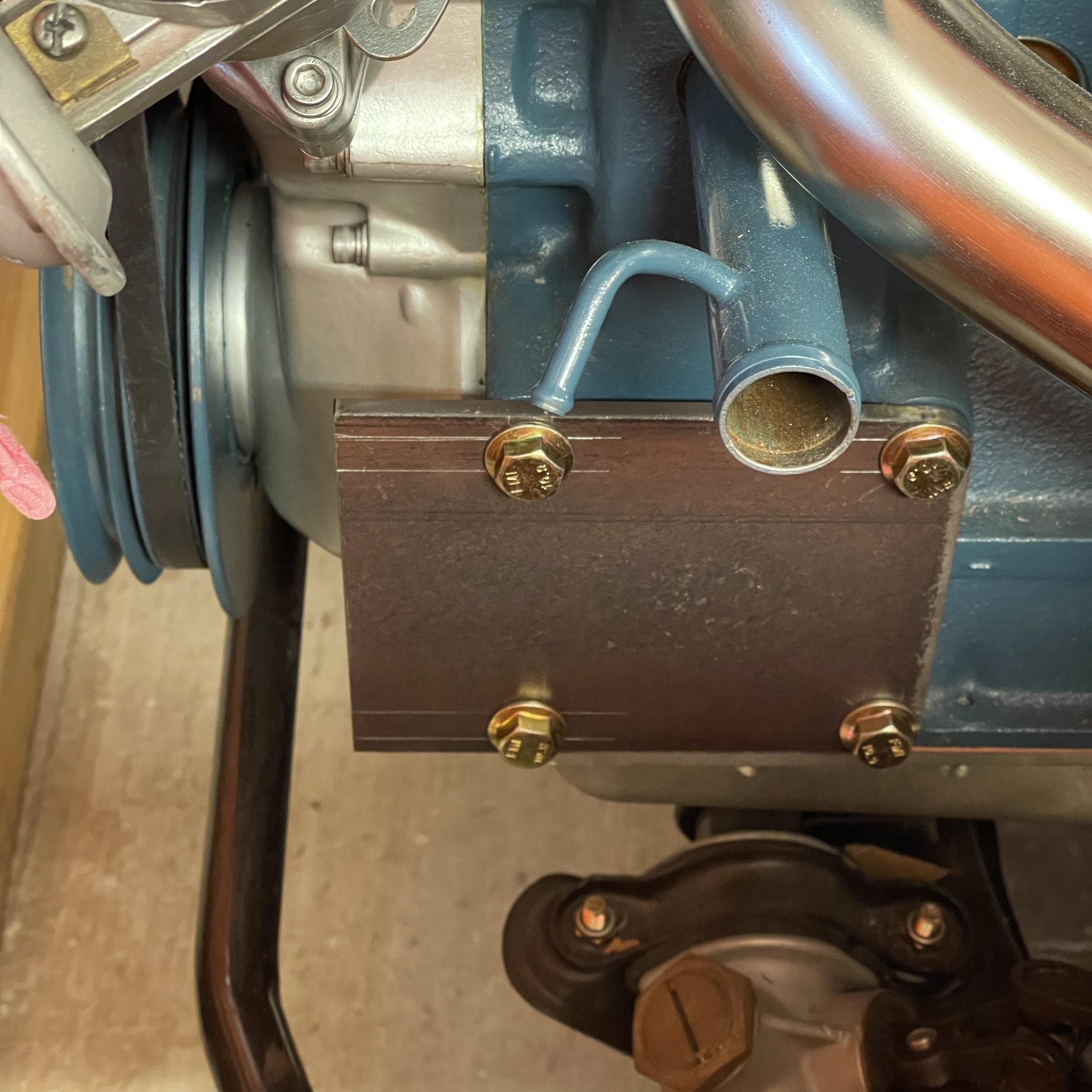

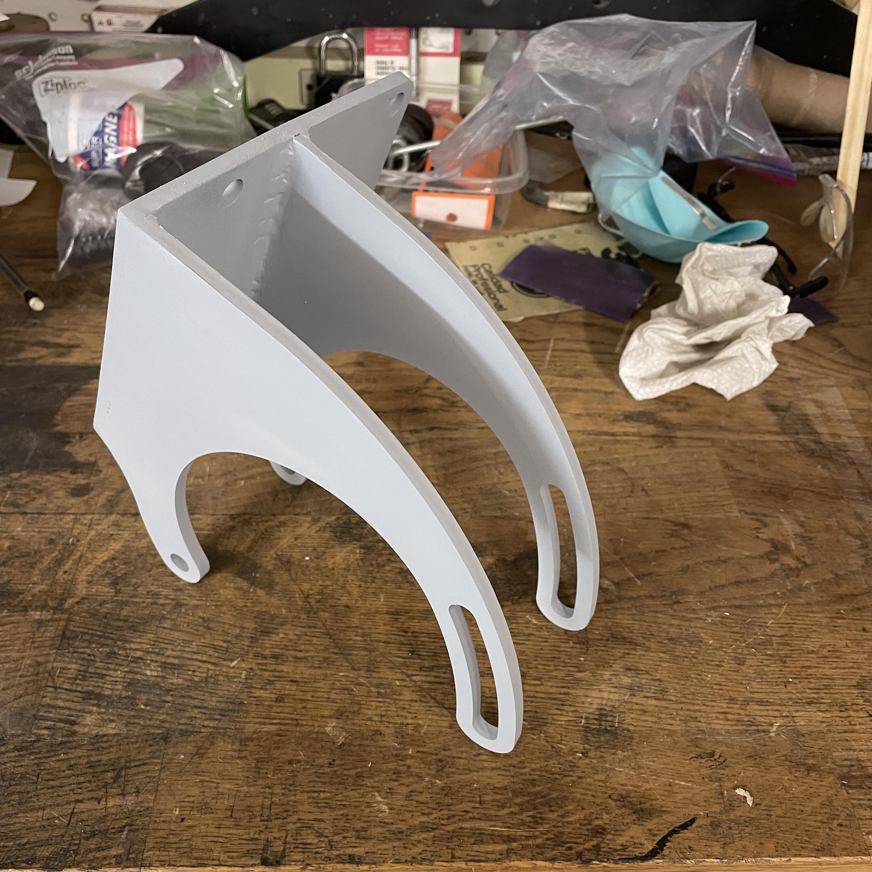

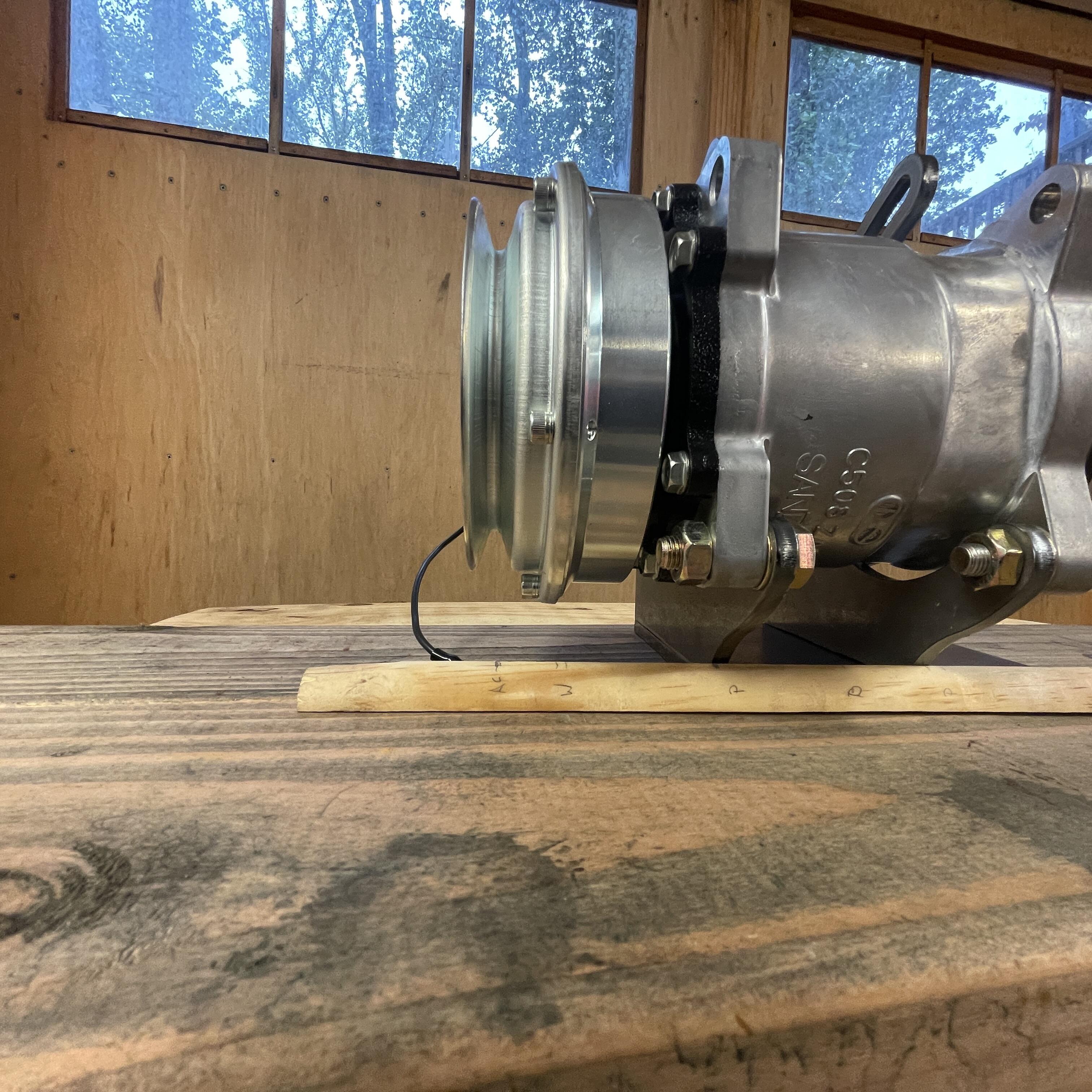

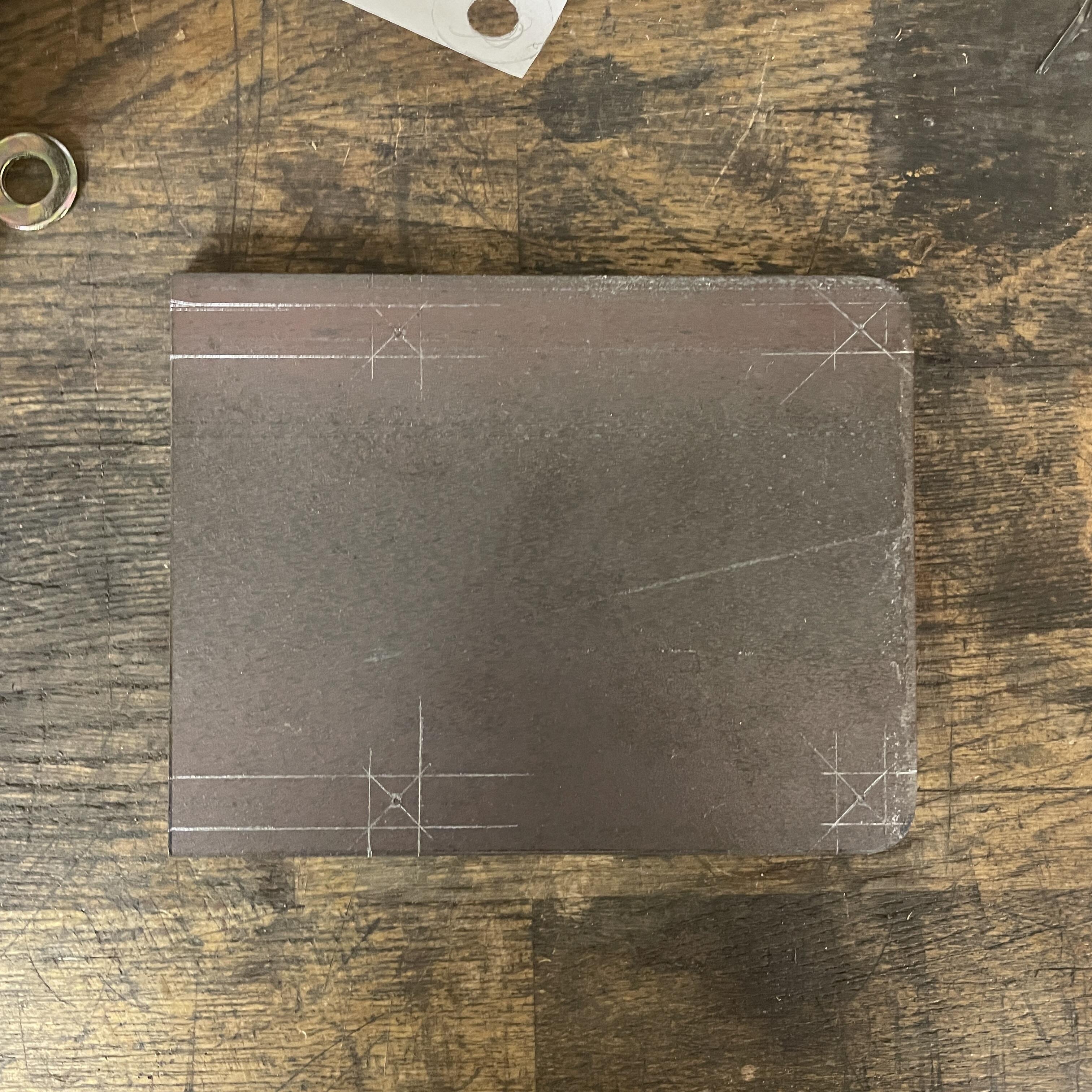

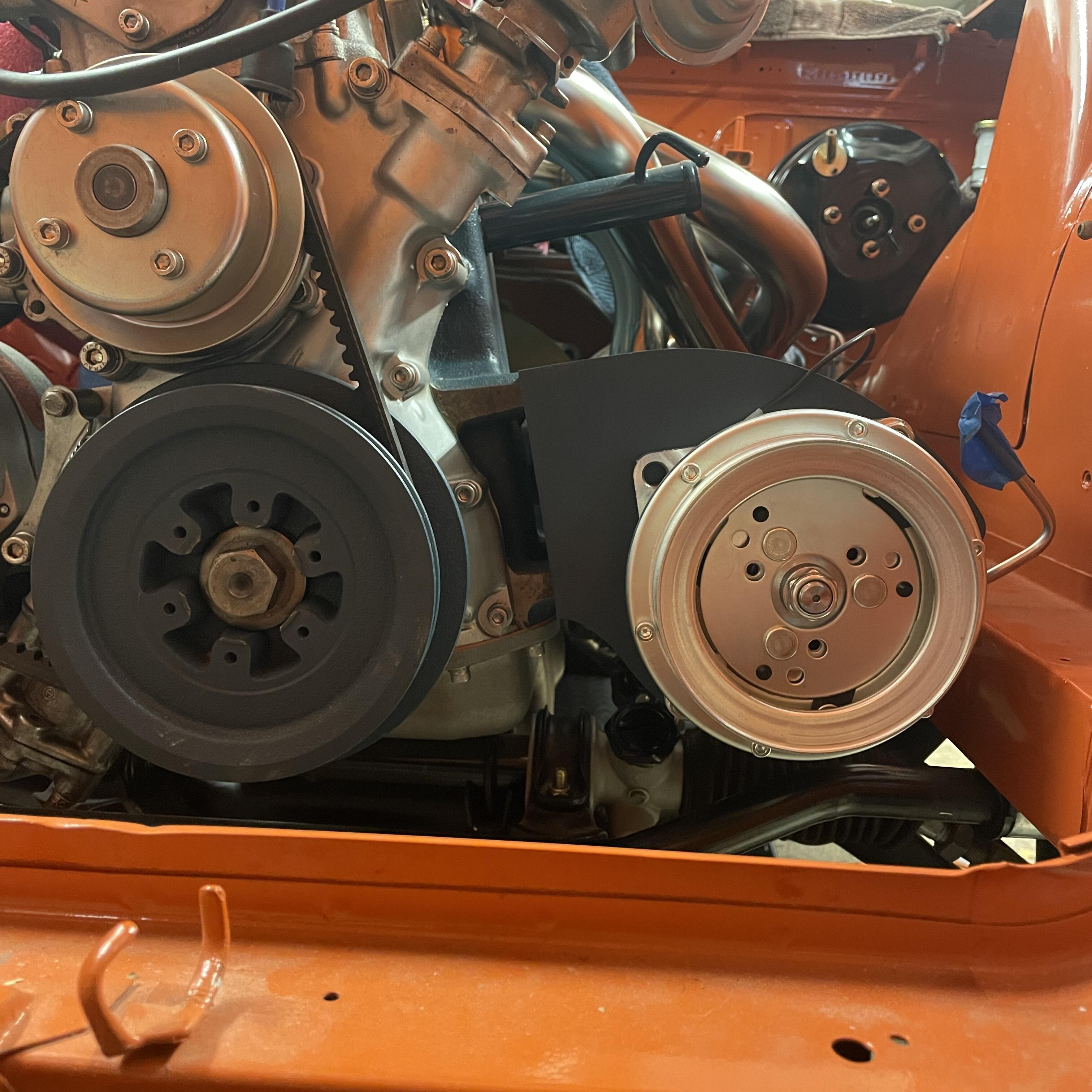

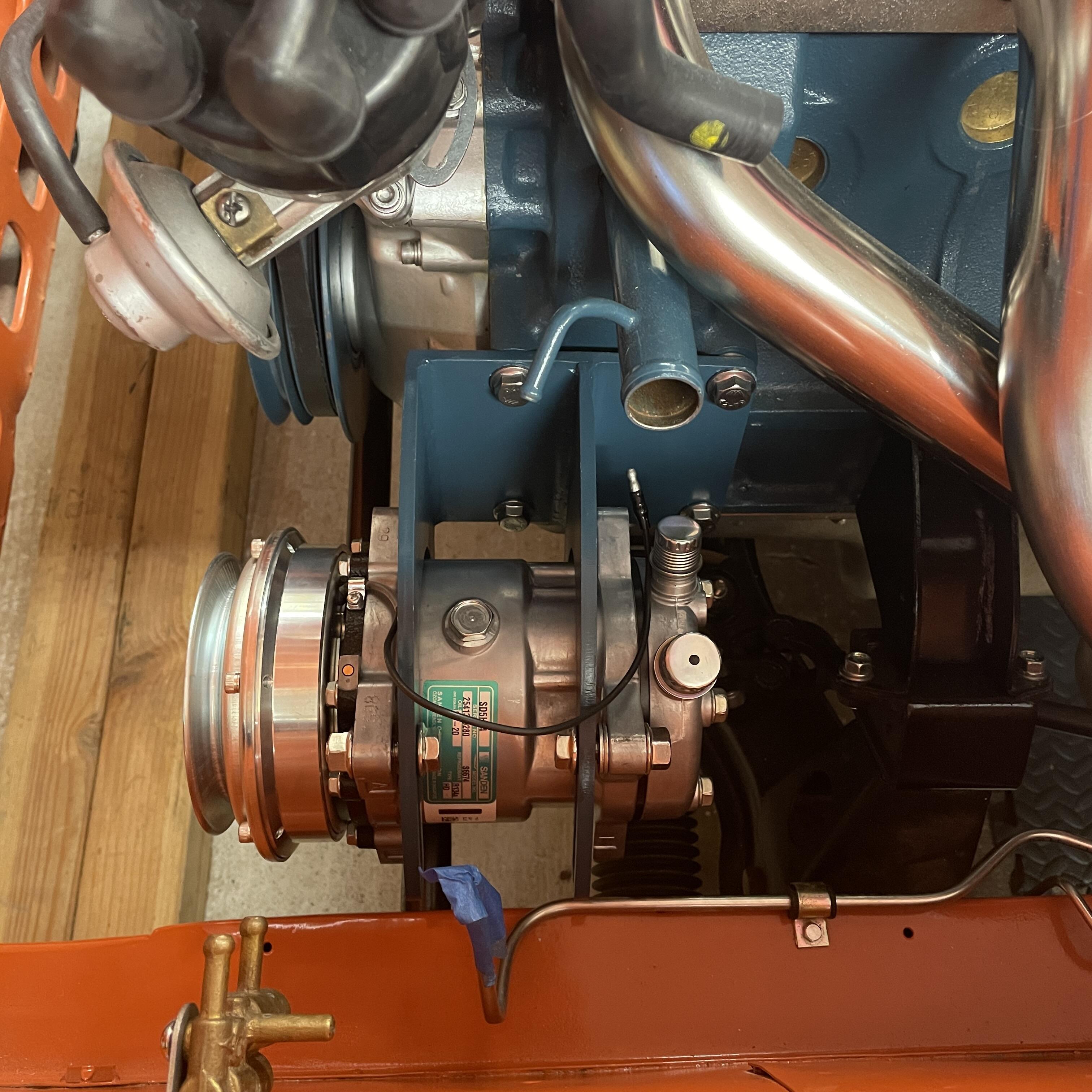

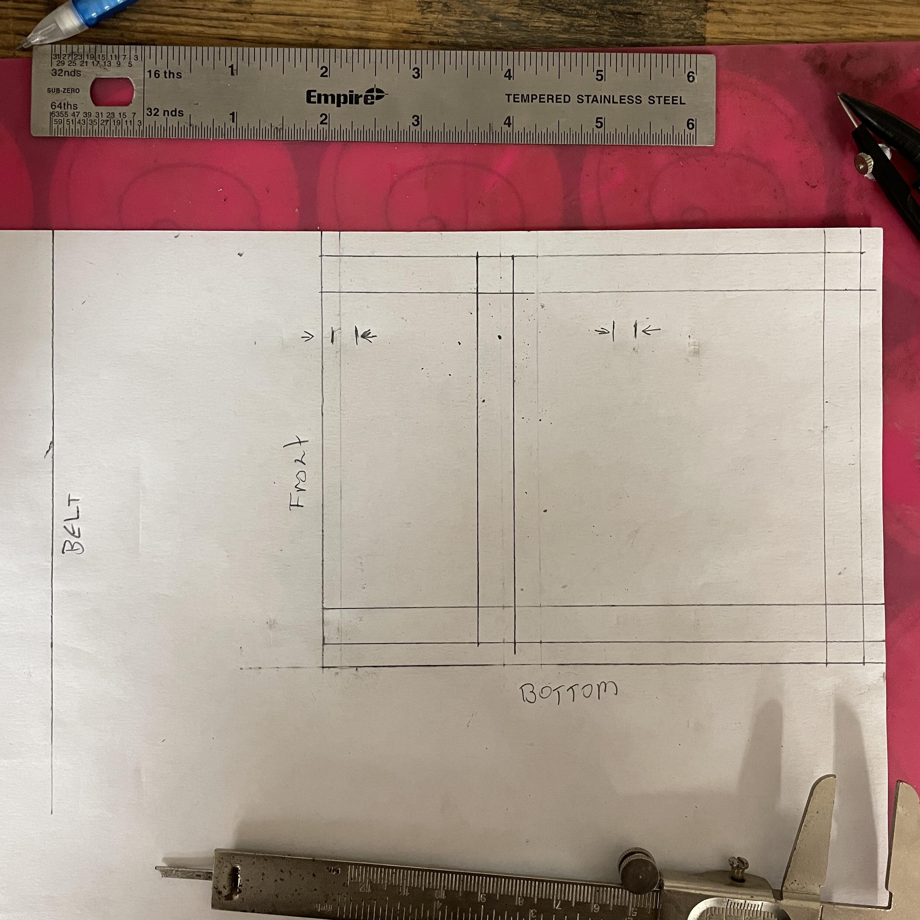

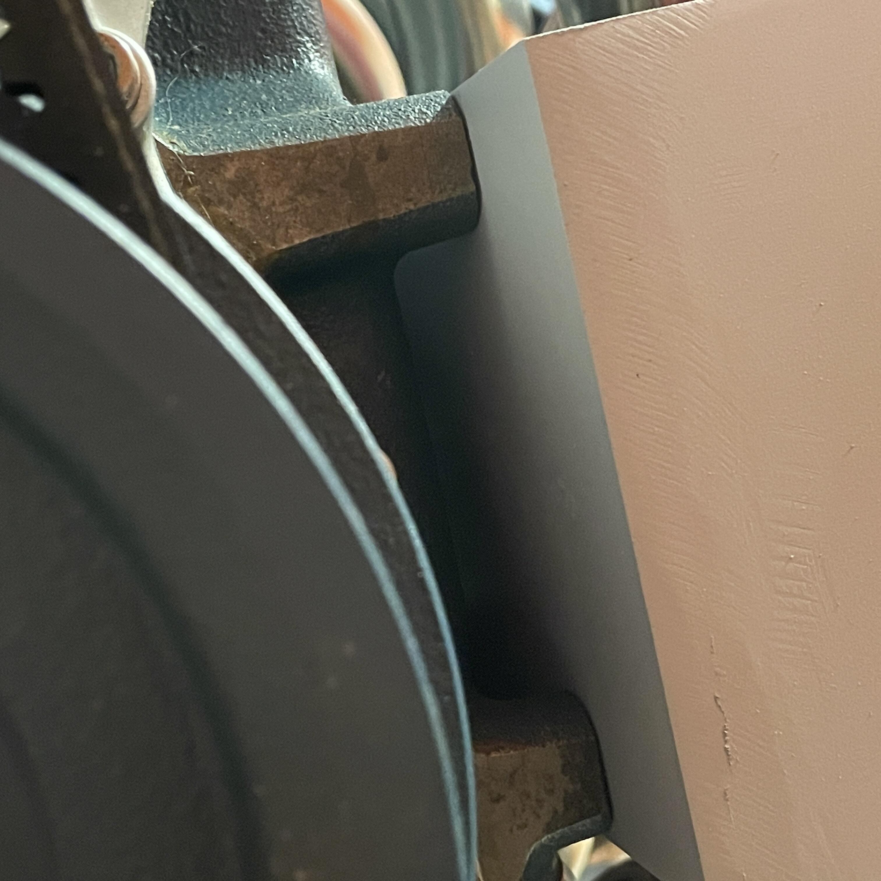

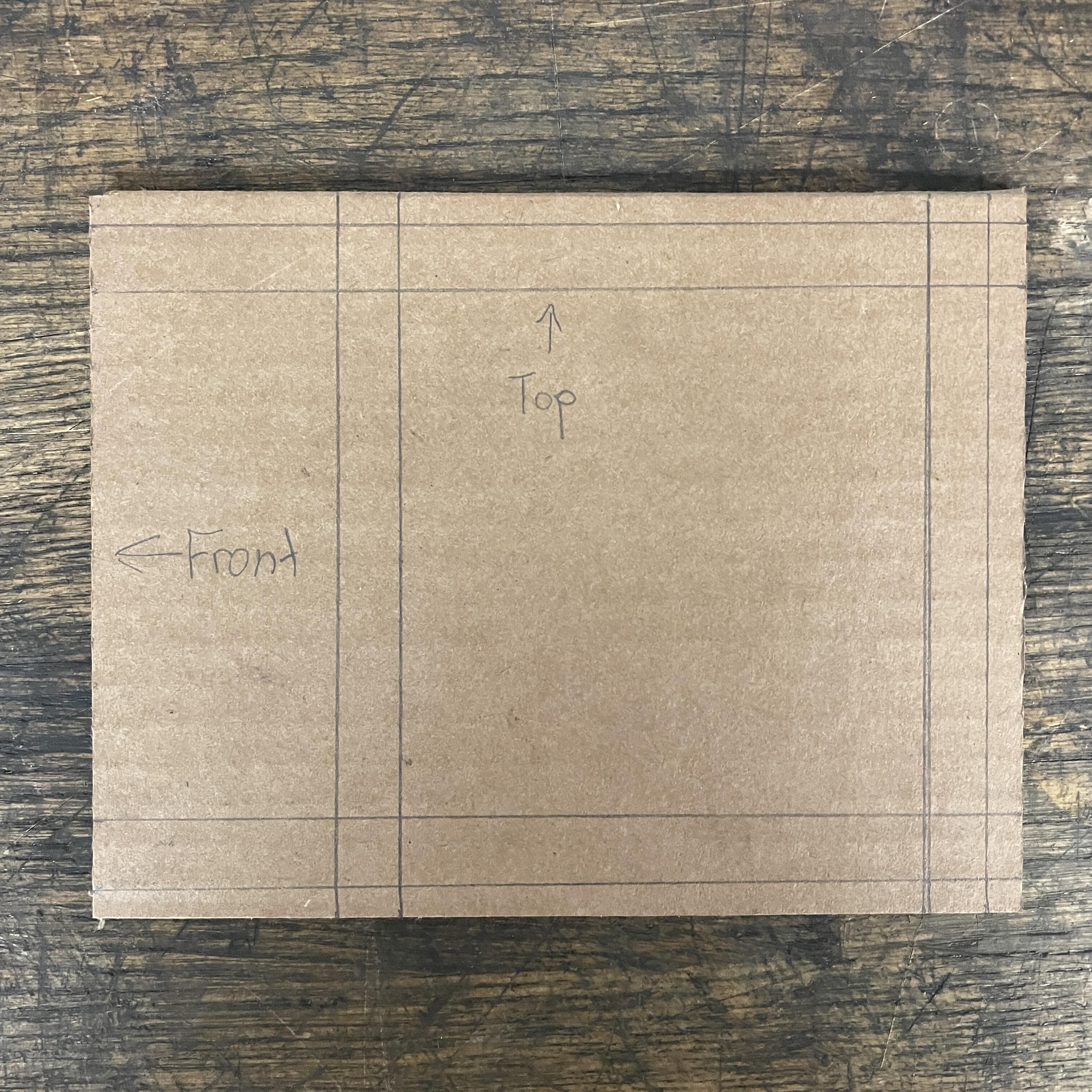

October 2, 20231 yr Author Popular Post comment_657736 More progress… I fabbed up a bracket for my Sanden compressor because modifying the ZX bracket was turning out to be just too much. I used the Vintage Air universal bracket parts ($50 @ Summit) and a sheet of 1/4” steel from the hardware store, which I cut, drilled, and welded to the brackets. It came out okay. If I were going to do it over again (which I’m not) I would angle the bracket up more to 1. make more clearance for the compressor to slide in under the bracket, 2. move the compressor away from the frame when at the furthest point of adjustment, and 3. change the adjustment angle to be more perpendicular to the block, making the adjustment span more pronounce/longer. Otherwise I’m happy with it. Edited October 2, 20231 yr by Matthew Abate Link to comment https://www.classiczcars.com/forums/topic/51541-1973-rebuild/?&page=94#findComment-657736 Share on other sites More sharing options...
