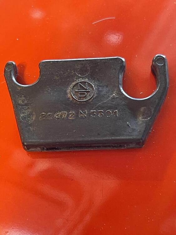

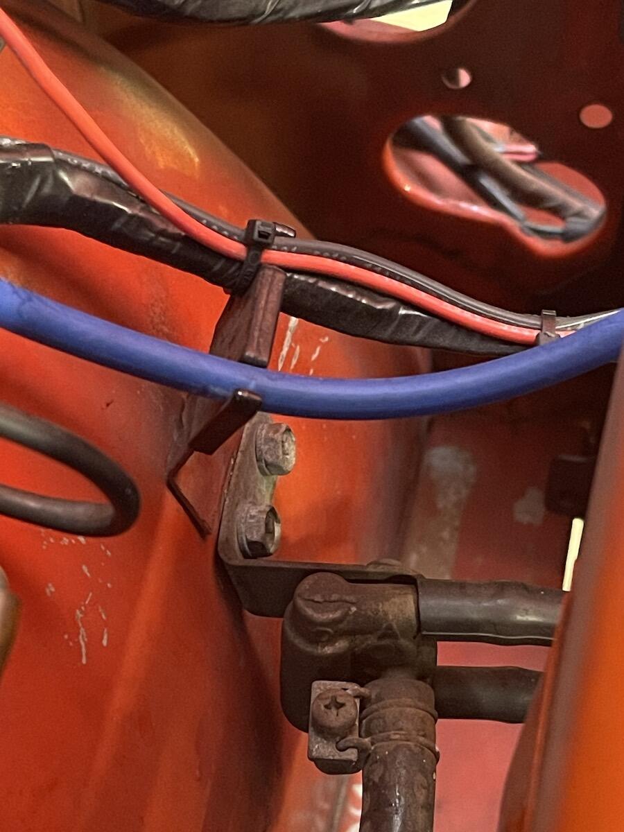

October 22, 20231 yr comment_658425 On 10/8/2023 at 4:00 PM, Matthew Abate said: ☝By the way, does anyone know what this tab is for? I assumed it’s for a clip to hold the coil wire because it’s similar to the tabs for the plug wire clips. My 73 has a wire clip for the coil and distributor/water temp sender wires on that tab. Here's the part No. Link to comment https://www.classiczcars.com/forums/topic/51541-1973-rebuild/?&page=96#findComment-658425 Share on other sites More sharing options...
October 22, 20231 yr Author comment_658434 Am I misreading that? I’m not finding anything when I search 22472-n3301. Edited October 22, 20231 yr by Matthew Abate Link to comment https://www.classiczcars.com/forums/topic/51541-1973-rebuild/?&page=96#findComment-658434 Share on other sites More sharing options...
October 22, 20231 yr comment_658436 19 minutes ago, Matthew Abate said: Am I misreading that? I’m not finding anything when I search 22472-n3301. Yep, 22472-N3301. I'm not finding it either on the web, except for here: https://www.carpartsmanual.com/datsun/Z-1969-1978/electrical/wiring/to-jul-76/23 Maybe only a July 73 thing? Link to comment https://www.classiczcars.com/forums/topic/51541-1973-rebuild/?&page=96#findComment-658436 Share on other sites More sharing options...
October 22, 20231 yr Author comment_658441 I see that N3300 was used on the manual. Any idea how it was different from N3301? Link to comment https://www.classiczcars.com/forums/topic/51541-1973-rebuild/?&page=96#findComment-658441 Share on other sites More sharing options...
October 22, 20231 yr comment_658449 Haven't a clue. Mine shows no signs of ever having an automatic. Not sure what difference between AT & 4SP could even warrant a change in that area of wiring. Misprint maybe? I see a few of them on BAT pics, even earlier years, look the same. Link to comment https://www.classiczcars.com/forums/topic/51541-1973-rebuild/?&page=96#findComment-658449 Share on other sites More sharing options...
October 23, 20231 yr comment_658520 Just checked on my Mfg 12/70 car - 4SP. The clip looks the same as the one pictured but there are no markings at all on either side of the plastic wire clip. Link to comment https://www.classiczcars.com/forums/topic/51541-1973-rebuild/?&page=96#findComment-658520 Share on other sites More sharing options...
October 23, 20231 yr comment_658523 If it was an automatic at one time there is a trans kick down bracket above the gas pedal and you will not have a bump stop on the firewall where the clutch pedal depresses. My 78 conversion proved this and there is extra wiring in trans tunnel. Link to comment https://www.classiczcars.com/forums/topic/51541-1973-rebuild/?&page=96#findComment-658523 Share on other sites More sharing options...
