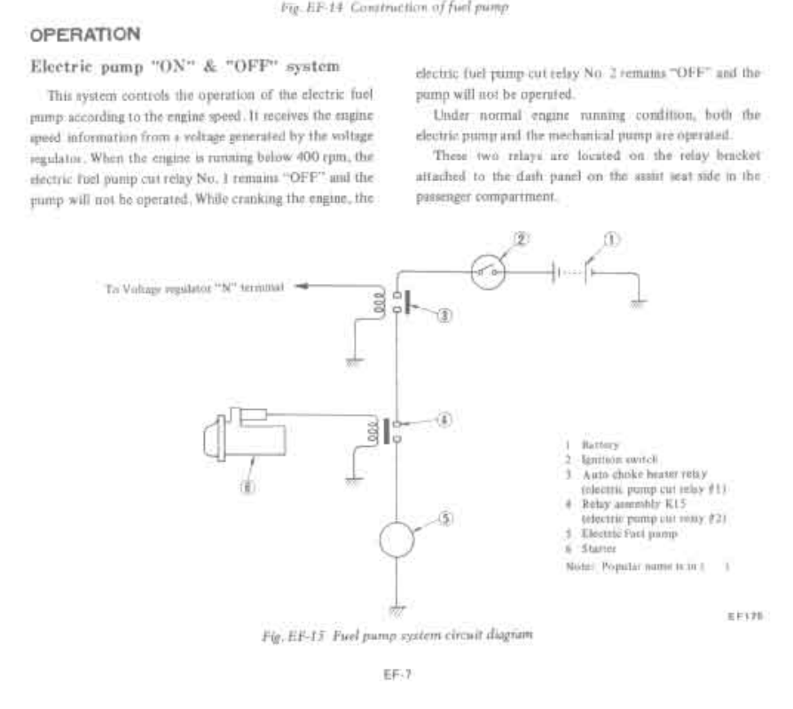

There is in fact an electric fuel pump by the fuel tank, but both of my 260's also have a second fuel pump up in the engine compartment.  On the car in question both electric fuel pumps were active and i only recently bypassed the one in the rear of the car.
Zed, i think you nailed it.  In my haynes manual it spells out the operation clearly.  The motor must be running at 400rpm or higher to engage the electric fuel pump.
My goal was to not introduce new variables when swapping the motor so I think i'll hook up the existing (known working) fuel pump with the wire all the way across the car, get it running, then replace both pumps with one good one in the back of the car.
