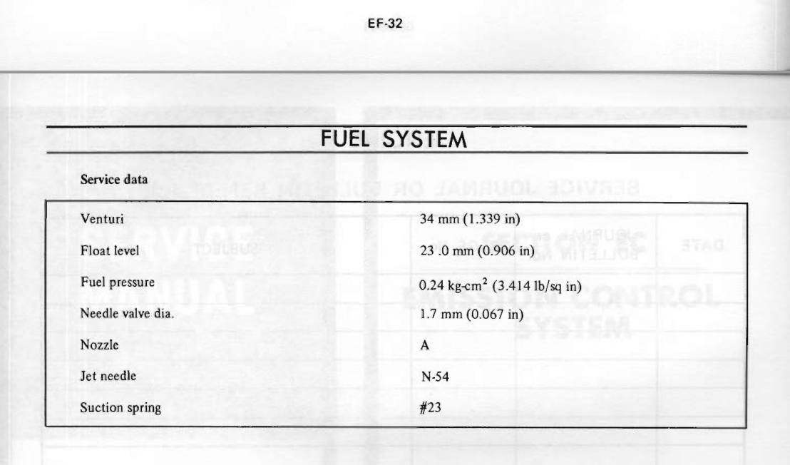

Airtex 8012S measuring 5 psi at the rear carb! I moved the idle timing from 12 to 15BTDC. Do you think this can affect or damage the engine in someway? Trying to advance a Little bit to see if i get rid of the slight hesitation below 2000 RPMS.
All of the links on SU's that I find say that 5 is too high and might cause problems.  I don't even know exactly how the SU's maintain pressure but spec. is 3.4 psi according to the FSM.  I assume that the mechanical pumps regulate internally, and there is an orifice in the carbs that provides back pressure.  You'll need a pump that regulates pressure internally if you want to continue to use that method.  If you don't, again assuming, you'll have to remove the blockages to allow flow and place a regulator in line, or dead- head the carburetors and replumb them, with a regulator at the T with the return line.  From what I gather, the 240Z's all have a return line so there are lots of options.  You still haven't described clearly how exactly your system is plumbed though.  A regulator won't do you any good unless it's plumbed correctly.
