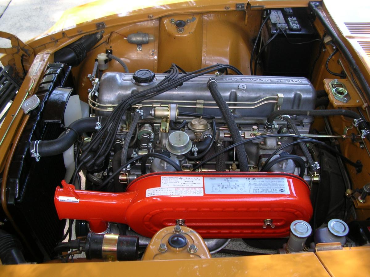

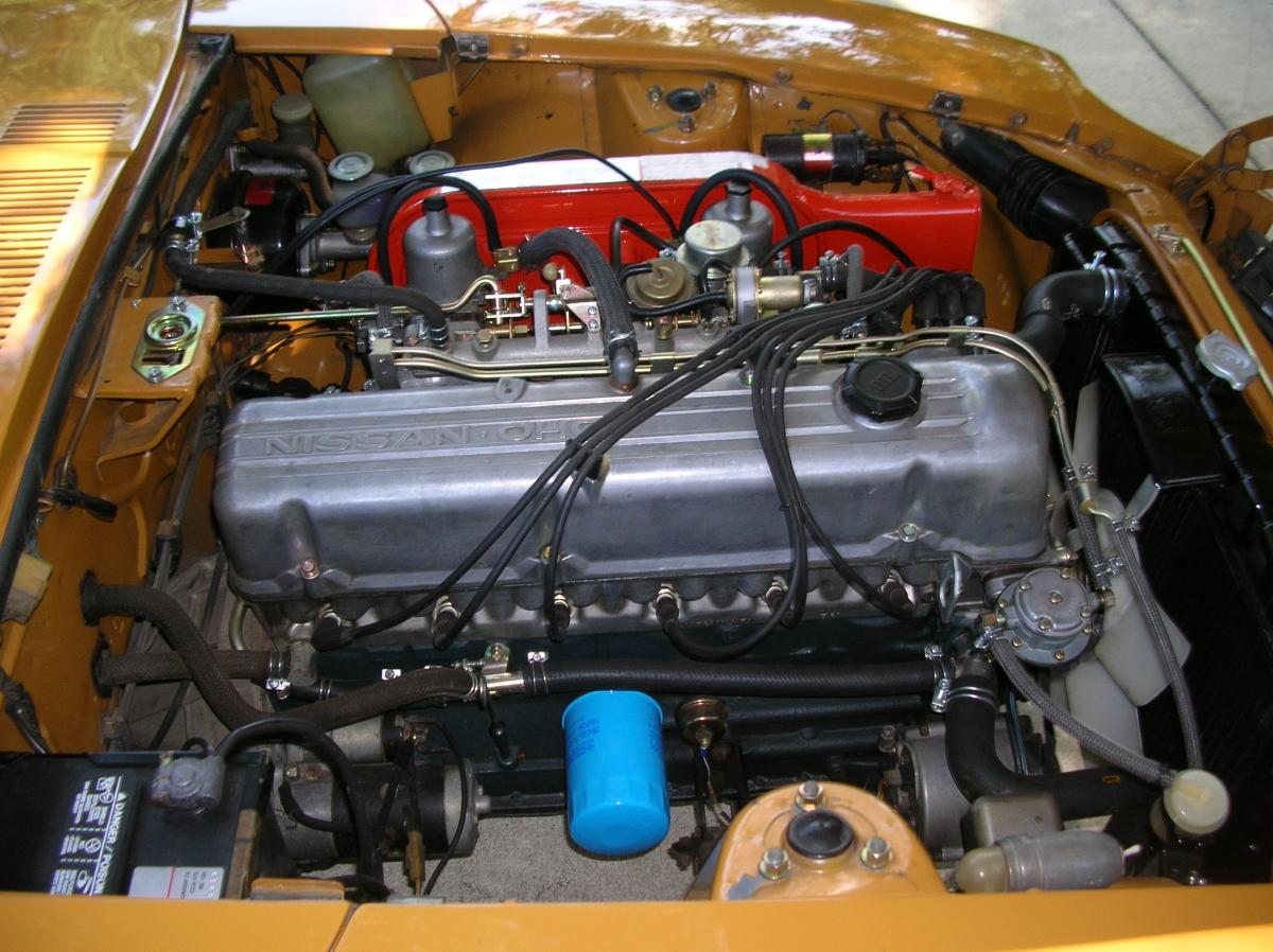

June 5, 20159 yr comment_471311 26th-Z sent me some empirical evidence of the 2-wire clamps being bright silver zinc on an early 70's car, with low mileage at least in the engine bay. Please share the information 26th-Z shared with you.Thanks,Keith Link to comment https://www.classiczcars.com/forums/topic/51594-240z-resto-011970-car/?&page=2#findComment-471311 Share on other sites More sharing options...
June 8, 20159 yr Author comment_471537 Please share the information 26th-Z shared with you.Thanks,KeithHe has posted the images before in another engine restoration thread. Hopefully he'll see this thread and pop them in here. They're not my own personal photos so I'll wait for him to give the green light or post them. But there are a number of photos with pretty clear shots of some tarnished "clear zinc" coated clamps next to some tarnished "light yellow zinc" coated throttle linkage parts. So the difference is quite visible, I'd say. Link to comment https://www.classiczcars.com/forums/topic/51594-240z-resto-011970-car/?&page=2#findComment-471537 Share on other sites More sharing options...
June 8, 20159 yr comment_471542 These are two of the clearest pictures I have. Although this is not the earliest of cars, the brightwork is very nice and clear in color. One thing we noticed was the clamp for the coil. It is silver zinc on my cars. Edited June 8, 20159 yr by 26th-Z Link to comment https://www.classiczcars.com/forums/topic/51594-240z-resto-011970-car/?&page=2#findComment-471542 Share on other sites More sharing options...
June 8, 20159 yr Author comment_471553 These are two of the clearest pictures I have. Although this is not the earliest of cars, the brightwork is very nice and clear in color. One thing we noticed was the clamp for the coil. It is silver zinc on my cars. For that reason, I dropped the coil bracket off today, and asked for it to be clear/bright zinc, instead of what's pictured there. Some things can slip up, but the clamps were clear/bright zinc on the other photo you posted in someone elses engine resto thread as well, so for the clamps I did not go yellow zinc, nor will the coil bracket be on this particular resto. I looked under the unpainted portion and it was definitely silver- no hint of yellow of any kind. Link to comment https://www.classiczcars.com/forums/topic/51594-240z-resto-011970-car/?&page=2#findComment-471553 Share on other sites More sharing options...
