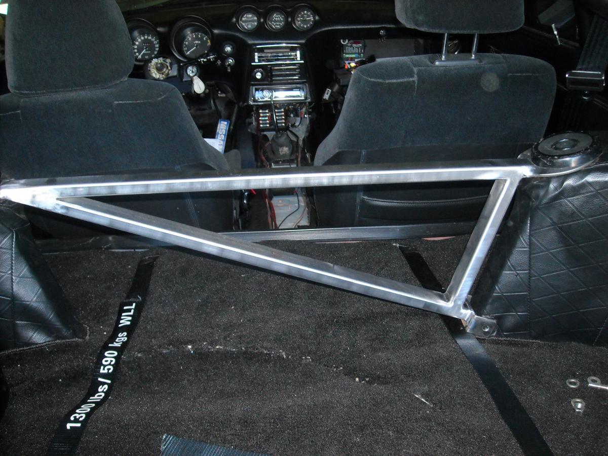

June 5, 20159 yr comment_471354 Looks good John. all welded in it looks like... Link to comment https://www.classiczcars.com/forums/topic/51614-advice-please-strut-braces/?&page=2#findComment-471354 Share on other sites More sharing options...

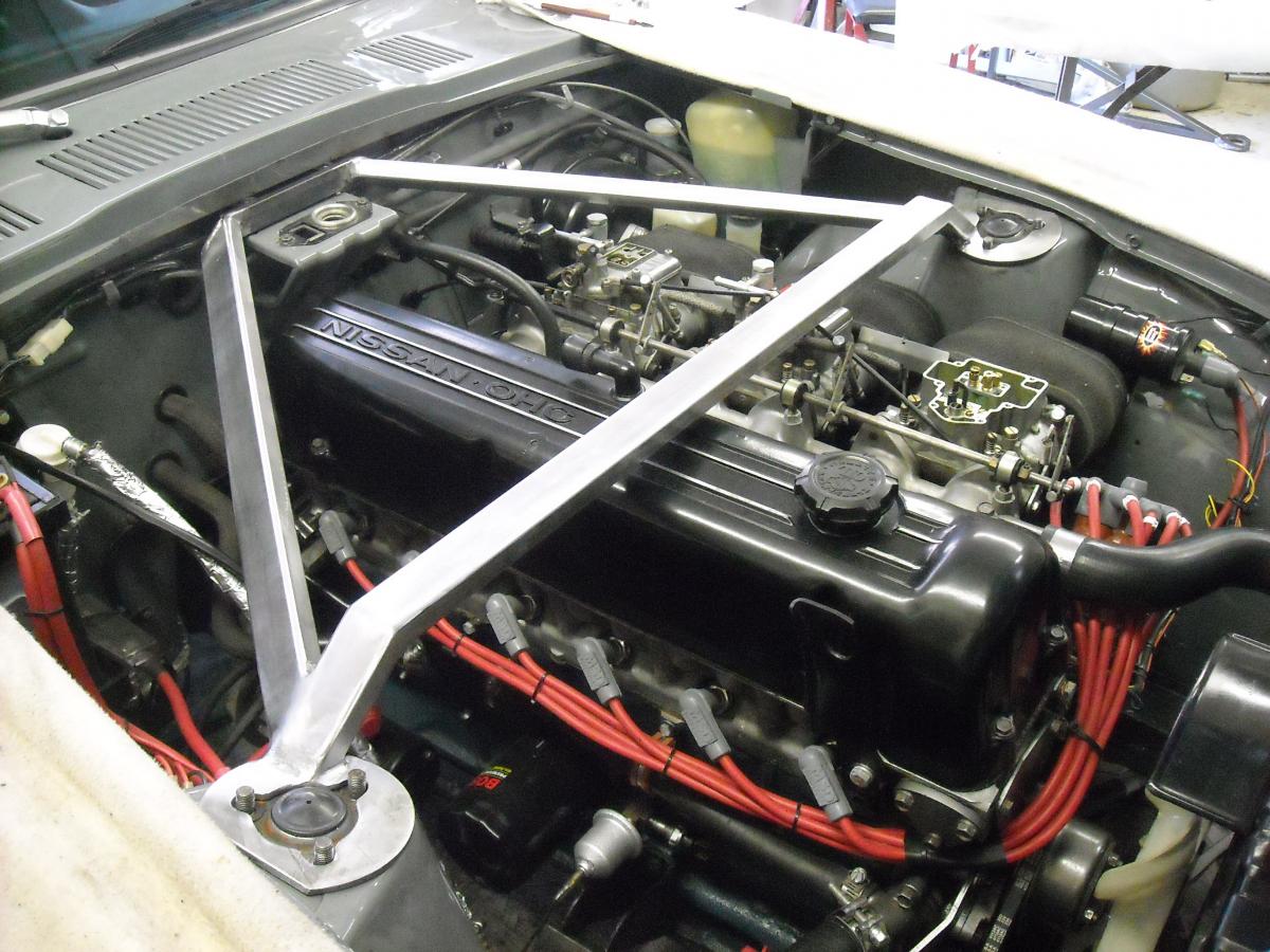

June 5, 20159 yr comment_471358 Here's how to do it: So many interesting things in this picture.... Link to comment https://www.classiczcars.com/forums/topic/51614-advice-please-strut-braces/?&page=2#findComment-471358 Share on other sites More sharing options...
June 6, 20159 yr comment_471371 Build your own, Link to comment https://www.classiczcars.com/forums/topic/51614-advice-please-strut-braces/?&page=2#findComment-471371 Share on other sites More sharing options...

June 7, 20159 yr comment_471470 Here's how to do it: John, I can't tell from your pic, are the clevises attached to a ring that attaches to the three strut studs, or are the clevises welded straight to the strut towers? Link to comment https://www.classiczcars.com/forums/topic/51614-advice-please-strut-braces/?&page=2#findComment-471470 Share on other sites More sharing options...
June 8, 20159 yr comment_471534 The clevis's are welded to the strut tower and a plate on the firewall. It was all custom and is not available as a bolt-in. In general, bolt-in chassis reinforcement doesn't work that well. Lots of other custom work in the pic:Radiator mountRadiatorCooling system routingCooling system overflowIntake manifoldThrottle bodyCAIBrake MC bracket Edited June 8, 20159 yr by John Coffey Link to comment https://www.classiczcars.com/forums/topic/51614-advice-please-strut-braces/?&page=2#findComment-471534 Share on other sites More sharing options...
June 8, 20159 yr comment_471545 It also looks like the brake booster is deleted. Does that cause an issue with making brake pressure? Did you change the master cylinder to accommodate deleting the booster? Link to comment https://www.classiczcars.com/forums/topic/51614-advice-please-strut-braces/?&page=2#findComment-471545 Share on other sites More sharing options...
June 9, 20159 yr comment_471592 Yes, the booster is deleted using the bracket and Tilton balance bar I used to make and sell. It allows mounting of two master cylinders, one for the front system and one for the rear system. That, in conjunction with the balance bar and an adjustable prop valve for the rear system let me dial in the brake balance. Brake pedal pressure was perfect (for me). Link to comment https://www.classiczcars.com/forums/topic/51614-advice-please-strut-braces/?&page=2#findComment-471592 Share on other sites More sharing options...
