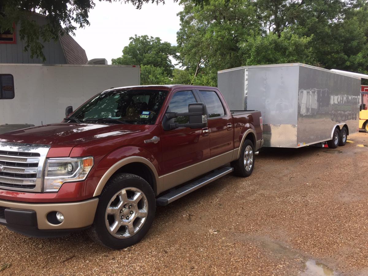

I'll know a lot more about the question you ask in a few days.  I'm towing my Z to Memphis for ZCON and just purchased a new 20 foot enclosed trailer by Continental Cargo.  Purchased it up in Waco and brought it down to Austin about 2 weeks ago.
I am not an expert on trailering but am learning fast.  A couple of data points that I have so far.
My tow vehicle is a 2014 2WD F150 with the 5.0L V8.  Has the complete towing package which includes electric brake controllers.  I believe that total towing capacity for the truck is around 10000 lbs.  Curb weight of the trailer is about 3400 lbs.  I purchased the upgraded axles to 5200 lbs as well as went with torsion axles instead of leaf springs.  You can get the full specs of the trailer here if you are interested:
http://www.continentalcargotrailer.com/default.asp?page=models&unit=valueauto&choice=specs&series=ValueAuto
My trailer model is VHW8520TA3.
On my way up to Waco to pick up the trailer I was averaging around 70 - 75 MPH and got around 19-20 MPG.  On the return trip with an empty trailer, averaging around 65 - 70, I got around 12 - 13 MPG.  I guess there are going to be a lot of gas stops between here and Memphis!!  Will also have to learn how to keep my speed closer to 55 as well!
Having said that I also don't think my trailer and tow vehicle were optimally set up.  Since picking up the trailer a friend whom I consider more an an expert on this topic strongly advised that I have a weight distribution system / anti sway system installed.  This ensures an optimal loading of the tow vehicle from front to back as well as optimal tongue weight.  I ended up having one installed last weekend (made by Curt Manufacturing) and in the short distance I have driven the rig, I can already tell a difference.  The truck seemed to labor a whole lot less and was much more stable on the road.  Like I said, I'll have a lot more for you in a couple of weeks.
I've included a picture of my truck and the trailer taken on the day I picked it up.

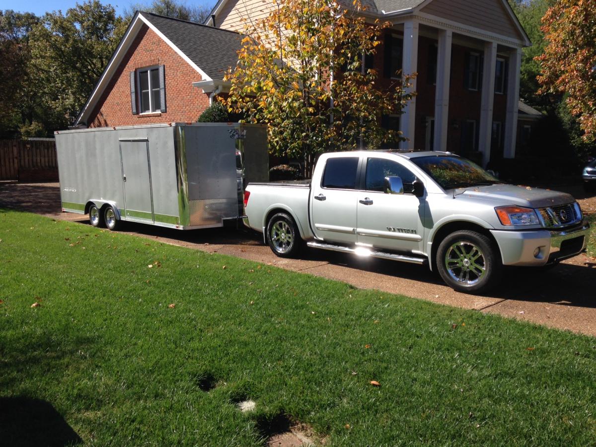

Good luck in the pursuit of a tow vehicle. All the things that have been brought up about engine size, towing capacity, weight load set up etc are all very important. There was a mention as well about brakes and the use of a brake controller. If anyone has not towed a trailer, with a load, especially downhill this item can easily be overlooked. Some people just plug in the harnesses and away they go only to have the trailer try to pass them in an emergency stop going down a grade. Be sure the controller is properly adjusted as well. I tow with a Titan and my set up basically allows me to not realize the trailer is even behind me until I look in the rear view mirror. So again good luck in finding the right tow vehicle and trailer and have a safe trip.
Zulaytr
