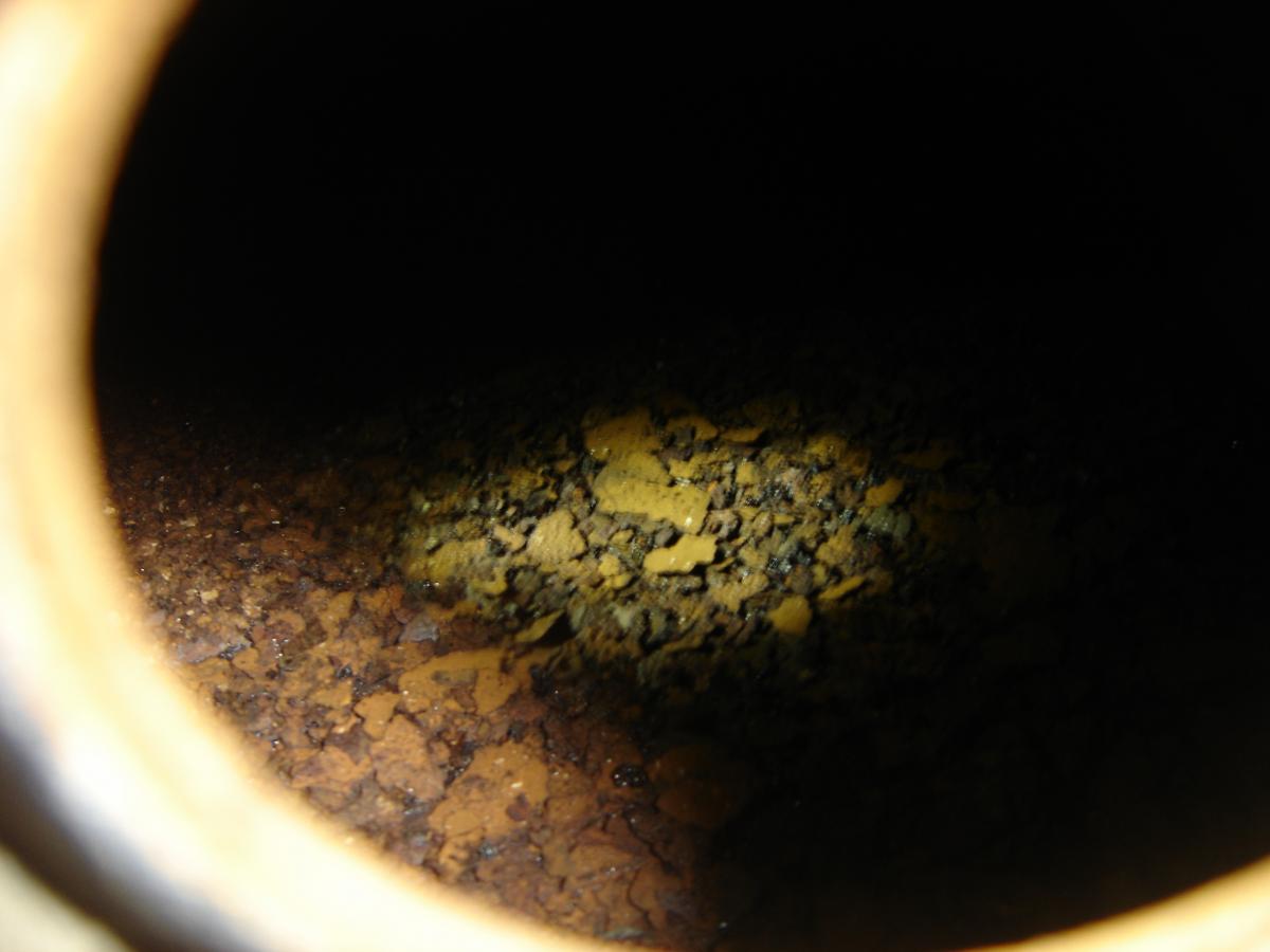

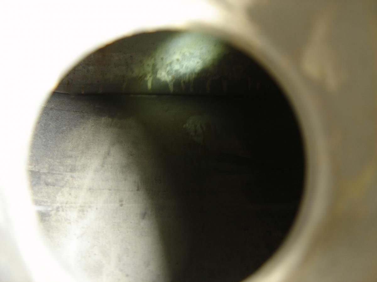

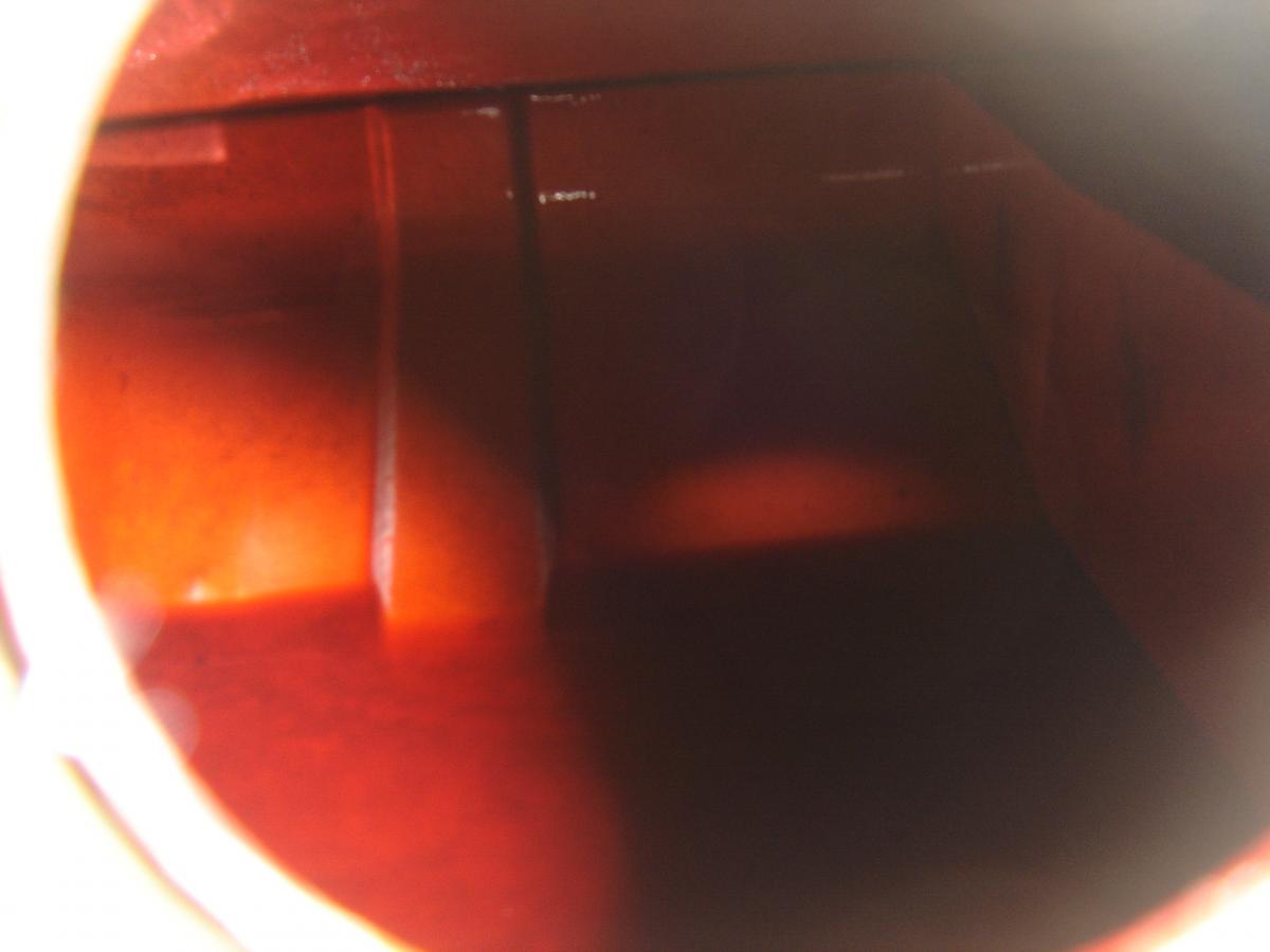

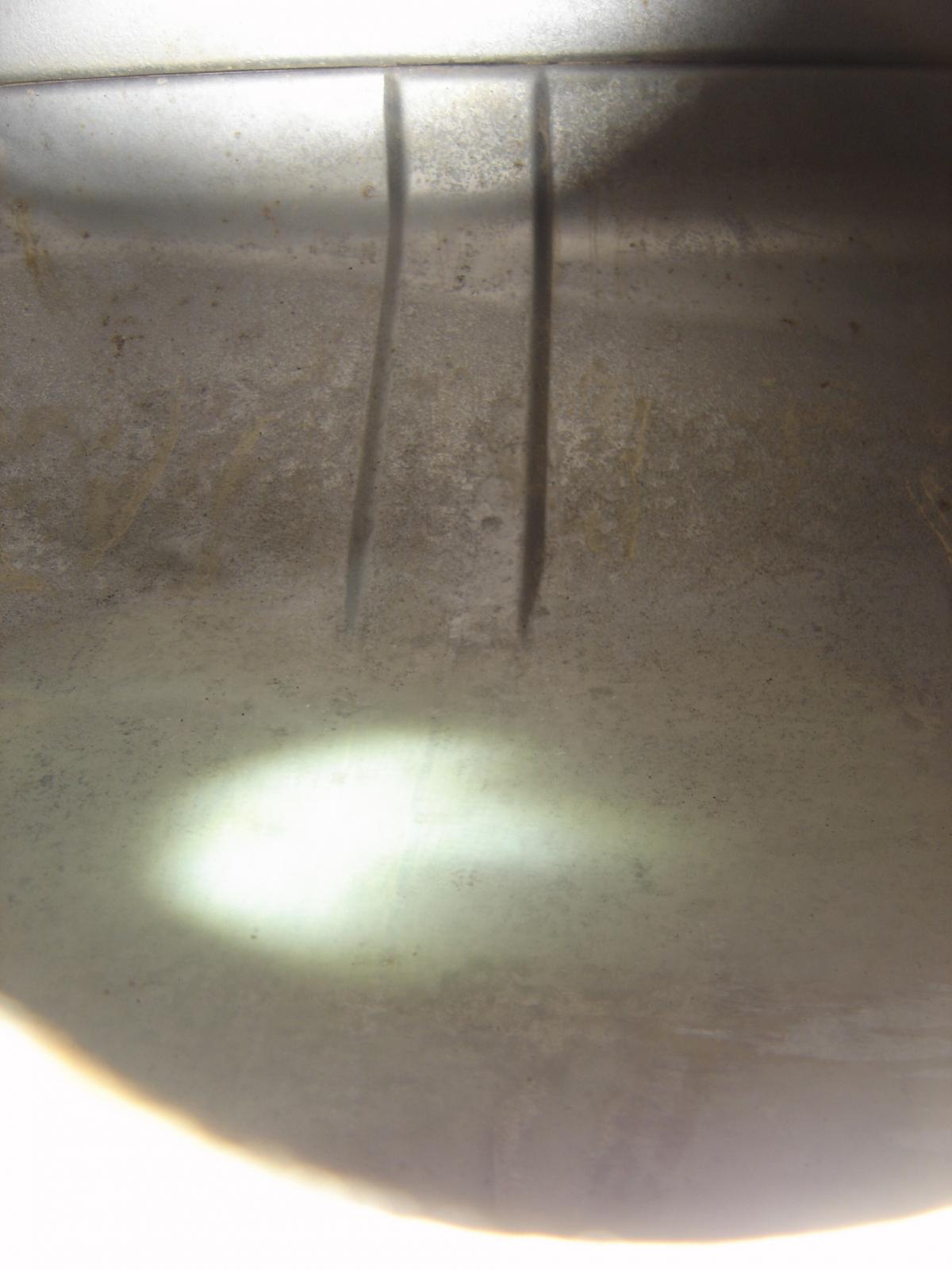

I've done 2.  Quart of Red Kote liner $30, gallon of muriatic acid $5, quart of acetone $10, 4 boxes of baking soda $2.  Leaf blower I have already and I get empty 5 gallon buckets for free.  Drop the tank one day, clean and seal the next.  Takes about a week for the Red Kote to cure.  Here's what gave me the confidence to do it, http://atlanticz.ca/zclub/techtips/fuel/gastank/index.htm
Read this and you'll get an idea of what I did, http://damonq.com/techsheets/red-kote.pdf
post-23570-0-13943200-1436727692_thumb.j
post-23570-0-56516500-1436727730_thumb.j
post-23570-0-30318800-1436727786_thumb.j
post-23570-0-10534300-1436727817_thumb.j
post-23570-0-05277200-1436727852_thumb.j

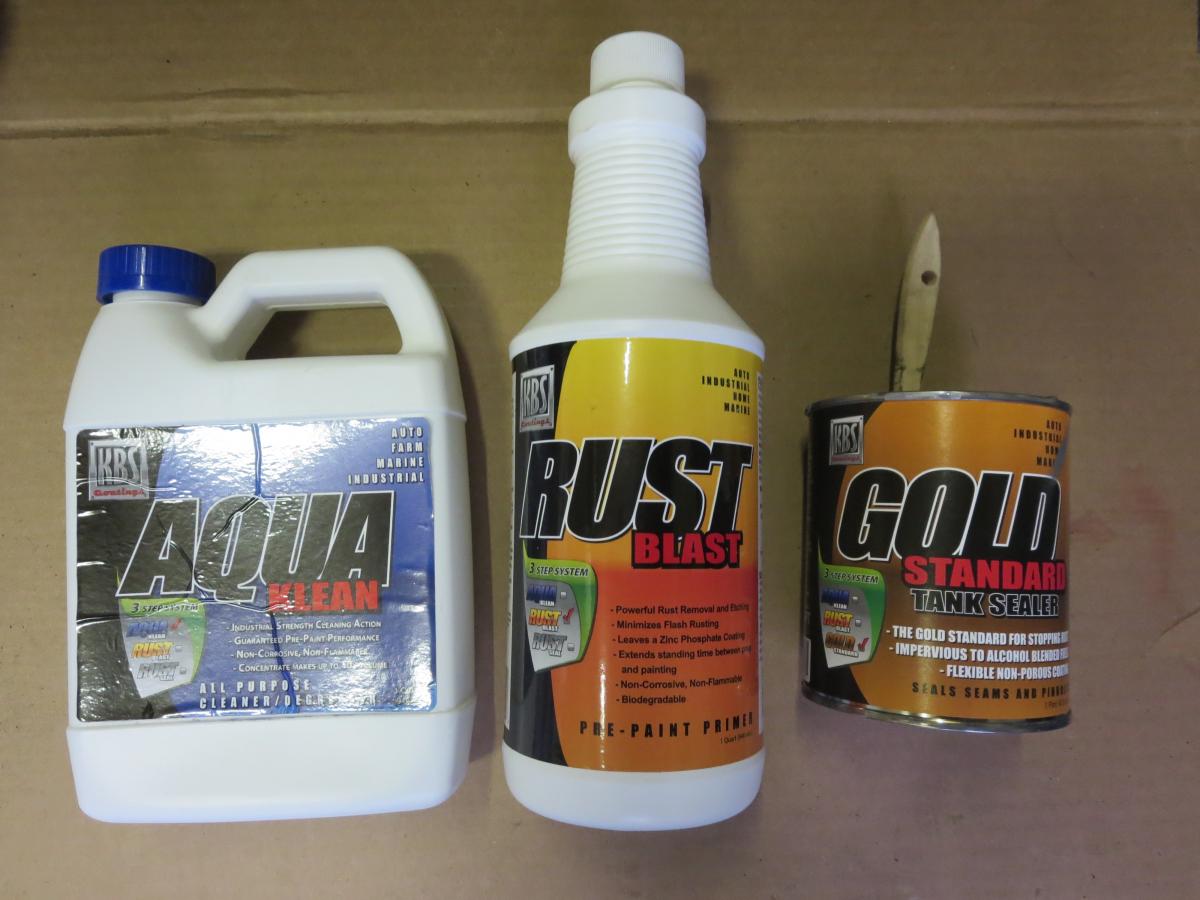

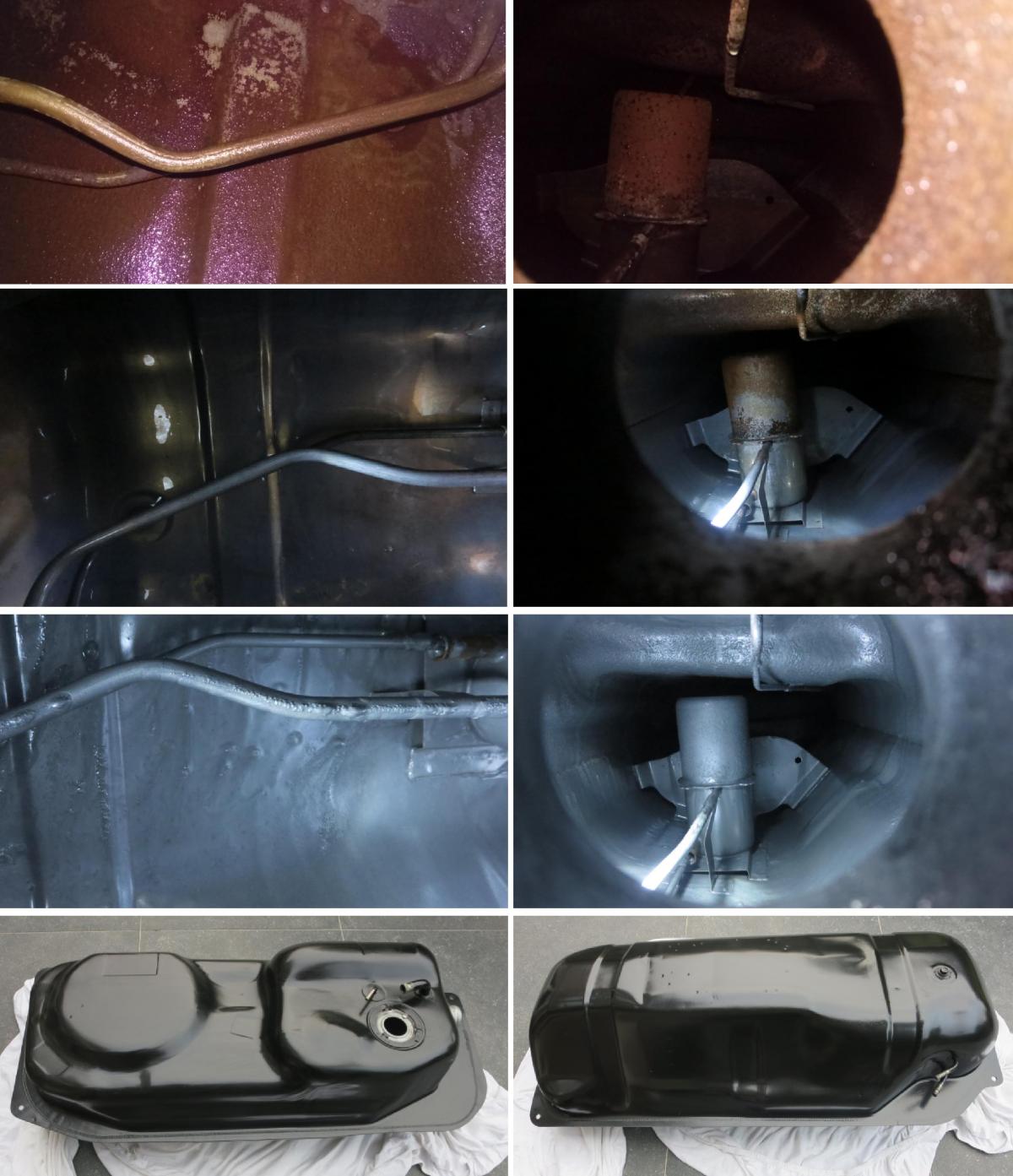

I used a kit from KBS, but there are other brands available. You could try the cleaning solution in the kit to dislodge the material and clean the tank in the process.
The photos are
Row 1: Before treatment
Row 2: After Aqua klean
Row 3: After Tank Sealer
Row 4: Tank repainted
