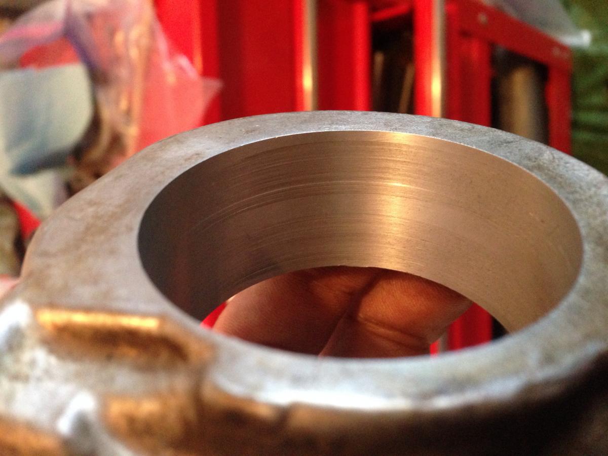

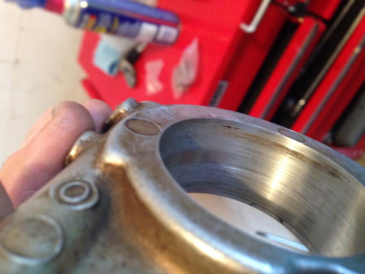

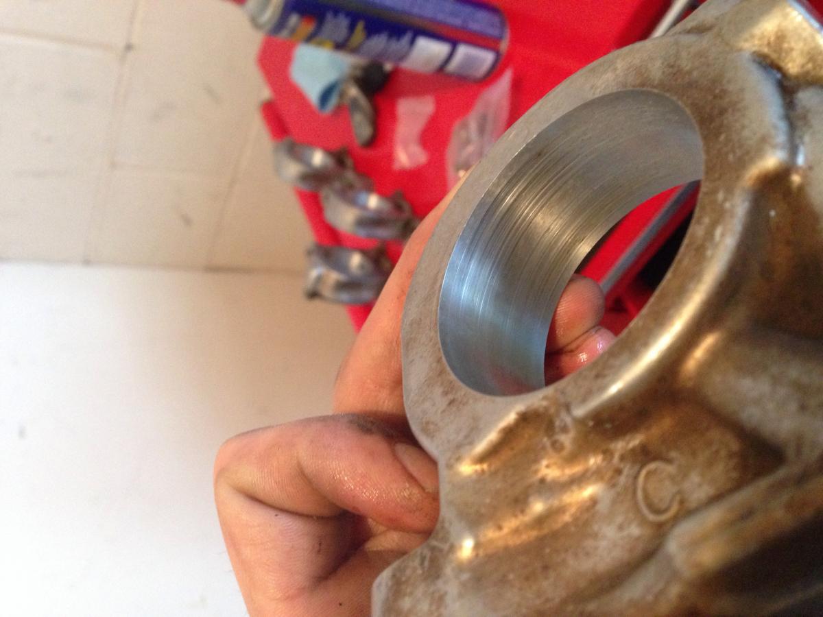

I took the head home as I'm going to attempt my own port and polish job. I ended up buying the spring compressor listed in this thread earlier. So putting the cam towers back on was required. I just tightened them finger tight. I think I may have done some damage. As I was removing the valve springs, I had to turn the cam, and I think I may have have scored the tower bearing surface by doing this. They obviously weren't lined up perfectly. I mean the damage could have always been there, I honestly didn't look. But they are scored no doubt. Some of marks can barely be felt with a fingernail. I'll let the pictures do the talking.
I've read about people having luck sanding these out. Is this a safe option? My other option is to steal the cam towers from my N47 head, this is a safe bet, but perhaps I won't be able to line them up properly?

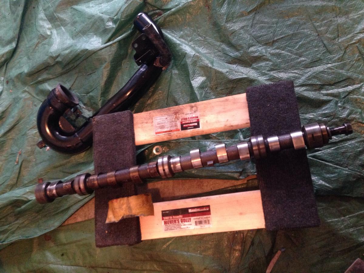

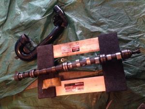

I also tried following Blue's footsteps and tried to clean up the rusty cam that was in the P90.  I'm getting it reground, so I thought I may as well use a "junk" cam if he will accept it.  I tried scotchbrite but was getting nowhere.  I ended up using WD40 and 400 grit sandpaper.  After a few hours of rubbing I was able to clean most of it up.  I'll be discussing my cleaning process with Colt Cams to see if it is useable, or just a paper weight right now.

Do the Nissan heads not use a pressed in cam bearing? I have never looked that close...The one with the deep grooves are pretty deep. I wouldn't think sanding them out would be a good idea. If there is no bearing then replace the towers or have them line bored and add a bearing sleeve.
When I sent my cam to Schneider they used it as a core trade in and sent a nice clean cut cam back to me, I marked mine with a Dremel engraving bit to see.  If you have some spare towers I'd use them, peace of mind for the future.  I cleaned mine with 600 grit and WD-40, just enough to get a shiney finish inside the cam towers.
