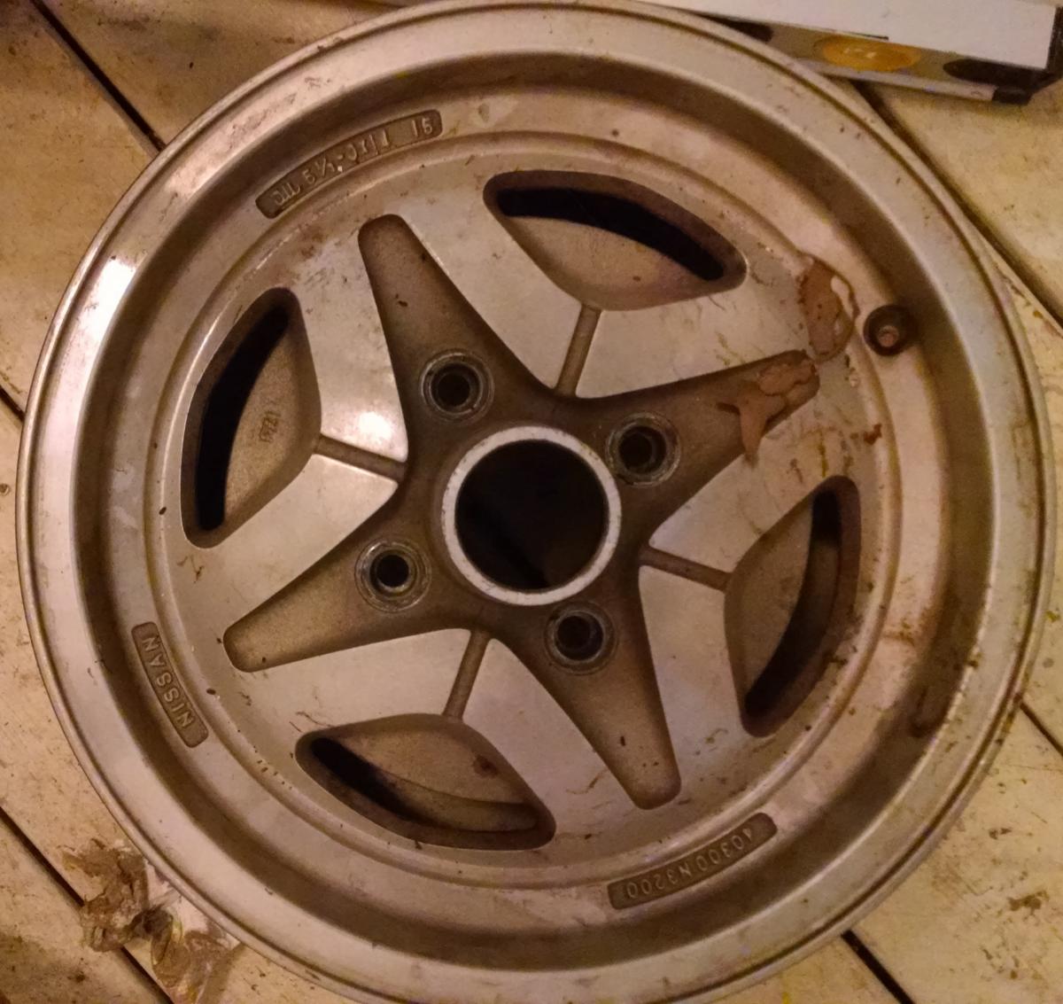

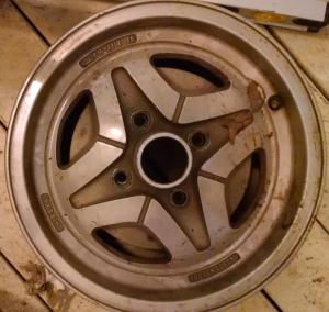

A quick internet search didn't help.  I found people claiming everything from zero to +12mm for the six spoke wheels.  I would trust the zero claim the most since the site listed the offsets and weights for many of the common stock and aftermarket Z wheels.
You don't need  hub extenders to attach the ZX wheels, but you do need to know how much room you have to work with for different wheels, considering the offset and backspacing of the ZX wheels.
You talk about changing between bolt paterns, and spacing what wheels are you looking at?  You might want to look at changing the hubs.  This might not be a bad idea.
On my first Z I looked into several rims and the cost of custom rims were minimal when you add in the spacer cost.  SO I went with Colorado Custom rims.  It was worth it because the wheels fit perfect.
