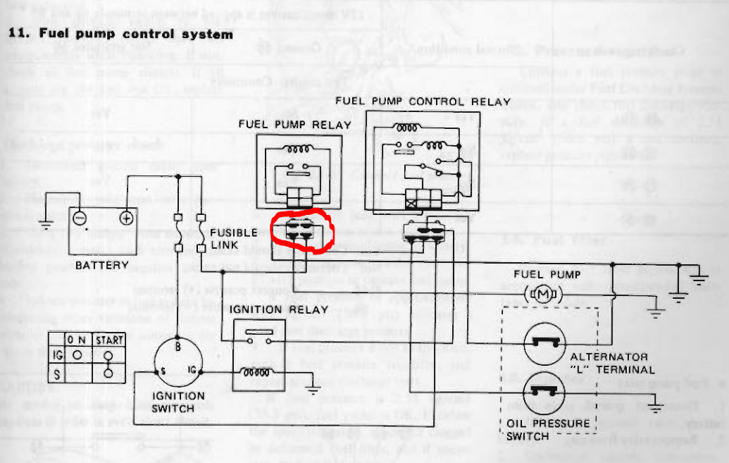

August 20, 20159 yr Author comment_476151 On 8/20/2015 at 8:43 PM, Zed Head said: I'd try the last one first. It's pretty easy. You might be able to jump the fuel pump relay plug in the cabin instead of running a bunch of wire to the pump. Just let it run, that's what it does when you're driving. Won't hurt. That fuel pump relay, I must be blind because I didn't see it in the cabin. Where is it? It is not hidden in the engine bay under black metal cover on the right side of the engine, just in front of the battery, is it? Those are EFI relays, correct? On 8/20/2015 at 8:43 PM, Zed Head said: It looks like you've checked everything and it's all working to spec. but you're still not getting enough fuel at Start to kick the engine off quickly. If the CSV is not squirting because the thermotime switch is open, that means the injectors aren't squirting enough. Which might be because the Start enrichment designed in to the ECU, through injector open duration, is not enough. Either the enrichment is not working or it's just not set high enough.The low enrichment during start is what has always been on my mind when I started doing all these tests. I just don't understand why. I think it is also emphasized by incorrect CSV operation. As I recall correctly, my voltage at the starter when cranking was acceptable as concluded by one of you guys here. The starter definitely makes this "big buzz" as you accurately described it. It has been doing that even more often recently and it prevents me from holding the key in the START position therefore not allowing for a longer cranking . Link to comment https://www.classiczcars.com/forums/topic/52060-280z-difficulty-starting/?&page=11#findComment-476151 Share on other sites More sharing options...

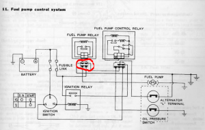

August 20, 20159 yr comment_476155 The control relay and the pump relay are both in the engine bay under that cover. There's a diagram on page BE-6 (edit - went ahead and added that picture too). I don't know how comfortable you are with wiring but a jumper wire at the connector (circled in the attached drawing) should run the pump just fine and completely bypass the control relay. A paper clip might do the job but make sure it doesn't touch any metal. It's connected directly to the battery and could short. As soon as you jump it the pump will run. While you're there, take a look at the control relay. If it's dirty and corroded it might need a good cleaning. They can be disassembled. But try the jumper wire first, that will tell the story on the control relay quality. CO might have some comments. He has dug much deeper in to the system. I'm suggesting this because it would be easy if you don't mind playing with electricity. A few screws, remove a plug, add a paper clip. More knowledge. Edited August 20, 20159 yr by Zed Head Link to comment https://www.classiczcars.com/forums/topic/52060-280z-difficulty-starting/?&page=11#findComment-476155 Share on other sites More sharing options...
