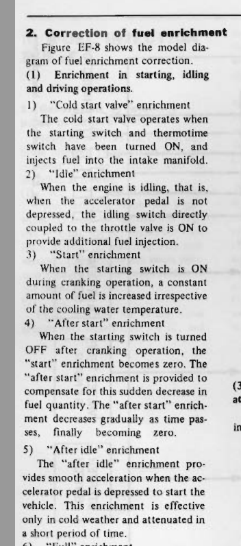

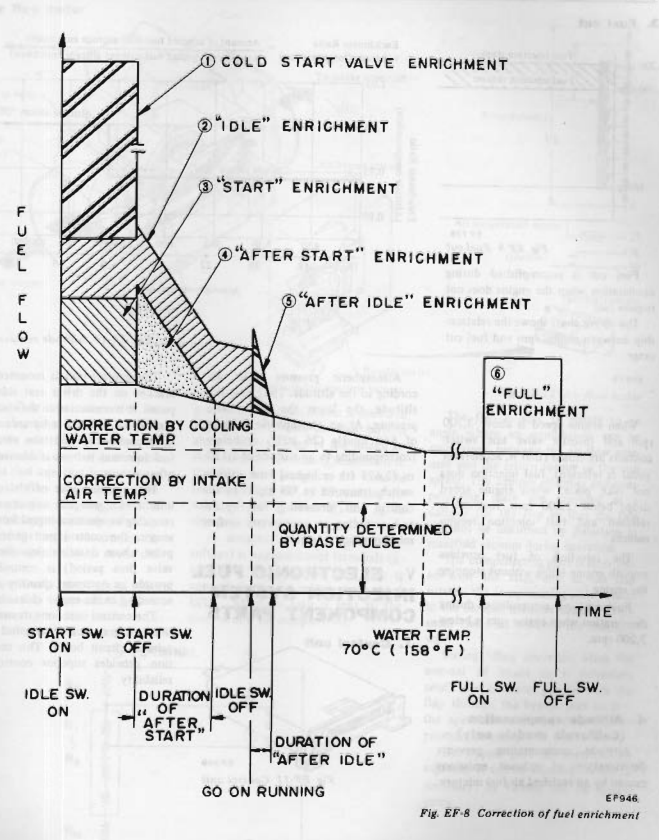

August 11, 20159 yr comment_475564 Since you're above CSV activation temperature, but the engine does try to start, you might look at the other enrichments.  I've studied the chart and the descriptions and sometimes misinterpret what they're saying, and can't always tell when exactly things happen, but they're still worth a ponder.  "Start enrichment" is the CSV contribution I believe.  In the past I thought that it might be more time on the injection pulse but probably not.  "After start" enrichment is an interesting one.  Seems to fit your time frame but it's not clear what parameters put it in to action.  Maybe the "idle" switch along with the Start signal?  Maybe just the Start signal?  Who knows?  "Idle enrichment" seems easy enough.  If the idle switch is actuated the ECU adds time to the injection pulse for more fuel.  So there's two things that might affect behavior right after starting, both connected to the idle switch.  Were it my car, I'd check the throttle position valve [TPV (aka TPS)].  They have contacts inside, not well protected from the elements.  They get dirty.  Maybe you're missing your idle enrichment.  Check at the ECU connector first, where the signal gets used.  Here's another link to a useful book, which hsows how to check everything at the ECU connector, maybe easier to work through than the FSM.  Use the 280Z/ZX Electronic Fuel Injection Guide.  Third one down.  http://www.xenonzcar.com/s30/otherguides.html  Link to comment https://www.classiczcars.com/forums/topic/52060-280z-difficulty-starting/?&page=6#findComment-475564 Share on other sites More sharing options...
August 11, 20159 yr comment_475565 Kind of funny - I misinterpreted the chart again. Â It actually shows CSV enrichment as separate from Start enrichment. Â So Start enrichment is probably always there hot or cold, maybe to varying levels depending on temperature. Â Since the system is designed to be started with the throttle closed, idle switch actuated, I wouldn't be surprised if your idle switch is dirty or maladjusted and part of the problem. Â Also wouldn't be surprised if ti was fine and not your problem. Link to comment https://www.classiczcars.com/forums/topic/52060-280z-difficulty-starting/?&page=6#findComment-475565 Share on other sites More sharing options...
August 11, 20159 yr Author comment_475566 Thanks Zed Head. I do have the book you are referring, 280Z/ZX Electronic Fuel Injection Guide. I read through it once, but obviously will have to read again and perform some tests. Now I have these couple of things to check: 1) CSV-in-the-jar test with water temp sensor disconnected.2) Throttle Position Sensor clean up and test. Link to comment https://www.classiczcars.com/forums/topic/52060-280z-difficulty-starting/?&page=6#findComment-475566 Share on other sites More sharing options...
