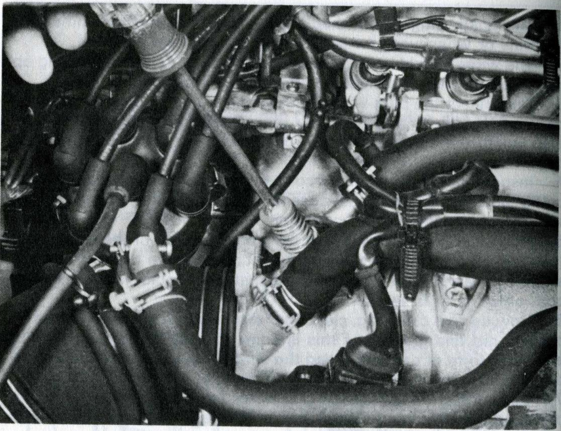

November 7, 20159 yr comment_480712 I wonder if raising the idle speed slightly would help. The rich oily fuel air blend might be too much for a cold engine. As I understand things, on the dual pickup ignition systems there are two things that keep the idle speed up when the engine is cold - the AAR and the second pickup. The AAR stays open for just a few minutes, but the second ignition system keeps the timing advanced until the engine warms up. Which could take about 20 minutes. Advanced timing increases engine RPM. Anyway, it might be worthwhile to increase idle RPM a couple hundred RPM. Turn the screw circled counterclockwise. You can actually do it by hand some times. Stole a picture from this link, post #4 - http://www.classiczcars.com/topic/37021-no-idle-screw/ Link to comment https://www.classiczcars.com/forums/topic/52141-redwings-car-an-update/?&page=15#findComment-480712 Share on other sites More sharing options...
