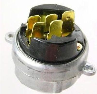

Likely not the only issue with RB but I am becoming suspicious of the ignition switch itself.
It does not happen very often but they do go bad.
If it were mine as long as we are trying parts out, I would try a different switch.post-4108-0-20988700-1447212521_thumb.jp
I did have a spare so I will see if I can find it.
