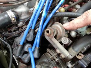

August 31, 20159 yr comment_476783 This is Grey's finger pointing to: (1) the white cap on the dash pot was missing. Edited August 31, 20159 yr by Redwing Link to comment https://www.classiczcars.com/forums/topic/52141-redwings-car-an-update/?&page=4#findComment-476783 Share on other sites More sharing options...
