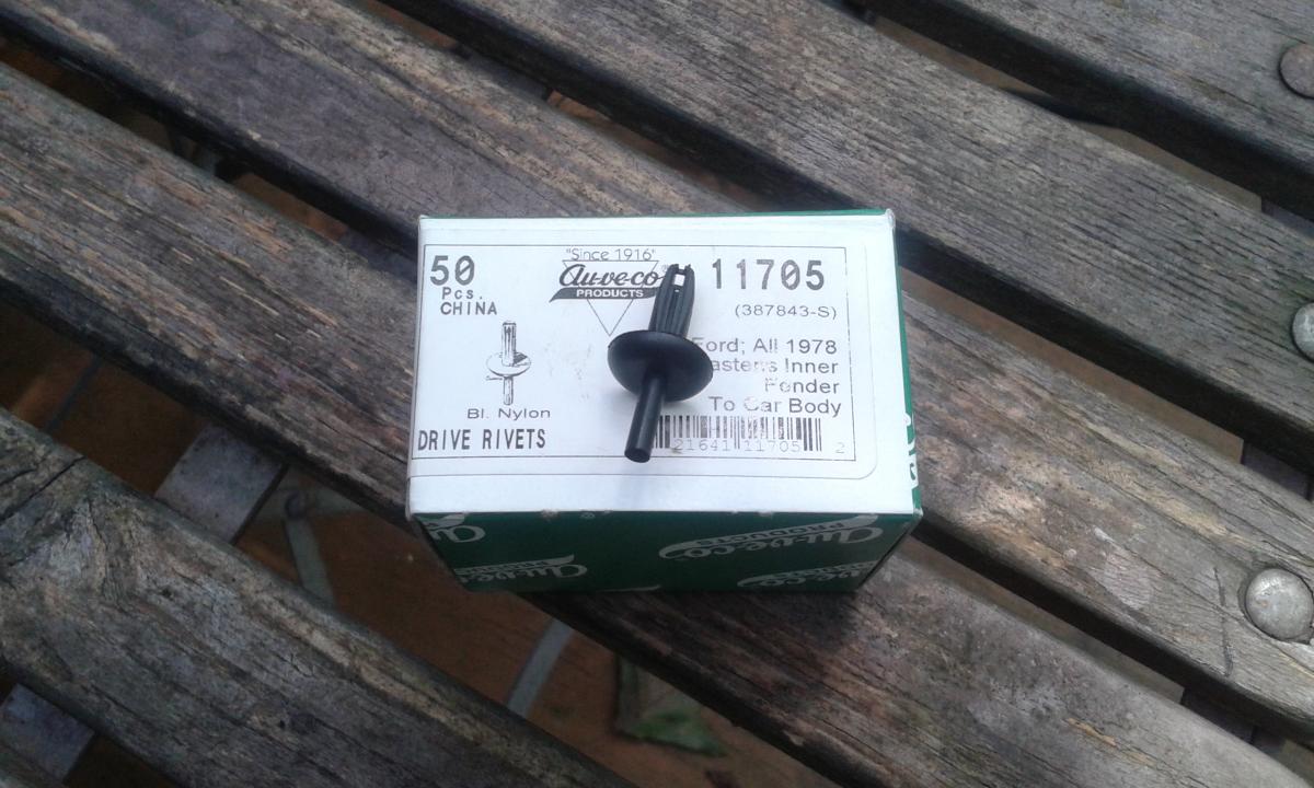

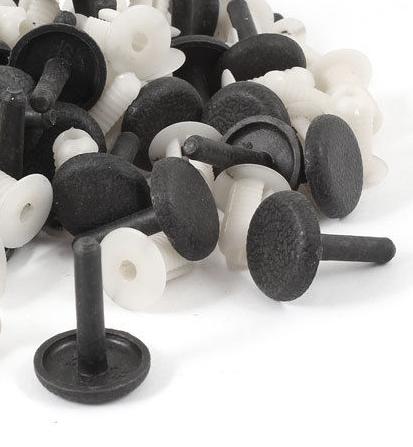

This was the last attempt to get 5mm rivets from an asian vendor:
post-1411-0-23055700-1440432502_thumb.jp
If the rivet body would fit the 5mm hole, these would  be perfect.
