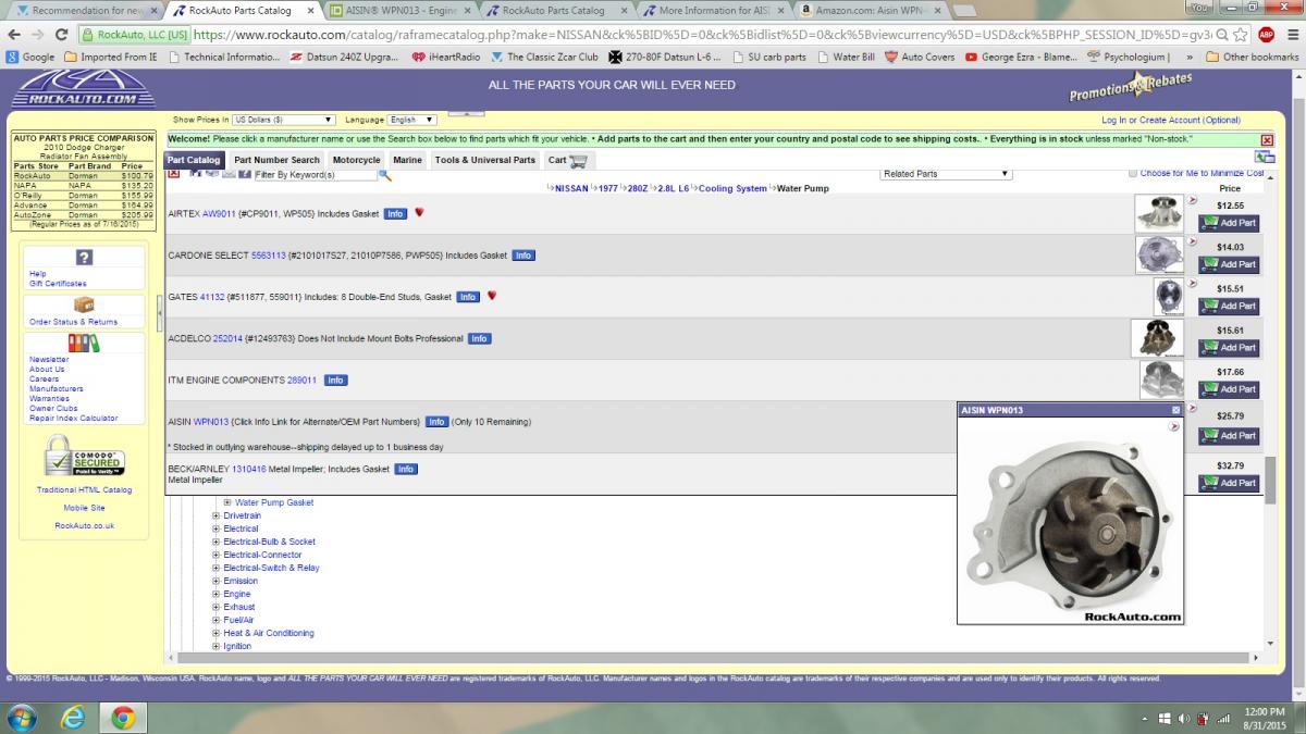

This is the same, and best in my opinion, impeller design as the original.  Amazon.com has the Asin for $29.99.
http://www.amazon.com/Aisin-WPN-013-Engine-Water-Pump/dp/B008EEZ2XY/ref=sr_1_5?ie=UTF8&qid=1441037491&sr=8-5&keywords=240z+water+pump
