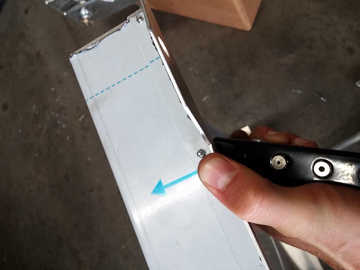

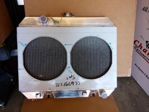

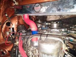

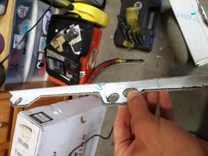

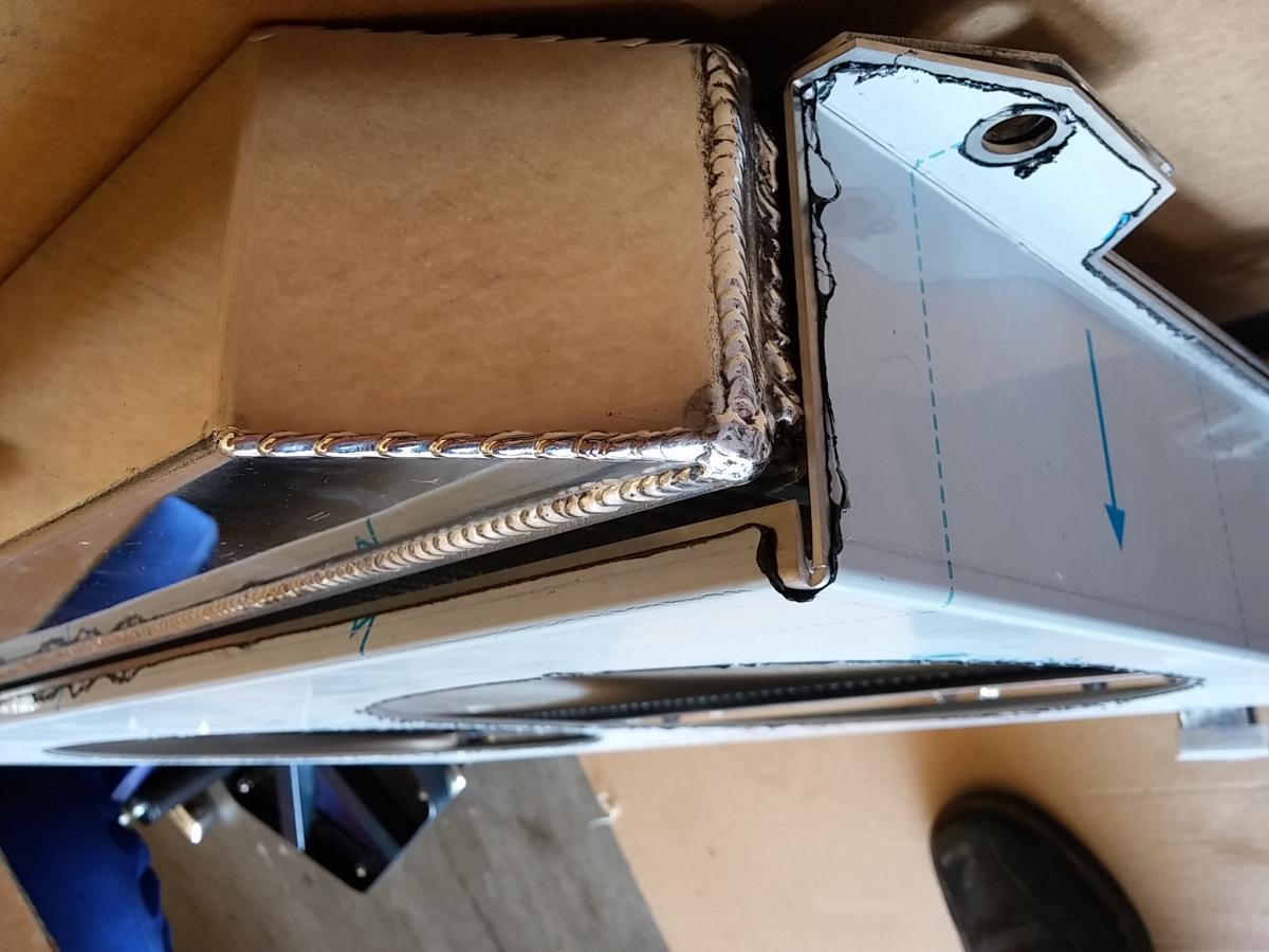

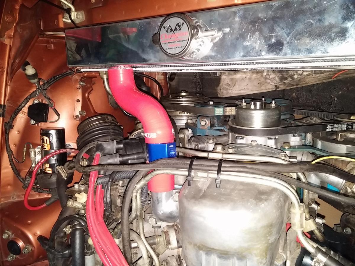

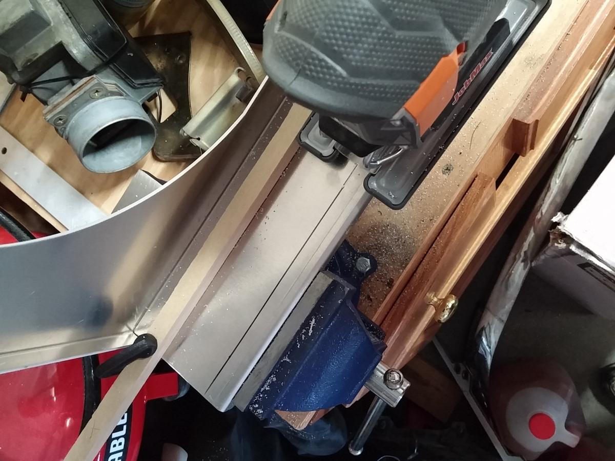

Mike W,  I went similar way you did the fist time around. I got Champion 3 core radiator. I also got their dual fan shroud  that they just recently started to offer(which I had to modify in order to really fit tightly, it was  a missed opportunity on Champion's side and I let them know about that). I got two SAPL 11" fans that draw 9.5 AMPs each (I got the 12" first but hey were just a pinch to large and they were sticking about 1/4 " outside the radiator on each side). I used inline radiator hose adapter to mount a thermo switch. I found one that had 1/8 NPT threads that matched my wiring harness that I got from Derale: http://derale.com/products/electric-fans/fan-controllers/single-stage/standard-transmission-cooler-mount-kit-11-32-detail  I have seen the Dakota fan controller, but that was just a bit too expensive for me at this time. I'm still putting all this together. Here are few pictures of the shroud modification and the sensor adapter.
This is the shroud on the radiator. It has long sides that wrap the radiator and use radiator mounting holes
post-30354-0-96250900-1443616864_thumb.j
As a matter of fact the sides were a little to long and created gaps on top and the bottom of the radiator as shown here
post-30354-0-33250400-1443616959_thumb.j
So I decided to shorten it a bit
post-30354-0-39588800-1443617036_thumb.j
post-30354-0-09153300-1443617061_thumb.j
post-30354-0-58962800-1443617098_thumb.j
And here is the sensor adapter on my new silicon hose
post-30354-0-32779000-1443617124_thumb.j
