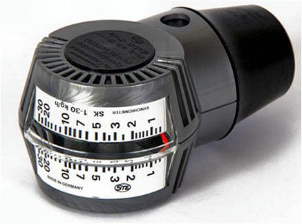

If you're going to keep your carbs I'd spend $30 on one of these, ebay or amazon has good prices.  Takes the guessing out of the process.  :)
