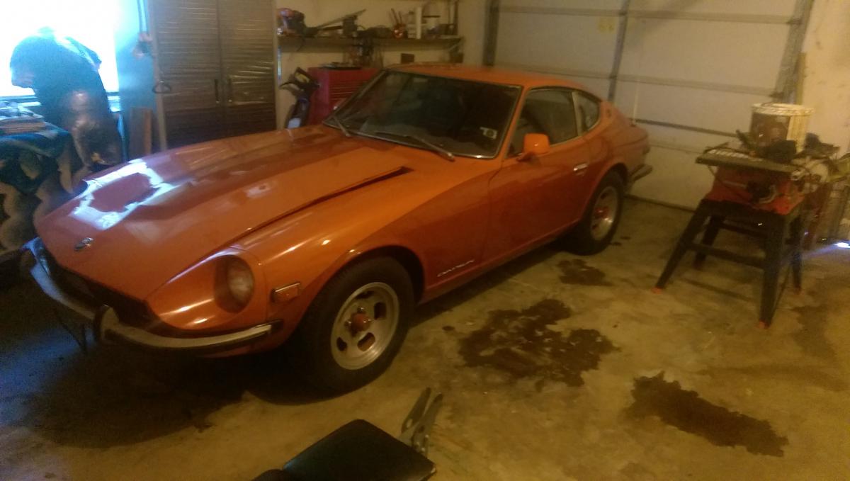

October 20, 20159 yr Author comment_479433 Original orange on top / Ford TerraCotta on bottom Link to comment https://www.classiczcars.com/forums/topic/52348-new-member-from-oklahoma/?&page=2#findComment-479433 Share on other sites More sharing options...
