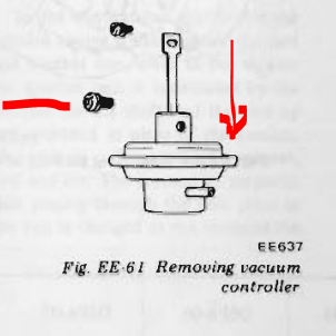

September 14, 20159 yr comment_477543 If you do find that the internals of your 76 distributor are rusted and gummed up, the ZX distributor is a good option also, because it uses a high energy ignition control module and coil (so you'd want a newer coil too, projects always grow...). 1976 still uses a low energy coil and ballast resistor. But if the guts are in good shape, it might be worth keeping. I marked up a picture to show another simple way to check the breaker plate. But, they are almost always rusty and need lubrication. They are super easy to take out and replace and you'd have to work to get it in backwards (no offense to those that have managed to do that). It will only install the right way or 180 off, no gear teeth to worry about. It will only go in 180 off if the tang and slot are worn, and you can't distinguish the big half moon from the small one.. Take the big screw out, it might be very tight, gently loosen the vacuum module, it might be very tight, and gently pry it out part way with a screwdriver. It might be very tight. The breaker plate with the pickup coils on it should rotate. But, if you pull too hard you might break the bearing holder under the plate and screw things up. So it's dangerous. Were it mine, I'd loosen that big screw while it's mounted in the engine, give the module a little twisting to break it free, then remove the distributor and take a good look. The breaker plate comes off easily also, and you can check the centrifugal weights. The other way to check operation though, is with a timing light. Connect intake vacuum directly to the module port and see what happens to timing. Edited - backward arrow. Edited September 14, 20159 yr by Zed Head Link to comment https://www.classiczcars.com/forums/topic/52360-reluctor-and-other-distributor-parts/#findComment-477543 Share on other sites More sharing options...
