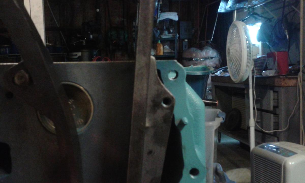

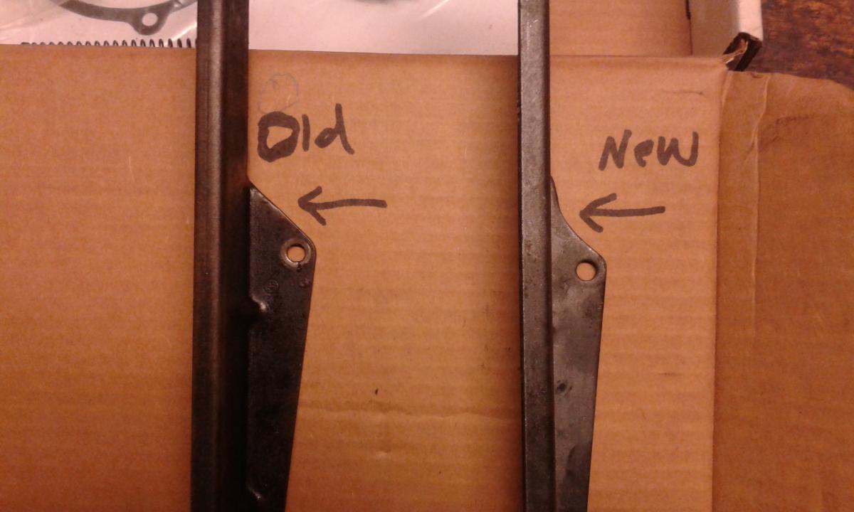

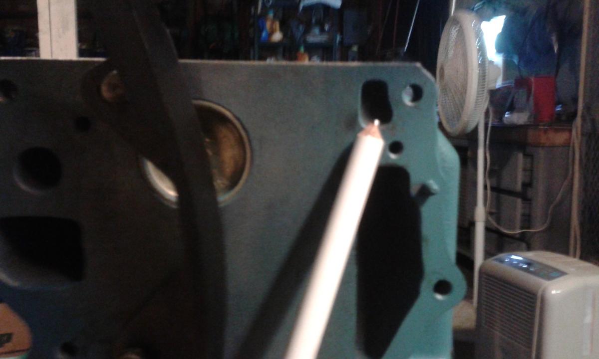

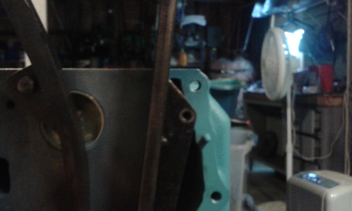

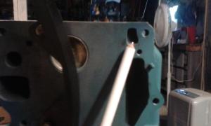

September 15, 20159 yr Author comment_477596 Zedhead I can only find one small difference. The straight tight side guide has a little more indent the the OE one from the 2.4. It opens up a very little more on some hole in the front of the block. I'm gonna take some pictures to look at. Tell me what you think. I don't now what the purpose is of the hole. Thanks for the kermani tip. I'll look into that. Link to comment https://www.classiczcars.com/forums/topic/52368-timing-kit-differences/#findComment-477596 Share on other sites More sharing options...
September 15, 20159 yr Author comment_477598 The new one for the 2.8 actually closes off more of that cavity. I think I have it backwards above. Link to comment https://www.classiczcars.com/forums/topic/52368-timing-kit-differences/#findComment-477598 Share on other sites More sharing options...
September 15, 20159 yr comment_477601 Cliff, that hole is there to collect thick oily goo Link to comment https://www.classiczcars.com/forums/topic/52368-timing-kit-differences/#findComment-477601 Share on other sites More sharing options...
September 15, 20159 yr Author comment_477604 Cliff, that hole is there to collect thick oily goo Is that good for something? Should I worry or buy a 240 tight side guide? Everything else seems to be the same. Thank you Chris, I thought that was a coolant pocket. Link to comment https://www.classiczcars.com/forums/topic/52368-timing-kit-differences/#findComment-477604 Share on other sites More sharing options...
