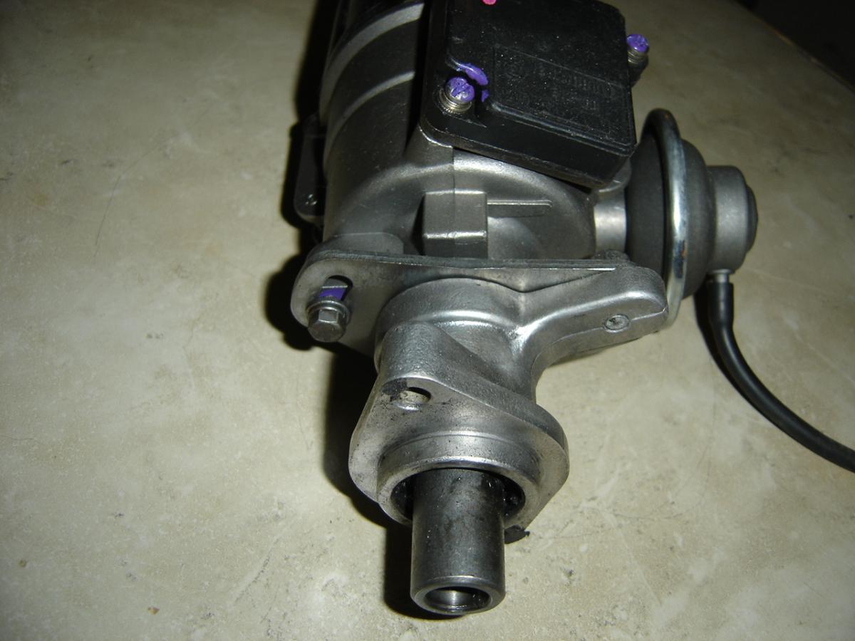

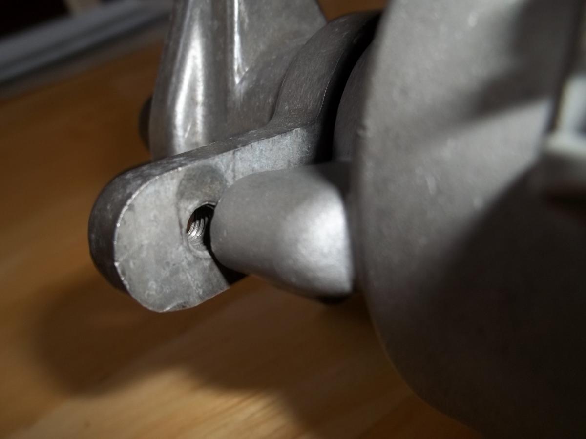

Posted September 26, 20159 yr comment_478026 I have a D6k8-02 distributor. The tangs with the threads don't line up. You can see in the pic the hole with the threads sticking out. They are supposed to be bolted together aren't they? The spacer's tang is at 9 o'clock when put in car. Should I have a different spacer? thank you very much. Link to comment https://www.classiczcars.com/forums/topic/52436-280zx-distributor-spacer-into-71/ Share on other sites More sharing options...

September 26, 20159 yr comment_478045 Okay, I saw your other post with the pics. Looks to me like you're missing the adjusting plate? or whatever it's called. Link to comment https://www.classiczcars.com/forums/topic/52436-280zx-distributor-spacer-into-71/#findComment-478045 Share on other sites More sharing options...

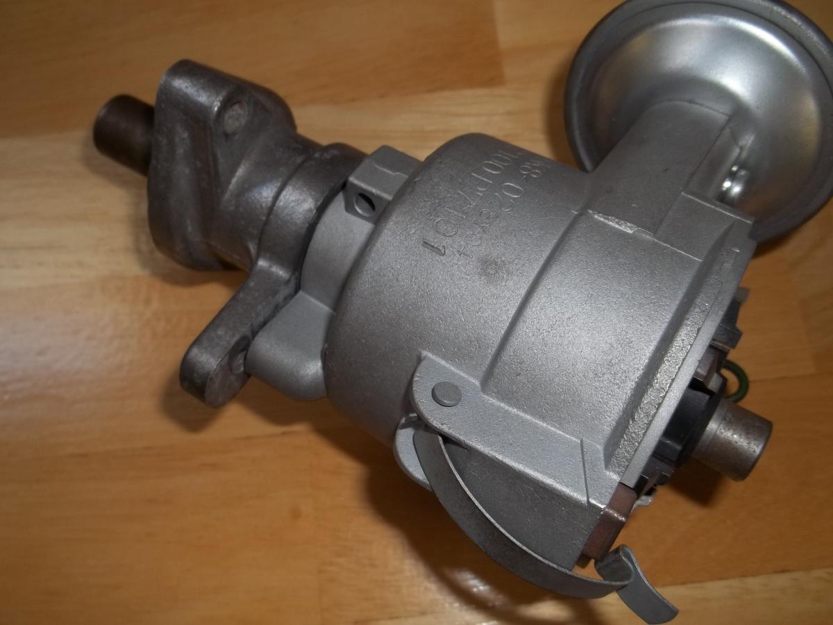

September 26, 20159 yr comment_478046 I forgot I had half of my motor in my spare bedroom! You need that plate and then turn it 180 degrees. Here's mine; Link to comment https://www.classiczcars.com/forums/topic/52436-280zx-distributor-spacer-into-71/#findComment-478046 Share on other sites More sharing options...

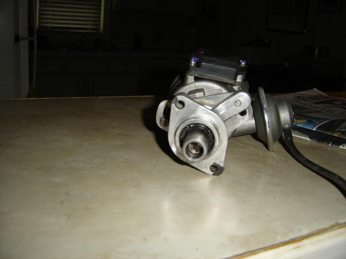

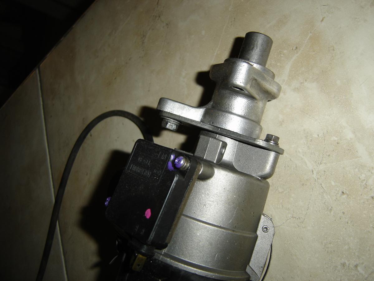

September 26, 20159 yr Author comment_478050 Here's the pics. Am I missing something. Thank you. Link to comment https://www.classiczcars.com/forums/topic/52436-280zx-distributor-spacer-into-71/#findComment-478050 Share on other sites More sharing options...
September 26, 20159 yr Author comment_478051 I see now, I'm missing the plate. Link to comment https://www.classiczcars.com/forums/topic/52436-280zx-distributor-spacer-into-71/#findComment-478051 Share on other sites More sharing options...

September 26, 20159 yr comment_478062 Now that I think about it, I'm using the one that was on the 240 originally. It ran better with the adjustment hole maxxed out towards the top, counter clockwise I think. Patcon may be onto something there. Maybe the ZX plate has more adjustment? Maybe I need one! Link to comment https://www.classiczcars.com/forums/topic/52436-280zx-distributor-spacer-into-71/#findComment-478062 Share on other sites More sharing options...

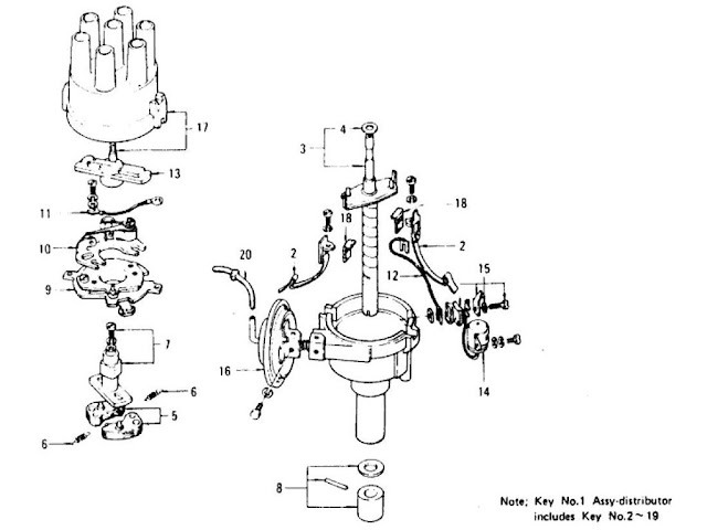

September 28, 20159 yr comment_478143 I looked at mine yesterday and I'm NOT using the one that was on my '72 240. The '71s, until August, didn't even have one according to this microfiche. here's the different ones. My '72 had the small cap one in this picture. Now it has the L28E one. I checked zcarsource.com and MSA with no luck, sorry. Maybe somebody will help out, or you could find one at a junk yard? Good luck. Link to comment https://www.classiczcars.com/forums/topic/52436-280zx-distributor-spacer-into-71/#findComment-478143 Share on other sites More sharing options...
