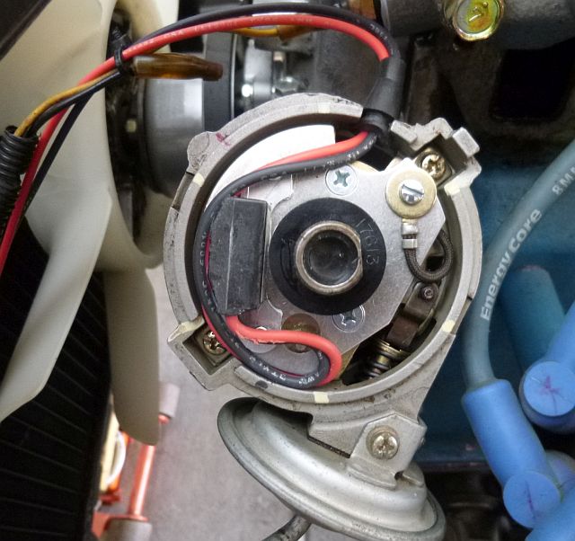

This is my 240 distributor in my 280Z block. Works well.
I have to see if I have a photo with the cap on as it ran excellent in the position I have it set up.

Yup that's exactly how mine looked.  Here is my rotor at TDC with a fair amount of advance....
i checked the timing with the distributor at full advance wit my timing light and manually turning the engine over.  It hit at 20 degrees btdc. So I guess my timing setup is fine and I have more than enough advance.
